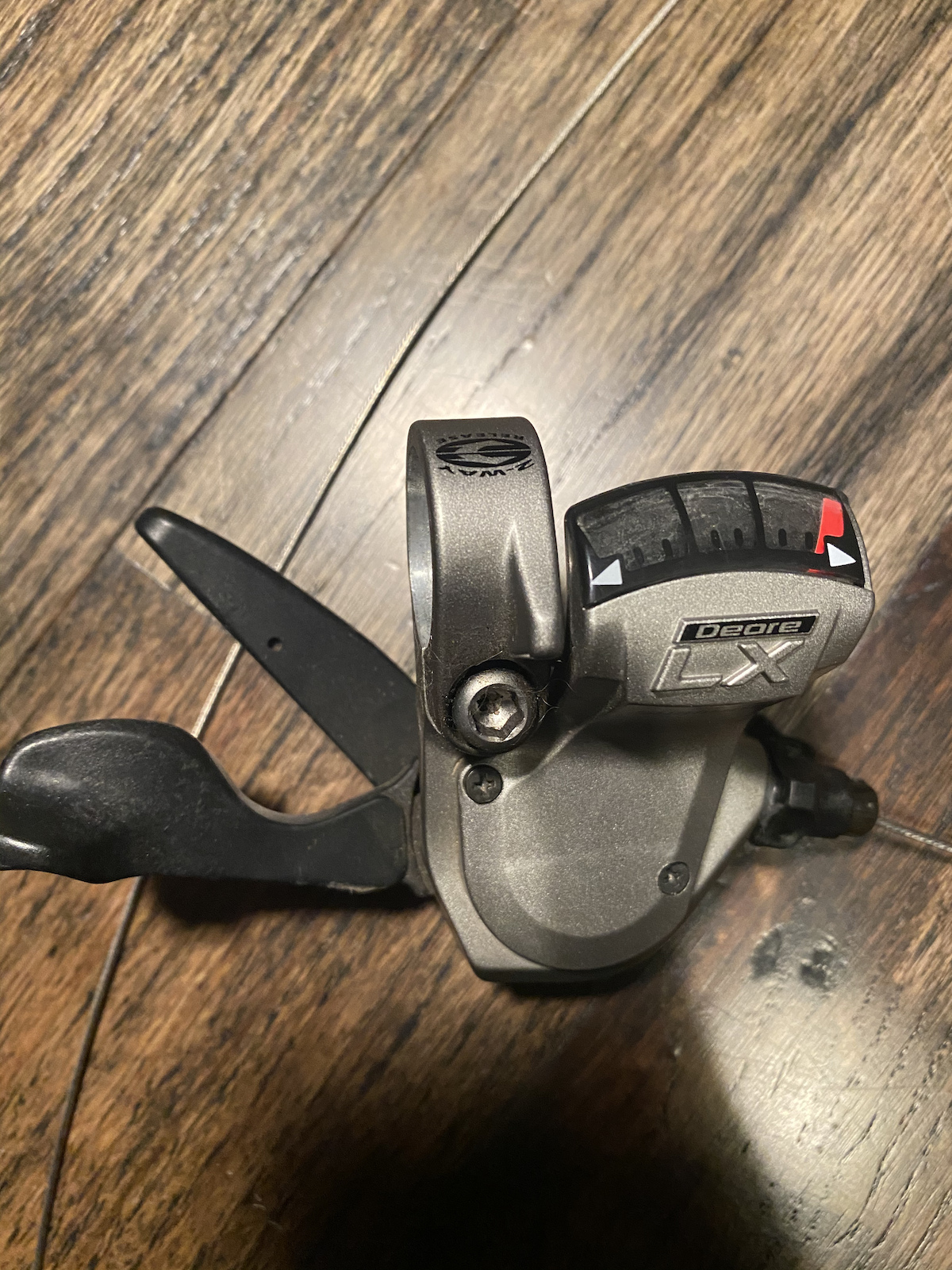

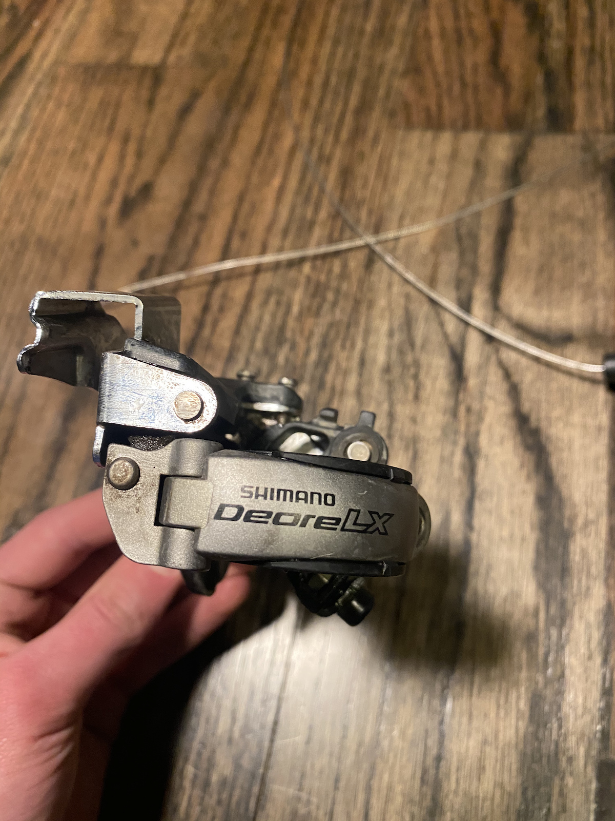

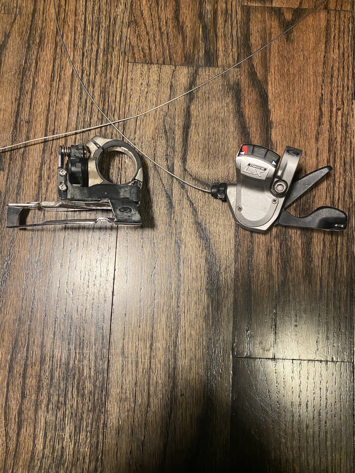

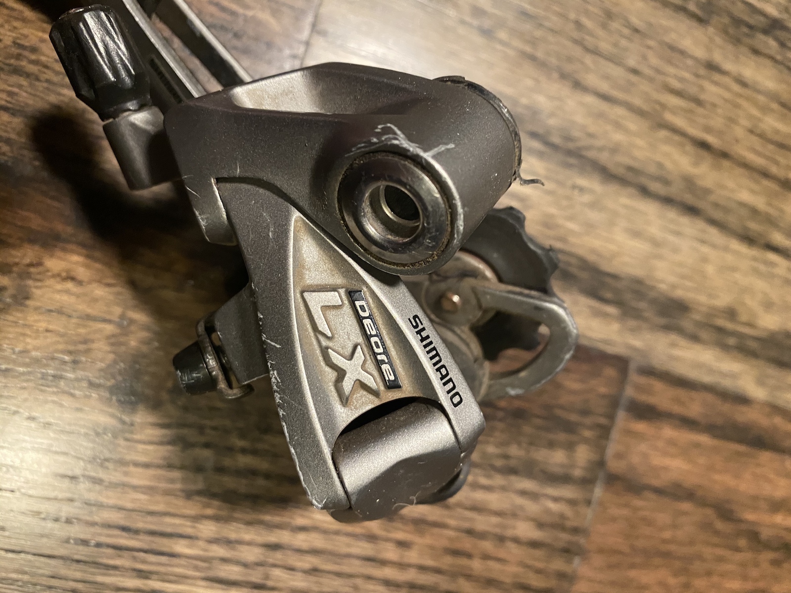

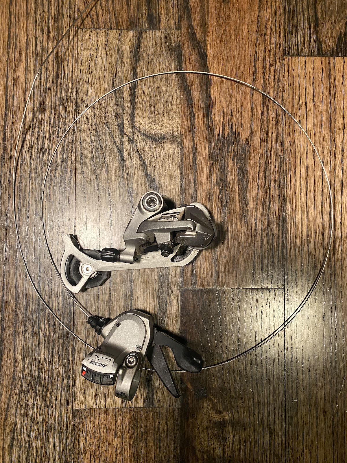

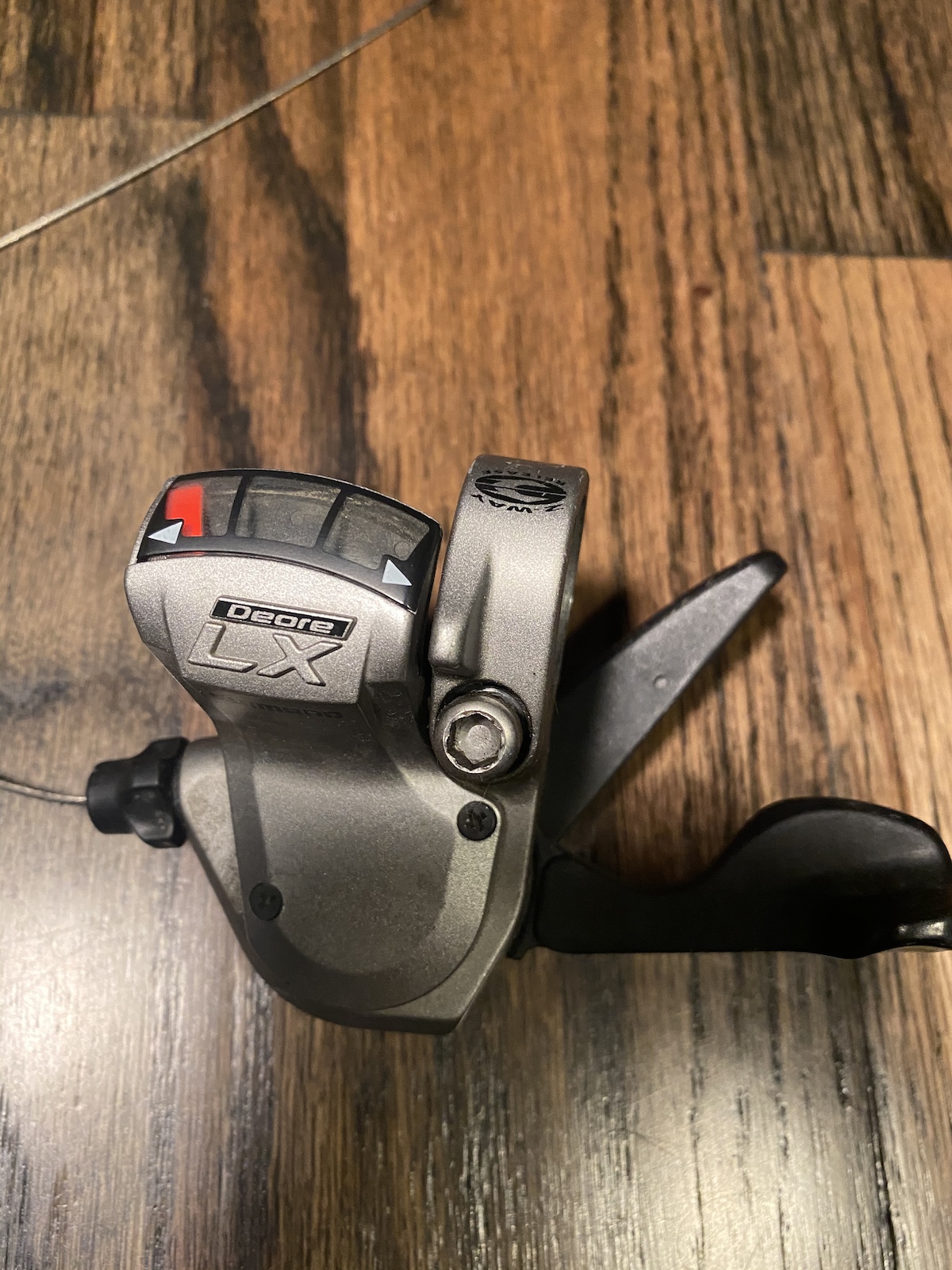

Secondly, the elves found me a front and rear derailleur/shifters combo...$50 shipped! I ordered replacement pulley wheels for the rear(as well as ones for my Deore LX M550 on the '92 M700)

Looks like a great deal. Do you know what year(s) that version of LX was made? I don't remember them but am thinking they might be the last version of LX.
The M580 series was released in 2004 according to what I found on Shimano's website.
https://www.shimano.com/en/100th/history/products/result.php?id=51#gallery-5
I thought it was a pretty good deal. I wasn't worried about the pulley wheels, since I was going to replace them anyways. Hopefully I'll pick up a matching crankset in decent condition to put on the bike as well. The "small" parts aren't being a pain in the behind ATM.. now dealing with the Headshok is a whole other can of worms. I'm debating on picking up a new RockShox coil or air fork with V-brake mounts for it and just putting the rebuild of the Headshok on hold.
