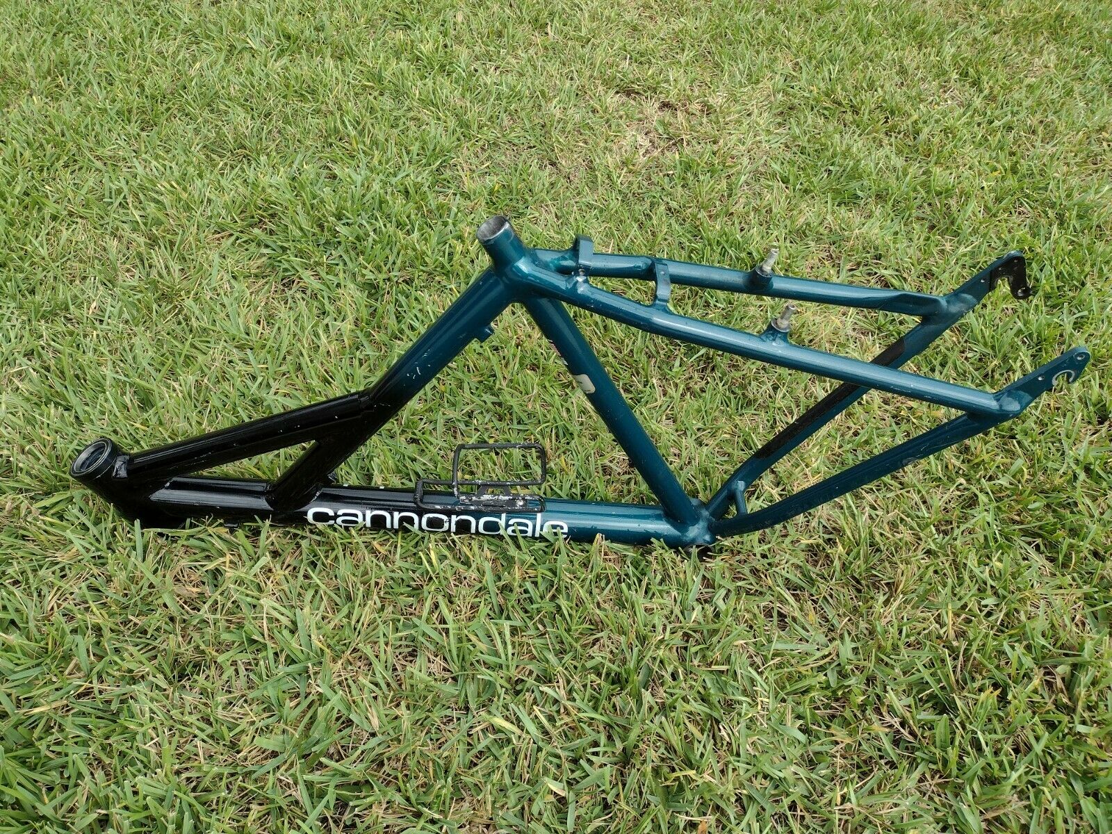

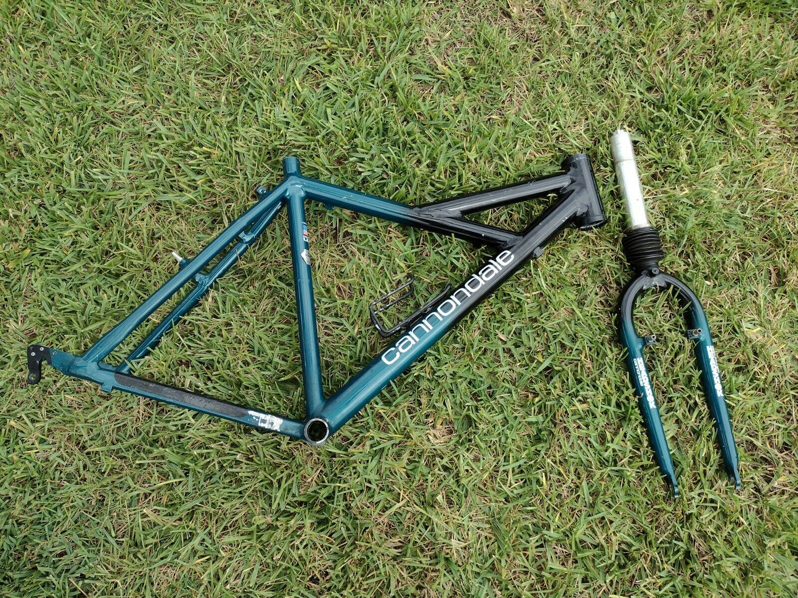

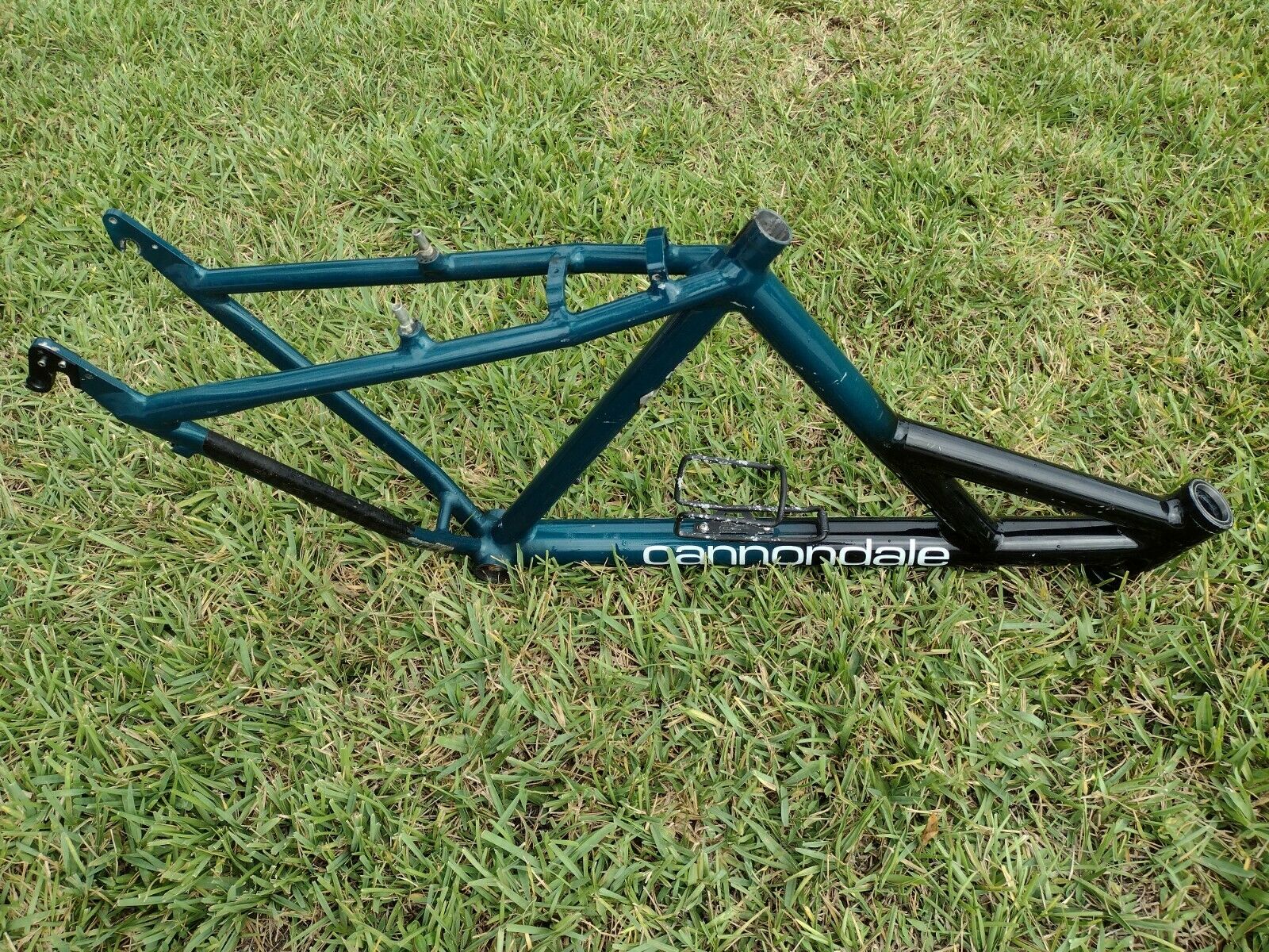

I decided to bite the bullet and pick up a "new" bike to rebuild for 2022. So today I picked up a bare Delta V 600 frame. I'll post some pictures once I get it.. Let the madness(or is it sickness) begin!!

I think 1994 was the only year for the DV600. It came with 7 speed STX and an LX rear derailleur. How are you planning to build it?
That's what I've been able to discover from looking at the catalogs as well. From the pictures of it the date code is FB which puts it as a Feb 94.
I haven't totally decided on what direction to take the build. I will make a decision once the bike is here and I can look it over more. Pictures can only tell you so much. I'd like to restore the paint 100% but I don't think I can tackle the factory fade. Then it's finding correct decals/stencils.. you know the rabbit hole that that can become. I say that about the paint because SOMEONE really wants and all white bike.:rolleyes:

I wondered about the fork as you said it was a bare frame. Did you have one on hand or did it come with the frame? Did you see the recent post from a UK member who is reproducing the boots?
What can I say I was an ID10T! I didn't see the final two pictures which showed the fork as well. Needless to say, I got super lucky on this purchase despite being dumb. Since it has the fork I am really rethinking most of my original plans for the bike. One of my original ideas was to move the 1x9 setup from the Jekyll (making it a 1x10) when I upgraded the wheelset on it. Now I think I will keep it and make the Delta V 3x9.
I also think I am going to sadly have to repaint this frame.. there are some bubbles in the paint that have tiny bits of corrosion under them. Plus I need to fix the minor gouges on the chainstay near the bottom bracket. Oh well, I love a challenge! I am going to copy the Cannondale paint forumlas and send them to my friend in FL that works in a body shop..Hopefully, he can mix up small batch and paint test sample for me to see if it can be matched. I have to find is the frame decals for a 1994 Cannondale as well.. I DO NOT want to repaint the fork. It doesn't have the standard Headshok logo's on it.
The small spots are doable ..its the larger one on the chain-stay that really concerns me as it is gouged into the metal. You can sort of see it in this picture, just not how deep the gouges are. From the looks of them it looks like someone bent a chainring and rode it for a while. The seller bought it from the original owner and thought it was pretty much still stock. However, he told me that the drivetrain,shifters and brakes were Suntour, not the mix of STX and LX it should have been.
