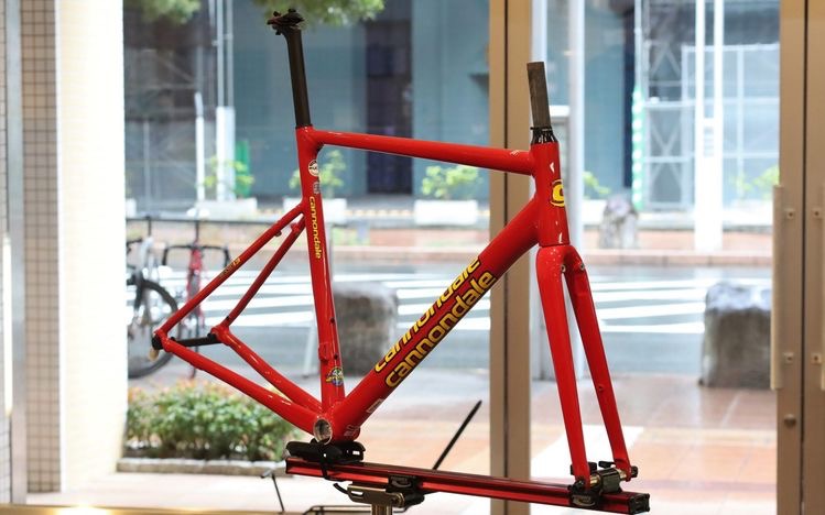

This is making progress and over the holidays I will repaint the frame in retro Saeco style like this caad13 frame. I know this is inaccurate but should look super.

Now, on to decals and clear coating. I want to turn this into a "off road" Seaco version from the 90ies. Any views? I will add the Aluminum 3.0 stickers instead of "CAAD", because that is what the frame is, same on the fork, and the original stickers on the seat tube.
Should I use the "true, accurate" Cannondale logo on the head tube (black diagonal lines) or the yellow "c" decal?

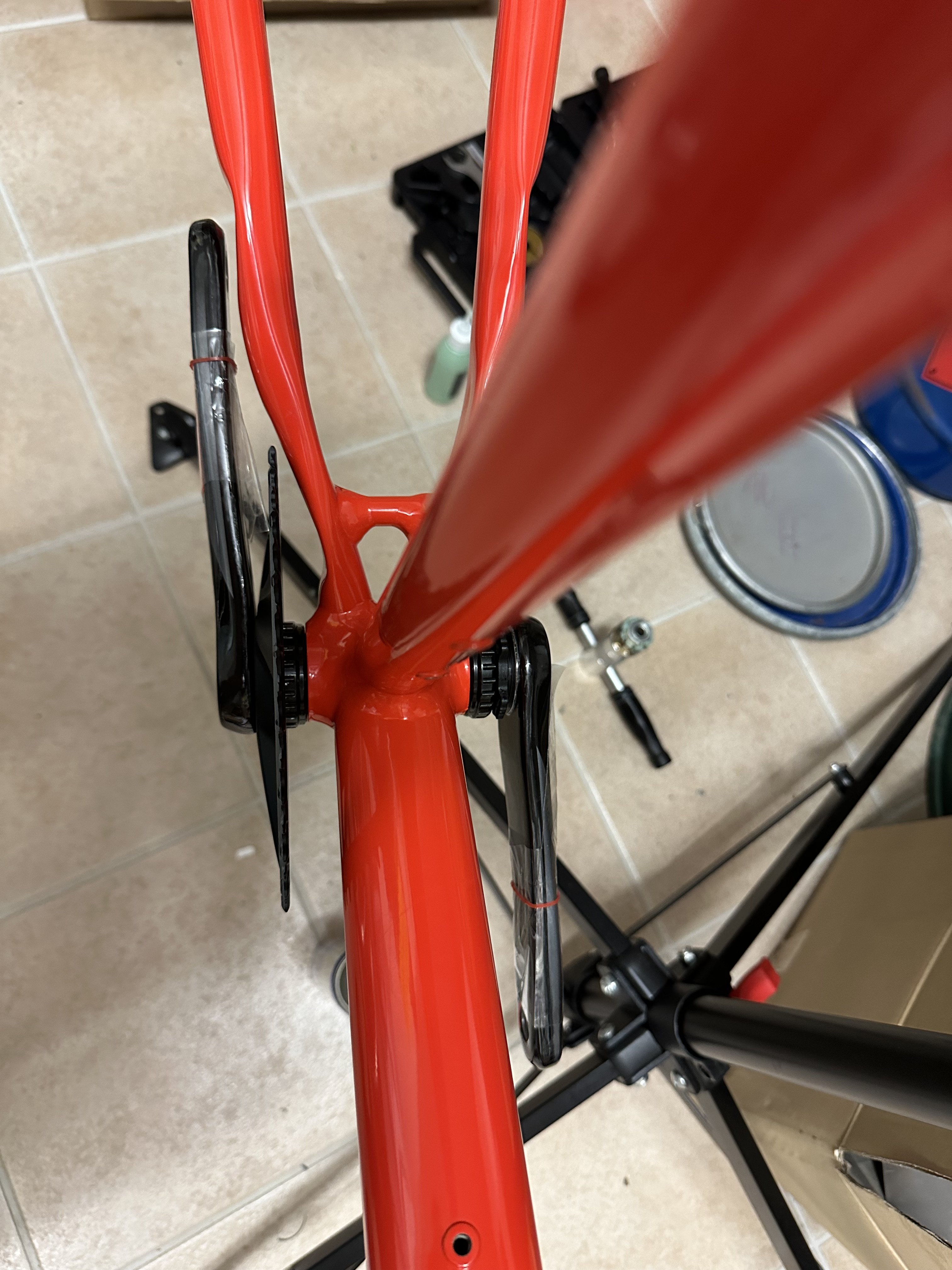

So i had difficulties screwing in the new bottom bracket. The frame was sandblasted and the bottom bracket threads do not look as shiny as they used to. BSA, right? Probably need to tap the thread to clean it. Or just a steel wire brush?
I'd try a brass wire brush, steel may be too hard and could damage the threads in the aluminum . I had take my M700 to a LBS to have the BB treads redone after removing the original BB and finding damage to the threads done when it was installed originally in 1992! I'd have done it myself, but the cost of the tool isn't worth it for me to buy it as a "just in case I need it" (the park tool version is $600+) tool.
OH yeah, the bike LOOKS super amazing. I kind of want to repaint my M700 but can't find any decals to match the originals.. I did find some M800 Beast of the East decals from that yea on e-bay, but the seller is in Hungary and to be honest I am leery if they can change the M800 to an M700 properly to make the bike complete
FPrue1304
Brushing cleaned out some grey residue. The bracket now turns smoothly for two revolutions or so and then gets stuck. Guess will have redo the threads.
FPrue1304
Chased the bottom bracket threads and test mounted the cranks. Road cranks (DUB, narrow version), 165 mm cranks, 1x 46 chain wheel - very pleased with the fit but will change to a 40 in the final build up. I was not really expecting the 46 to fit but this gives me flexibility. These old frames are marvellous - long and low and road part compatible. Glad the bottom bracket is sorted out. That would have been a "deal breaker"; these frames are listed super seldom and I was so happy to find a good 18 inch.
