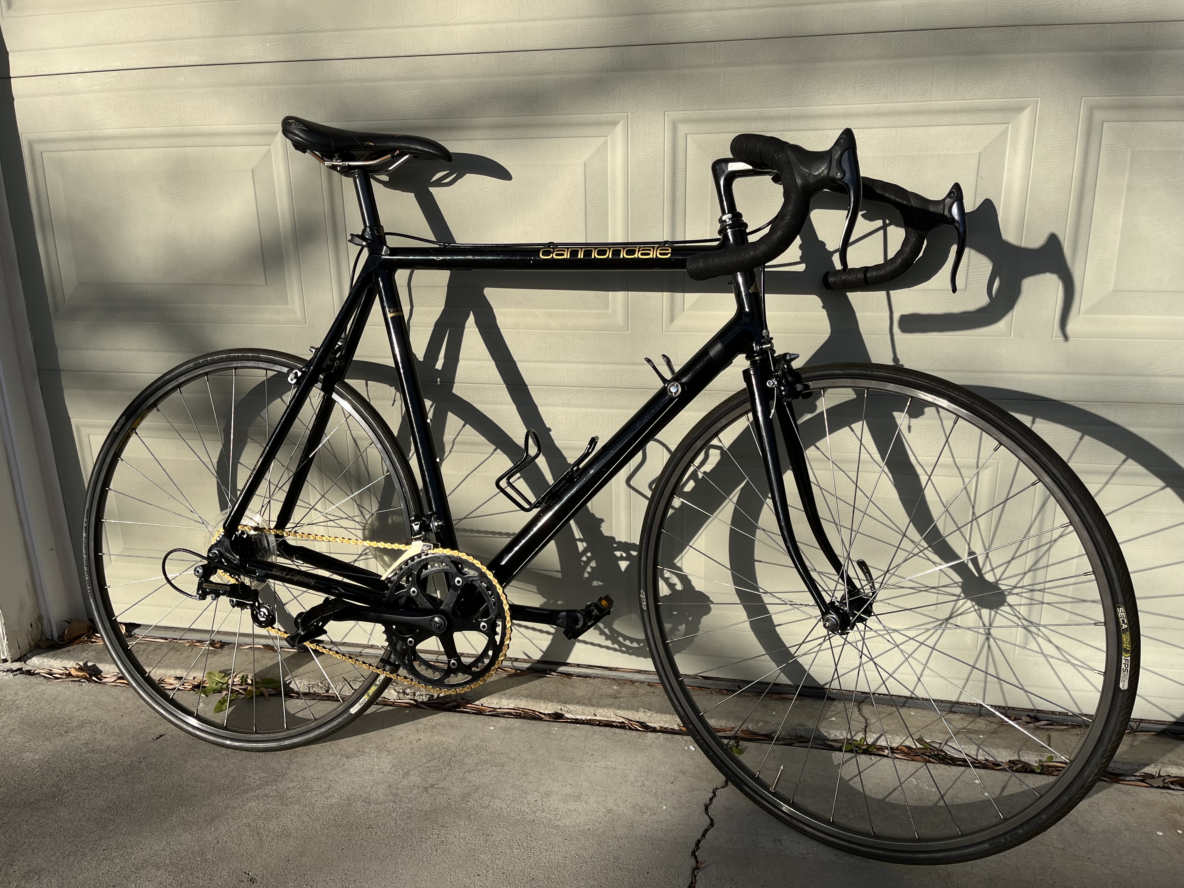

1988 Black Lightning

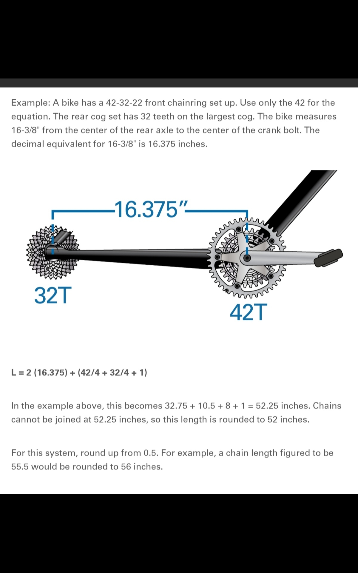

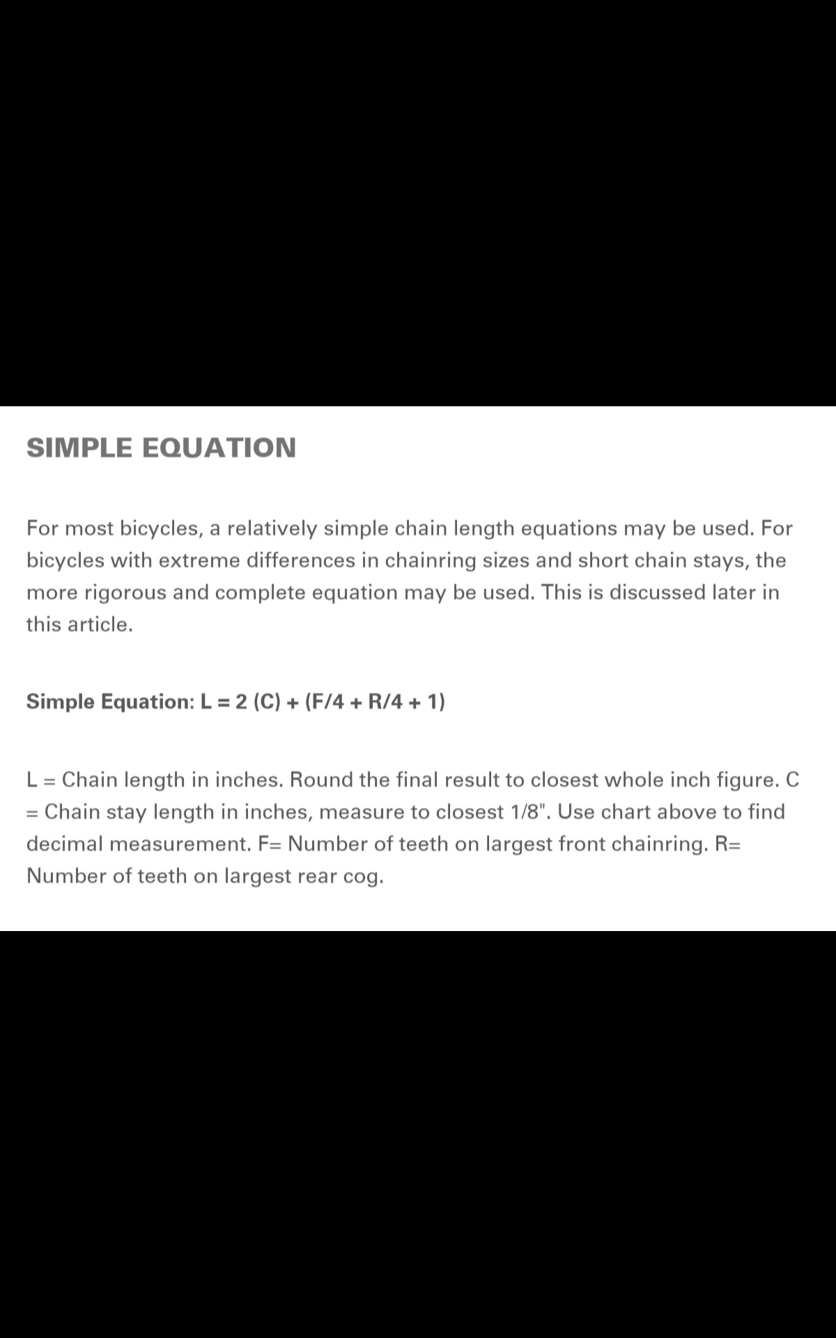

I am wondering if your shifting might improve with a different chain length? I am attaching the formula that I use when I question the chain length necessary for any given bicycle.
I began to wonder myself. When sizing I did the large chain ring to large cog, plus two pins. But removing/reinstalling the rear wheel I felt the chain might be better longer.
I tend to have my initial cable tension too tight. Being aware of that I paid extra attention to that detail with this project.
My initial difficulty was that I was getting a skip at the second to largest cog when shifting in the larger cog direction. Is that up shifting or down? I can’t keep that straight in my head. I wasn’t able to get a nice solid click with the shifter at that position.
The second day I started from the beginning. Set the limit screws with no cable tension. Paid better attention to initial cable tension and gave myself plenty of barrel thread for tightening. That method yielded a skip on the second to smallest cog. Aha! I then rotated the barrel in smaller increments than the day before to index. I progressed faster in achieving desired shifting between cogs compared to the previous day. Probably because I didn’t have to undo large cable adjustments.
I was in a self imposed rush to go for a ride and getting back to spending time with my kids. On the stand the shifting from large to small cog was great. Stands to reason that it would be, as that’s the direction the RD spring tension pulls. Shifting small to large isn’t quite as smooth in the middle.
I went with that as it was mid afternoon and about as warm as the day was going to be. My ride was going to be a short one through the neighborhood. One small hill and not much speed.
It’s the first bike I’ve completely torn down and reassembled. So one could say I was being cautious about my workmanship and not going pedaling fast and rowing through the gears. Was I scared? Nope. I’ve got a job that is very physically demanding at times. Being out on disability because of a bike crash entered my thought process. Is that old man think?

From the photo it does appear that your chain is a bit short. Shouldn't affect shifting except in large ring and larger cogs combos but doesn't look ideal.

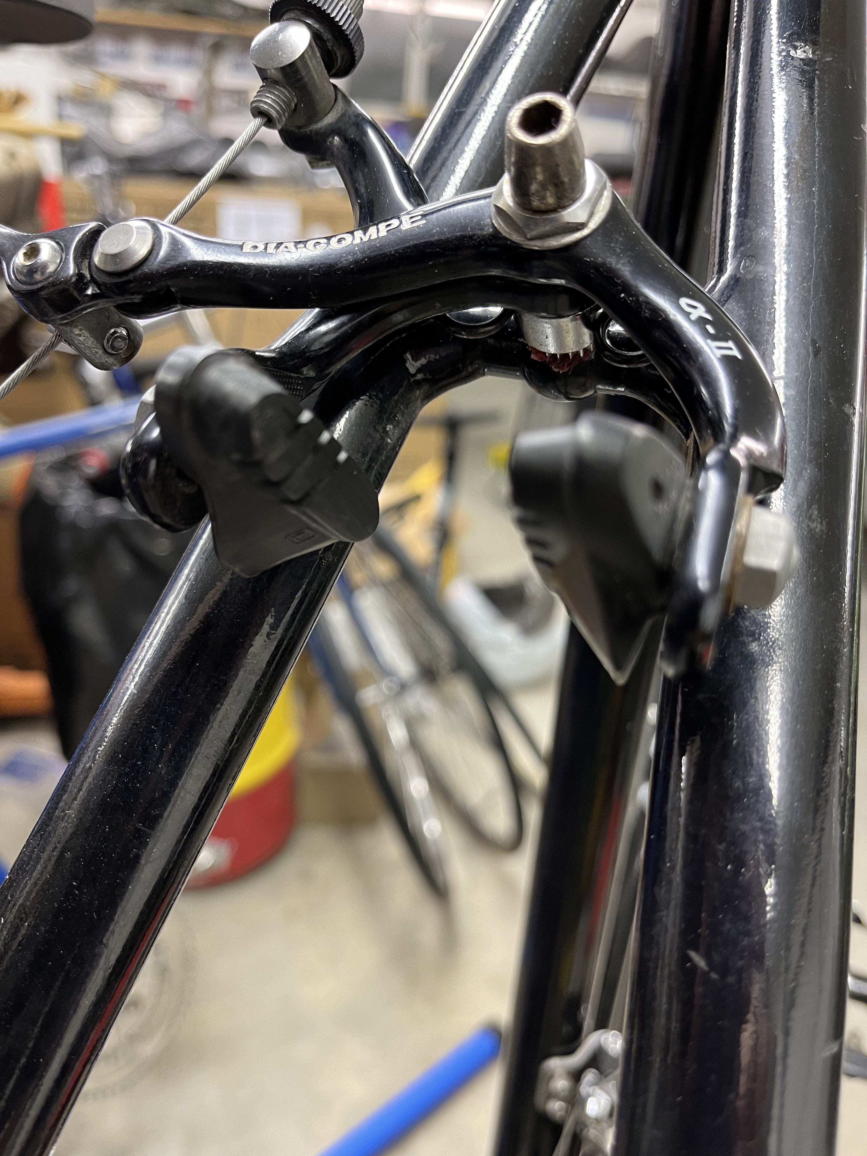

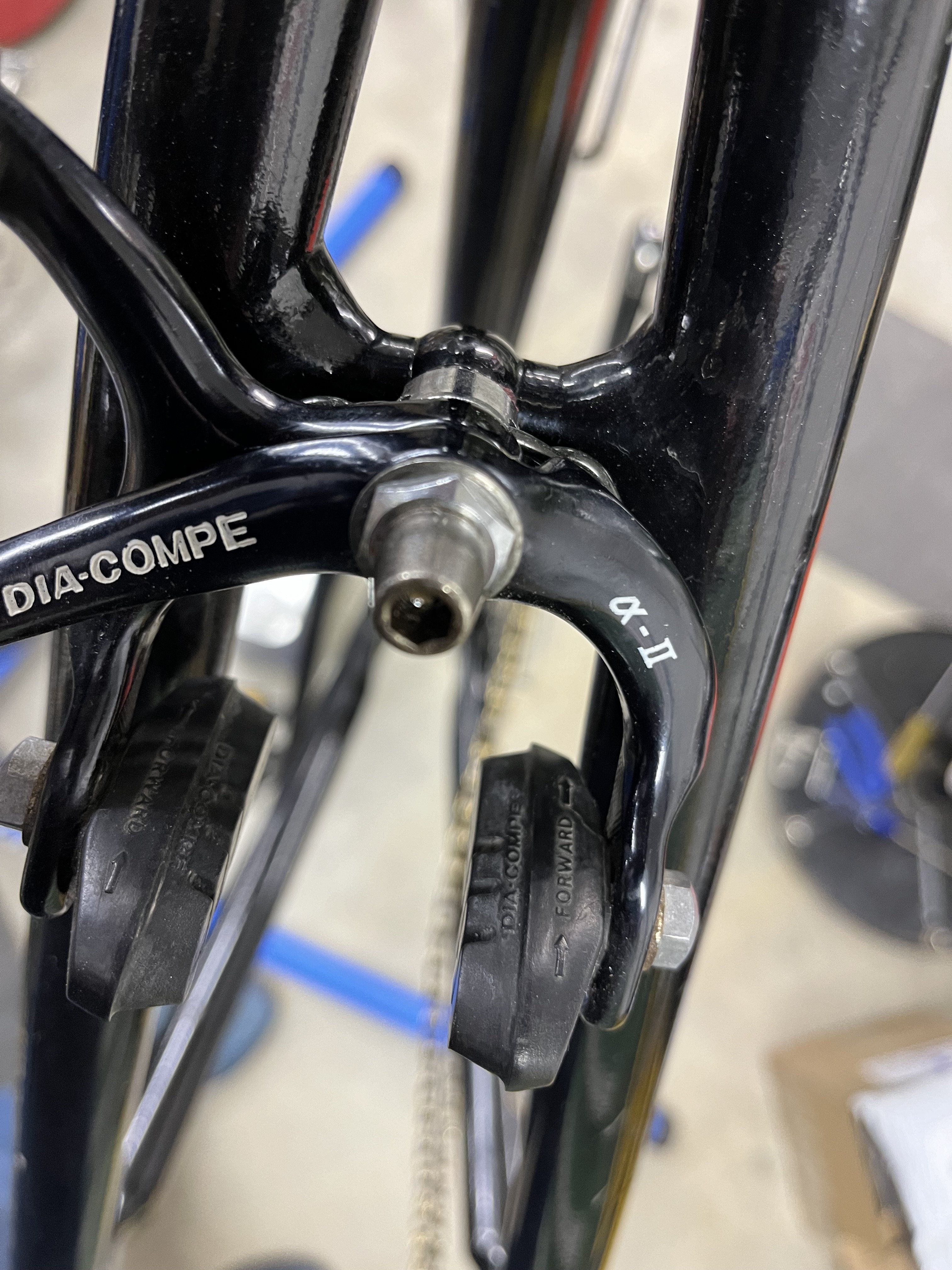

Anyone know the part number for Dia Compe 400 brake pads?
About to put new tires/tubes on and thought I’d put new brake pads on. They’re not rock hard but doubt their performance is very good. I’ve got the gears figured, about to put on new rubber and going to pedal to a high rate of speed. Stopping is a valid concern. I think ;)
You might try filing the outer layer of hard pad material down. May or may not be a layer with more grip underneath.
Someone at Cane Creek may be able to advise you on new pad choices. Cane Creek is DiaCompe's high end brand.
Thanks for the Cane Creek reference. Will check.

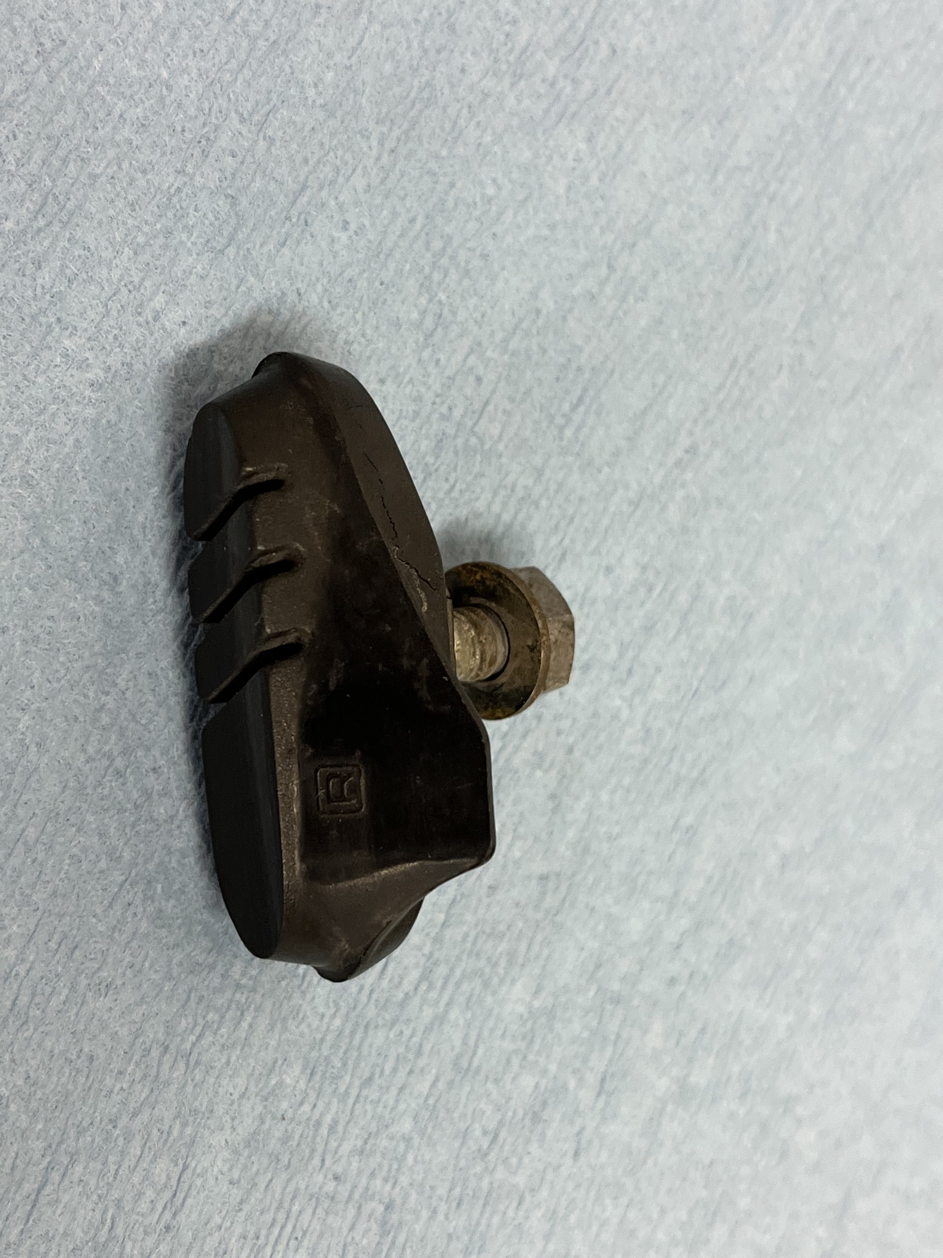

Best I could come up with for a number is OPC-30. I got that from Dia-compe’s Taiwan site. They look similar but sans forward arrow identifier. No dimensions either. There are a couple listings on the bay for OPC-30KX that look the same but are listed for BMX.
I did dress the pads with some 600 grit this morning. It’s currently snowing, so my planned afternoon ride is not taking place. Too bad I got the new tires installed also and managed to not pinch flat a tube during installation.
