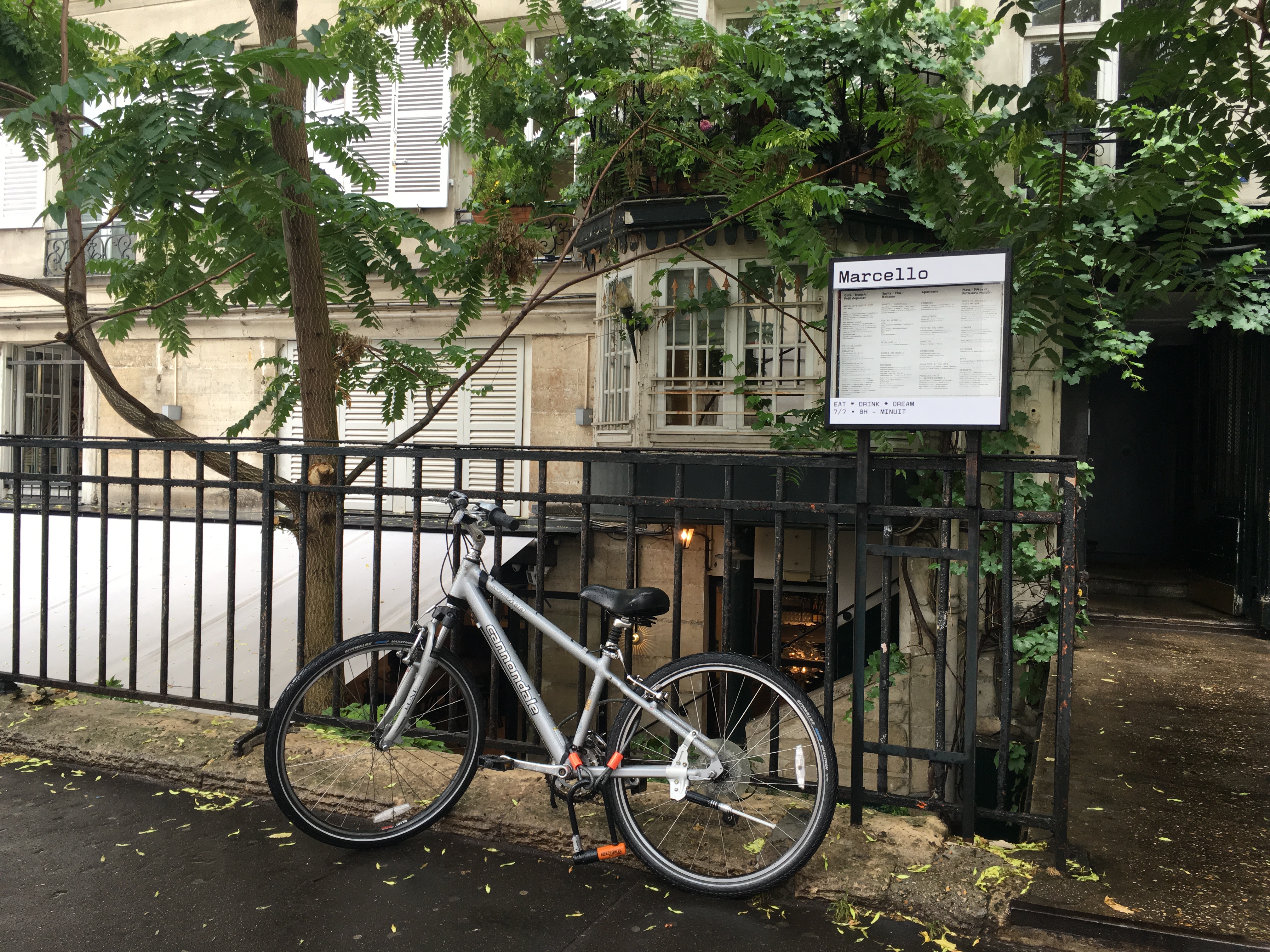

This is my girlfriend's bike,Comfort 400. It has originally double fork.
