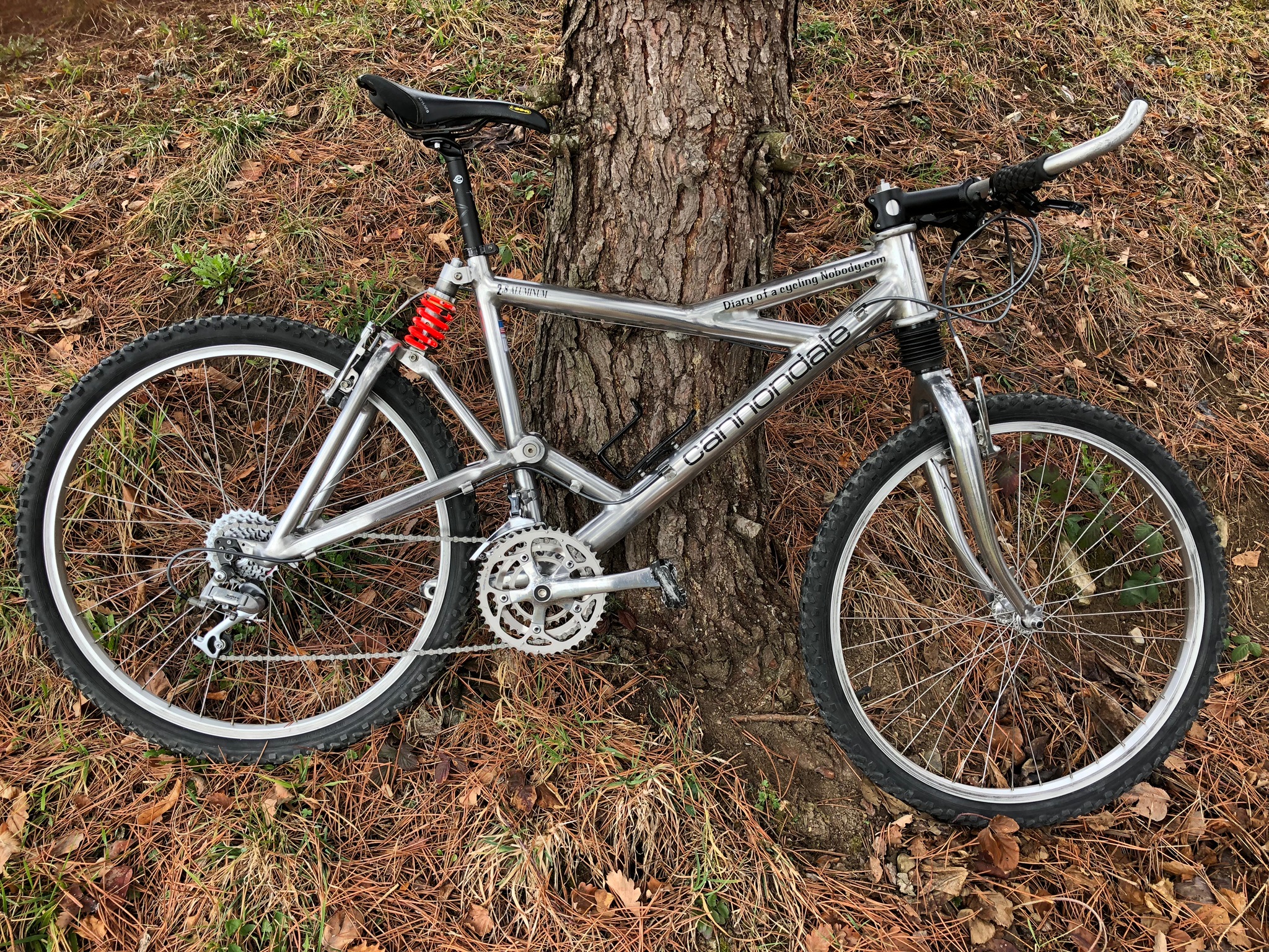

Hiya Brian - all of those. I’ve heated it a bit, hit it, bathed it in penetrating oils for 3 nights, tried to turn it with big grips and it ain’t moving. Very bizarre. It’s probably easier to find another one because it’s set too hard for me as Welles looking crap because the spring needs re-coating.
A new (old original) one might be hard to find. The threads are aluminum on aluminum, any chance they are cross threaded? Does the ring move at all? Can you try clamping it sideways, and get a block of wood, and smack it down? It may need to break some corrosion on the threads. Worst case, if its done... cut the ring, and find some ring that will work. Motorcycles use those types of rings.

Any chance you can go in the opposite direction by tightening it to reveal more thread and try and clean it or at least see where its binding.

As you’ll see, it is finished apart from that shock. At least I’ve rescued it from an eBay box of frame parts and found that weird sized bottom headset bearing with the help of this community.

I think your original shock can still be salvaged. Does sound like the threads may be galled. If that's the case, probably the best thing to do is to cut the nut off. That will allow you to clean the shock threads up without damaging them beyond what damage you now have. Of course that will require another nut. I'm guessing one can be found with the same threads.

I also think it can be saved. I would look at the threads, to see if its been cross threaded. If not, i would you oil, and tap with a block of wood, in the tightening direction, than the other way. Make sure it is in a vice tight, so the force is going to the nut, and not absorbed by the entire shock.
I would doubt that it's cross threaded as the nut is threaded on quite a way and the threads don't appear to be damaged. Probably got some grit down in the clearance between the nut and the shock and galled as a result. The shock thread could also have been damaged by an impact of some sort.
Coil-over nuts are usually a pretty loose fit. On the race cars we used to tack a small screw to the bottom of the spring so that we could reach inside the tub and quickly adjust the nut by turning the spring. Never had one that I had to use a wrench on as far as I can remember.
