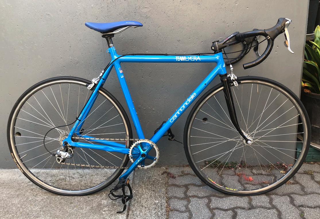

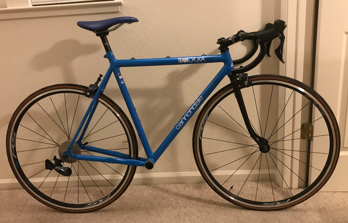

I am building up a late 80s cannondale with modern ultegra R8000 components and I am wondering what is the best way to route the cables. (the spacing for the rear wheel measures out at just over 127mm and I was able to fit a 130mm wheel in without stressing the frame)

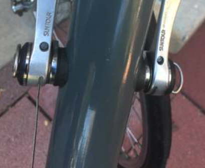

I would like to get a Cannondale boss kit and attach housing stops on the downtube. I found this replacement boss kit on eBay. Is it possible to attach this without stripping down the paint and epoxying them on? Are there any other alternative options to getting housing stops on the downtube? clamp on stops?

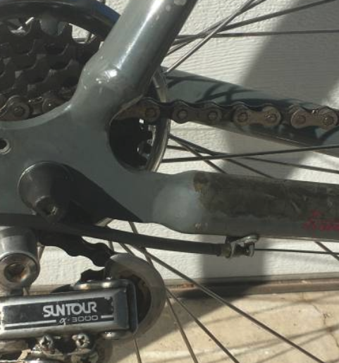

The chainstay is also missing a housing stop for the RD but I am not sure what the part would be called or what exactly I am looking for. Would anyone happen to know the name of this missing part or anything I can use as a replacement? Should I look into stick on/zip tie cable stops?

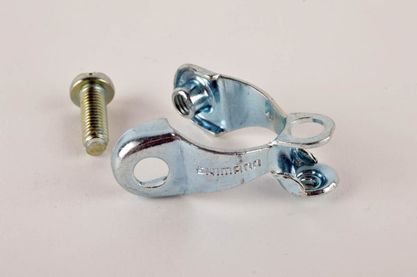

I would like to attach a braze on FD using the holes provided on the frame. Am I just looking for something like this braze on plate to attach to the frame? Looking at the one pictured it does not seem like it would put the FD in the correct place.
If the above options do not work out. Is routing the bike with zipties going to affect shifting/brake quality?
Thanks in advance!

I would recommend that you find the Cannondale parts from a trashed donor frame. Keep an eye on local craigslist and contact your local bike co-op for leads. The linked front derailleur mount might work but you would have to assume the guinea pig role to find out. I can't see the down tube bosses working at all. If they had made one side in two pieces like the original so they could be tightened without rotating the concave bits that contact the down tube they might be OK. I doubt you could find clamp on stops with the right diameter clamp. Here is what the original bits look like:

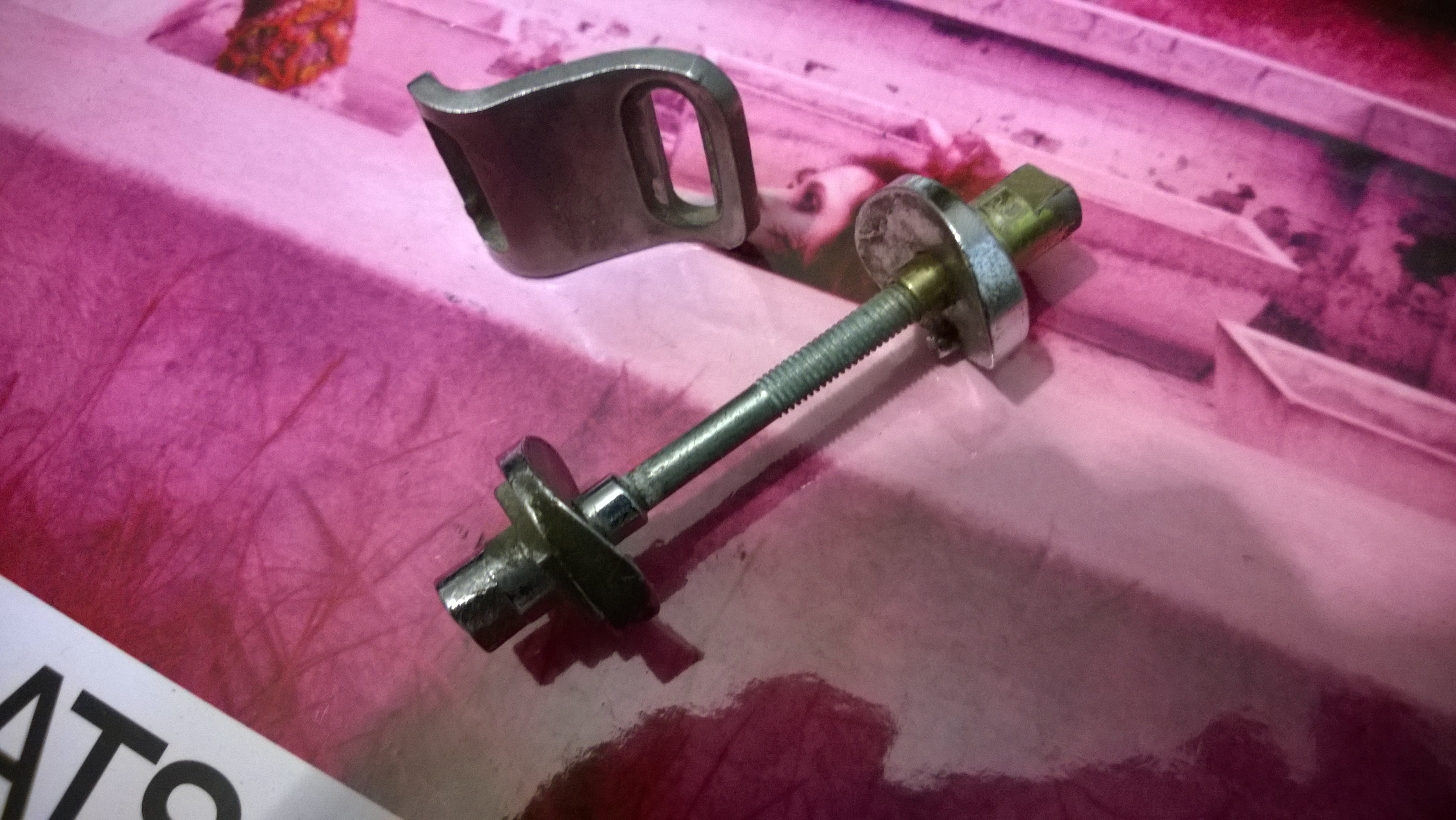

The gold portion of the down tube boss rotates independently of the concave boss, so that allows the assembly to tighten up without damage to the tube. You put the fixed boss and threaded rod through one side of the tube, add the boss for the other side, and tighten the gold "nut" to bring everything tight.
Looks like someone has run full length housing all the way to the rear derailleur but I can't imagine that it doesn't affect shifting performance. SunTour made some clamp on front derailleurs with a cable housing stop but I doubt that they would shift Shimano 11 accurately.
The chain stay housing stop is made from a piece of steel about 1/16" thick. It is attached to the stay with two pop rivets. If you are handy you could probably fabricate a replica. I can get you a picture of the original if needed.
Ask around your local bike shops about shops that were Cannondale dealers in the 80s/90s. Some local shop may still have a box full of these frame attachments. All the dealers would have had them when the bikes were relatively current, but most of the vintage Cannondale dealers are long gone.

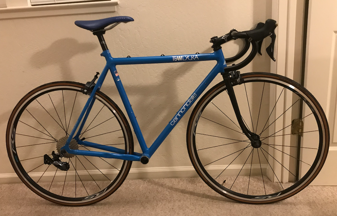

Thanks for the reply! Is there a range I should be looking to pay for an oem cannondale boss kit? How much should I be looking to spend on a used frame? I see quite a few used cheap cannondales for sale but it seems like such a waste to part out a perfectly good bike to build this one. If I bought something like this would it be fairly easy to take these parts out? Do I need any proprietary tools to do the job? Something like this would be perfect. Thanks again!

No special tools required, just a proper sized drill bit to drill out the rivets on the chainstay stop (start small). Adjustable wrench will remove the down tube bosses. Just be careful to loosen the correct side. The fixed side boss is diecast and pretty delicate. The one in my picture has the threaded part that holds the central rod broken off from the boss. Best to soak the rotating side well with a good penetrating oil so that you don't have to apply too much torque to break it loose. Front derailleur mount is just two socket head cap screws, 4 or 5 mm hex wrench to remove. Shoot some penetrating oil down the seat tube and around the mount. If the rivnuts turn in the frame you will have to drill or grind the heads off the cap screws, but not something I've needed to do. That 1987 SR400 would be a good candidate if it were in rough shape. Bottom of the line road bike and the Alpha 3000 components aren't much. I'd be patient and look for a rough/damaged frame.

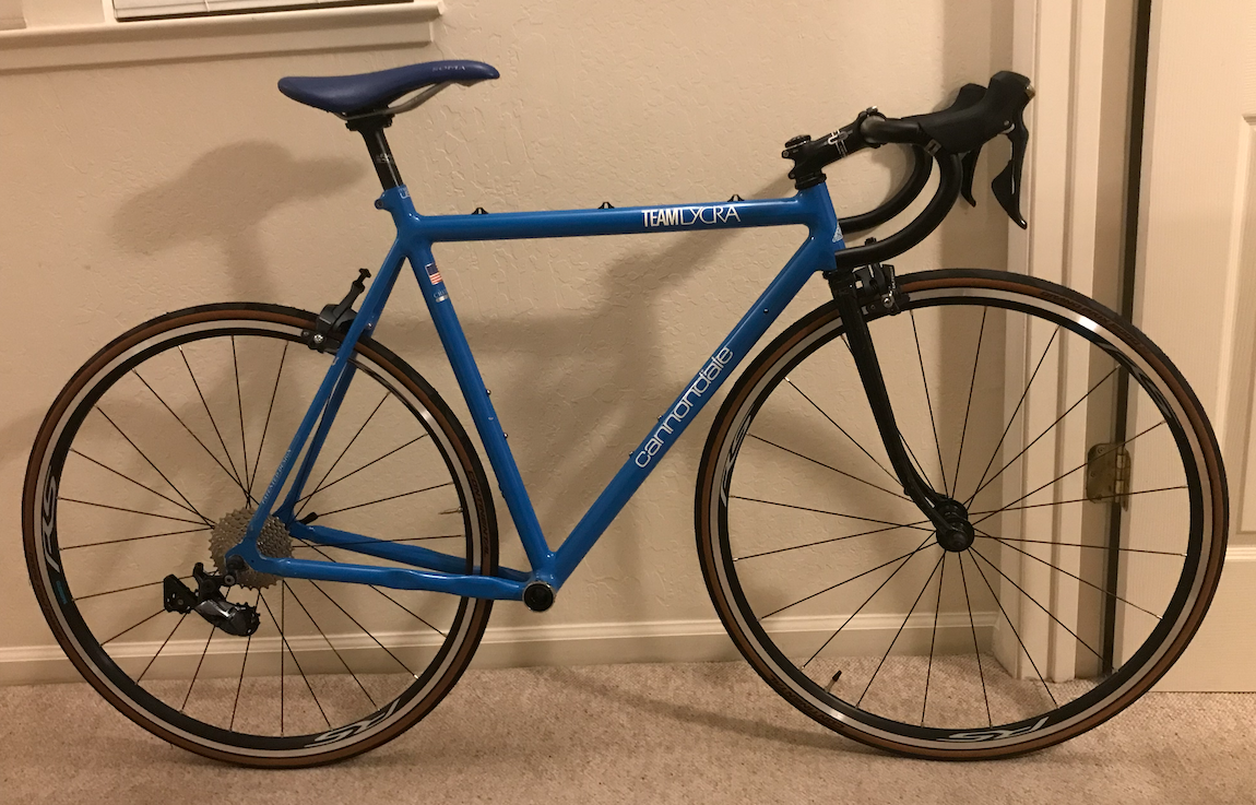

The bottom of my chainstay looks like this. Would I need to drill into this still? Any recommendations on oil to soak with? If I were to buy a frame and strip it, is the frame essentially useless without those parts? I would be happy to donate the stripped frame to a bike coop if they can use it.

I was thinking that the 1987 frame I looked at had the two rivet holes (nearly) parallel with the rear wheel axle - in line at 90 degrees to the centerline of the stay. Those look to be staggered - kind of on a diagonal to the centerline of the stay. I have a couple of 1988 frames and some older ones I can check given time. Check your serial number and see what the build date is.

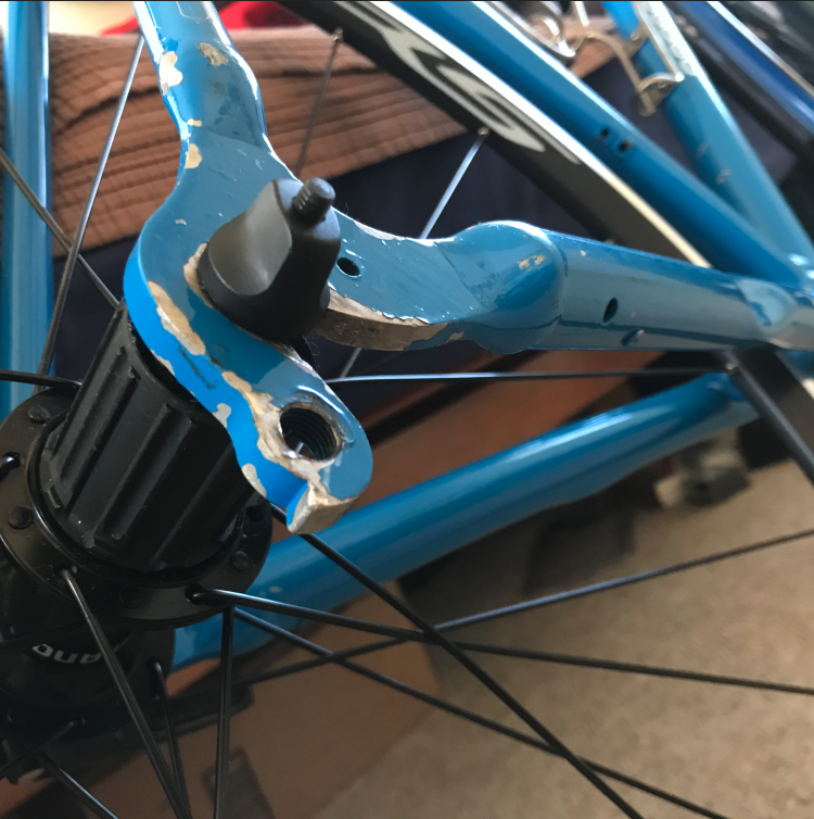

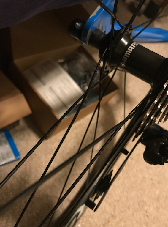

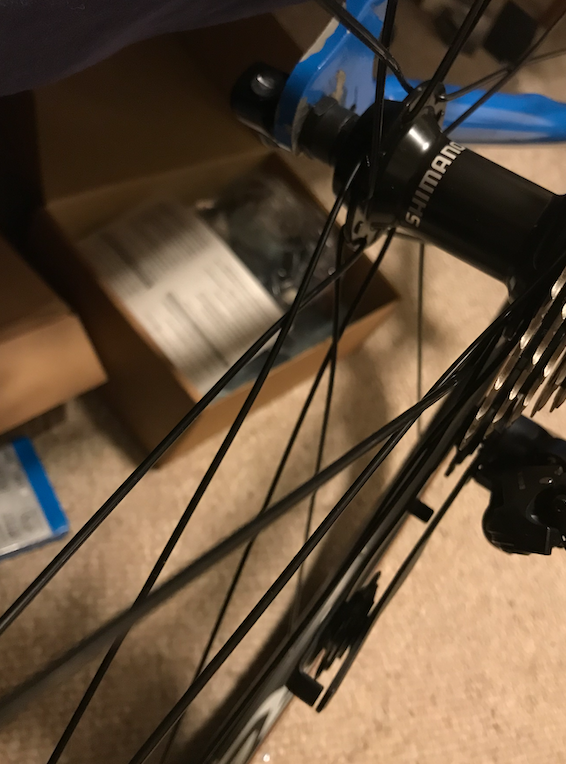

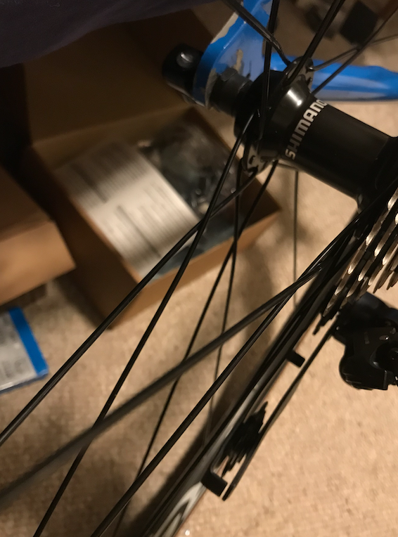

Thanks for all the help yesterday. Here is some progress as the parts come in. Next is the tricky part of routing the cables! Any thoughts on clearance with the derailleur hanger and the high gear? It looks like theres somewhere between 1-3mm clearance there although I have put any cable tension yet.

By high gear do you mean the largest cog? That is actually the low gear - lowest gear ratio with a given chain ring. I can't see what model of derailleur you have but it looks to be something like a GS cage Shimano. I'd need to know model number of the derailleur and the tooth count of your cassette to give you a definite answer, but my guess is that you will be OK once you have the proper length chain and everything is adjusted correctly.
