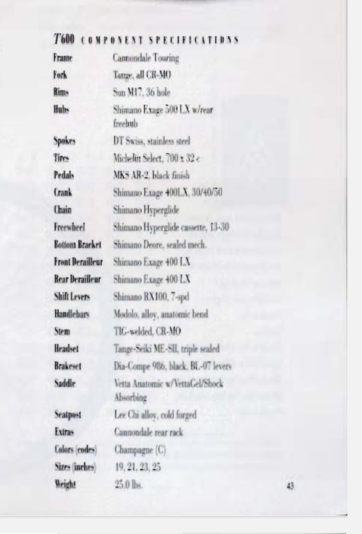

As I put more miles on my 1992 T600, I'm curious on where to start researching potential upgrades to the groupset. It currently has Exage 400LX components with 30/40/50 chainrings and 13-30 cassette, but the rear hub and wheel are replacements. The rear hub is also missing a lock nut for the cone adjustment so it always works its way loose. Front hub/wheel are OEM and seem fine. At a minimum, the brake and shifter cables and housings should be replaced as they are cracked and rough.
My first and most likely thought is to just find an Exage rear hub and call it a day. BUT if I go further...
Is it worth upgrading the components? Is there a typical route to go (i.e. everyone always chooses 7700, or 105, or SRAM something)? I was also unable to find any specific information about the bottom bracket. It's a square taper Deore, but I don't have info on threads/sizing. Do people typically just leave the OEM bottom bracket and limit crankset choices to square tapers?

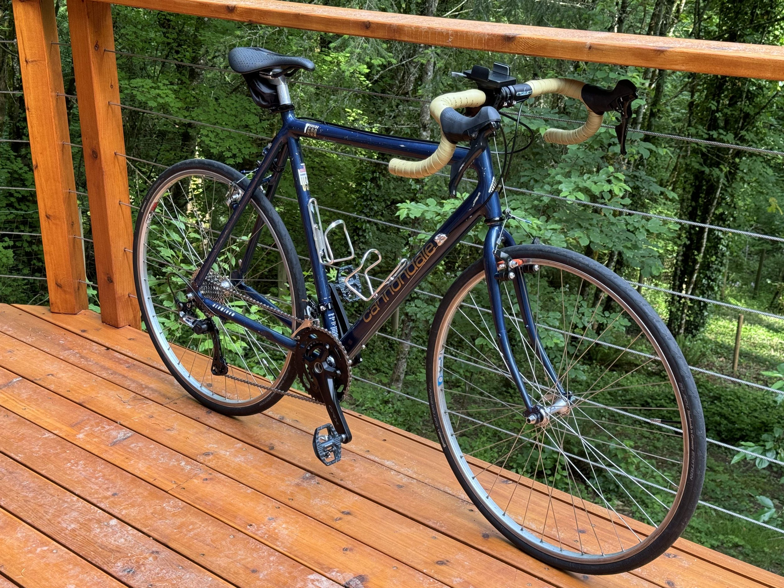

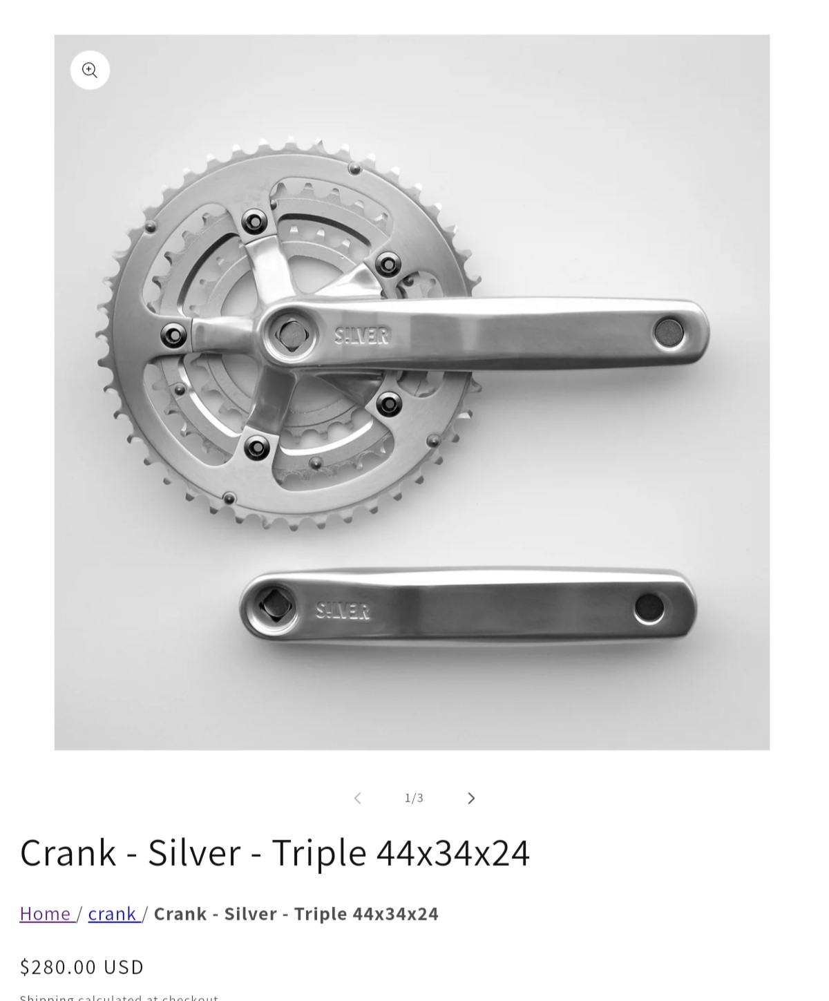

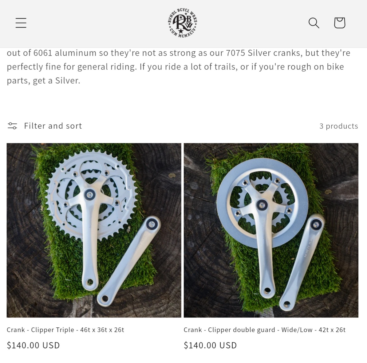

How about posting a picture of the drive side of your bicycle? Looking at the picture of your bike that you posted earlier I'd say that there are better quality parts available compared to you OEM drive train. You might not notice performance wise however. But things do wear over time. Wheels would be a great way to start, but beware, $1000 for a Wheel set is pretty common. Living in Portland; I'd contact Sugar Wheel Works. Bottom brackets are easy. Just replace it with a Shimano cartridge bottom bracket with the exact (or closest available) spindle length to what you have. Since bottom brackets sit close to the ground and get their fair share of water I'd replace it solely as a maintenance item. I would have the headset serviced too. That's a mighty old bike. Like I said before, if you replace the crank, you'll never notice the difference with the old one, performance wise. Chainrings wear however, but new ones usually cost as much as a whole crank. Maybe someone on this site could help in that regard. I'd say check out the Rivendell bicycle website. There are two pretty nice square taper cranksets there. You could also get some better climbing gears with a 26-36-46 chainring set up.

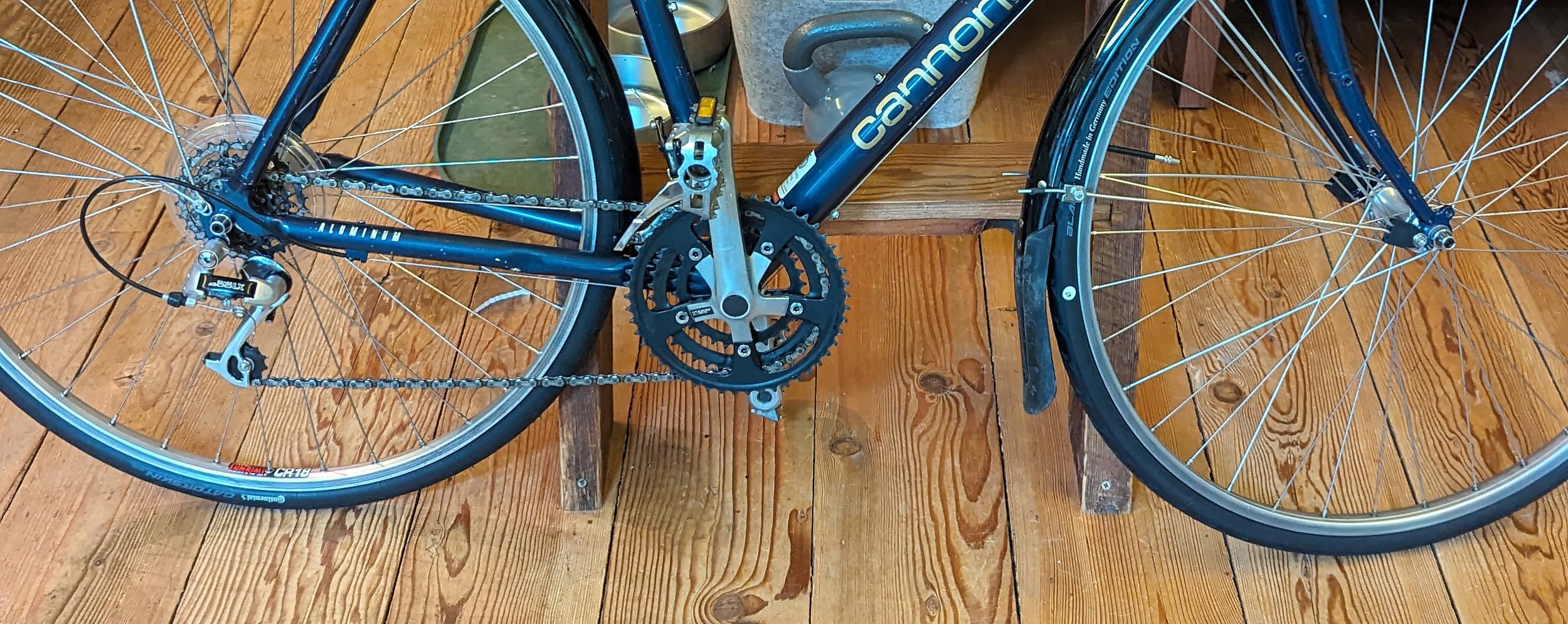

All good insights. Neglected to post the only drive side photo I have. I've been poking around looking at various wheel builds this week. That would be a good place to shave some ounces off the original 25 lb weight. I'll have a look at the bottom bracket this weekend and see what might be available in the same spindle length.

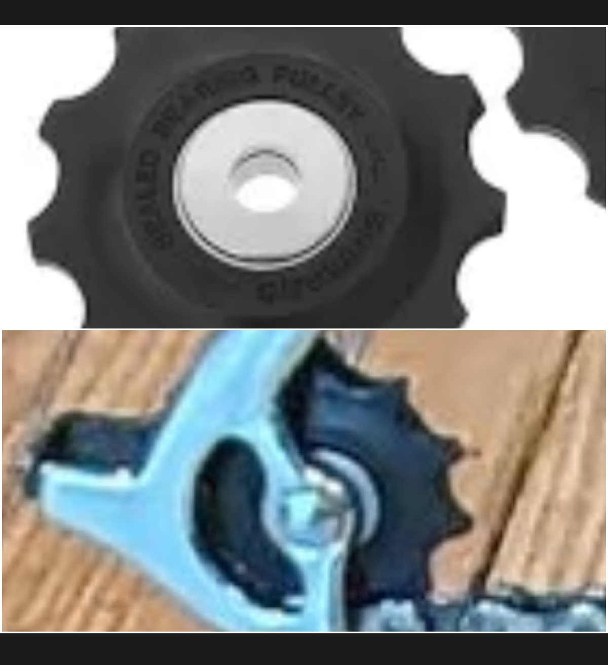

That's a pretty low end crank, at least the chainrings are (although nicer than the original equipment crank on my 1997 T500). I think that you might find something better to dress up the bike plus give you some lower gearing. As long as the derailleur is functional I'd keep it. A nice upgrade is replacing the original bushing style jockey wheels with new ones that have bearings instead (see attached picture). Jockey wheels have flat teeth when new. Yours are pointy, a sure sign of wear. Count the teeth and replace with the same number.
Looks like your pedal is missing the end cap. That will contaminate the bearings eventually. I'd also get a couple of stainless steel M5 screws for your rack holes midway down your front fork (available at a hardware store). The fork is made out of steel & you want to keep moisture out. All the screws should get a bit of Grease on the threads to keep them from seizing.

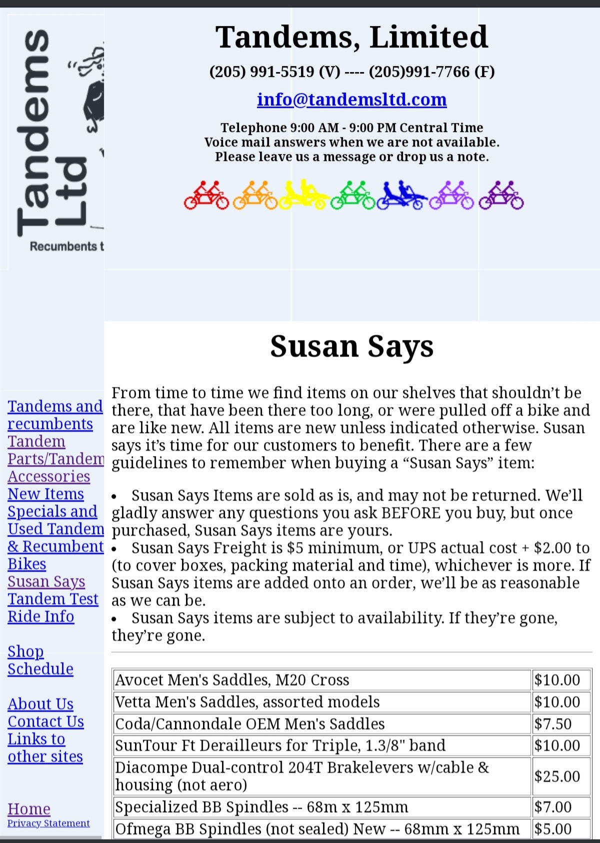

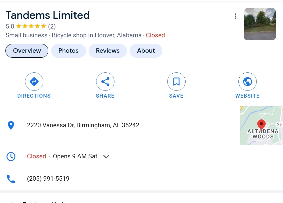

Seven speed cassettes are still available (try Performance bike online, or order the tandems limited catalog, they have some odd, and older, stuff for low gearing).

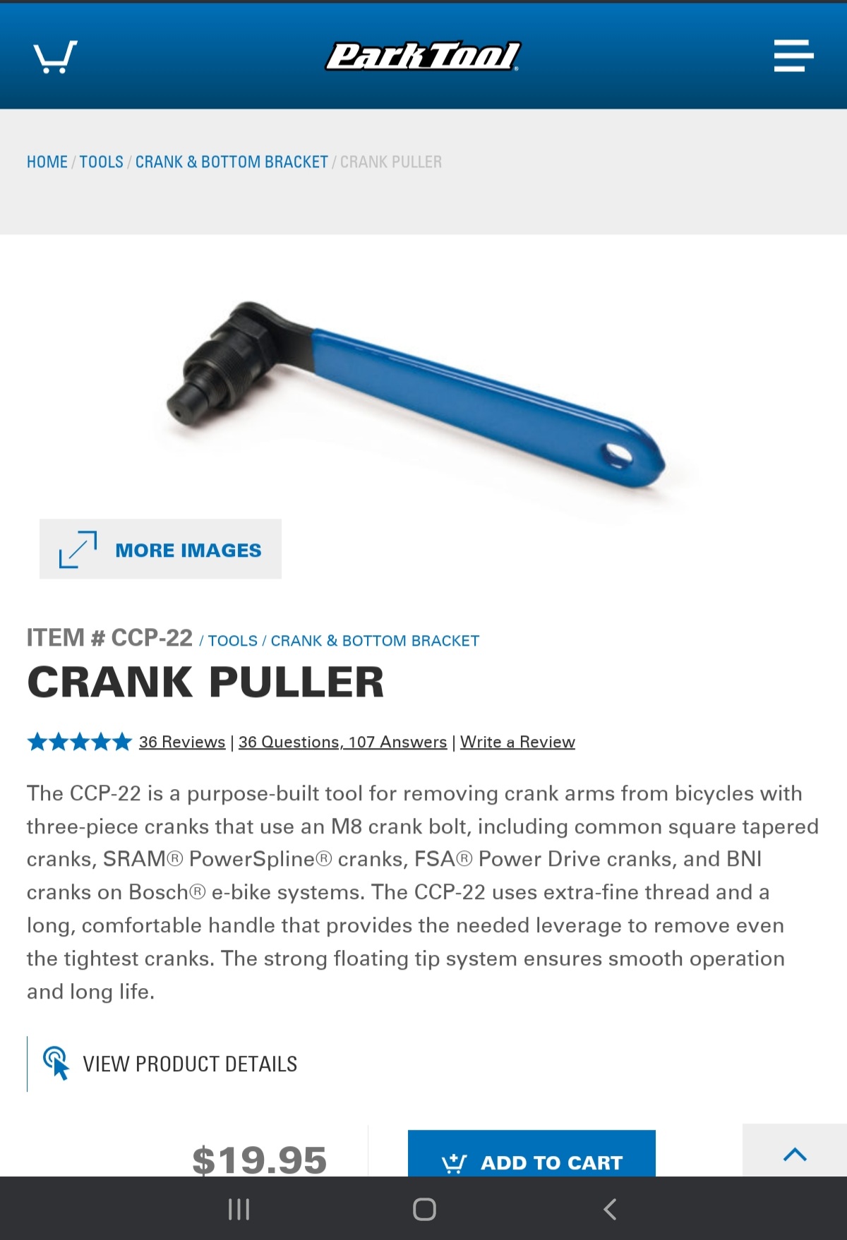

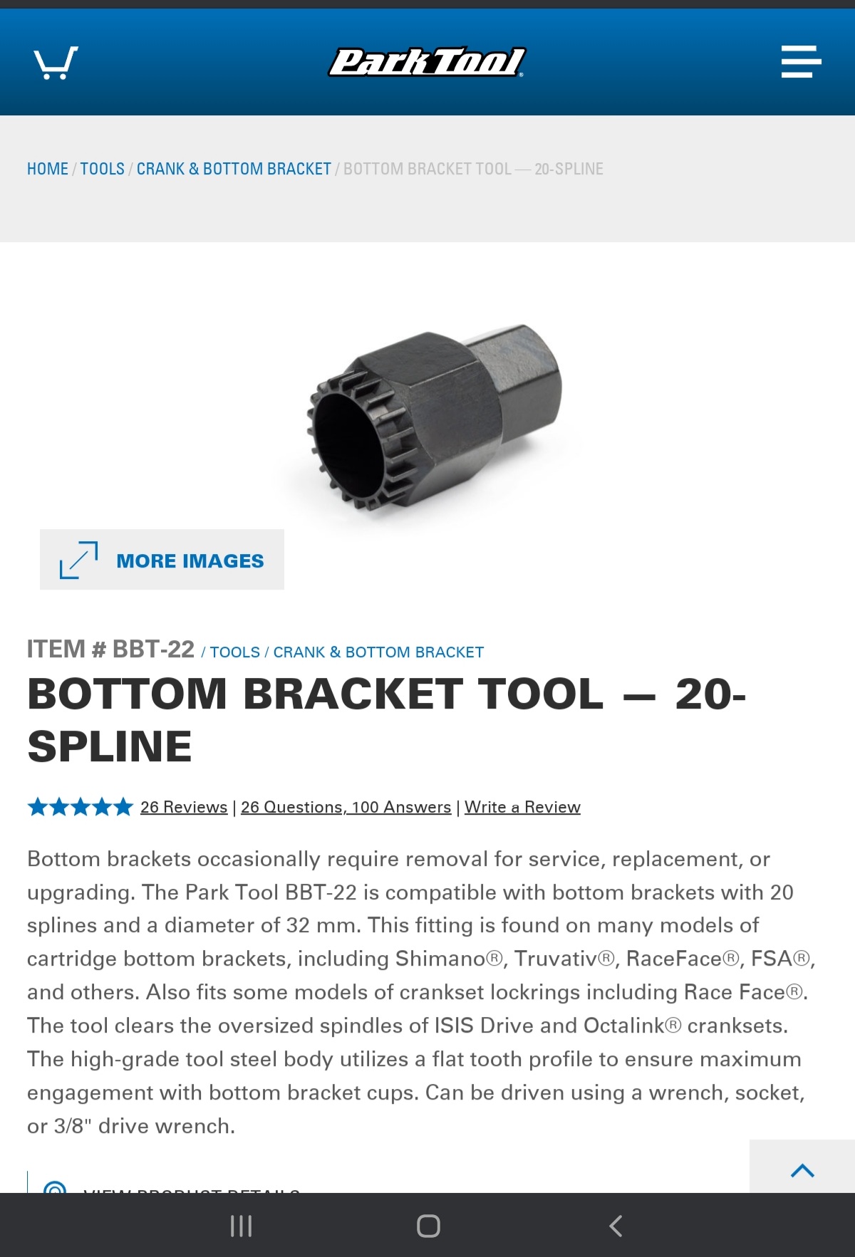

If you are mechanically inclined, buy a crank puller tool (I like Park tools) & a socket to install, and remove, Shimano cartridge bottom brackets. You'll get a lot of use out of them and save some money in the bargain.

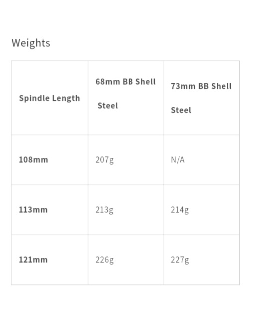

The lock nut for the hub should be easy to find if you want to keep the present rear wheel - if only for a spare. If my bike I would keep it pretty much original except for maintenance items. Bar end shifters would be a nice addition. The indexed 7 speed Shimano bar end shifters are getting hard to find but they do exist. Another option would be SunTour ratcheting friction shifters. I've seen them also branded as Raleigh and Schwinn. I'm pretty sure the Exage 400 crank used a 121 mm spindle. I'm not sure anyone makes one currently. You might need to replace with a 118 or 122.5 depending on how much clearance you have to the chainstay with the 121. You want one for a 68 mm British threaded shell.
Speaking of tandems limited, I saw they have a closeout on Cannondale Coda saddles for $7.50 a piece.

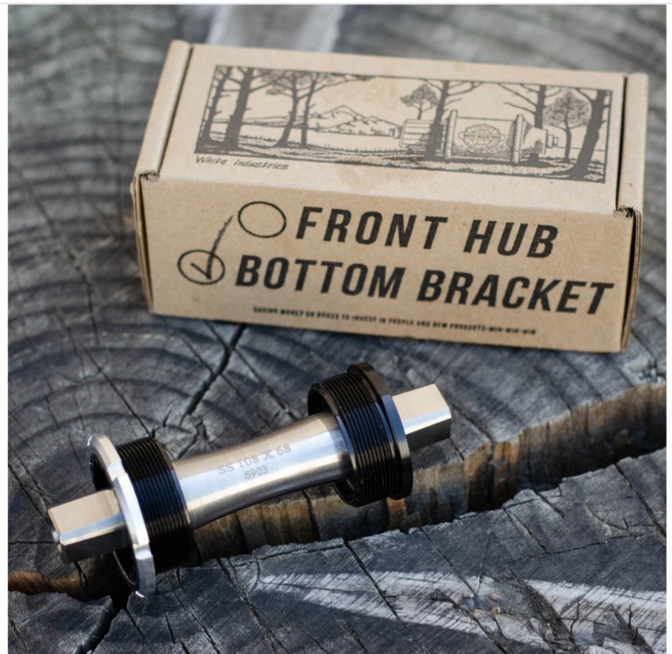

If money is no object check out the White Inustrustries bottom bracket. Made in California. Available at Rivendell Bikes.

What model of saddle? I couldn't find it on their site.
