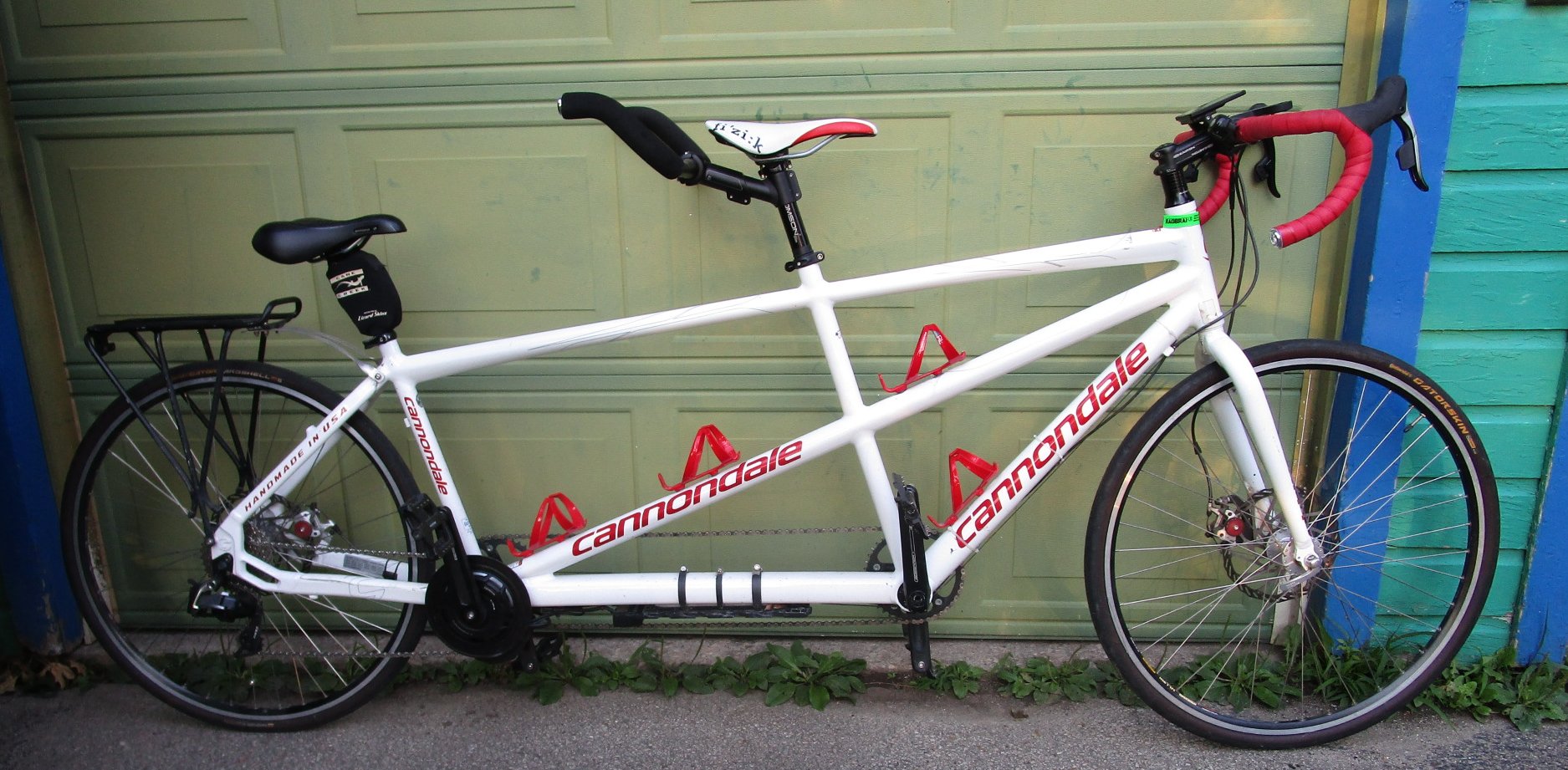

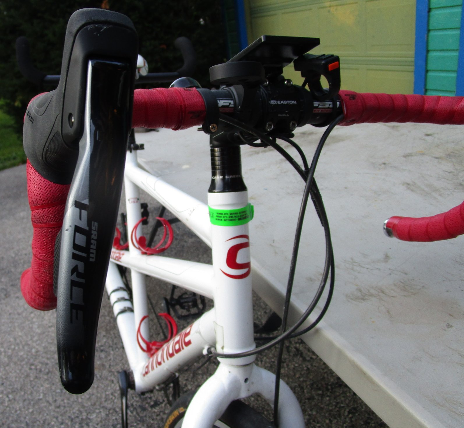

Just arrived. large Cannondale road tandem white with red decals, very distinctive.

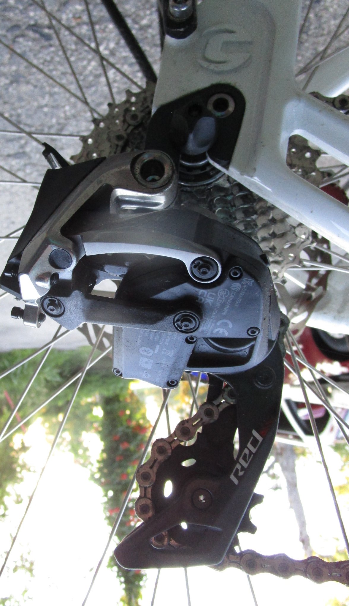

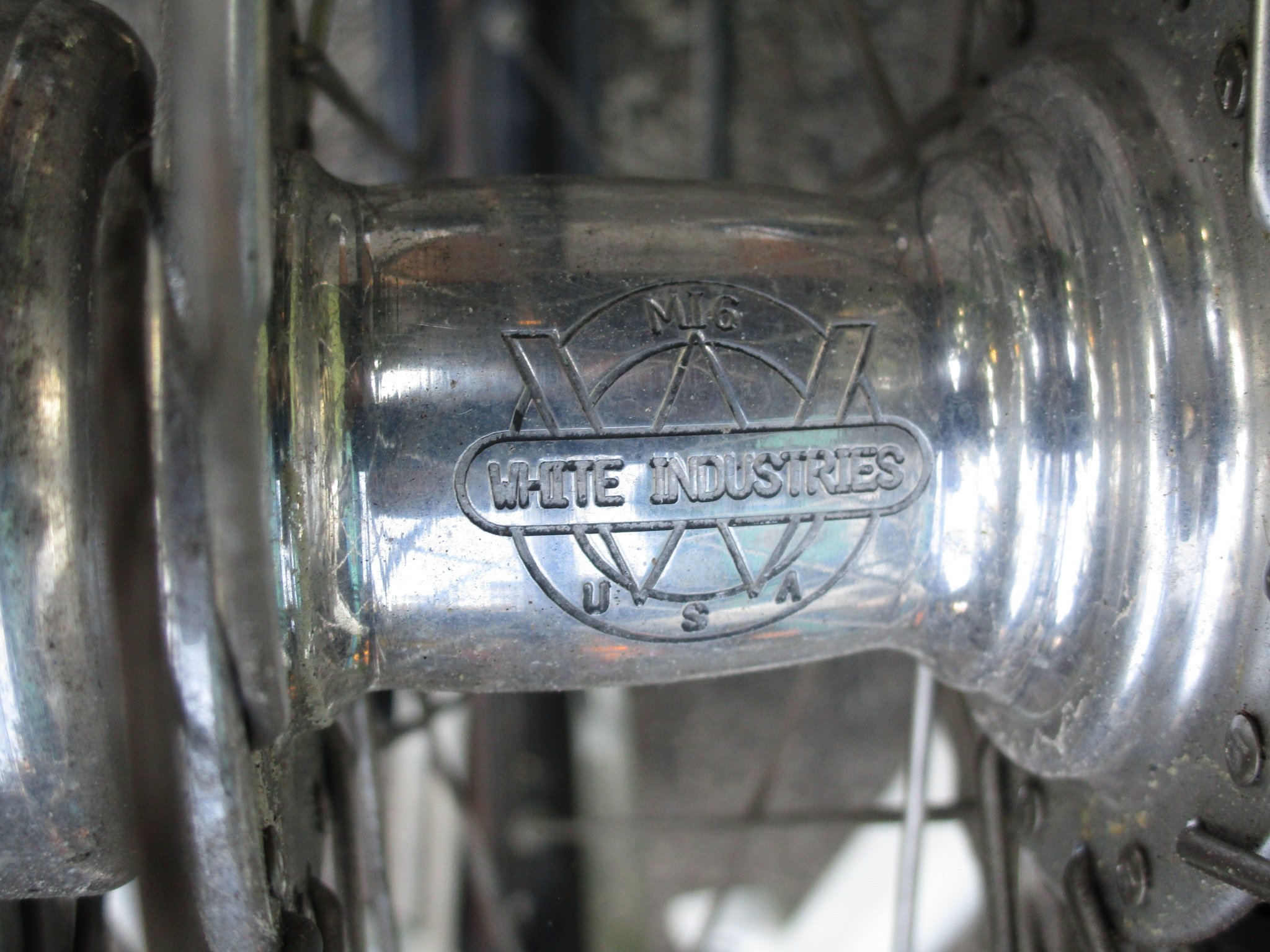

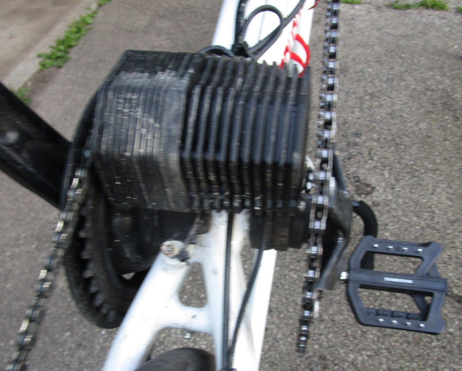

It had been converted to electric assist. Sram Red remote wireless shifting. Battery got water soaked (ruined). A new battery is some $750. Owner died. Donated to our local coop. I found the original shifters and derailleurs in the boxes of stuff that came with it. I plan on removing the electric drive and reinstalling the Shimano 3x10 Ultegra shifters. Two water bottle cages have blind nuts coming loose with paint chipped off around them. White Industries hubs that I assume are not stock so replacement wheels. They look very nice.
I talked to the owner last year and he thought it was one of the last made in the USA bikes so early 2000s?

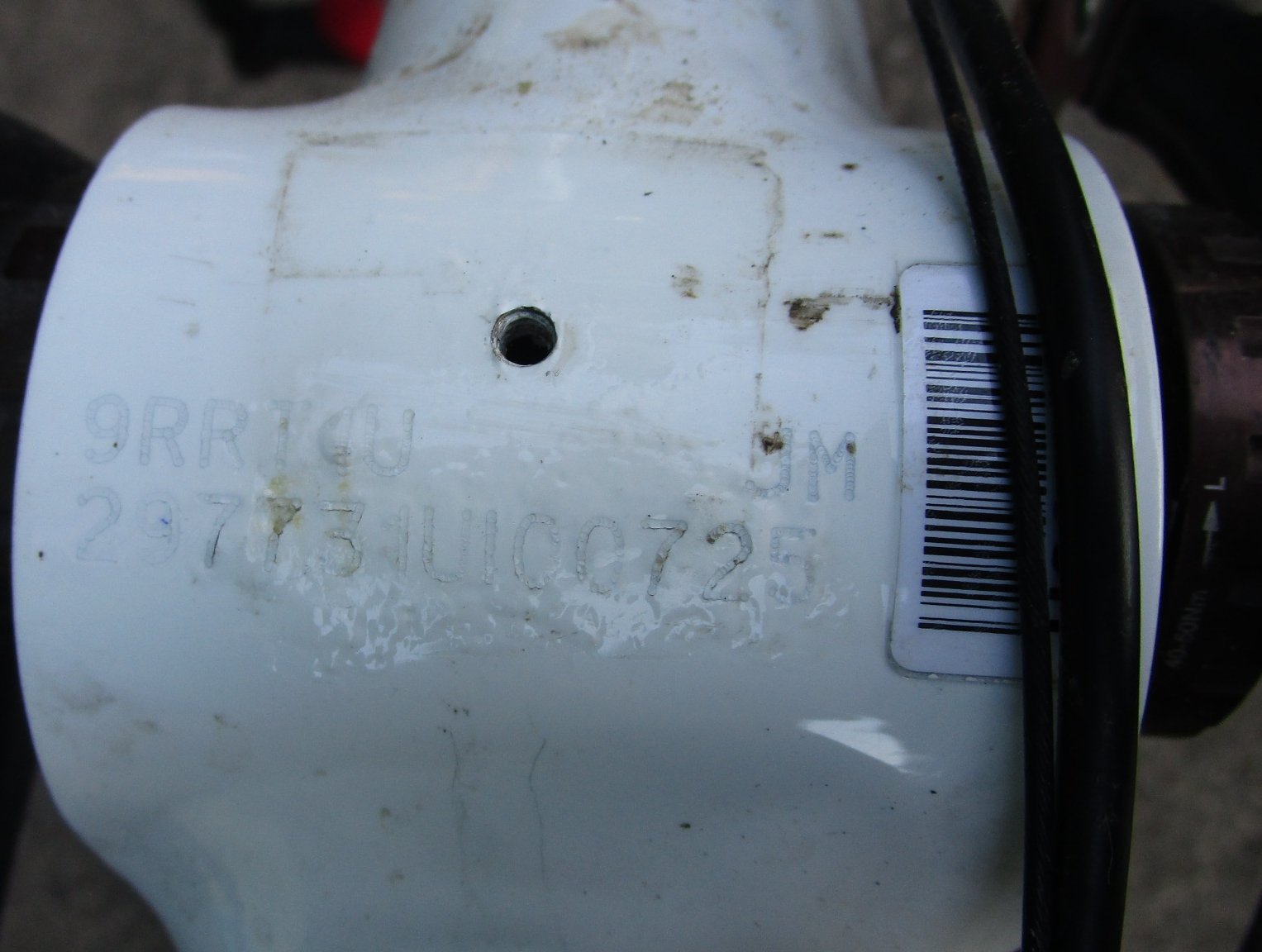

So what year?
Numbers on the bb shell.
9RRTIU JM
297731U100725
and a bar code sticker
U061755

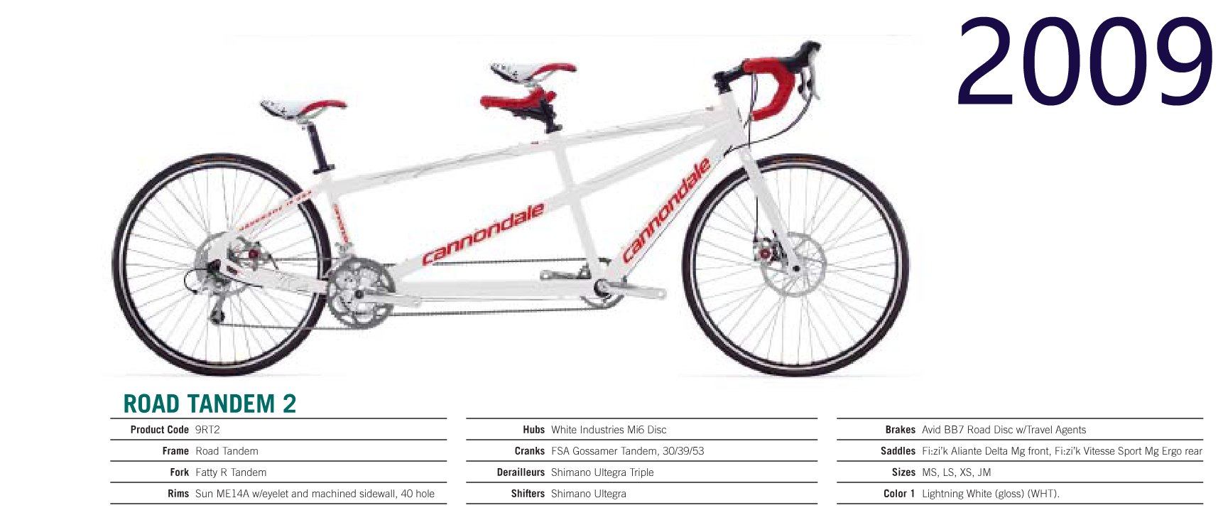

The bar code U is 2009. Matches up quite well with the 2009 catalog. White Industries hubs, Ultegra 30 speed, Fiziq saddles, etc.
