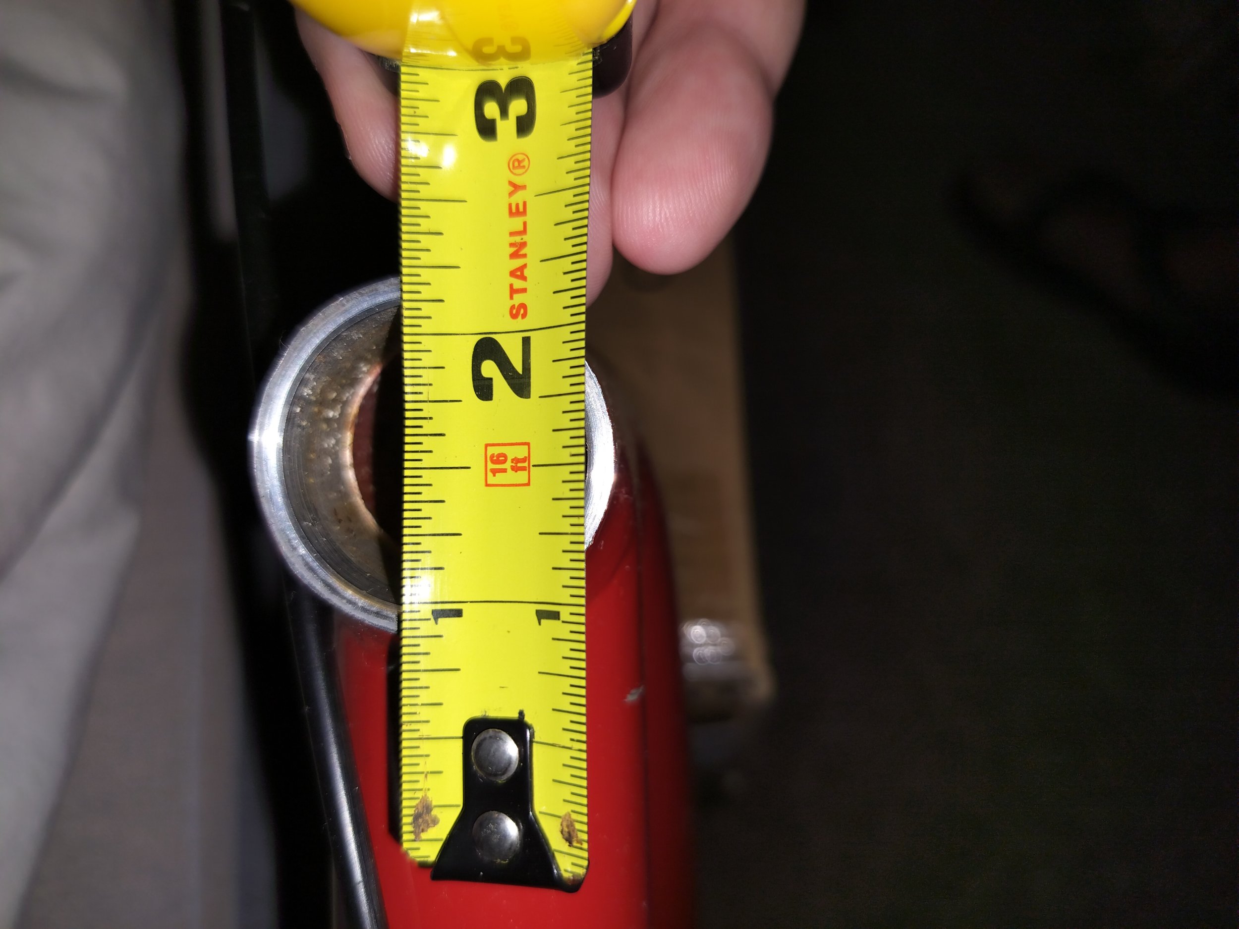

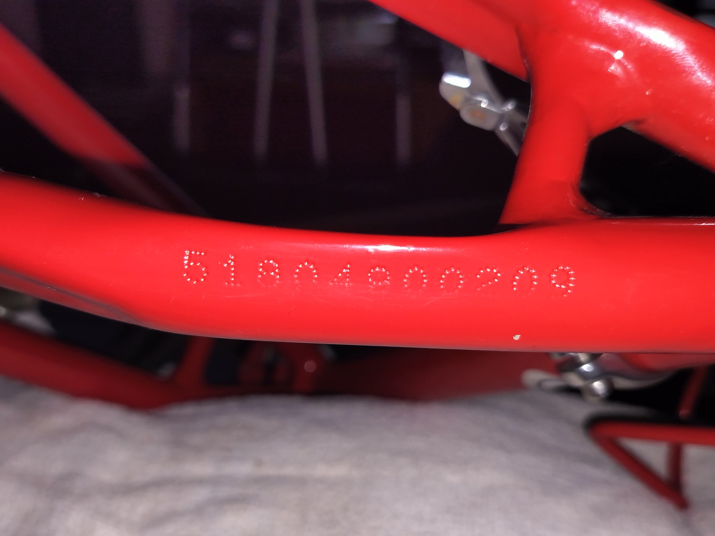

I am building up a 1990 Red Shred with cantilever stays and a 1 1/8" head tube. Now I've owned a 1988 SR400 for decades, and within the past few years have built up a small collection of MUSA models that I can now afford. Most stay entirely OEM stock. This one however was bought as a frame only. They are very rare, and my example is in very nice shape; paint is shiny and is still intact for the most part. Most importantly it is my size. I'll be damned that it has the 1 1/8" HT, I could've sworn they still had a 1" in '90.
