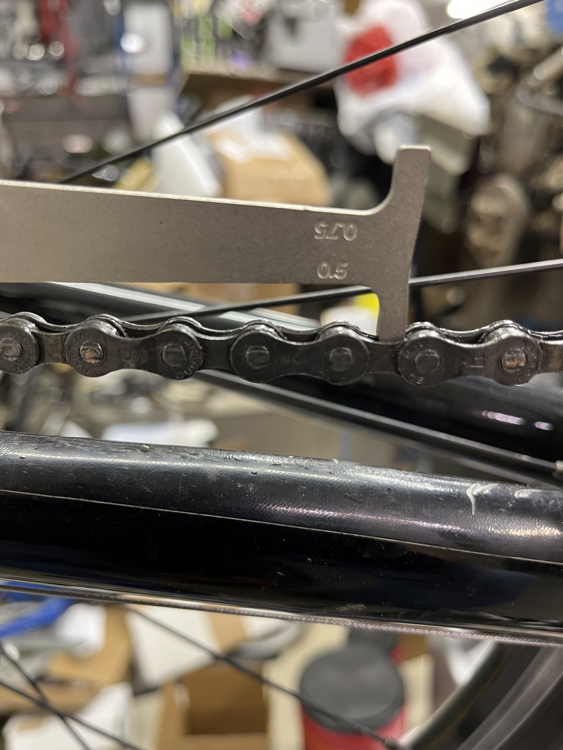

Hmm, no I don't think the derailleur is moving. Because I've gotten off the bike and lifted the rear wheel with one hand and pedalled with the other and the chain returns to the previously selected cog. But the jockey wheel portion of the RD is usually pulled forward. Chain bind of some sort. The cogs don't look worn to me and the chain passes the chain measuring tool test.

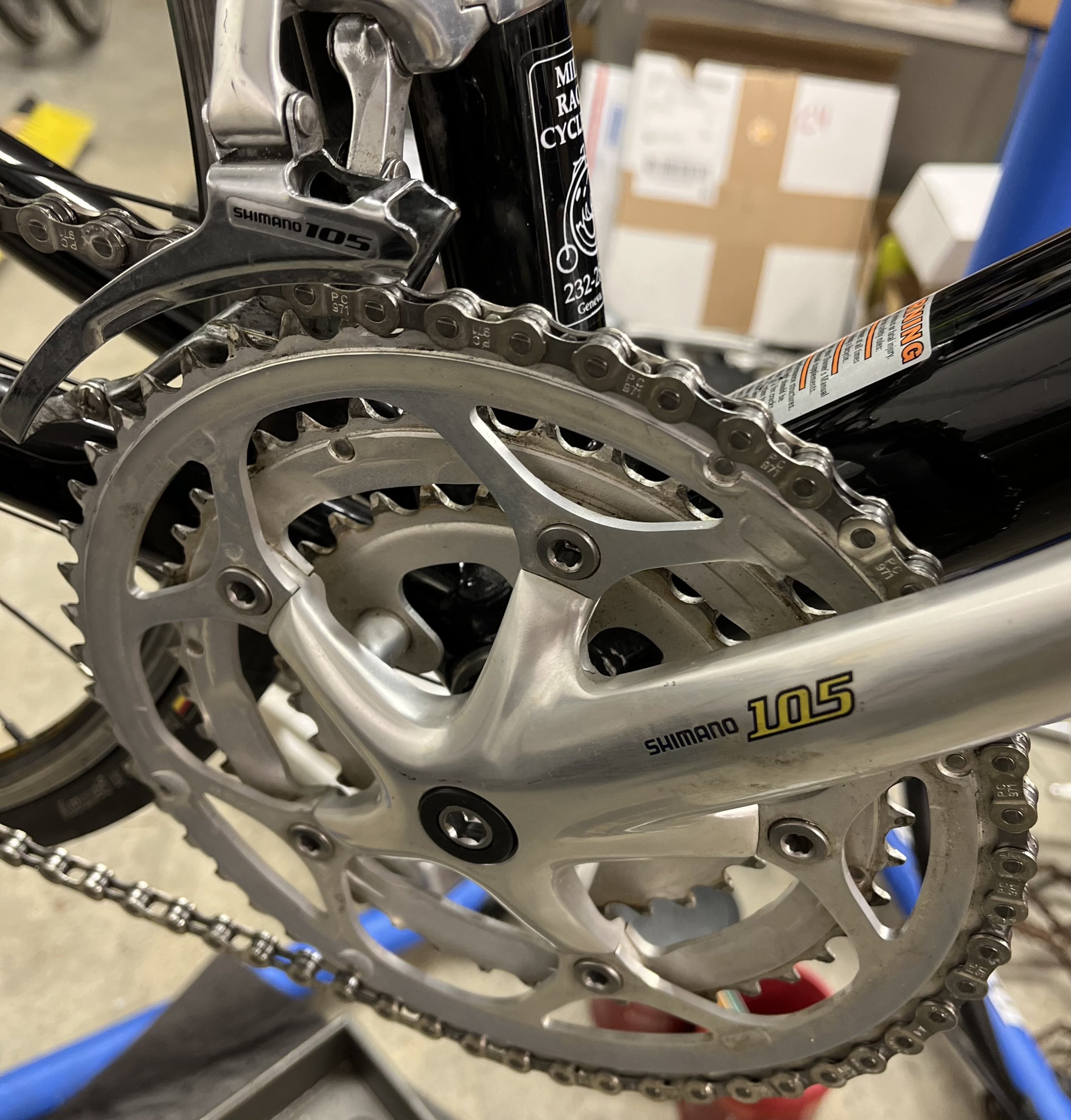

I've been planning an upgrade and believe I've got all the parts; 105 brifters and triple crank and a SRAM 9 speed cassette. I wanted the identical gearing as my '04 R500 (the race bike).

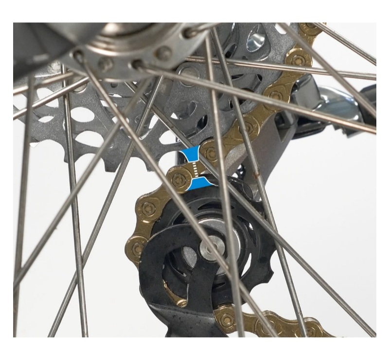

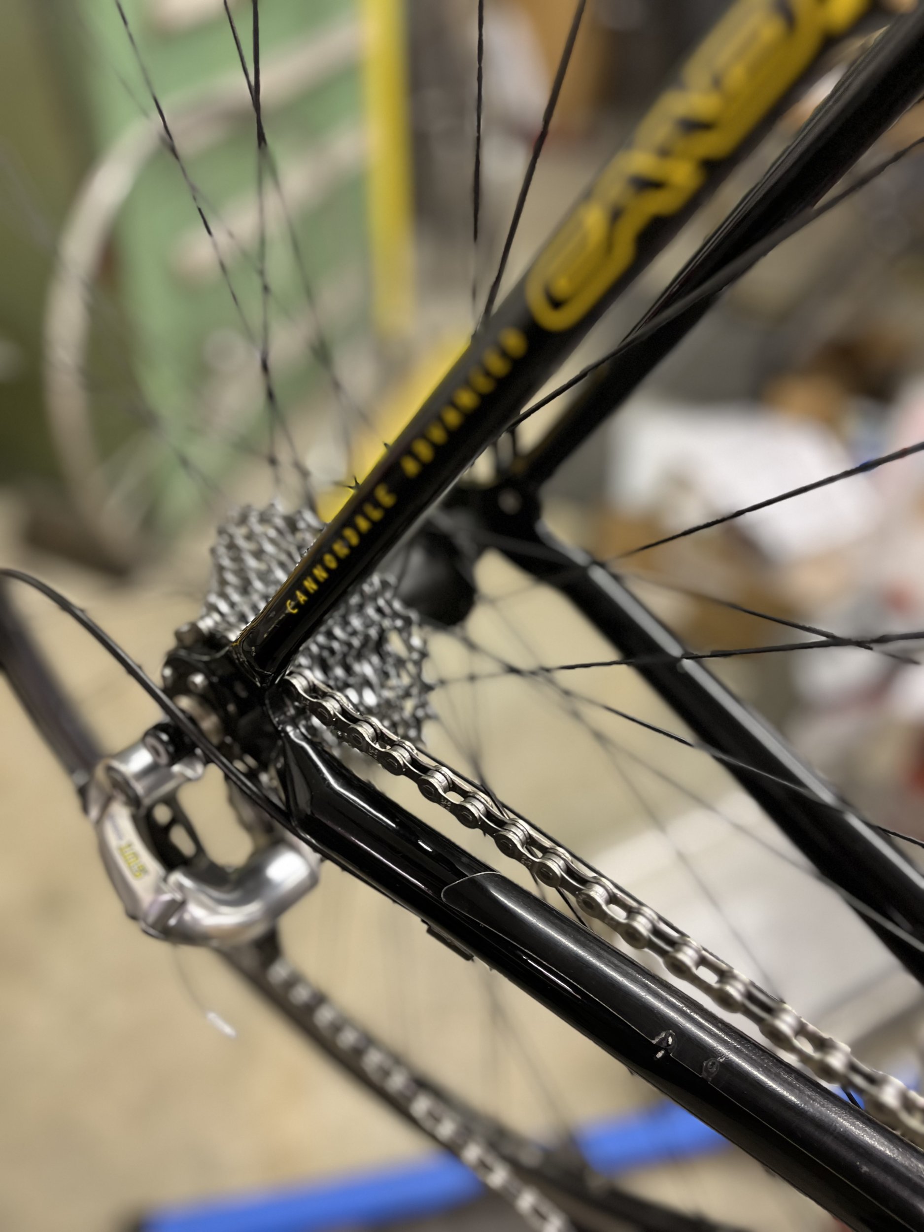

Is the B-screw adjustment okay?

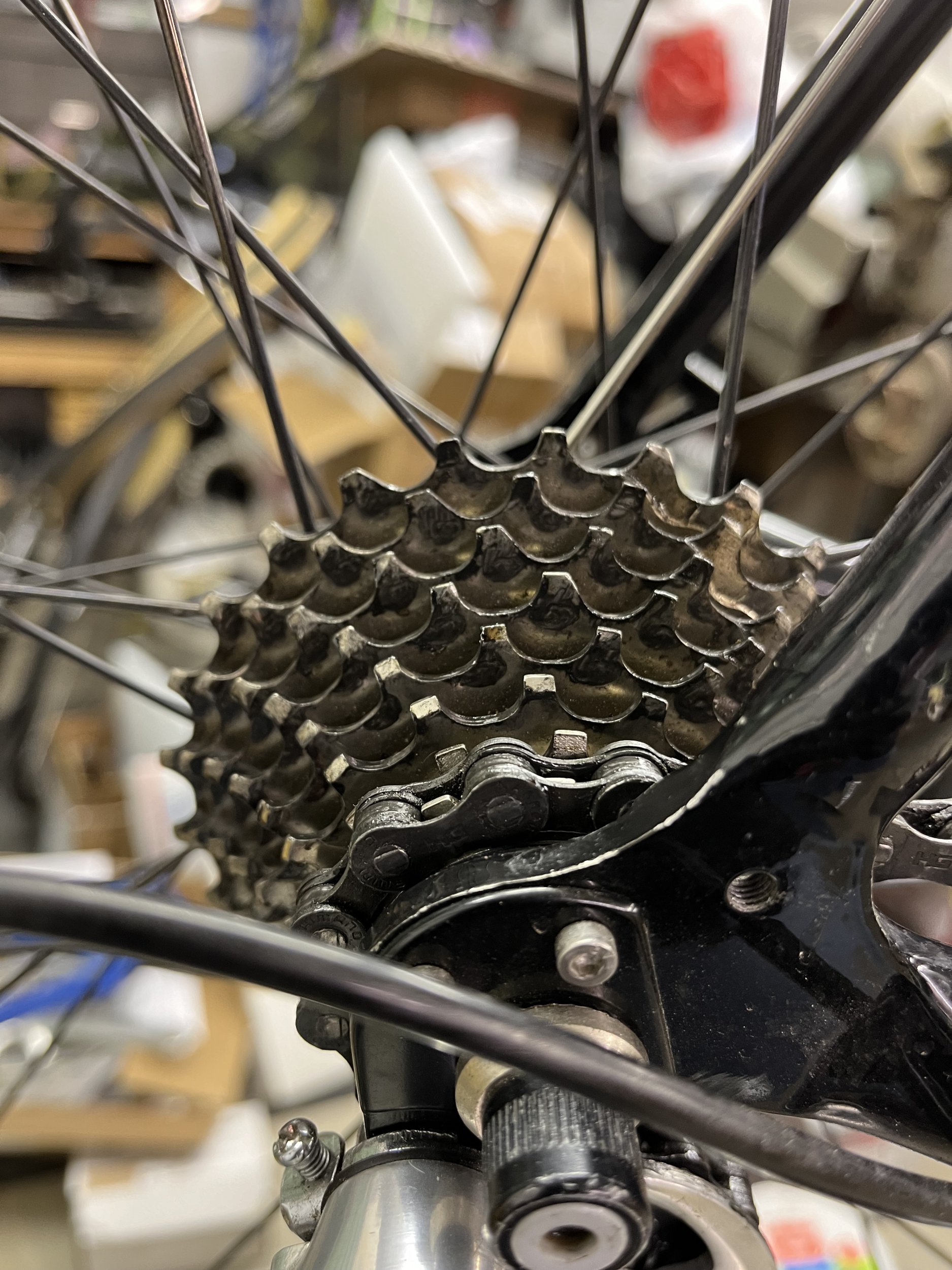

I have not checked the B screw lately. Will do. Thanks.

Chain is good. Not at the .5 wear indicator yet.

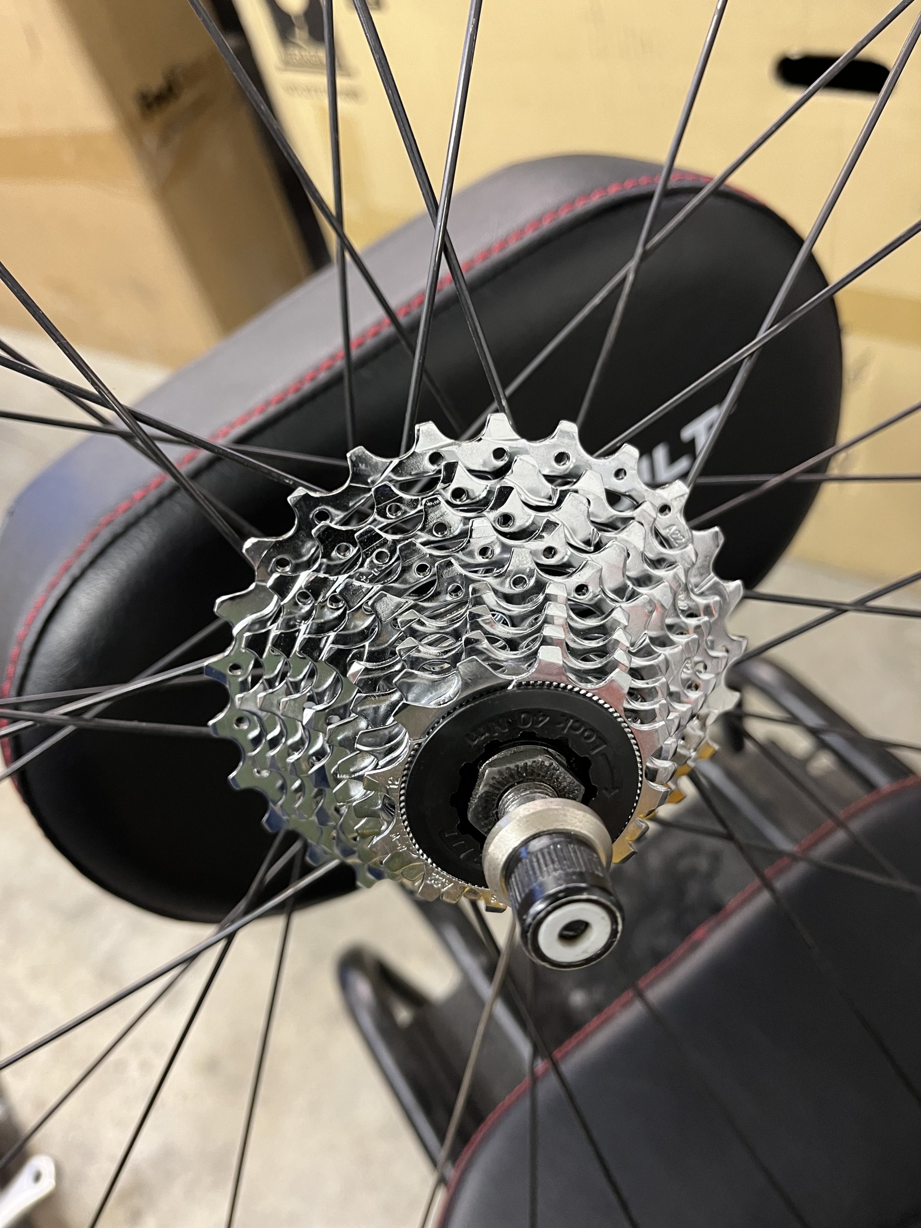

Buuuut, I do see sharks teeth on the cogs. Guess my eyes weren’t trained enough awhile back…

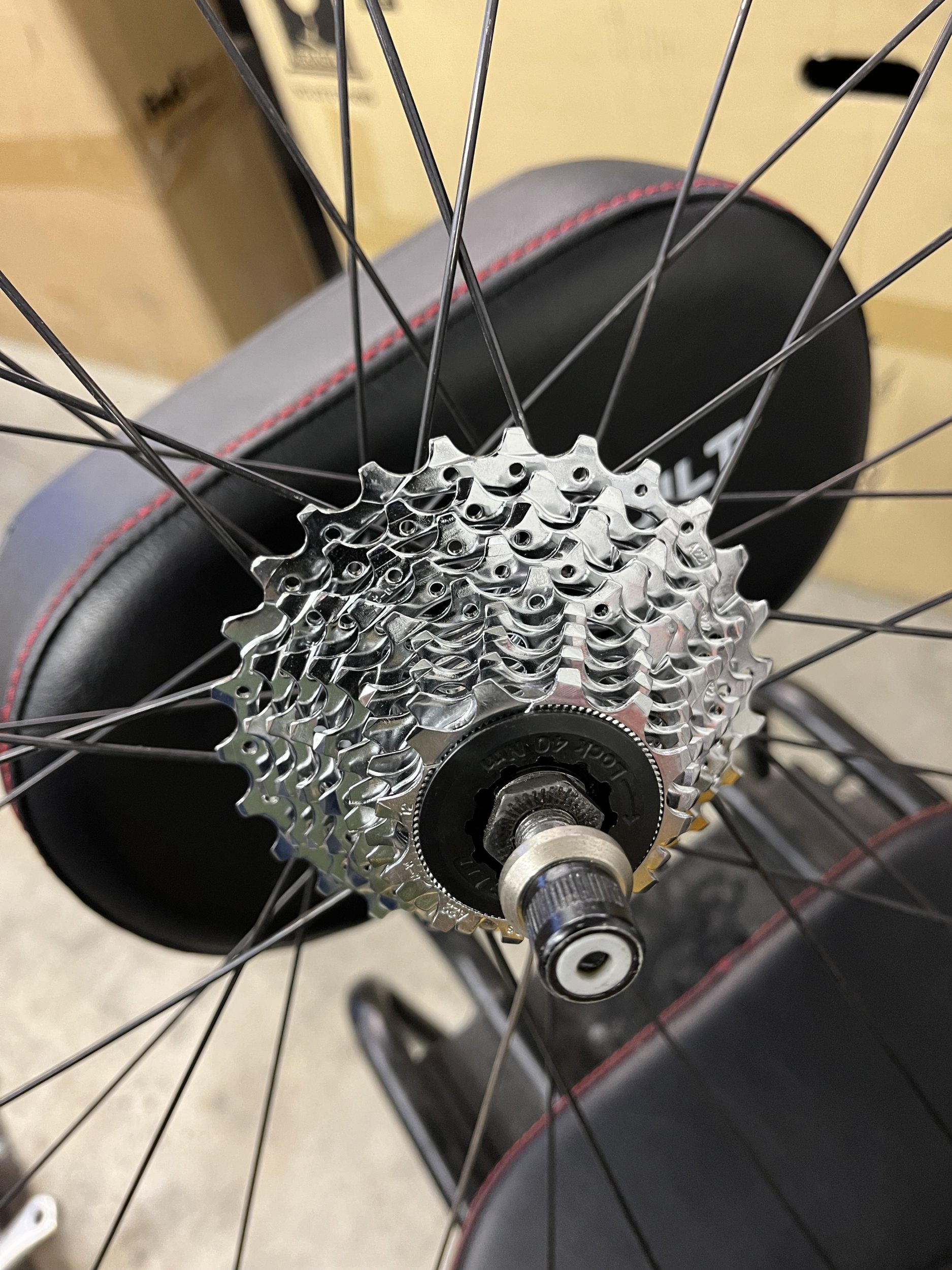

I do have a new cassette @black lightning 1987 it’s a SRAM 9 speed. It is part of the final mods that I plan on doing soon. I’ve slowly been converting the bike over to 105 components. Just the brifters and crank assembly remain. Those parts are awaiting in a box in the shop for me to get around to installing them…
