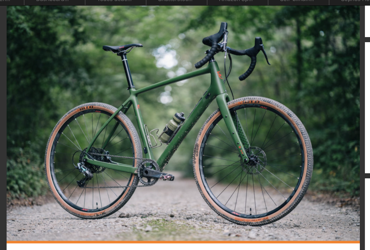

I don't really know about what wheels, but if you have a look to the pictures I just attached, you will get an idea of what I want to make. I would like to add a MTB or more BMX handle bar like instead.
The frame is in very good shape (dark blue with its Cannondale stuff) and I am also considering painting it to get one of a kind.

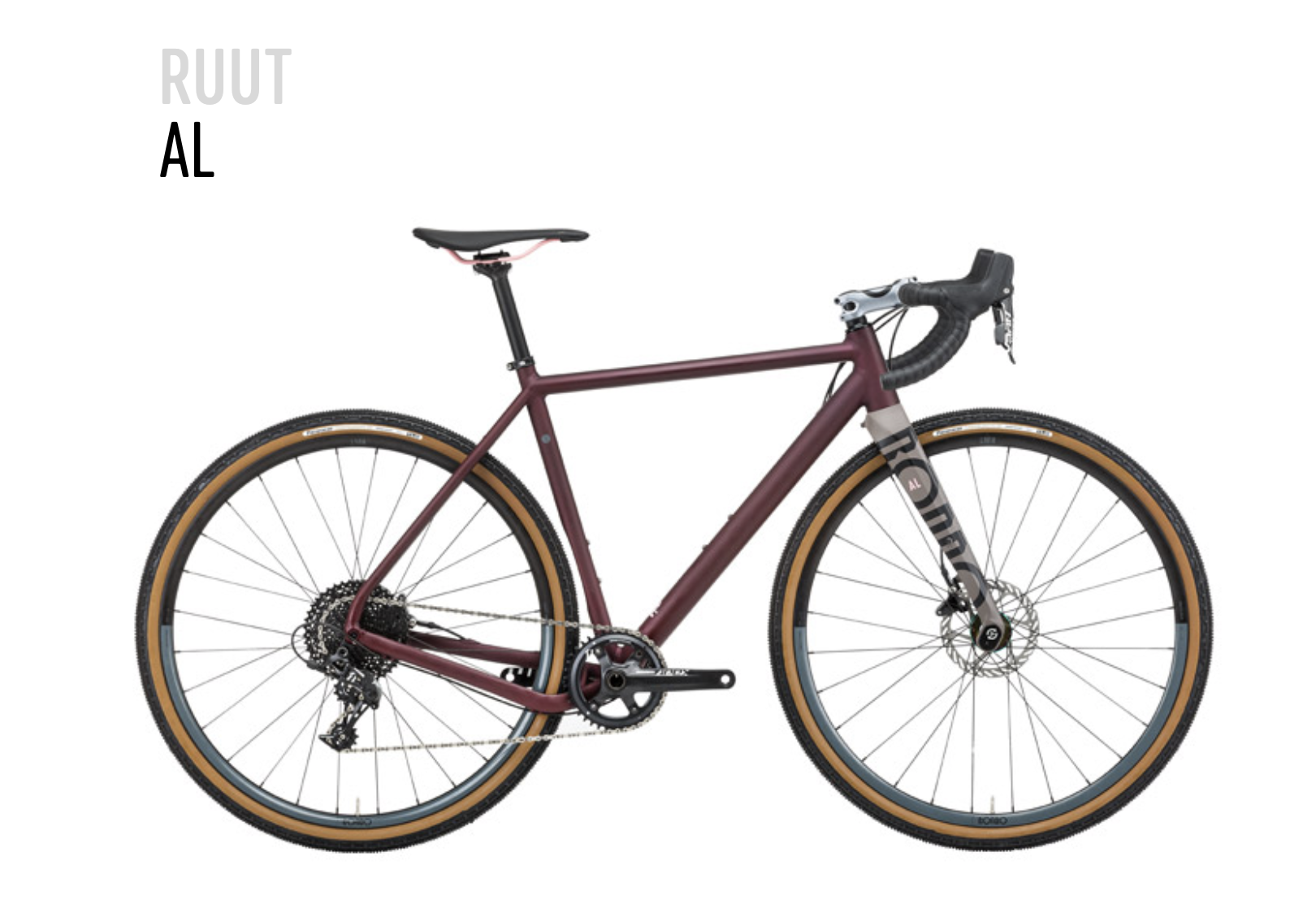

Another inspiration for me has been a Rondo bike that one of the guys is having (Ruut Al), you have a picture attached. And I just love it!

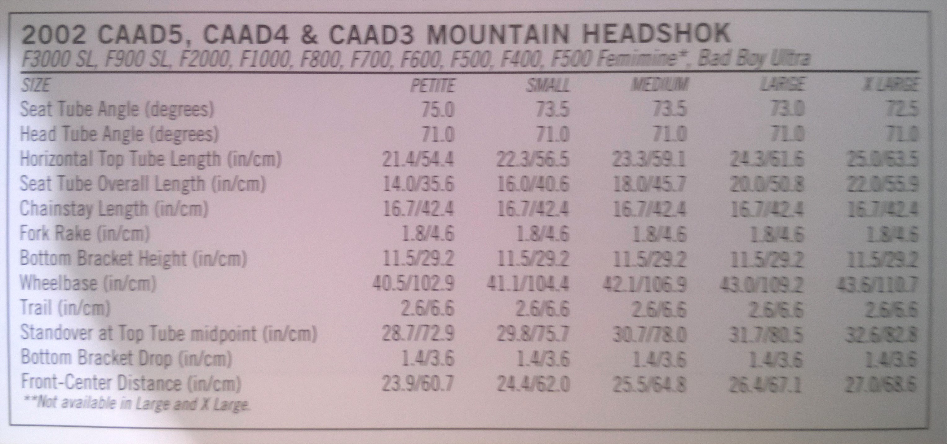

Here is a photo of the 2002 Headshok frame geometry chart. 2003 is the same. There are almost limitless ways to build a gravel bike. I still like to use a triple or sub-compact crank and 10 speed wide range cassettes. Lots of folks are going 1X with the modern SRAM and Shimano 40+ T cassettes. For cold weather riding, I like bar end shifters, as they can easily be shifted with heavy mittens.
