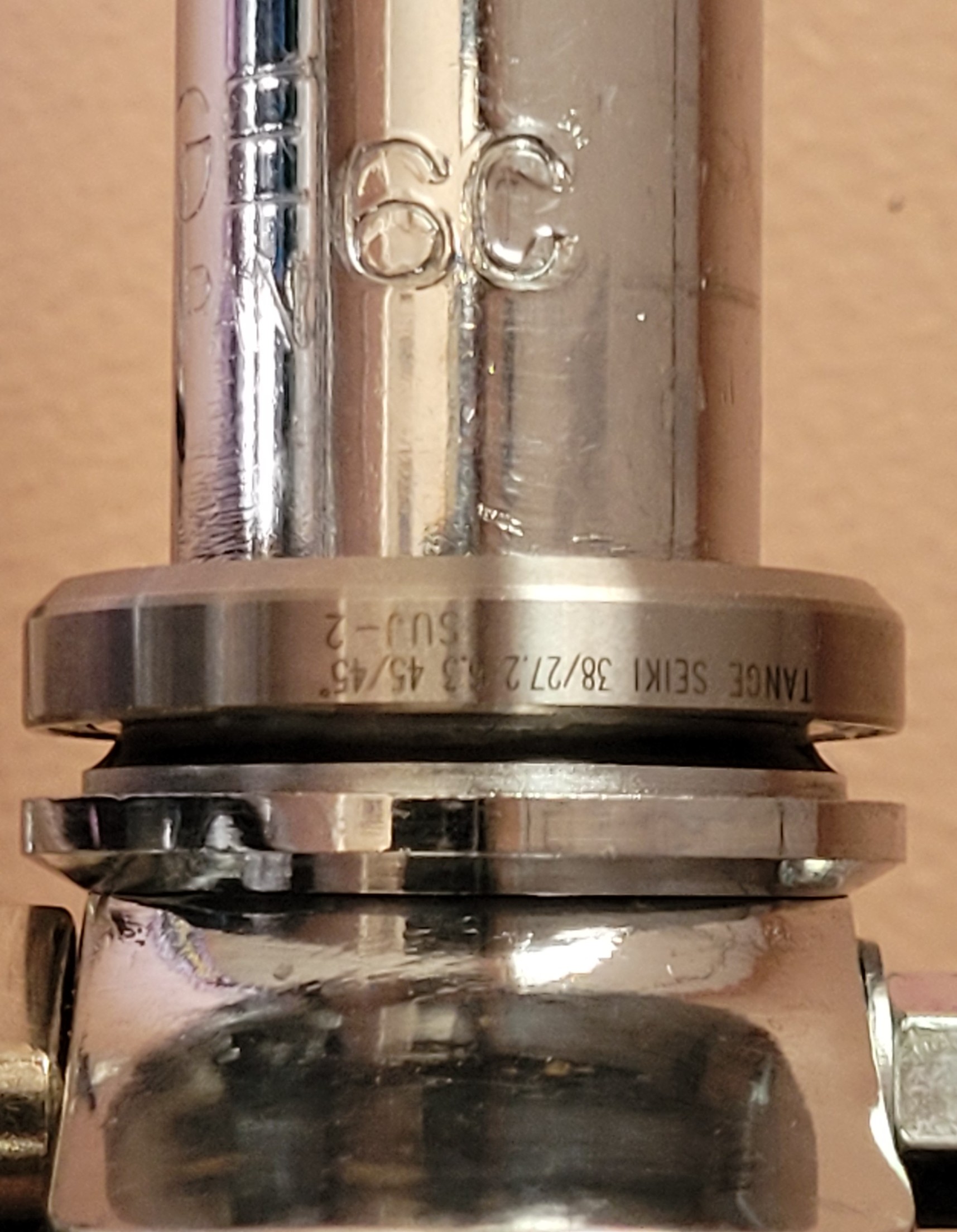

The headset feels lumpy because the races are brinelled (hadn’t noticed that before), and while I could yank the cages and pack the races with a different count of loose balls I’d really prefer to get sealed bearings. But the stack height’s only about 33 mm and it ain’t easy to find a sealed bearing headset anywhere close to that. I’d hoped that the IRD Technoglide would work, but the bearing it comes with doesn’t seat well on the race of the fork (photo attached). AFAICT my options are to recut the fork to match the bearing (I have access to a lathe), keep looking for a set that works out of the box (I’ll contact Tange and ask), or hang it all and just replace the old headset with a new Tange Levin CDS.
Do you have any history on the chrome fork?
The marking on the tube is TANGE 6C MADE IN JAPAN.

@letsbike , I just noticed that "TANGE-TR-R" is stamped around the dropouts, and eyeballing with a ruler the rake's about 45 mm. Factory documentation says the original fork was supposed to be a Tange 124B with 54 mm rake, and since I've gathered that 6C is a date code indicating March1986 it's pretty obvious mine can't be original.
And of course I finally realized that my difficulty with the race might be resolved if I, you know, pulled the old race off and replaced it with the one that came with the new headset. Damn, I always used to hope that someday I'd never be a dumbass again. I tried using a box cutter blade as a wedge to get it started, but just effed up the blade. It's on there really tight, so I'll just have the shop do it.

And don'tcha know, it turns out that the crown race ID is 27 mm, so it's JIS! Snap... looks like my options are
- Find a 33mm stack height JIS headset to match the existing fork.
- Take 0.3 mm off of the steering tube shoulder so I can use the IRD Technoglide headset.
- Find a new fork with a 183mm steerer, 45mm offset, sized for an ISO race.
Aaaaaand the flats on the motor axle are exactly 10mm apart, so it won't quite fit into the 9.4 mm dropouts. Hmmmmmm...
There's not enough meat on the axle to bring the flats 0.6 mm closer to each other. I've got a torque arm to manage the motor reaction so unless I can find a new fork I'm thinking I'll open the dropouts up and chuck the steering tube in the lathe to take down the shoulder so I can press the race on.

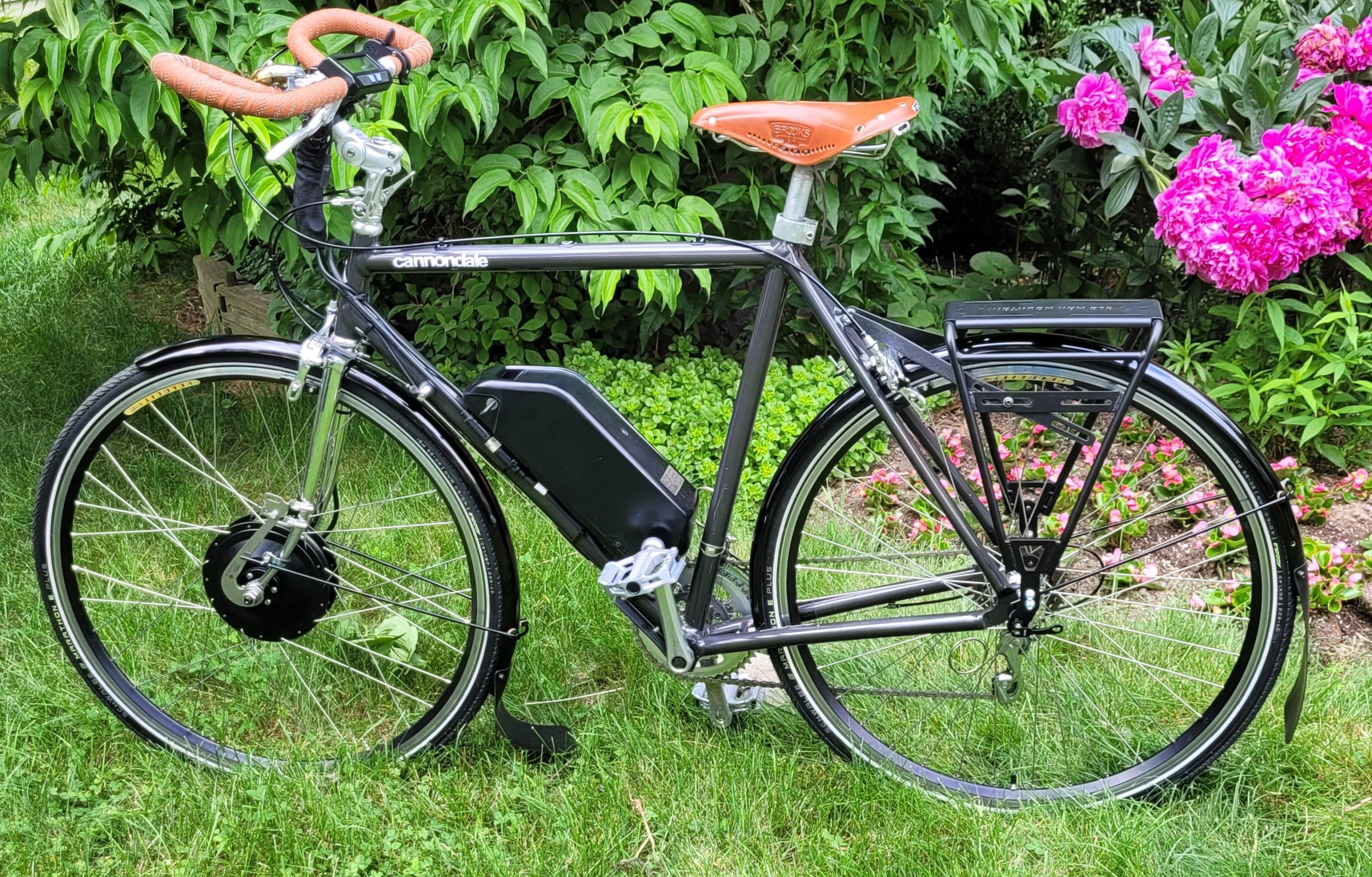

I've made a lot of progress, still a bit of cleanup to do and tweaking the motor output but I think it looks pretty good. Matt Assenmacher's a good guy, his shop's got a bunch of cool stuff and he got the fork done in a couple of days for a very reasonable price.
I did go with the Velocity Dyad rims, and got a set of Schwalbe Marathon E Plus 37-622 tires. They're about as big as could possibly be fit in there, and getting the fenders in took a lot of trial fitting and some grinding down of the fastener heads.
Got a brand new Brooks B17 Carved for 100 bucks off of facebook marketplace. I like it. Will probably start looking for a good suspension seatpost.
I have a set of Carradice SuperC panniers and Carradura bag for the back. Still need to fabricate an axle mount for the front rack.

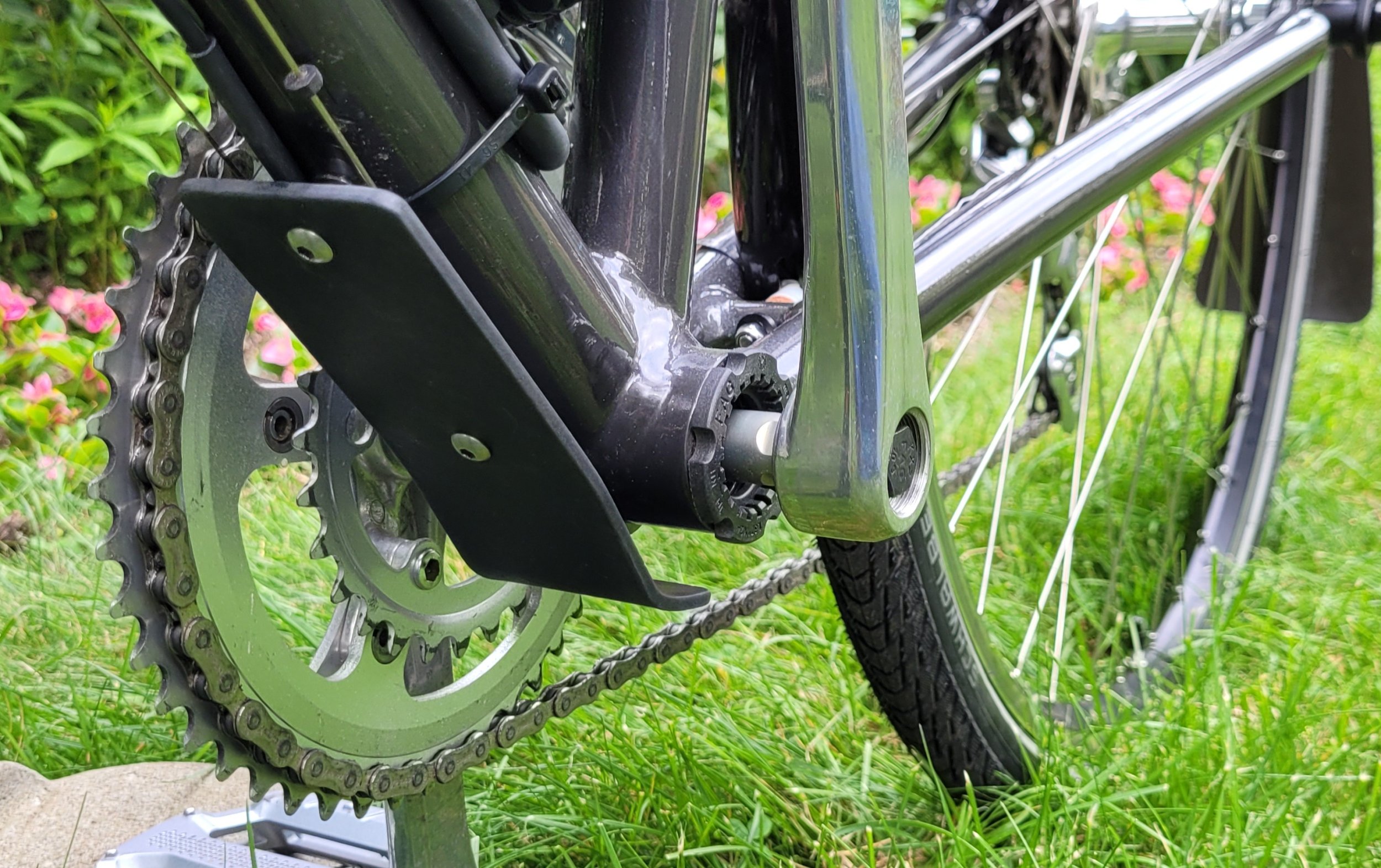

Aluminum shield for the BB torque sensor wires.

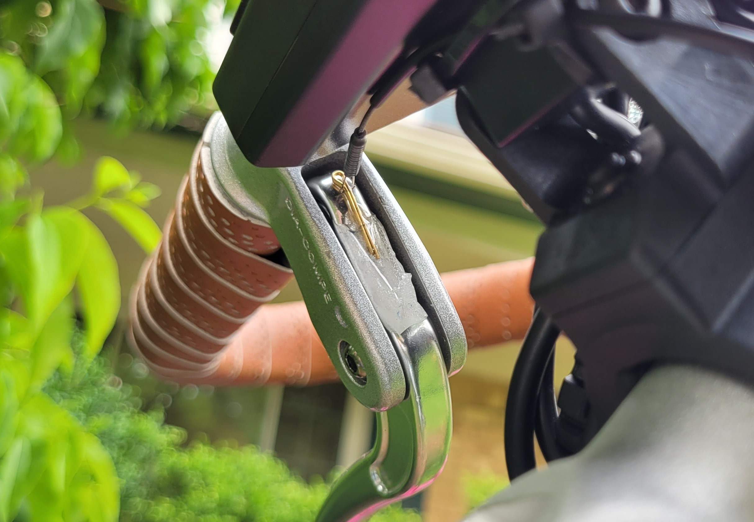

I epoxied a brass cotter pin onto the front brake lever to connect the cutoff switch, it was the best way I could think of to maximize travel without interfering with operation or having a tight bend in the cable

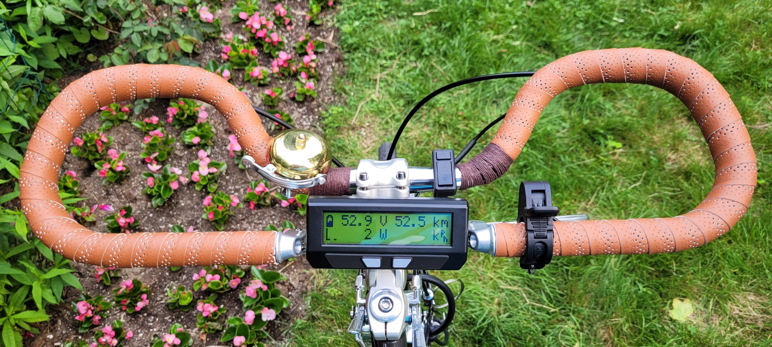

The Cockpit. I have a cell phone mount that I want to try to fit in there somewhere.
