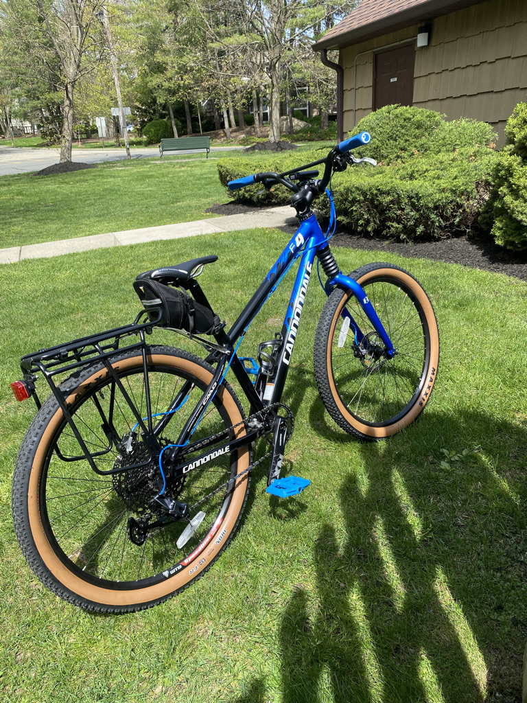

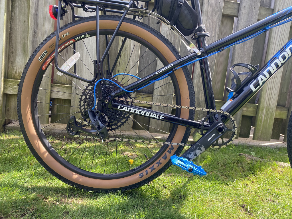

Well, I got my bike back from the shop, new drive train installed and it's amazing! No problem with peddling uphill and the bike just feels great. The only thing is after the 3rd ride, the gears seem to be slipping and not shifting smoothly. Possible needs the tension adjusted, which I will do and report back. I do have to bring it back to have the fix a stupid little thing they did. They zipped tied the shifter cable to my bike rack instead of running it straight to the derailleur (you'll see in the picture).
OMG The bike looks great!!!!!The blue Jagwire cables and brake housings make it even better. I agree that I think it was silly of them to route the shifter cable to the derailleur like that.It should be a straight as possible. The derailleur wont move as much as they have given you slack for. Have give it a nice gentle arch with about a 1/2 inch up or down and it will be fine.. Also, from what you said I also think that you are right on it needing to have the cable tension adjusted. If they didn't ride it after setting it up, it's very easy to get it really close but it still needs to be fine tuned while riding. I had to turn the adjustment about a quarter turn to get mine dialed in just right.
As a final note. I told you that you'd love how much easier it is to ride with as much gear range as the 11-50T cassette has.
Looks like the rear section of housing could be shortened by 2 or 3 inches, but I have no experience with SRAM post 10 speed.
Sounds like it will be good once the final adjustments are made and the bike looks great. Glad Johnny was around to make recommendations on this newfangled stuff.
