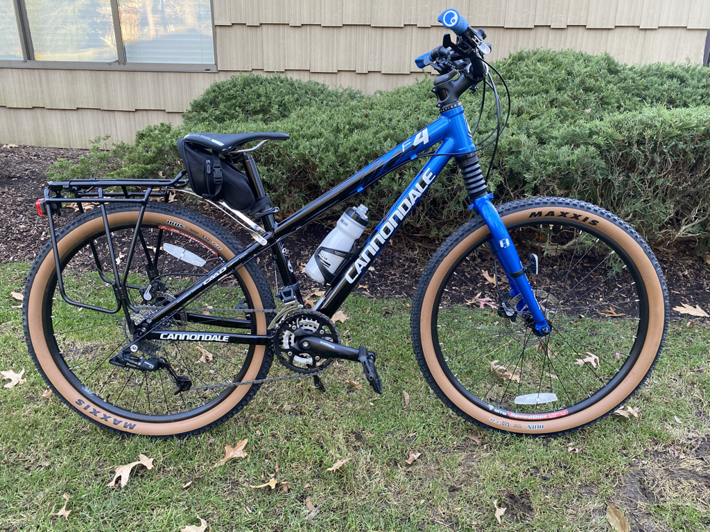

I am looking to convert the 3-front/9-rear drive train to a single front/11 or 12-rear with a new drive train groupset on my 2008 F4 CO2 SL hardtail. Any recommendations? I like SRAM but not sure what is compatible. Thanks!

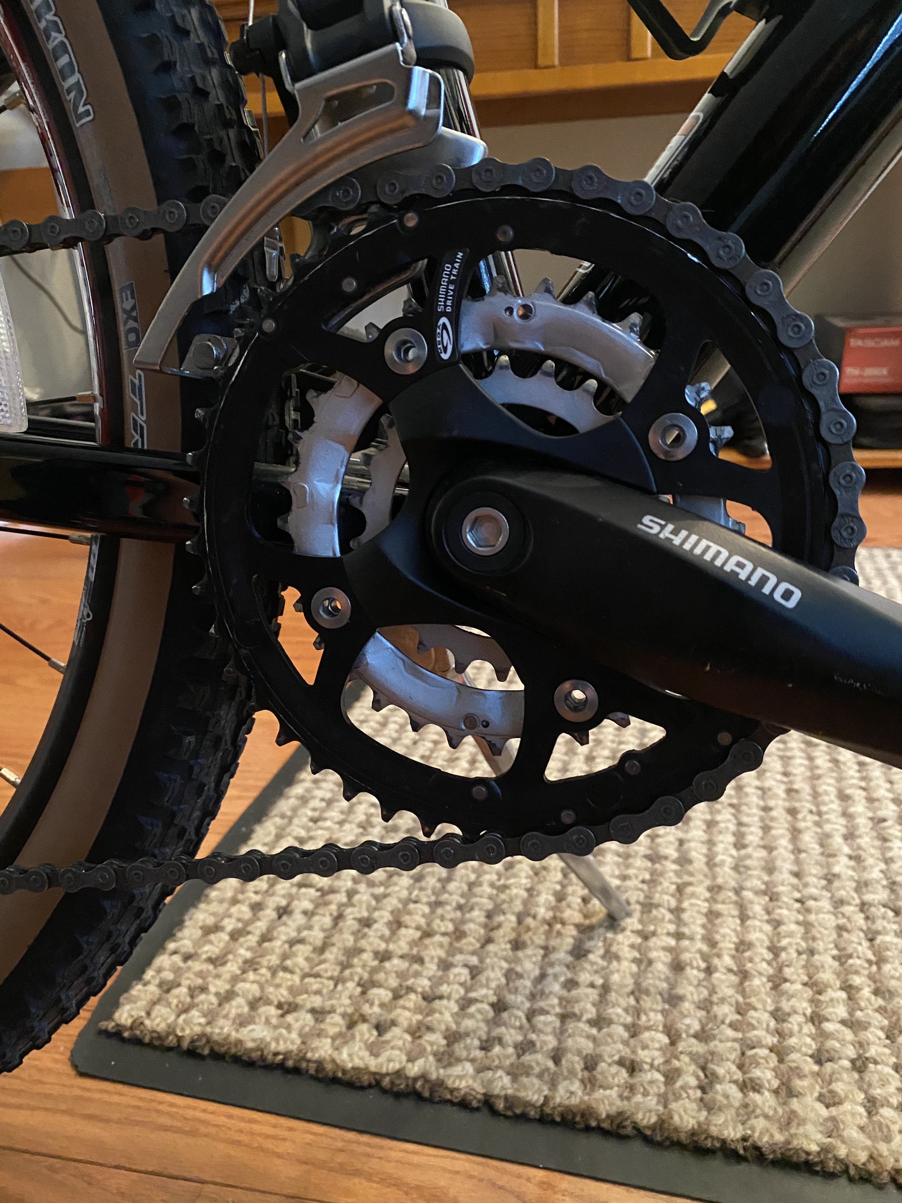

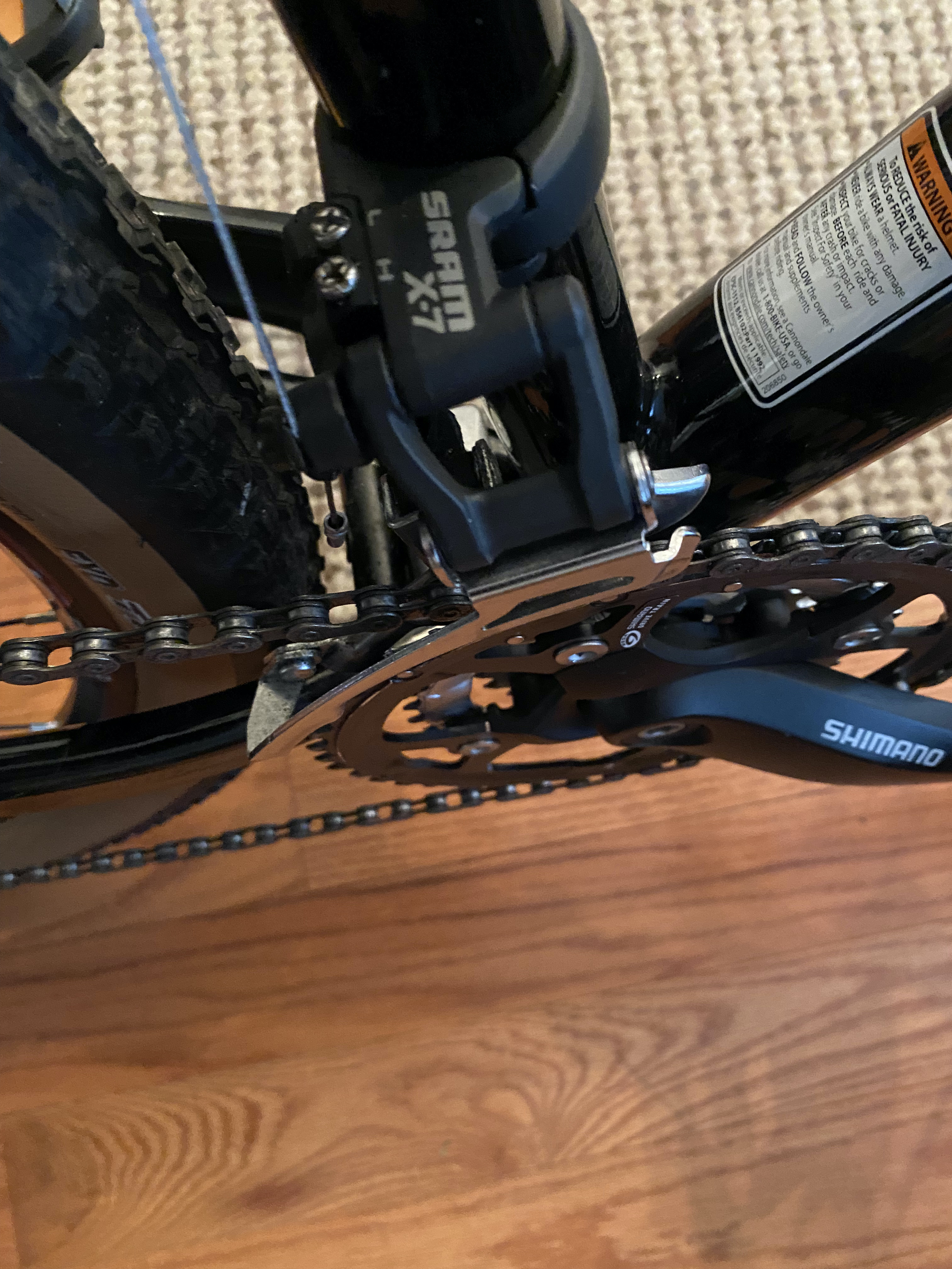

She cleared up why she is interested in it to me the PM I sent her. In a nutshell, The SRAM X7 has never been really dialed in on the front, despite two bike shops having tuned it. So she pretty much keeps it on the large ring up front and shifts the rear. So basically she has a 1x9 setup already, but without the wider range that the modern systems offer and a 44T chainring! I don't know what gearing her crankset is, but most 9 speeds were 22/24, 32/34 , 44/46 from what I've read. Figure the rear is an 11-32 most likely since that was pretty common as well and you can see why she has trouble riding on trails and climbing hills.
I am still not clear on exactly what you have on the bike now. You said Shimano but Johnny said you have a SRAM front derailleur. Do you have SRAM shifters or Shimano? If you have a SRAM derailleur and a Shimano shifter, that is likely the cause of your front shifting problem. Swap the SRAM out for a Mega9 and you should fix the problem.

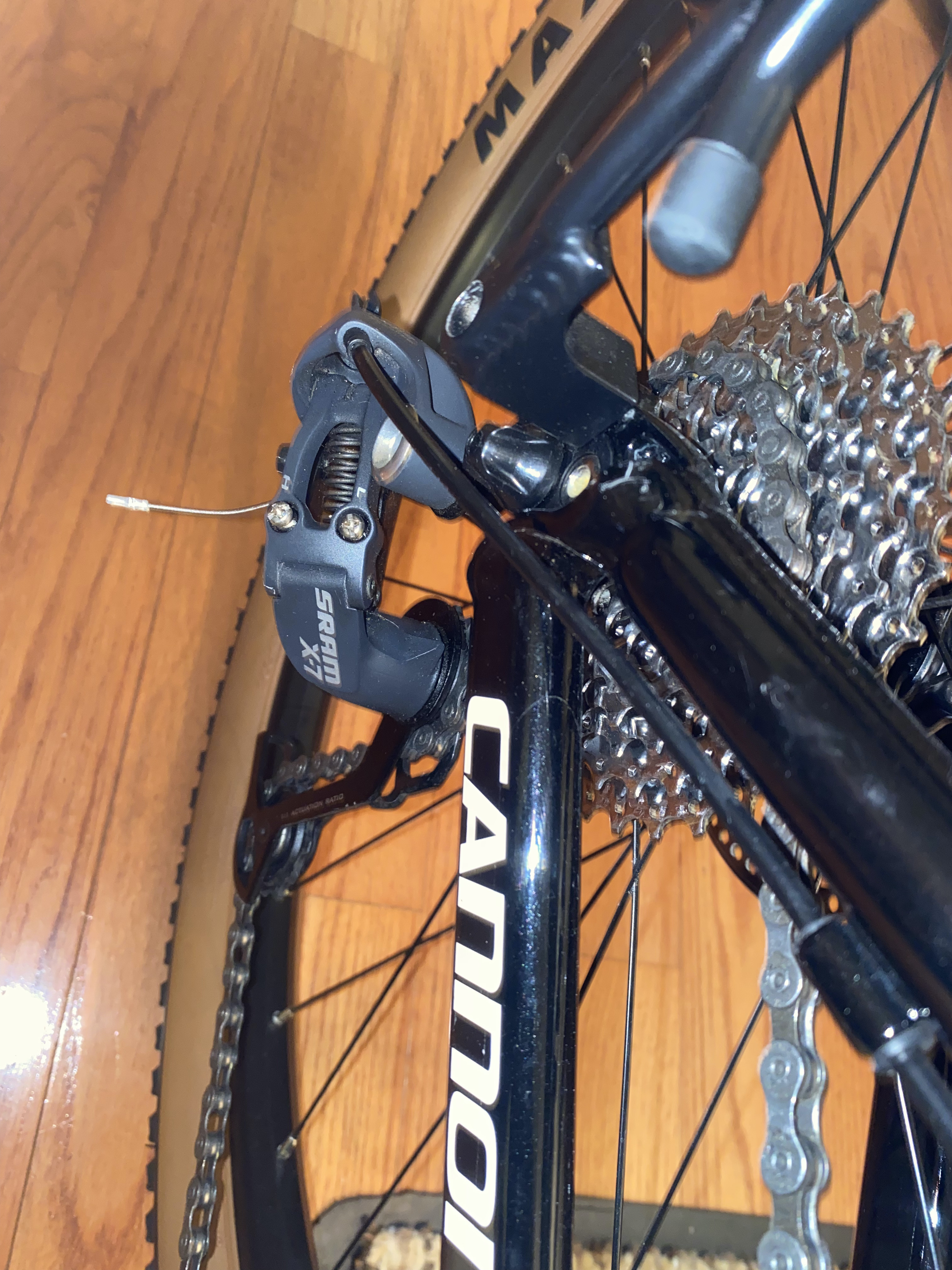

The gear shifters and derailleurs are all SRAM, but it looks like the crank set (if that is the correct term) is a Shimano Mega-9. I wouldn't mind so much if only the front gears worked right. They make a gd awful grinding sound and they don't shift cleanly (I have to press the shifter 2 or 3 times to shift down). I don't know what it needs (new chain or new everything?)
