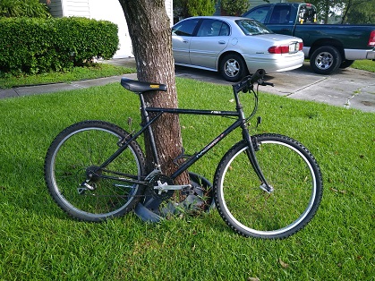

I was wondering about chain length with the new freewheel. The existing one is a 11-22T. I do have some extra chain and links if needed. My MTB is all Shimano, and I looked at swapping components yesterday. The freewheel is 12-26, but that derailleur is just plain ugly. I'm hoping the 6400 will work. It will be next week before I find out so I'll get back with info.
Here is that old beater MTB that got me started. The seat is worth more than the bike! LOL
