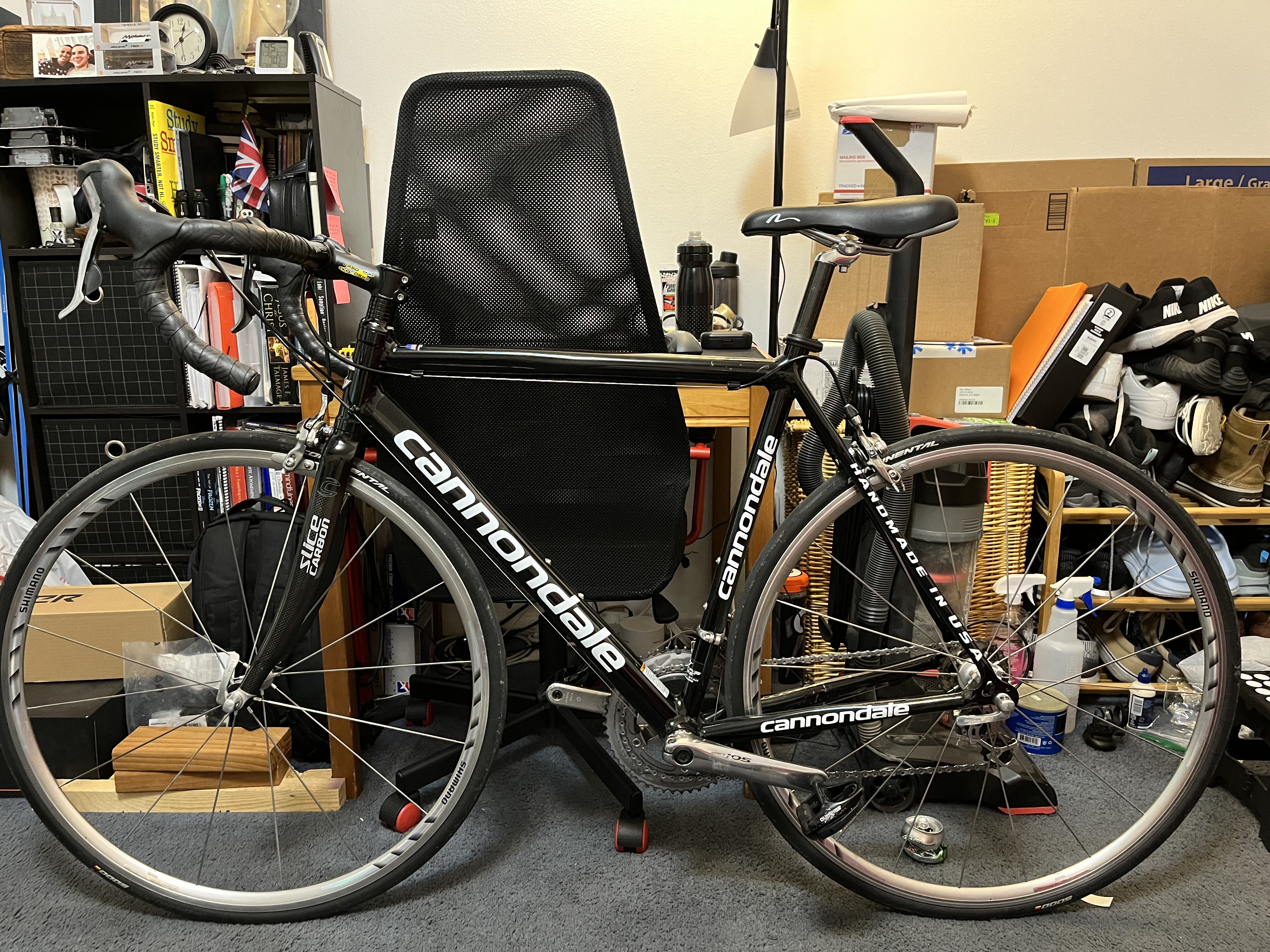

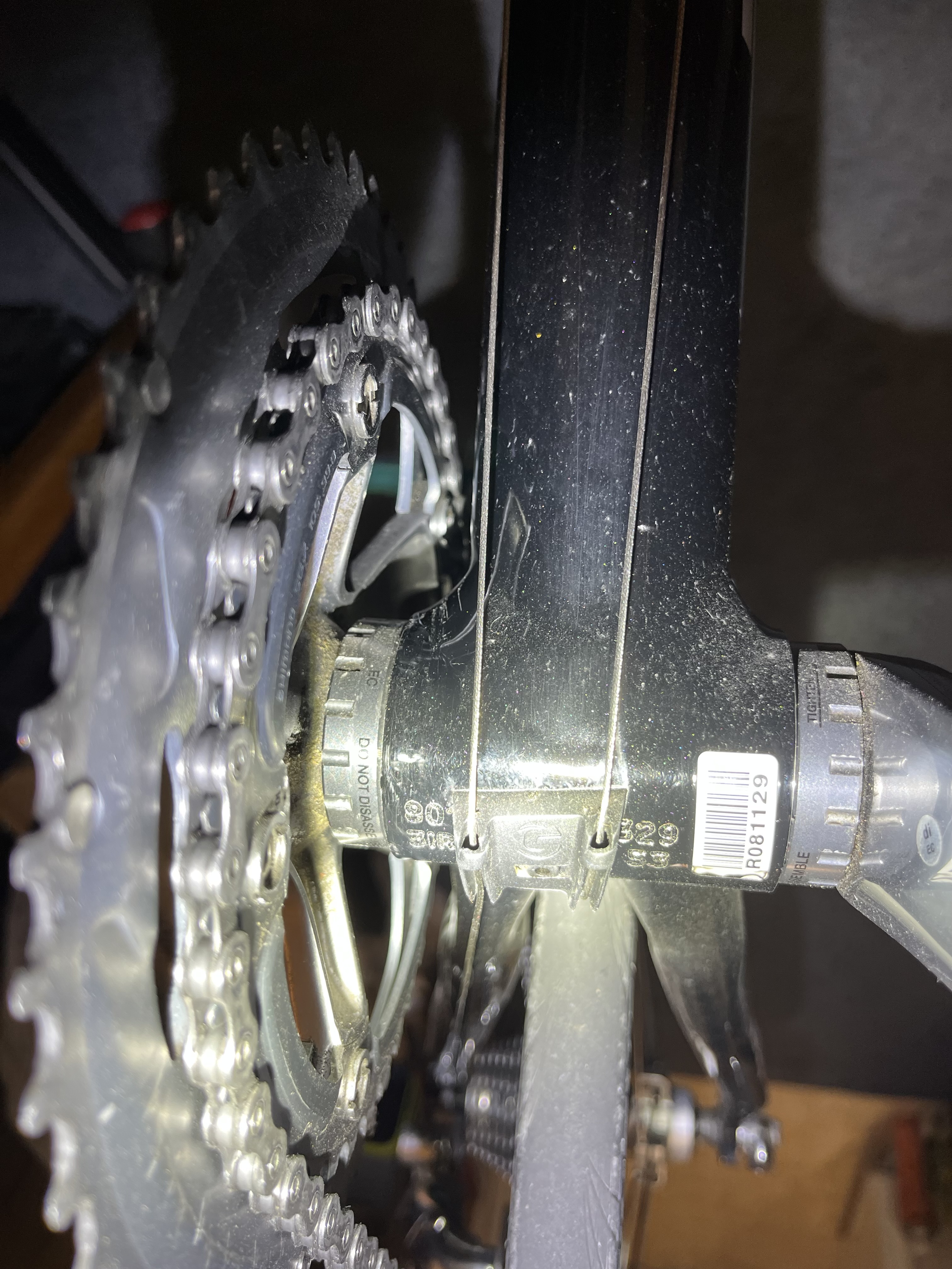

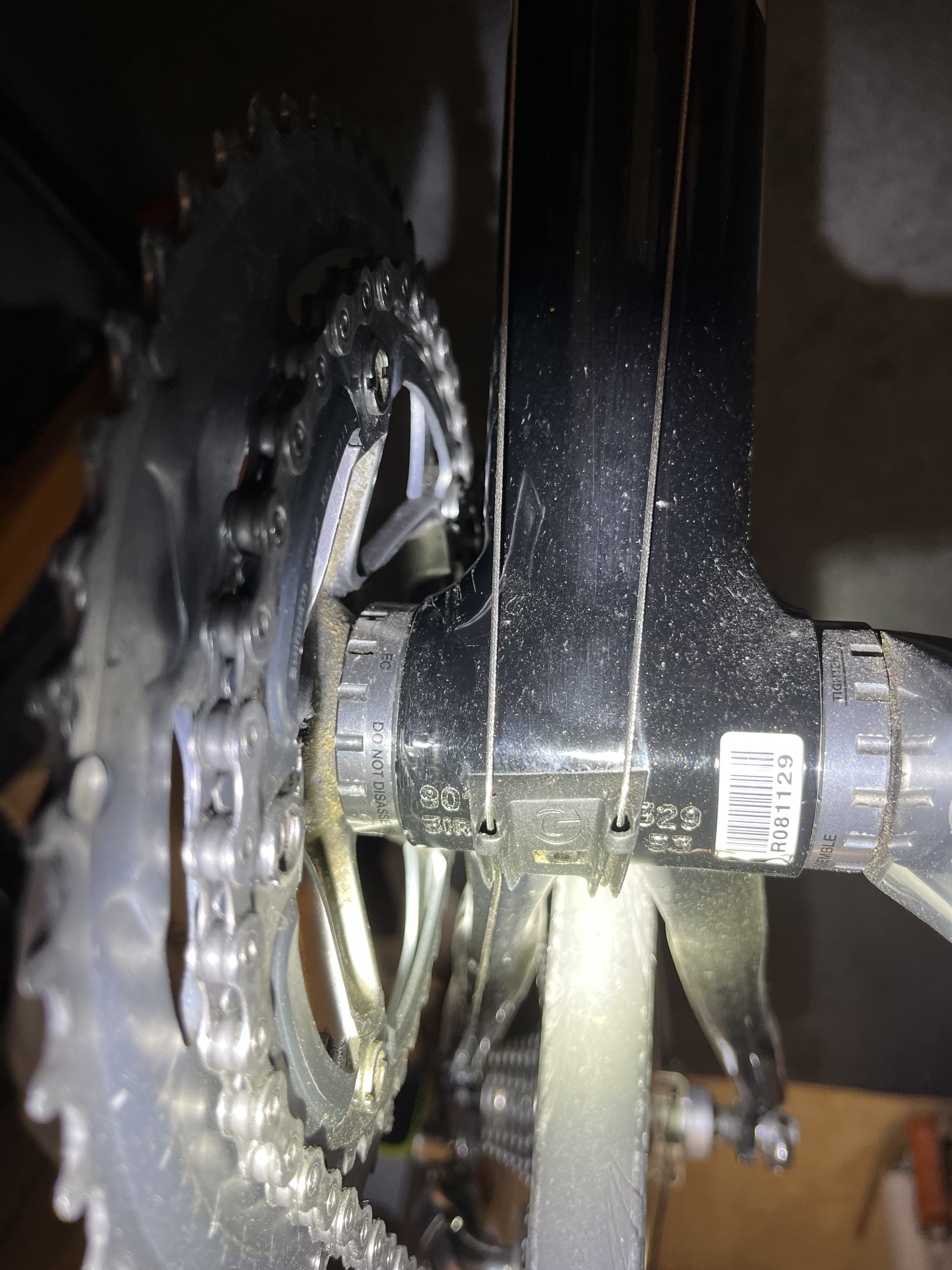

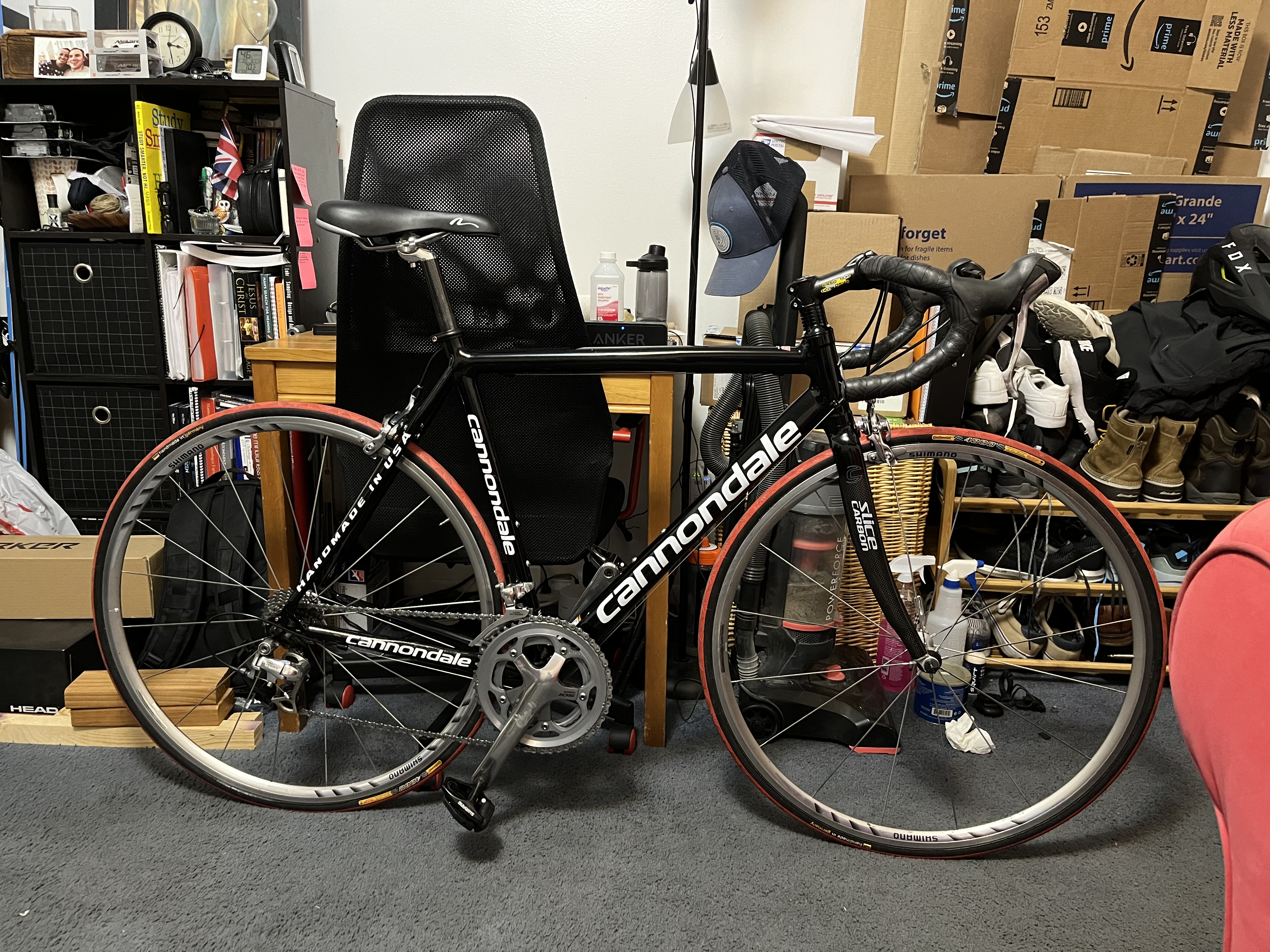

I recent found this older Cannondale with out a model name. I looked up the serial number and searched online and I think it’s a 2006 CAAD7 but I can only find pictures of the frame in silver? Does anyone know why the frame wouldn’t have a model name and what the model for this frame would be? Thanks!
It might have been a replacement frame or sold as a frameset rather than a complete bike. Assuming the frame is all aluminum (Is it?), I'm guessing that it's a CAAD8. See the dropout detail photo of the CAAD8 on the 2006 R800 page. I'm pretty sure that dropout is specific to the CAAD8. The fork looks to be older, see the fork on the 2004 R5000. That makes me think it might be a replacement frame. We have seen many frames like yours - lacking model numbers and with paint not shown in the catalogs.
