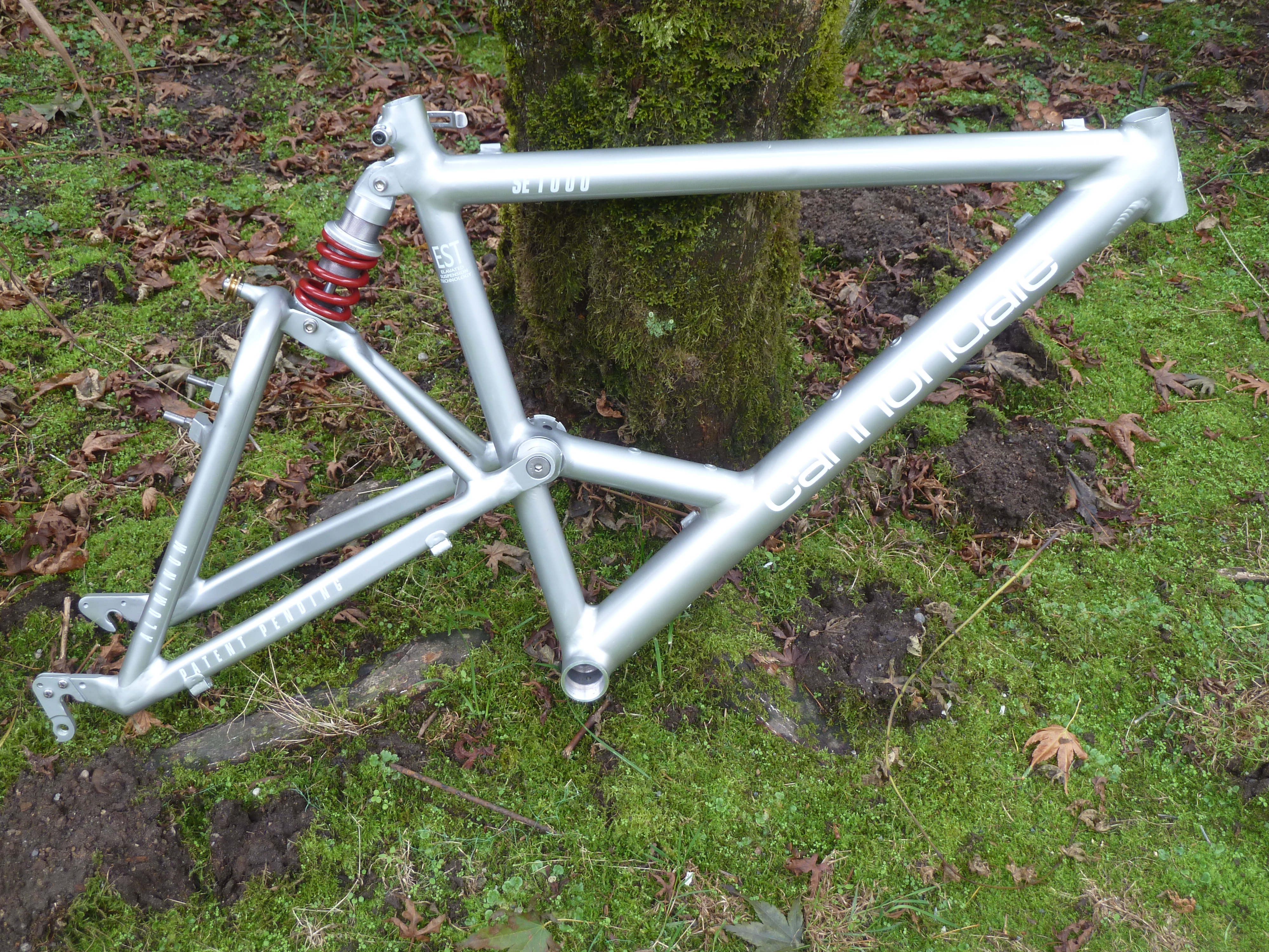

It has been considerable time, but I thought I'd update this post, considering other events unfolding rather quickly, which would seal the fate of this project.
When I left off, I did the welding repairs and was about to test fit components when I encountered another set-back... The head tube was worn out. I had a 1" headset in my stash of parts and I went about to test fit it, it just dropped in and wobbled! Normally, cups are sized 0.2mm bigger for an interference fit but it was now undersized. Sigh. I started to consider going to oversized 1" headsets (at 30.4mm), but then, they are very hard to come by and if the head tube needed to be reamed for that, who has 30.4mm reamers? I also thought maybe I should just use epoxy and glue the cups in, but then, how effective will that be long-term?
I put the frame aside and moved onto other projects.
I suppose the stars were aligned and I came across another Cannondale project to replace this one. I'll be posting about that soon. It's a good one!
I have gone ahead and painted this frame and it will be assembled and decalled. It is essentially a wall-hanger now and I am considering donating it to either a local bike museum (if they'll take it), or another far-away museum. Or if an individual wants to hang it on their wall... Either way, I don't consider this rideable. It served someone well and I'm sure they had fun riding it, but it's time is done.

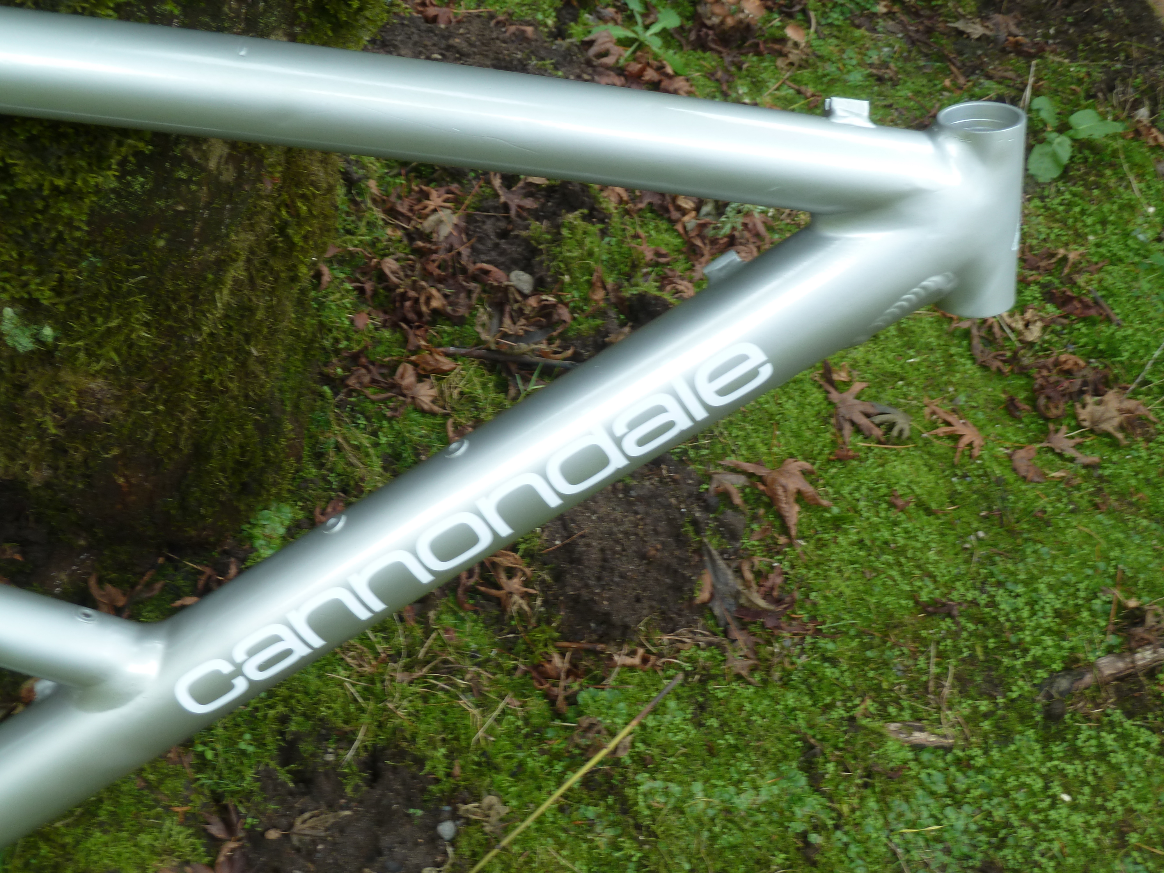

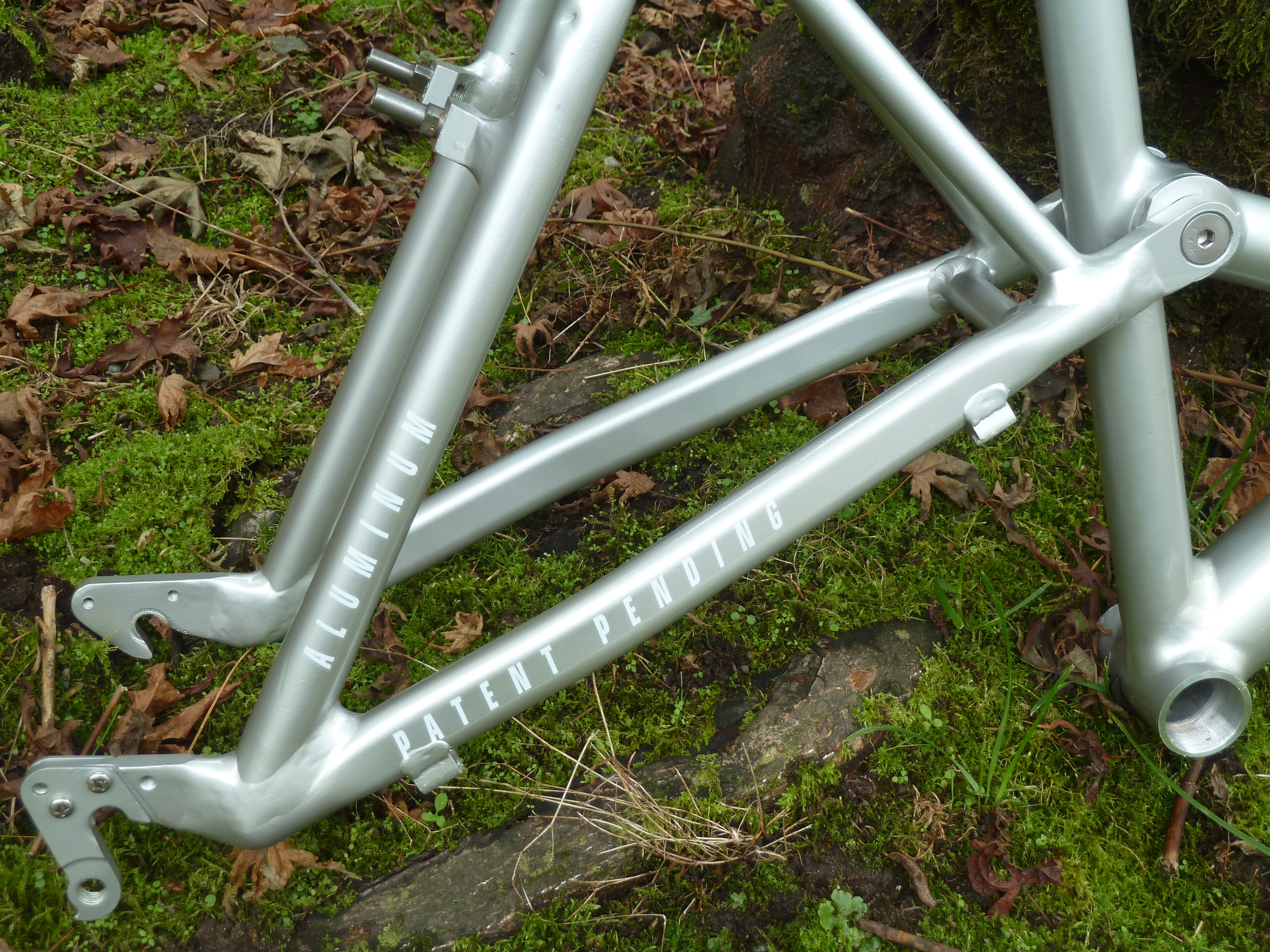

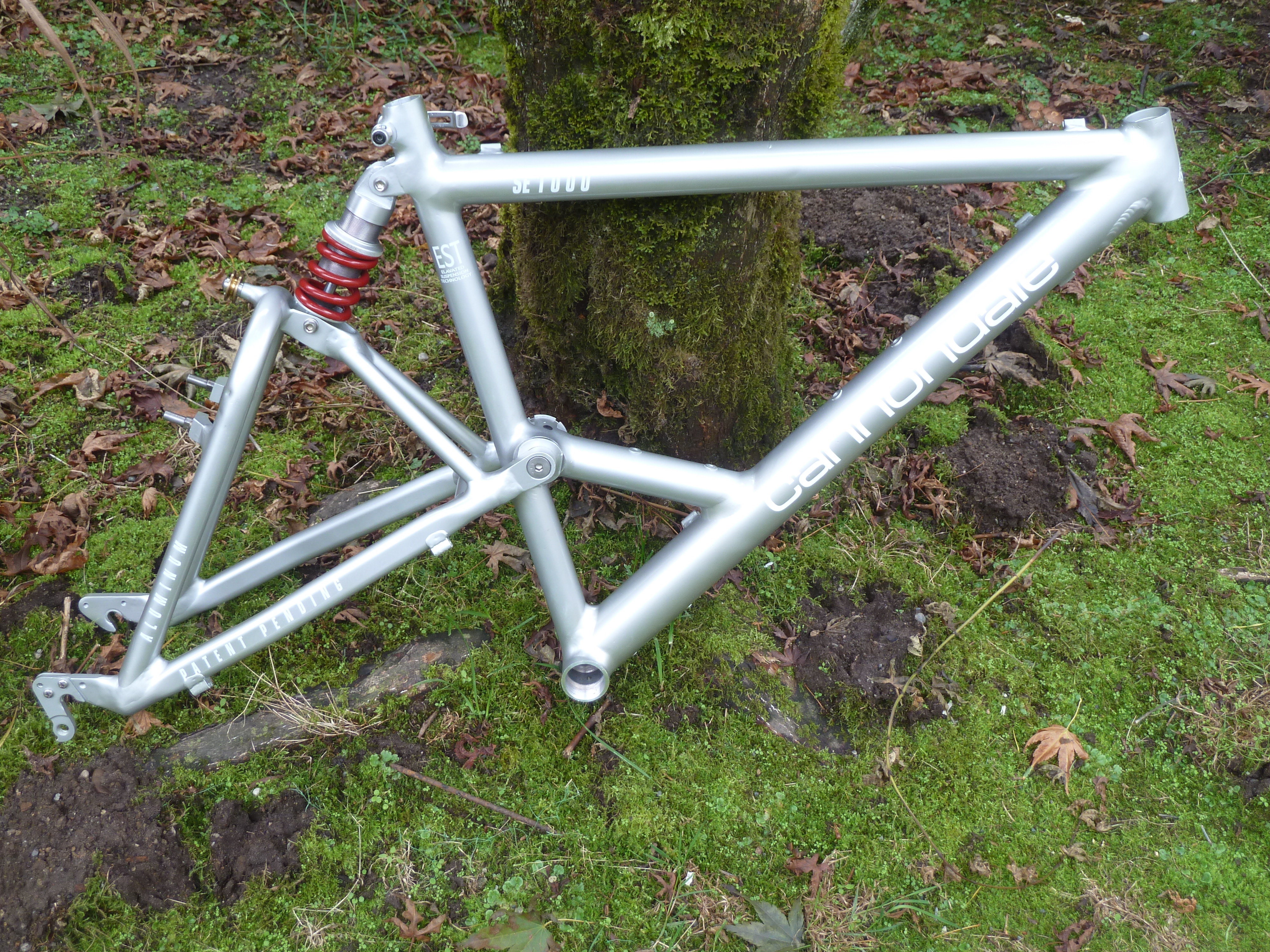

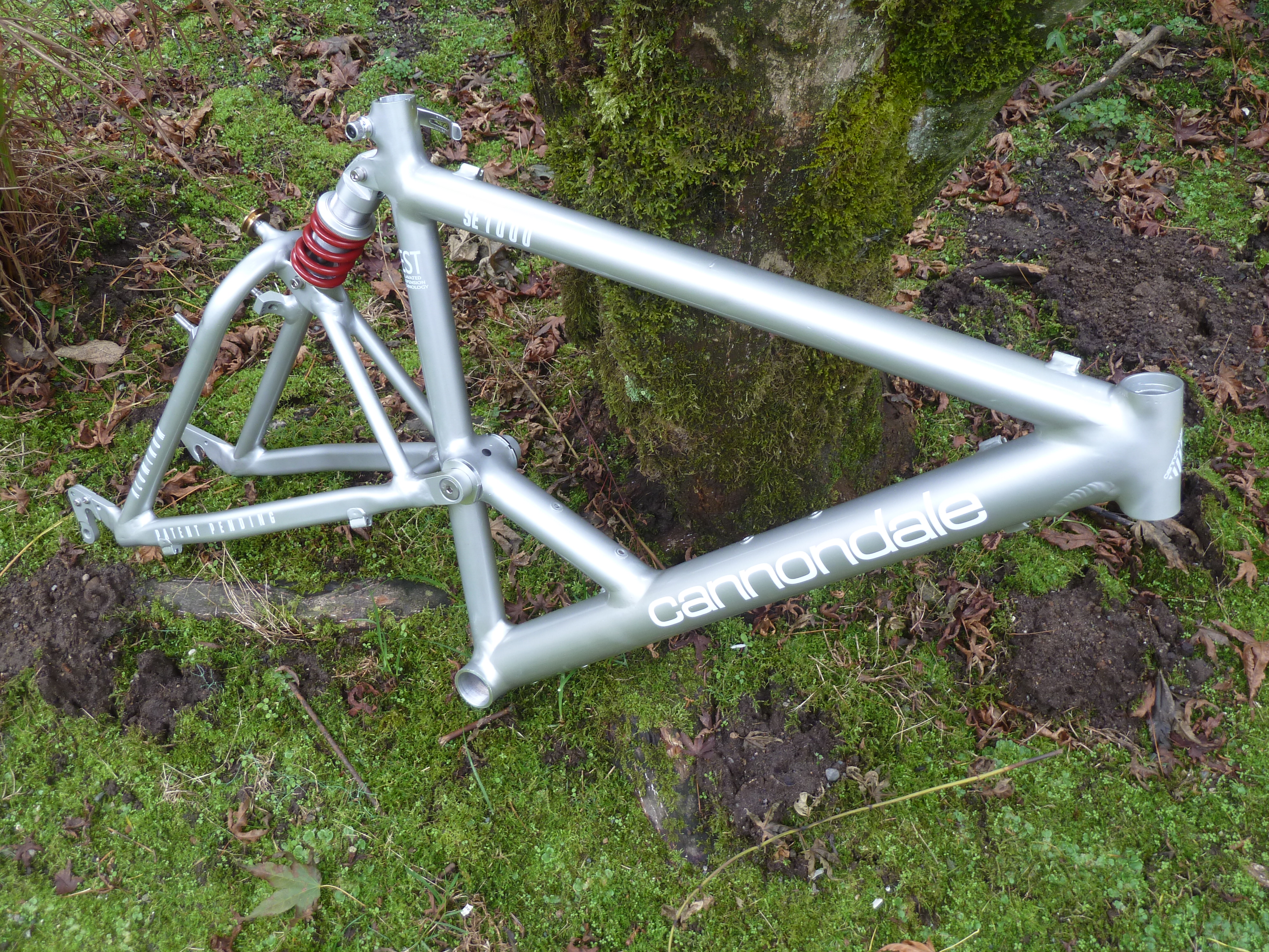

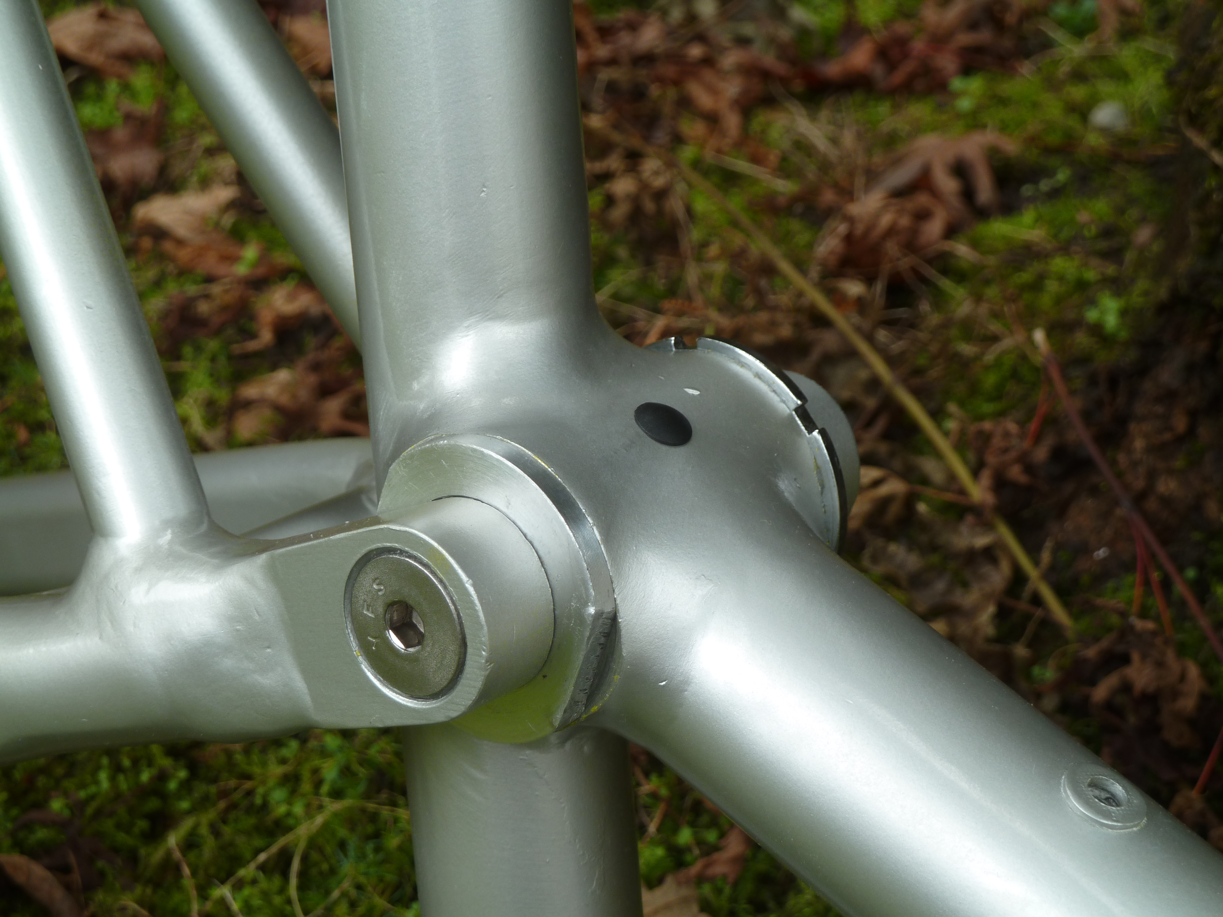

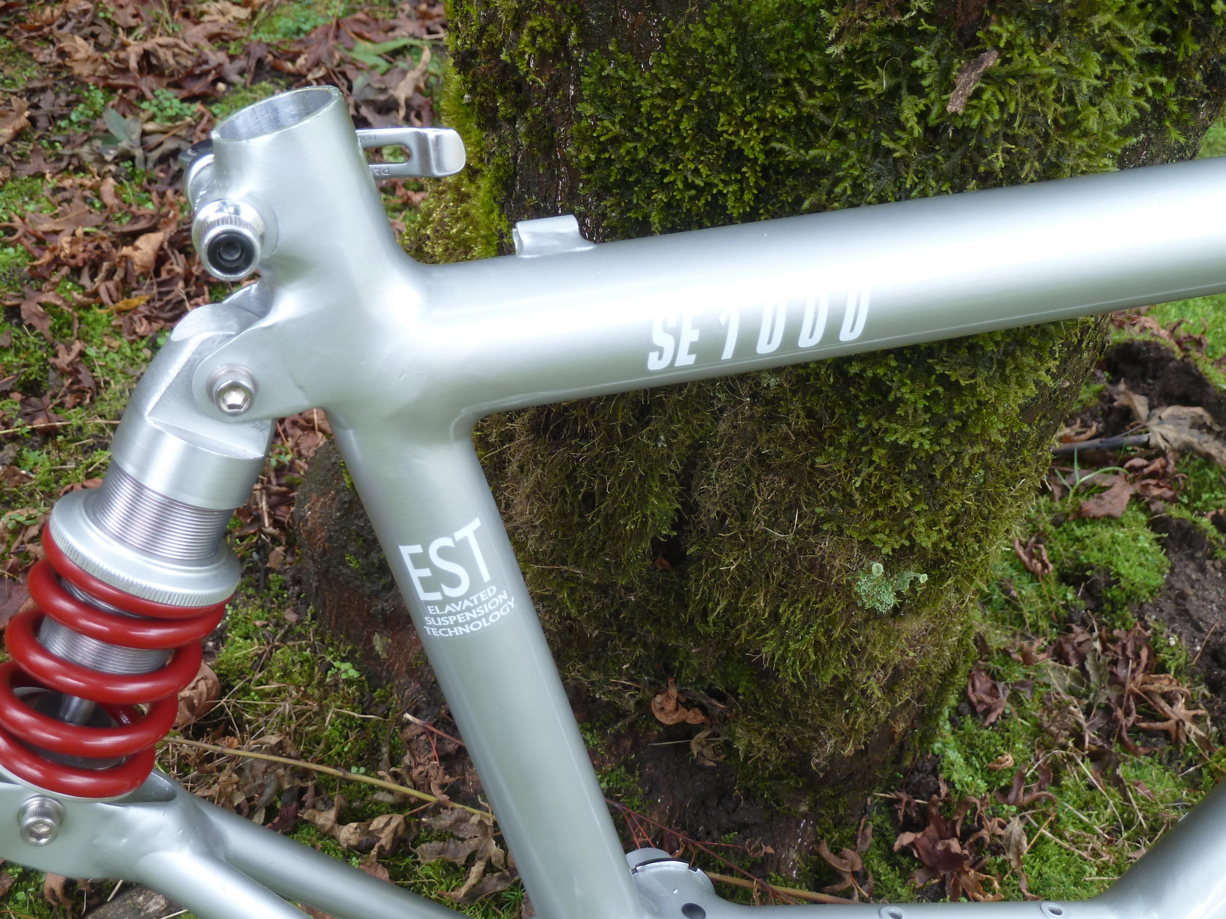

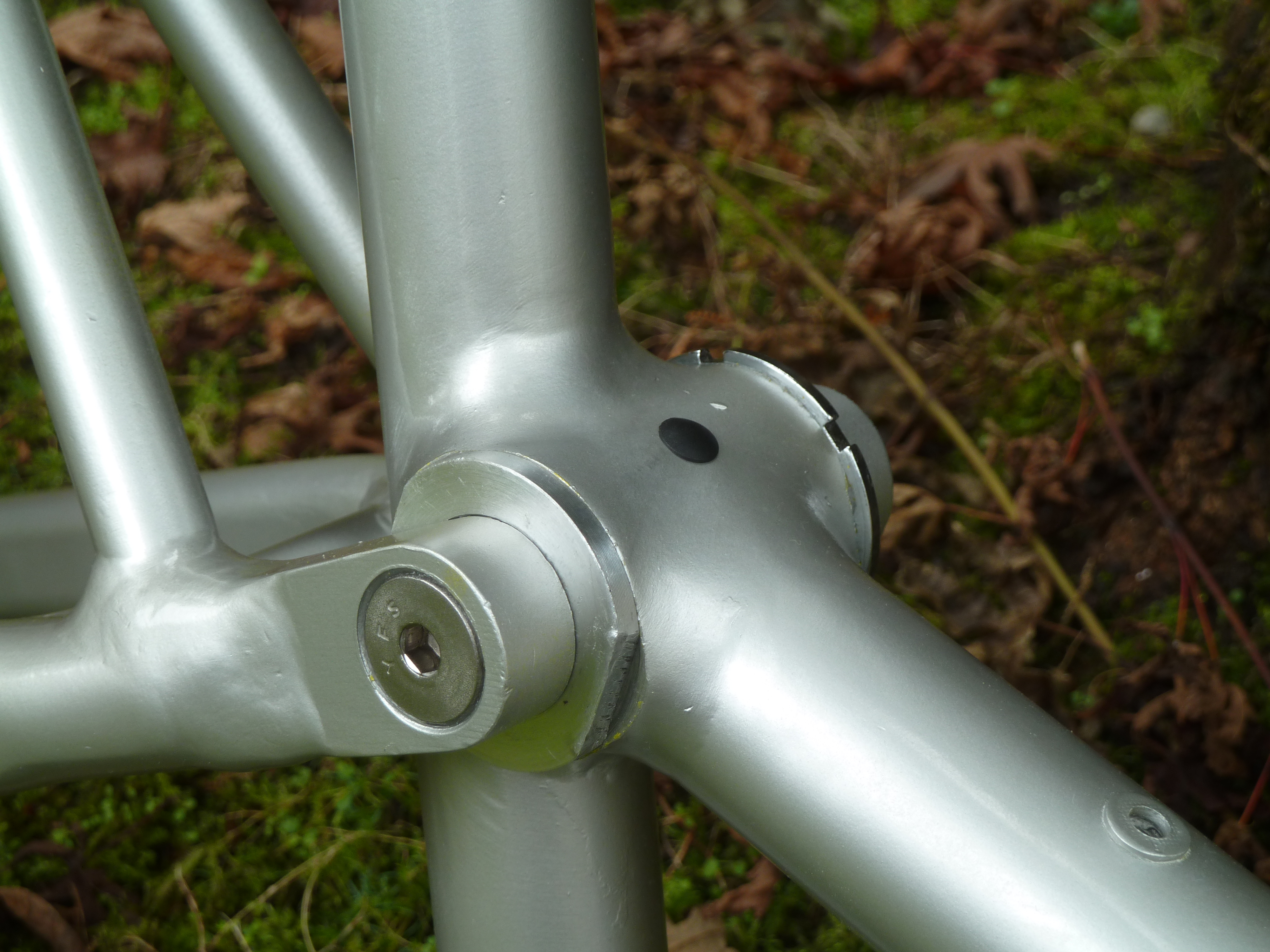

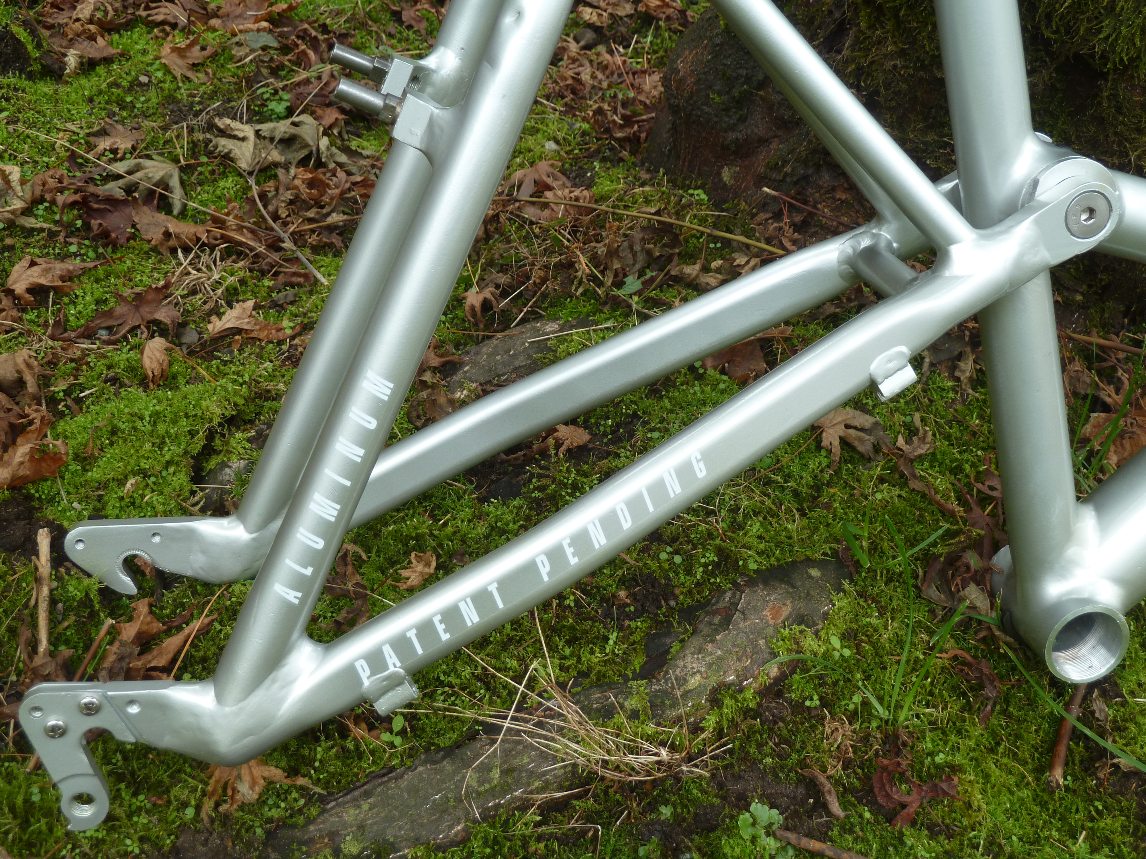

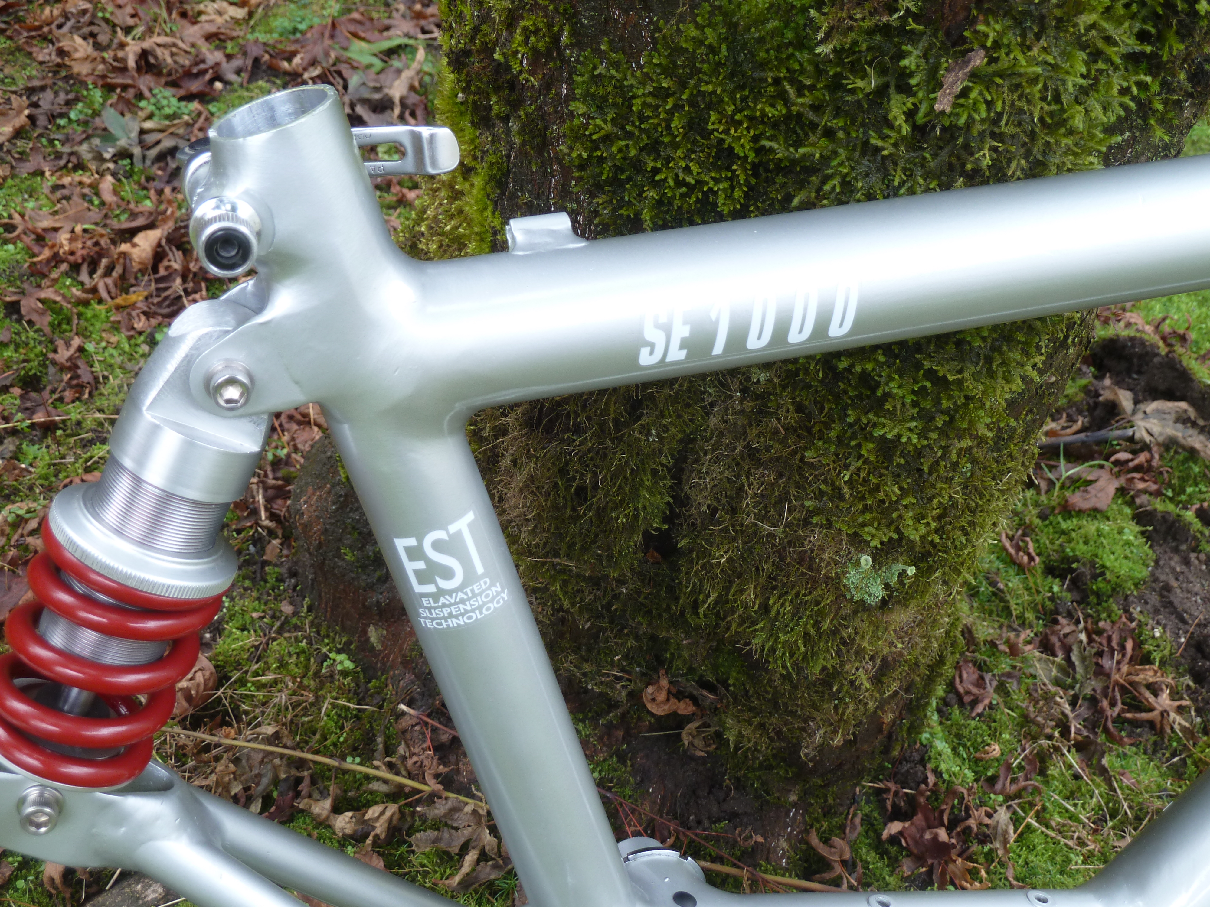

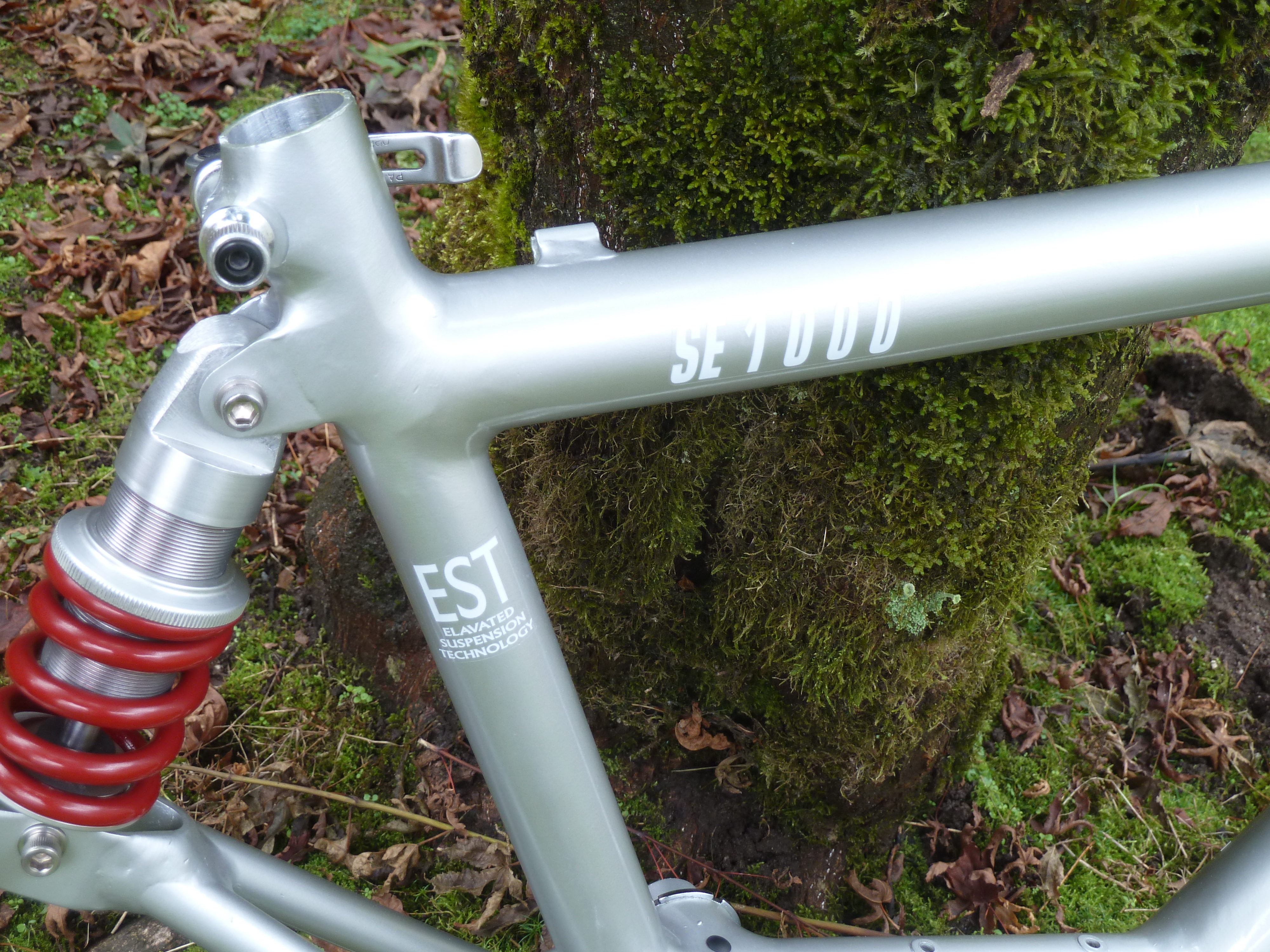

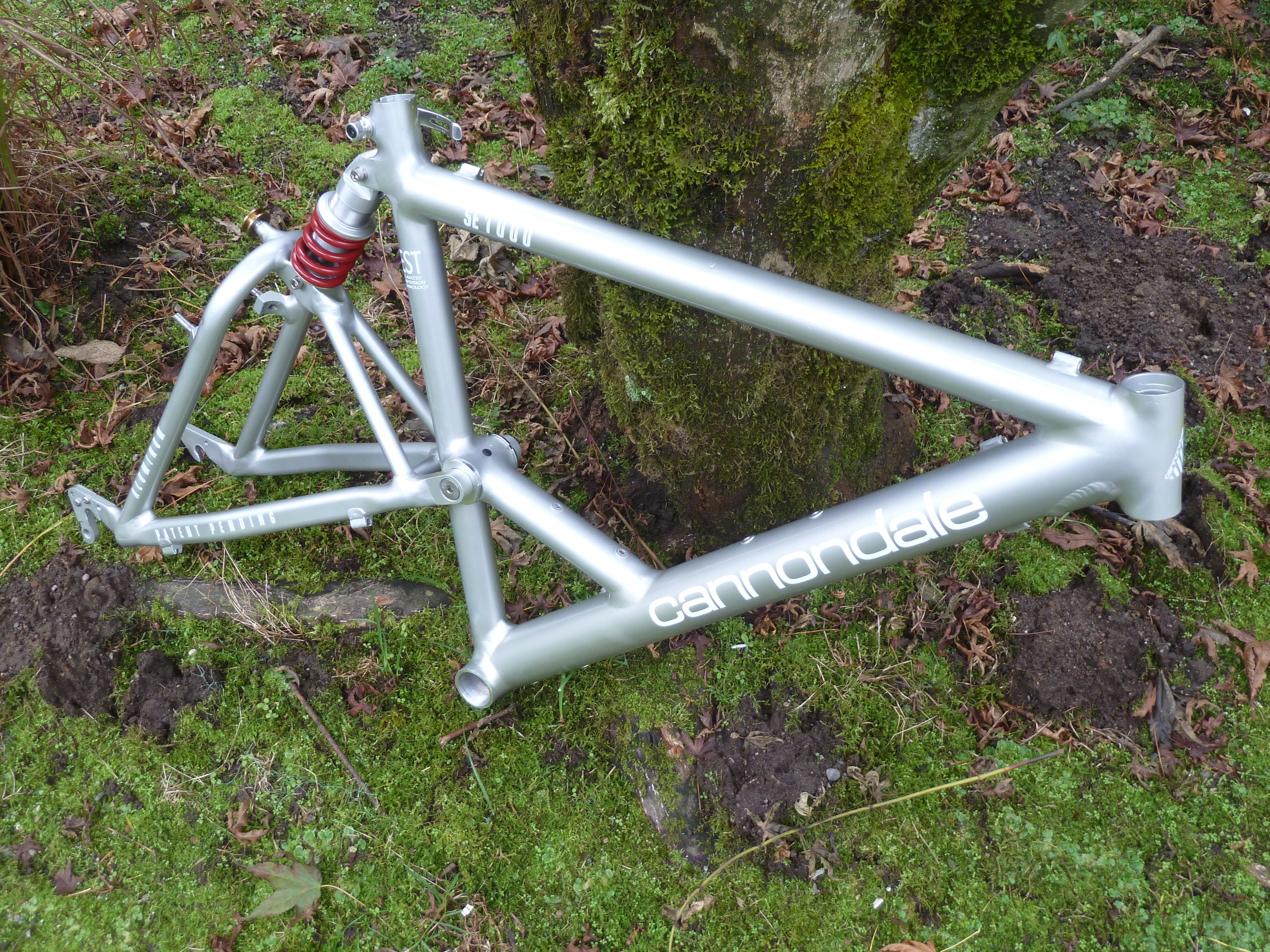

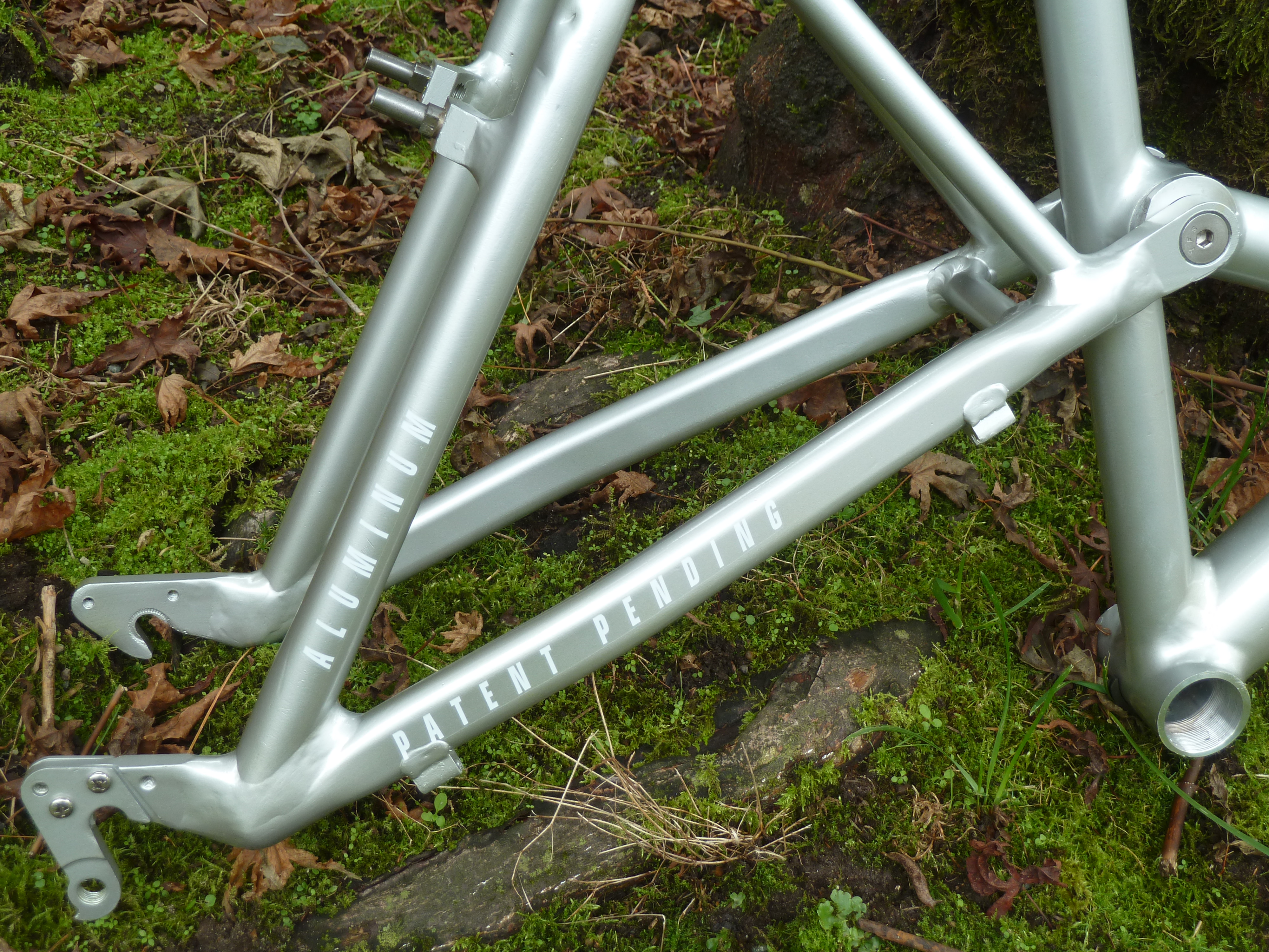

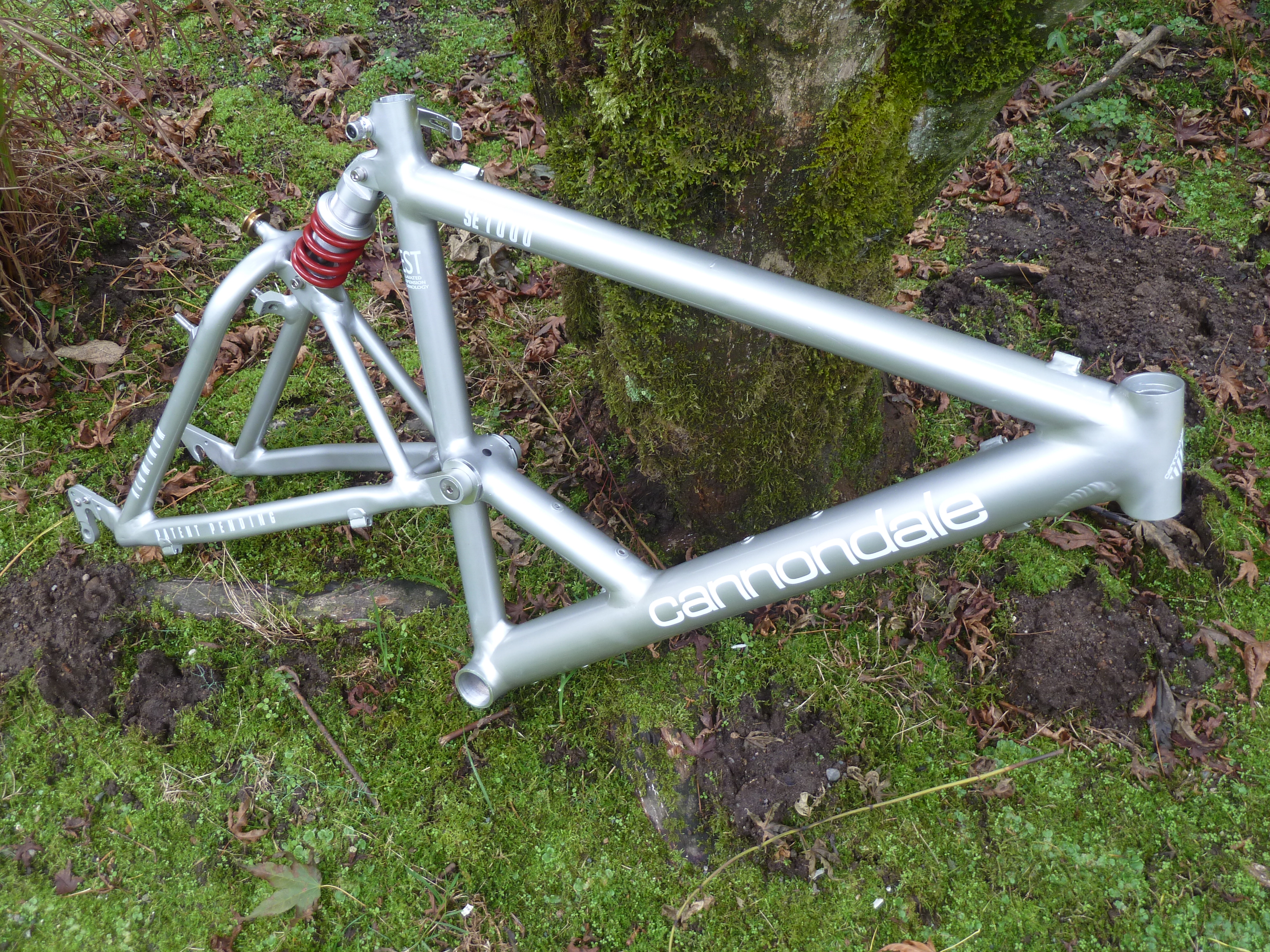

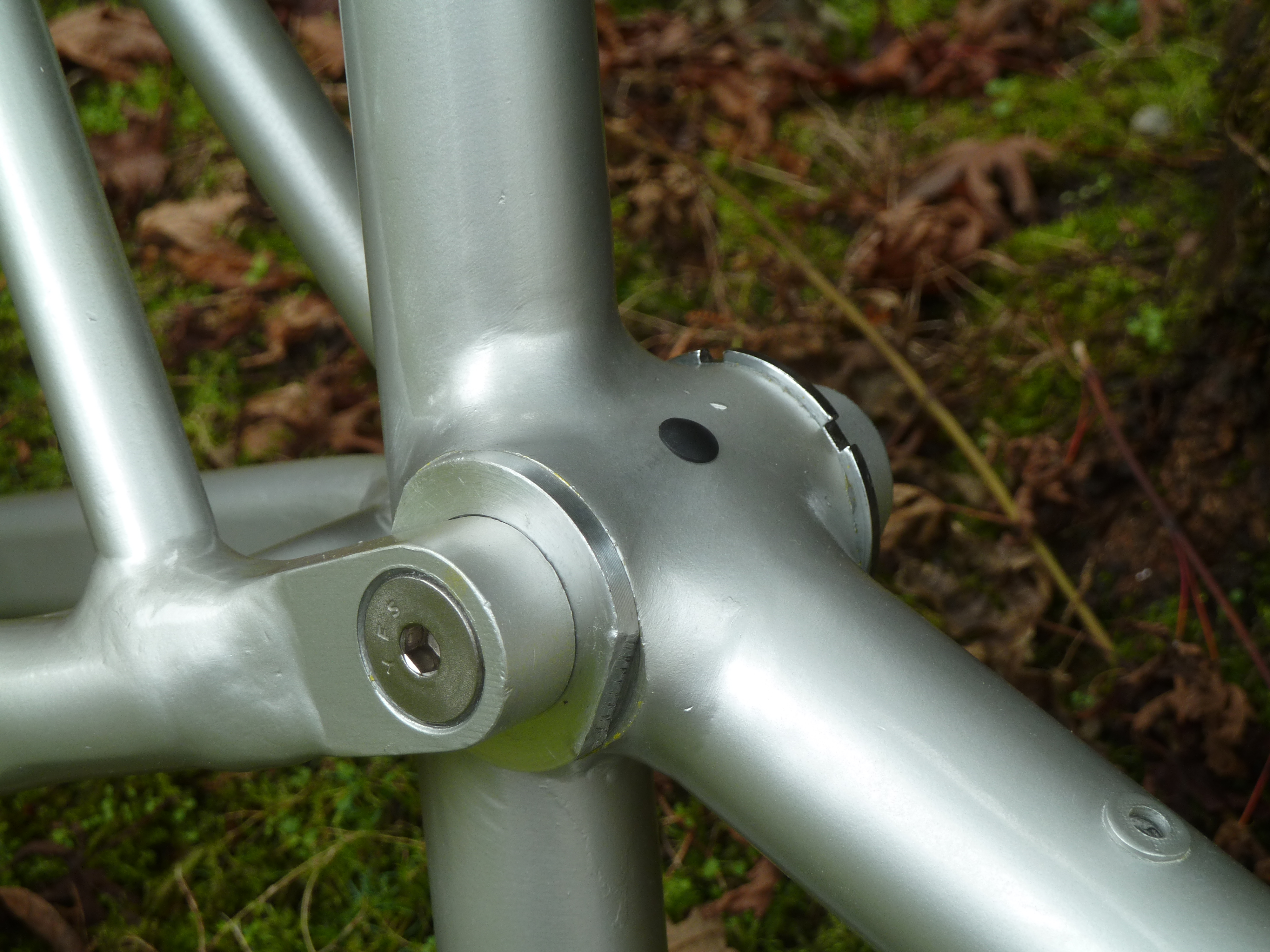

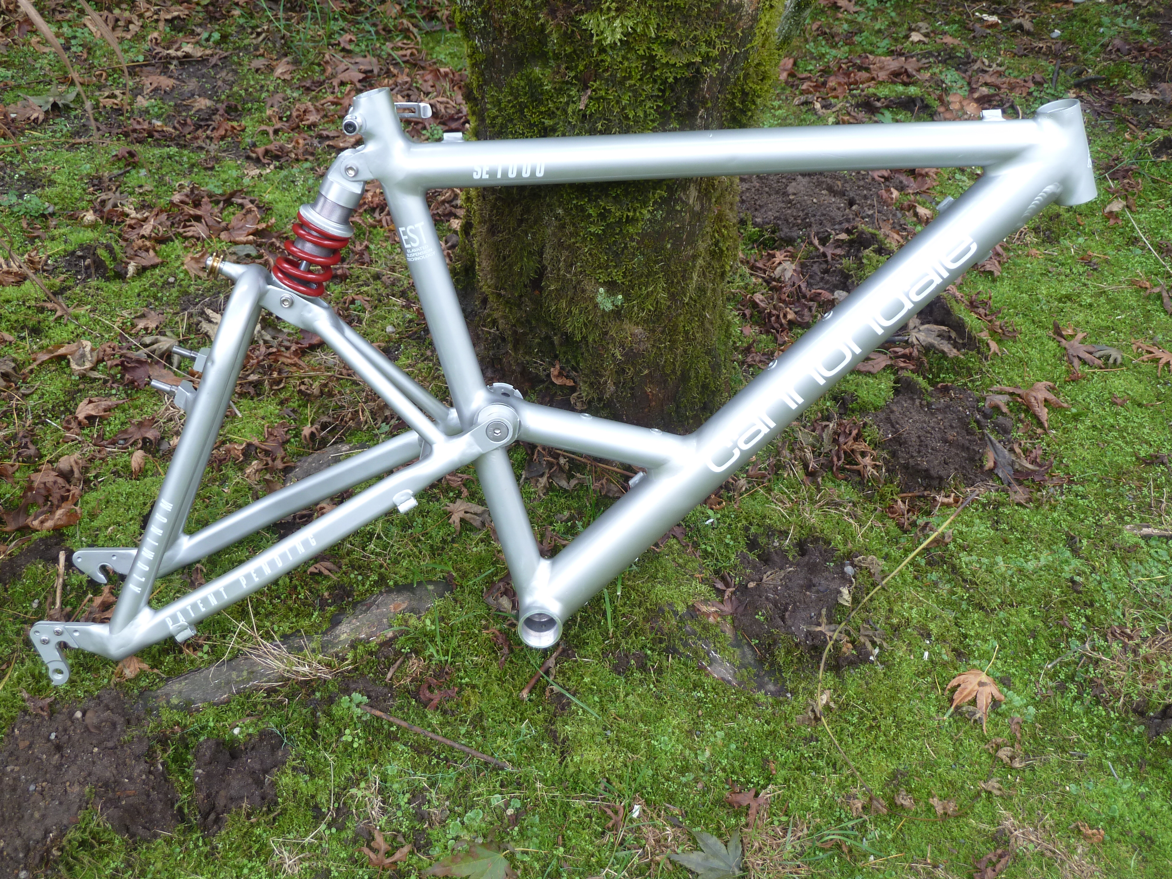

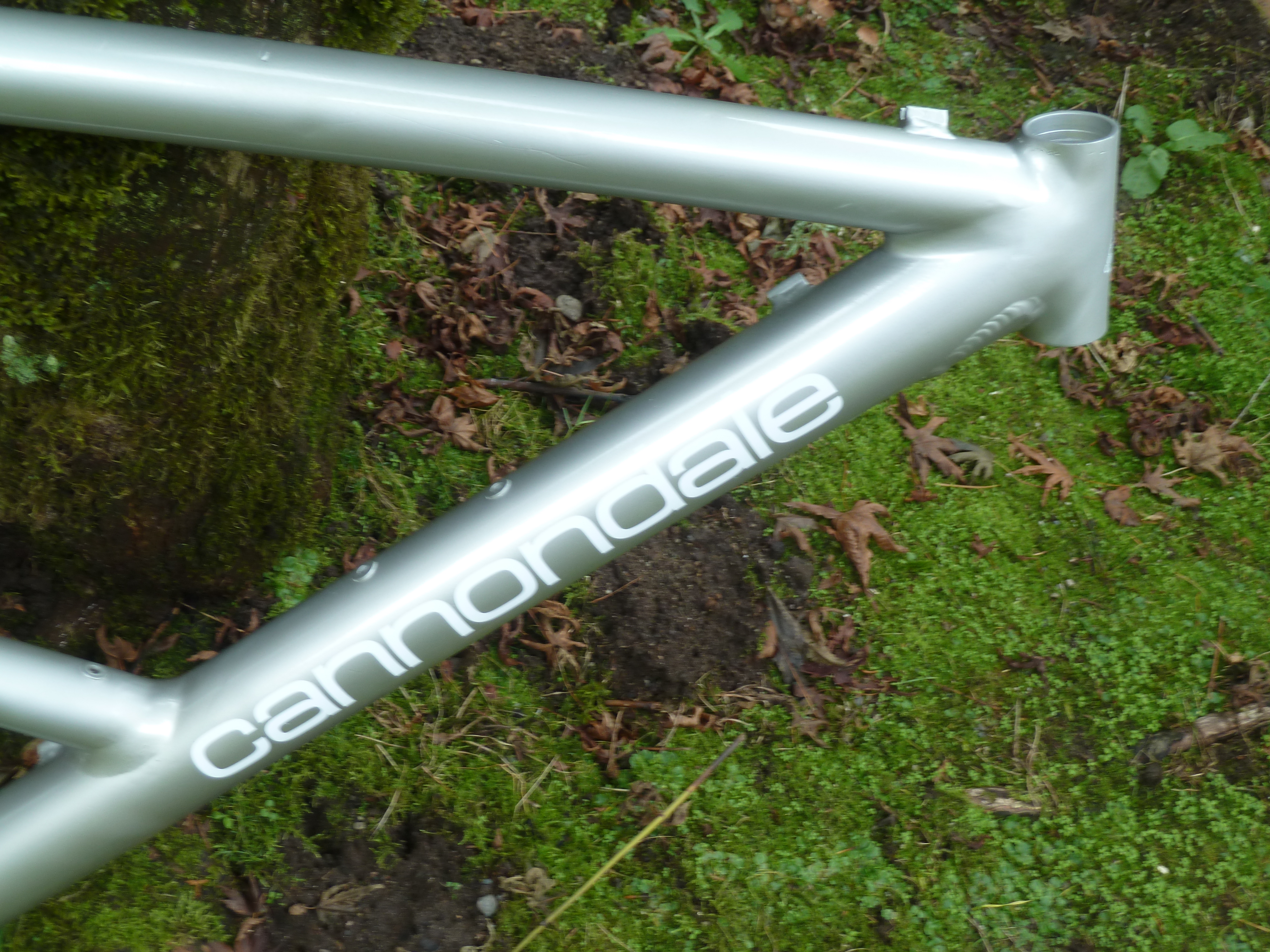

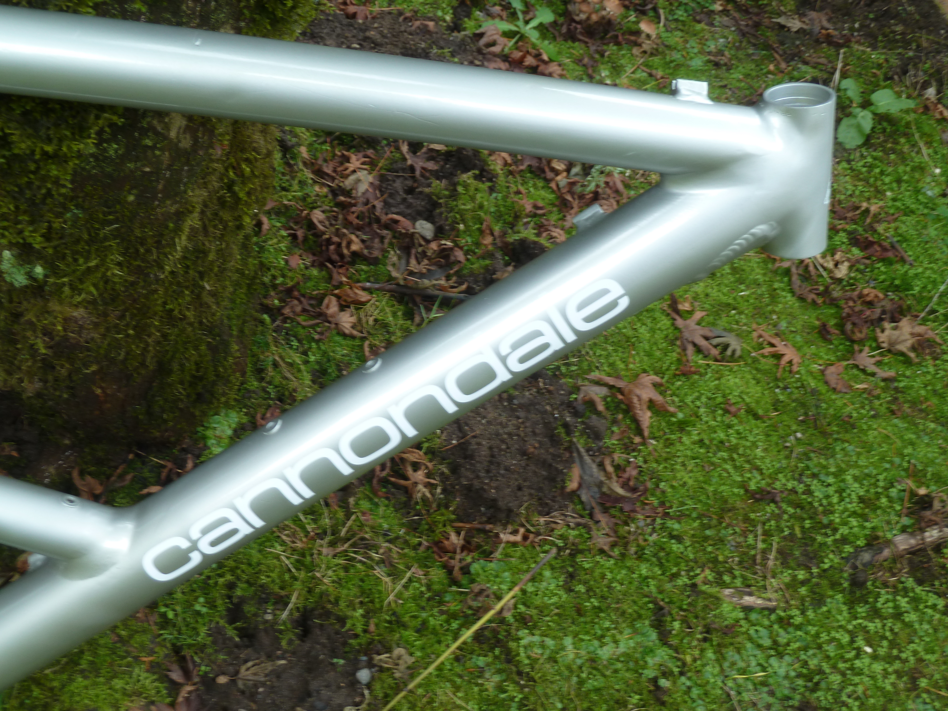

So, it's time to conclude the saga of this frame. I was able to sell it to a local bike shop (https://velocitycycles.ca/) and the store owner Travis, absolutely loved it. He hasn't decided if he'll keep it as a frame, or build it up into a period correct bike. It would certainly be a display piece and will one day be a formal part of a museum he's thinking that he may open up (considering all of the other frames and bikes he's collected over the years). Here's how it finished up:
L1060493.JPG L1060497.JPG L1060496.JPG L1060499.JPG L1060504.JPG L1060505.JPG

Nice build, to bad that jou could not finnish it.
View attachment 6536 View attachment 6537 View attachment 6538 View attachment 6539 View attachment 6540 View attachment 6541

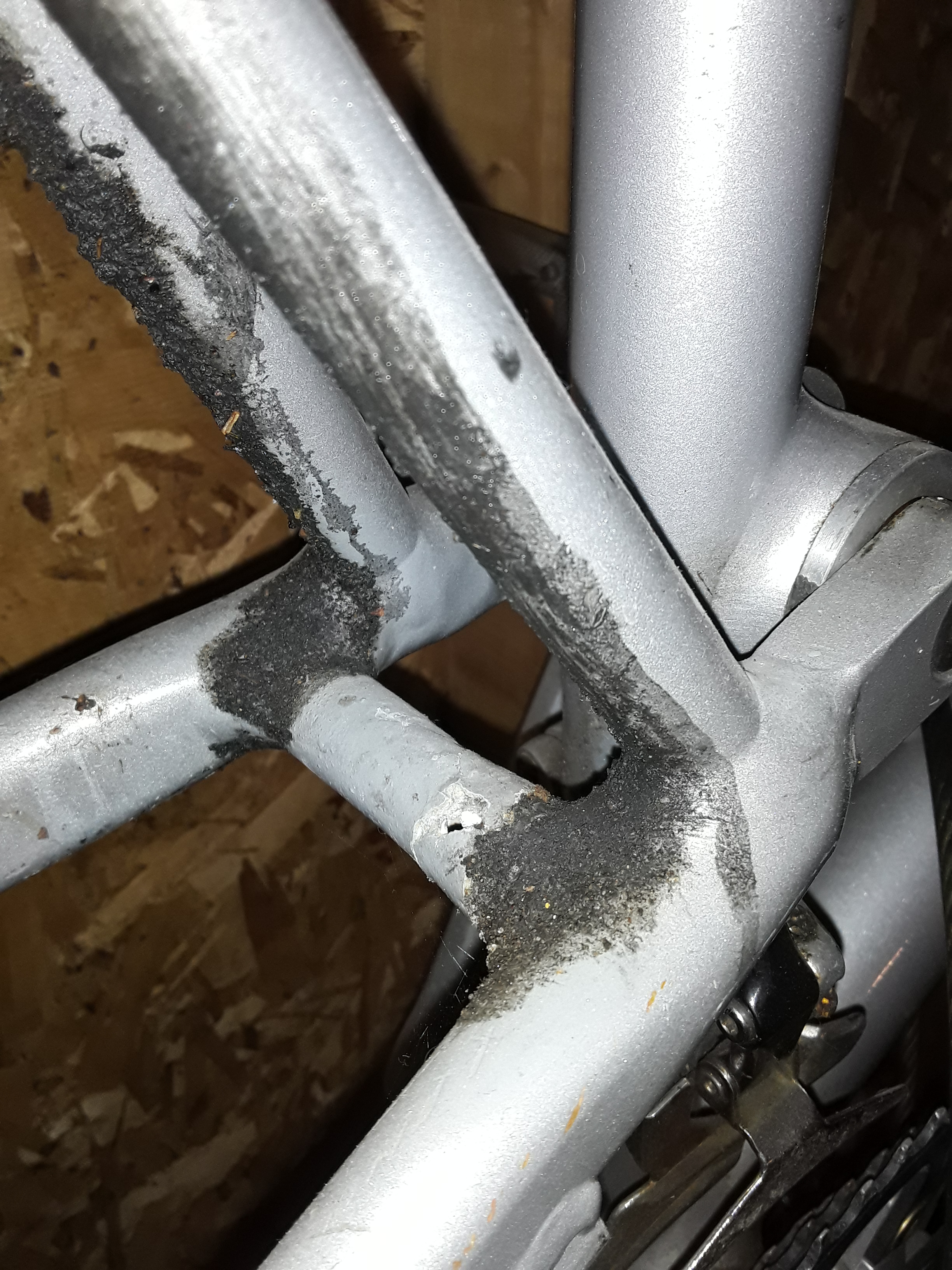

Really nice work. In messaging you, I was going to ask if you wanted to sell the swingarm. My swingarm has a crack in the same piece; I am in Chicago, Illinois USA though. If you find that the person you sold it to isn't interested (not that you should ask); I'd be glad to know. Otherwise, I'm sorry to hear about your headtube situation. If you were located in Chicago, I'd ask how much you would charge to fix mine. Your repair looked sturdier than original. A photo of my swingarm crack is attached; sorry about the dirt. I bought the frame in this condition.
