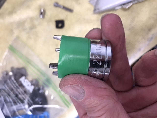

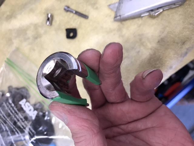

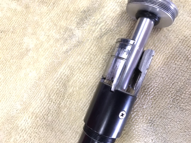

I cut up a 22mm socket, a lot of hacksawing and it doesn’t look pretty, but does the job perfectly with no damage to the damper.

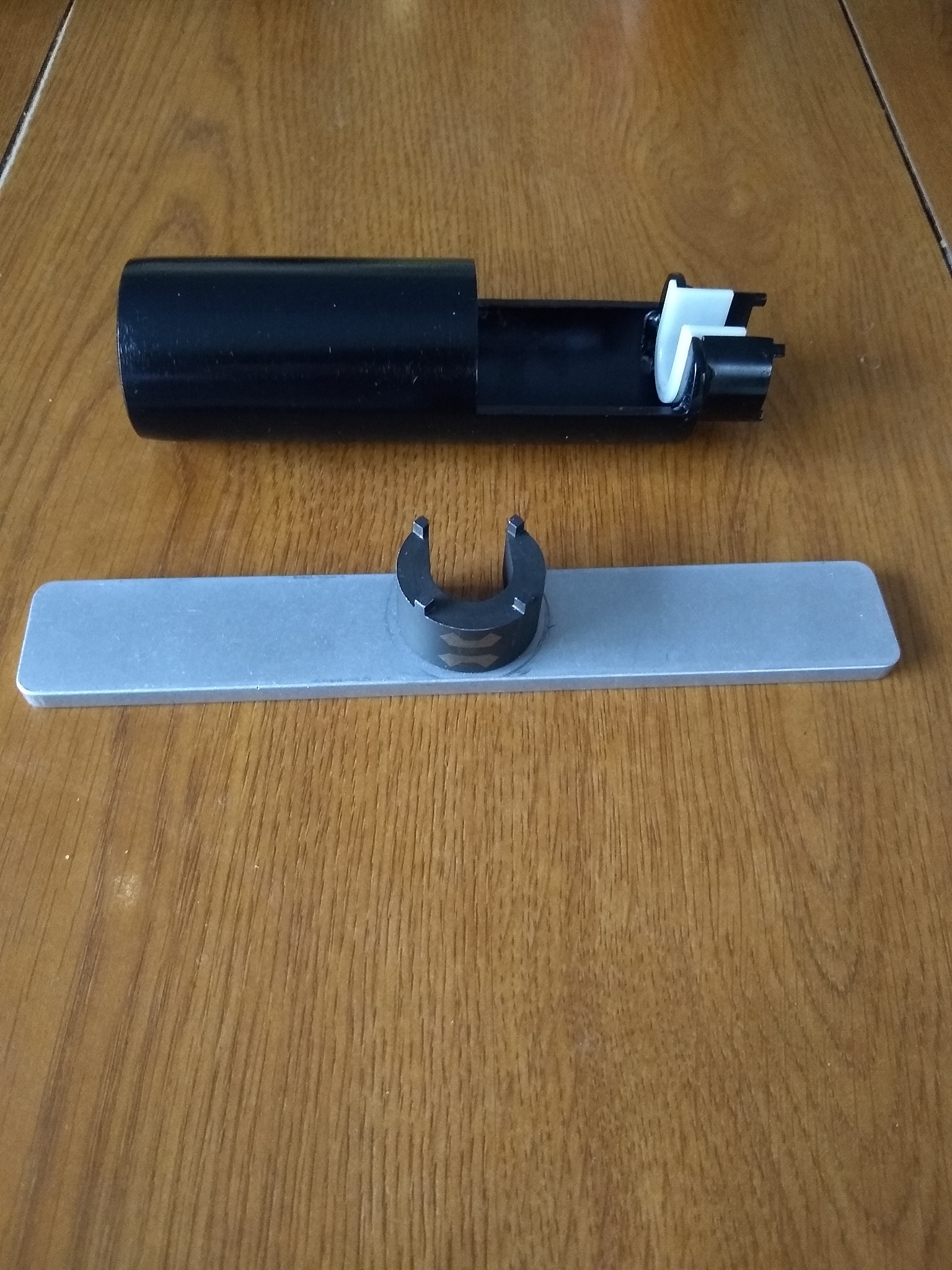

The KH031 super castle tool replaces the original tool, and is still available. I found it doesn't fit around the top cap of the 2005+ DL80, but it works on the DLR80 and all the older forks. The original style HDTL146 is currently made aftermarket by Leonardi, if you wanted that one.
