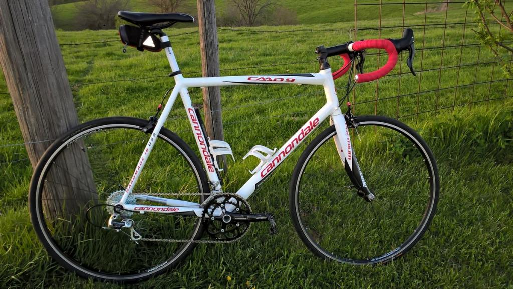

Here is my 2010 CAAD9, BB-30 with FSA crank and Campagnolo
