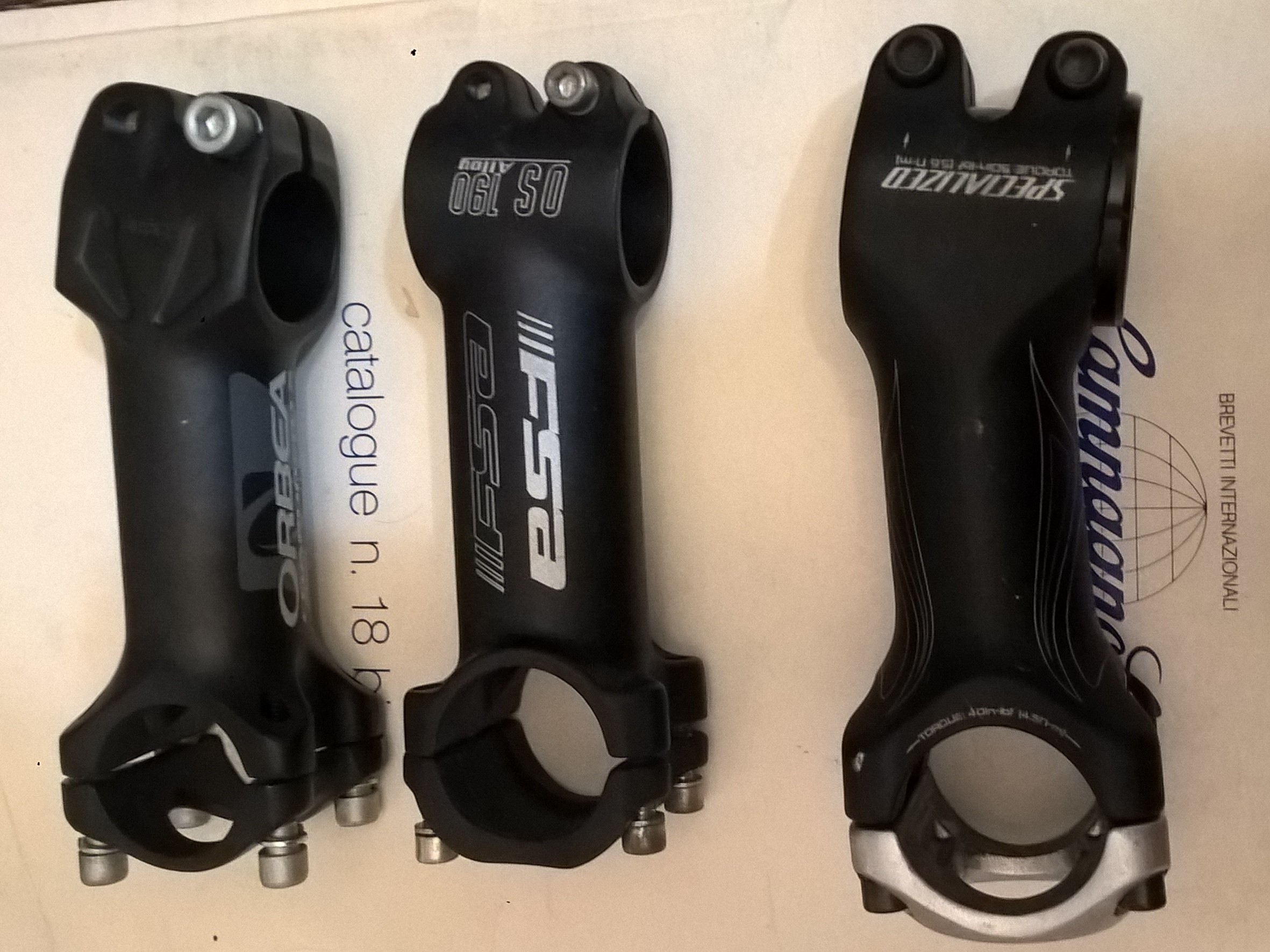

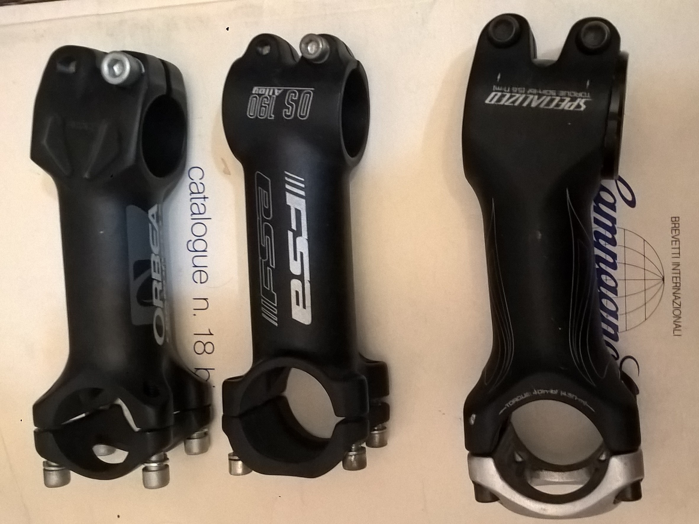

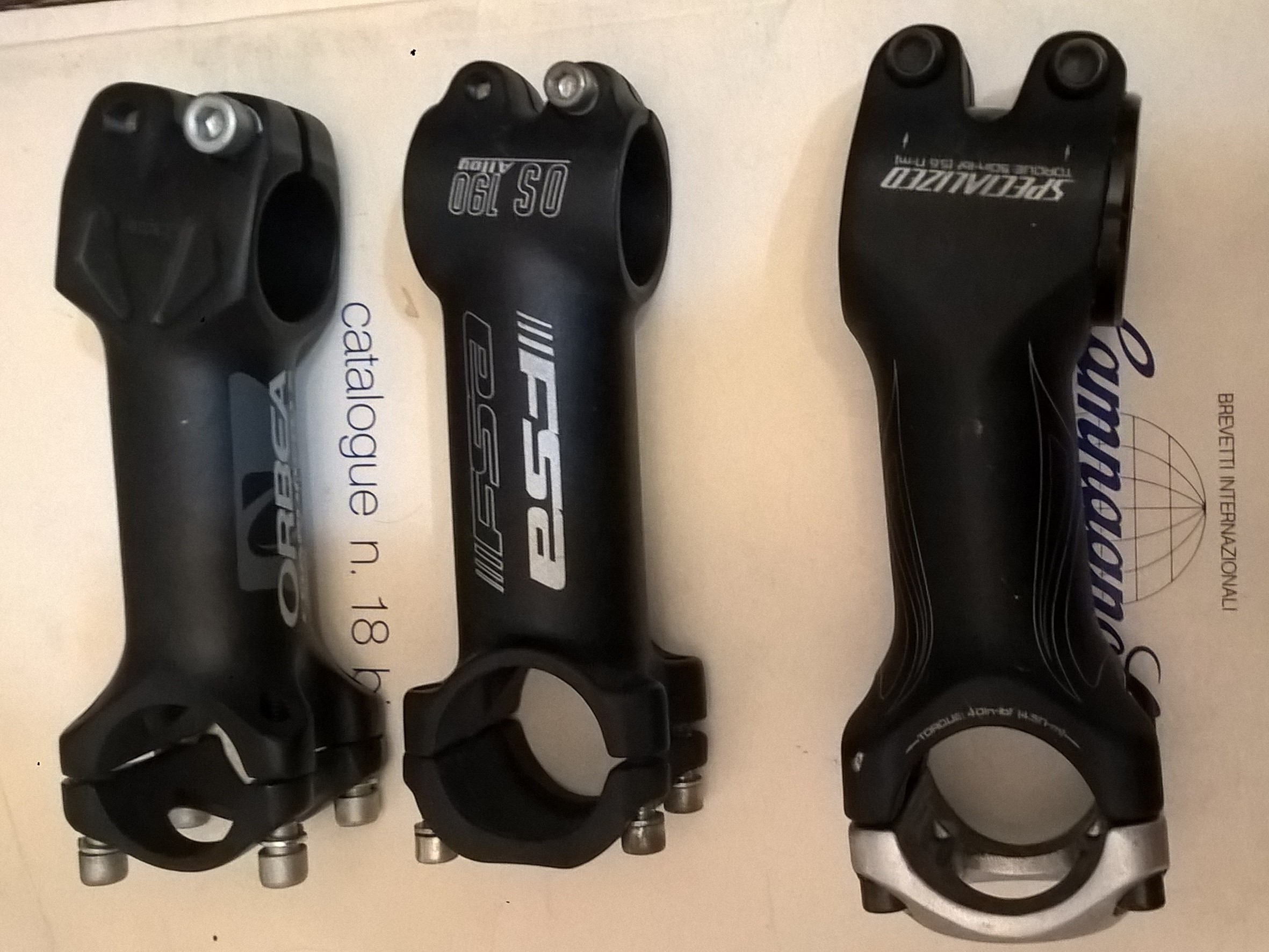

I found three 100 mm stems here, had a lot more 110s and 105s. The FSA and the Orbea are new, the Specialized slightly used. The Specialized has an eccentric sleeve which allows for angle adjustment. $15 for it or the FSA, $5 for the Orbea, + shipping cost.

I found three 100 mm stems here, had a lot more 110s and 105s. The FSA and the Orbea are new, the Specialized slightly used. The Specialized has an eccentric sleeve which allows for angle adjustment. $15 for it or the FSA, $5 for the Orbea, + shipping cost. View attachment 4381

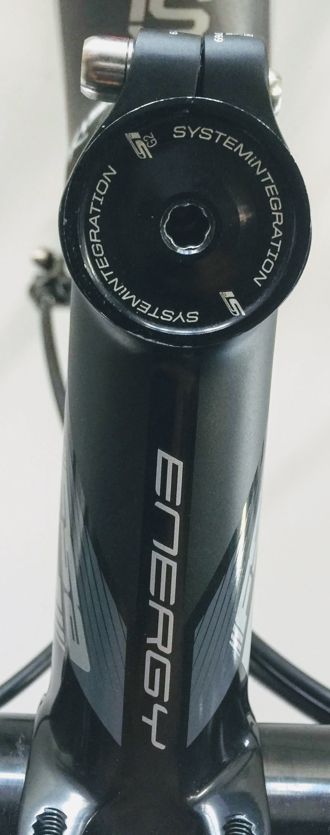

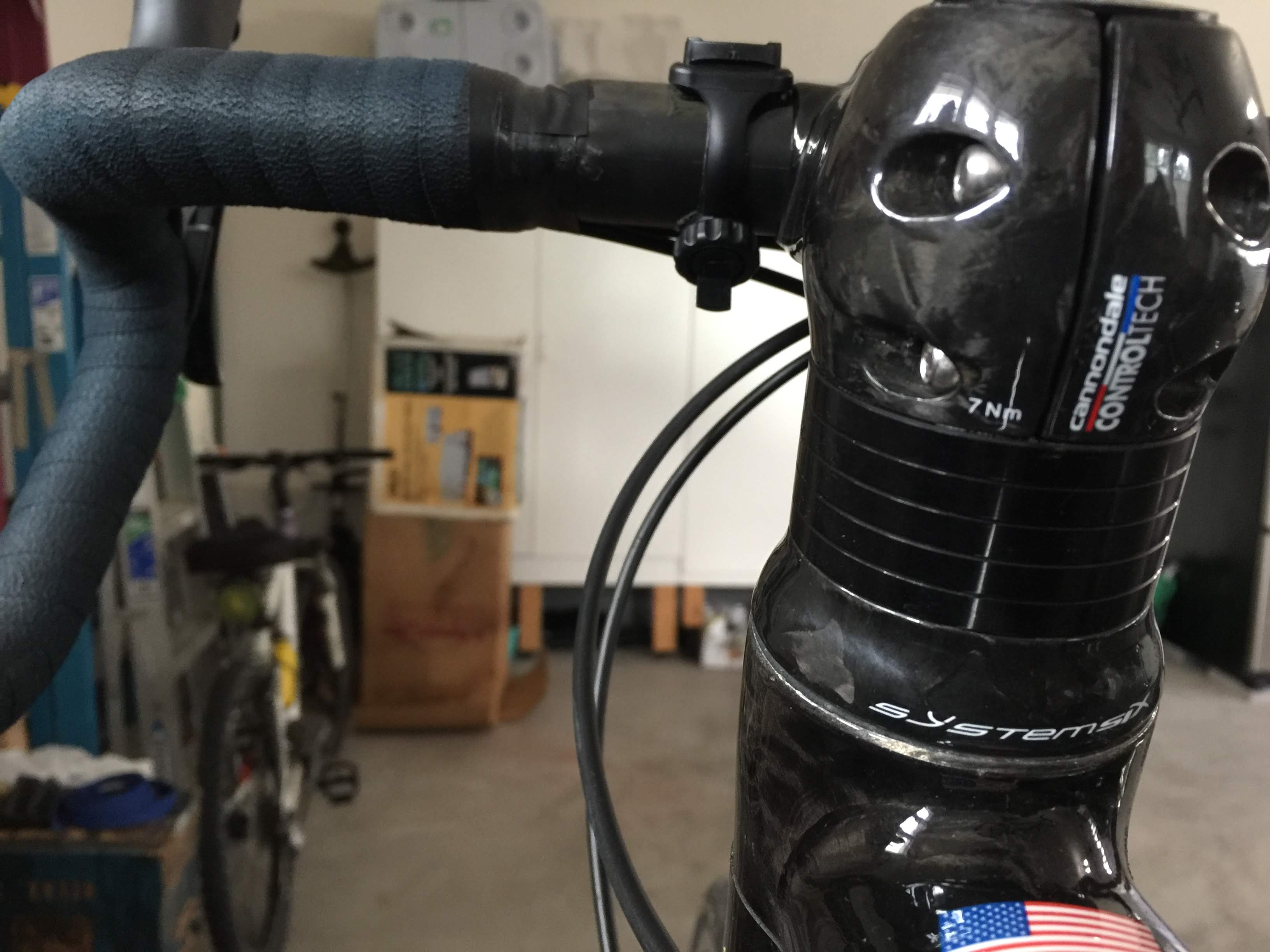

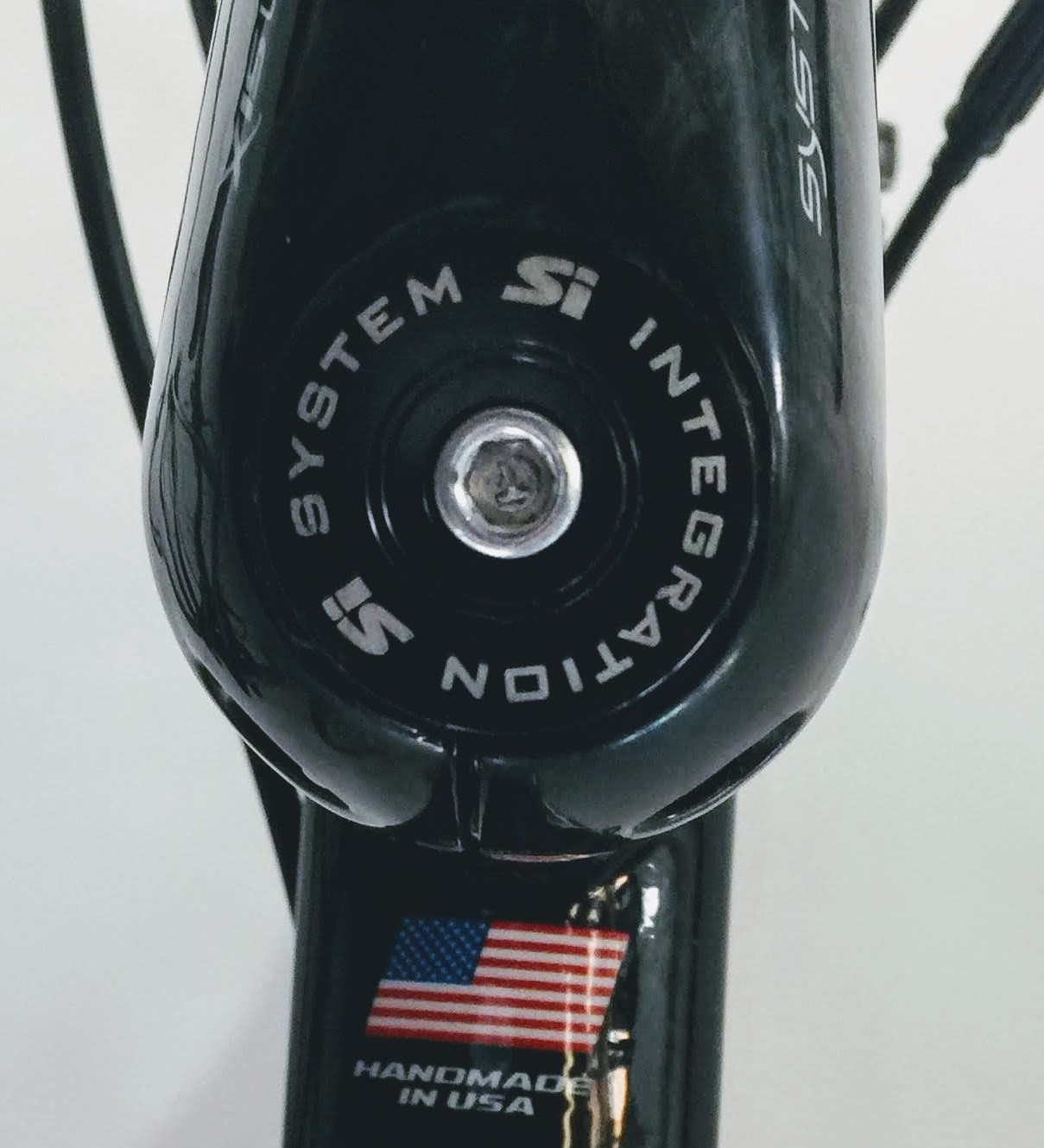

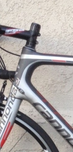

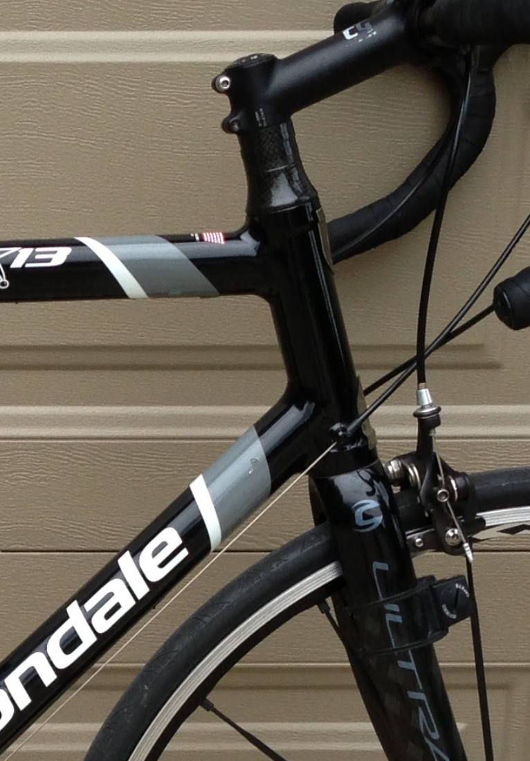

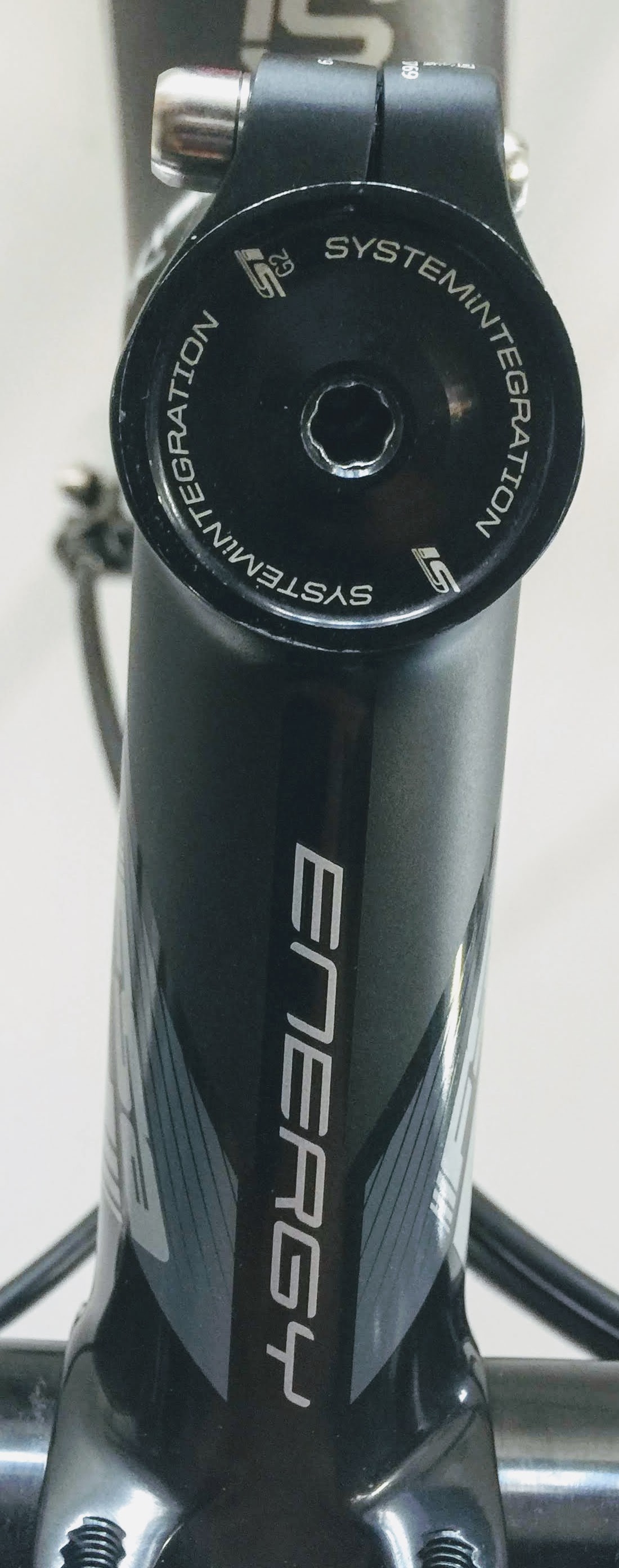

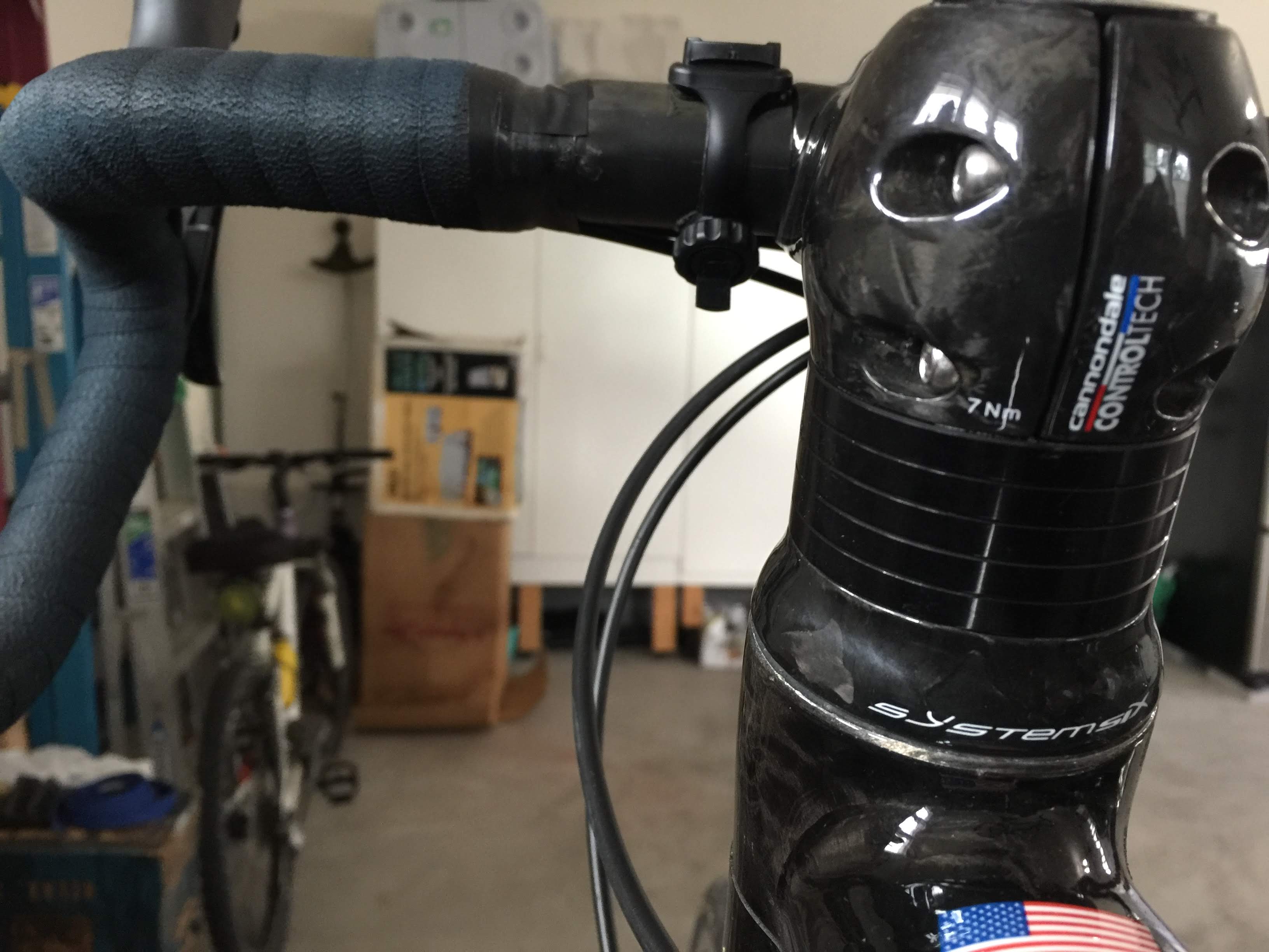

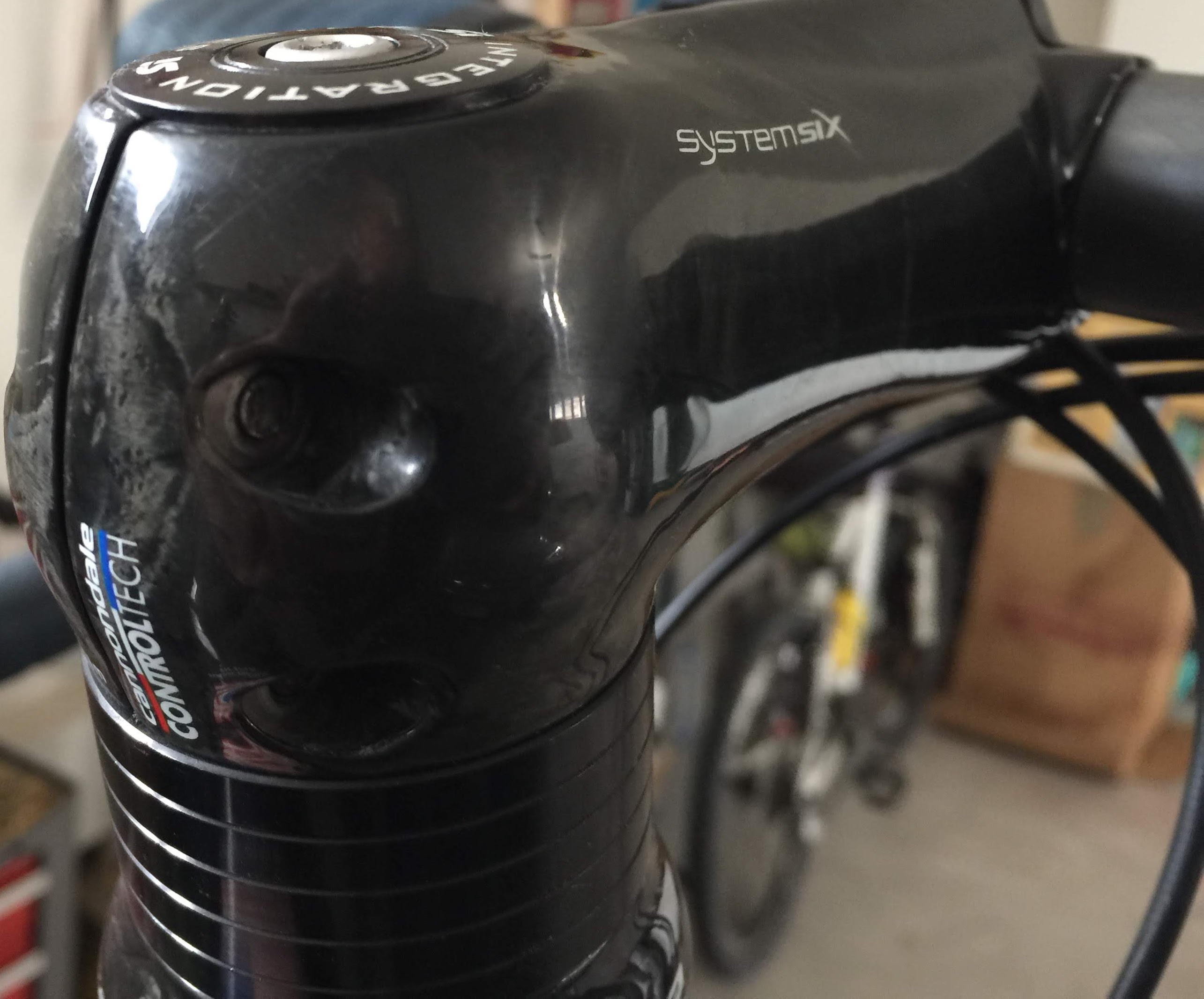

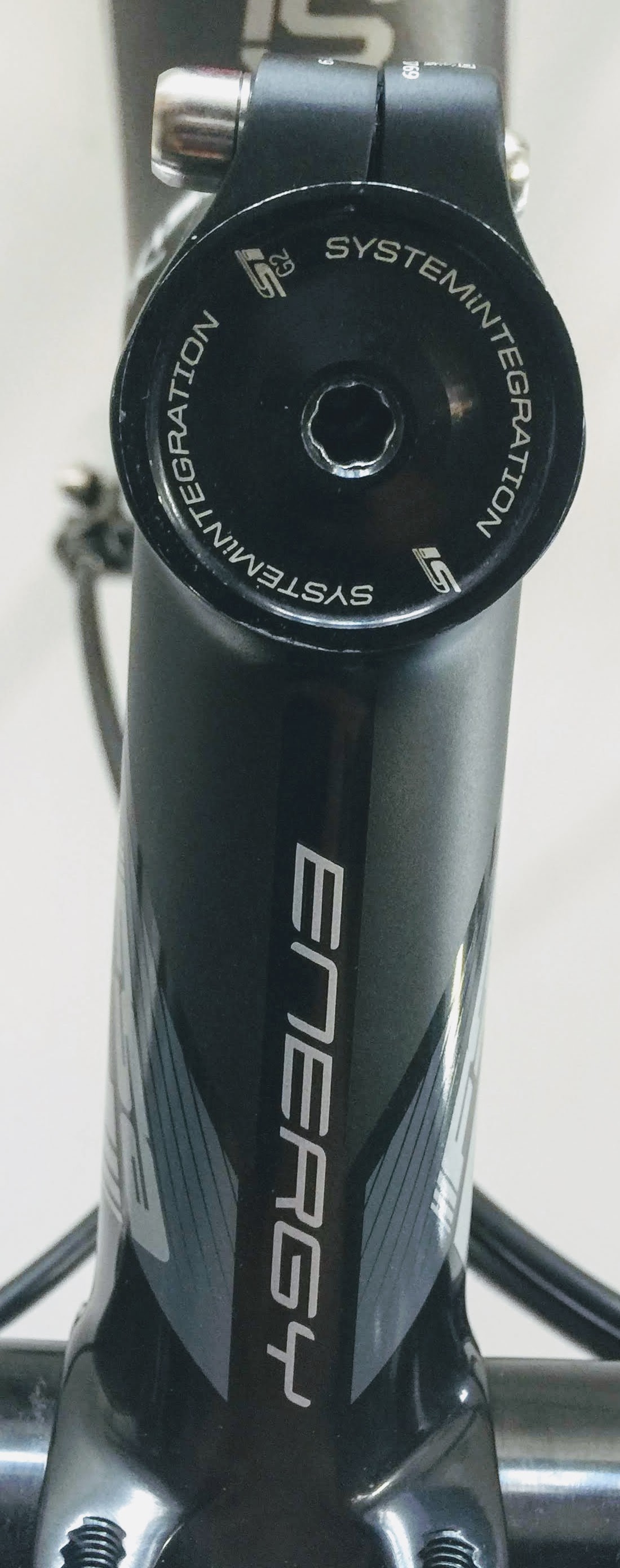

The Six13 and Evo use 35mm OD spacers. The SystemSix uses a 50mm OD spacer. I have attached photos from my 2007 black Six13, my silver 2015 Evo and my 2007 SystemSix showing the steering spacers and stem so you can see how large the section of the frame is where the steerer tube goes through on the SystemSix.
You are correct regular 35mm spaces would work it is just they would look really small sitting on top of the frame section where the steerer tube goes through but that may be my only choice. I was really hoping to keep the 50mm spacers on the SystemSix and find a stem with a 50mm width where it attaches to the steerer. They do exist. The Zipp SL carbon stem is like that but it is $265.

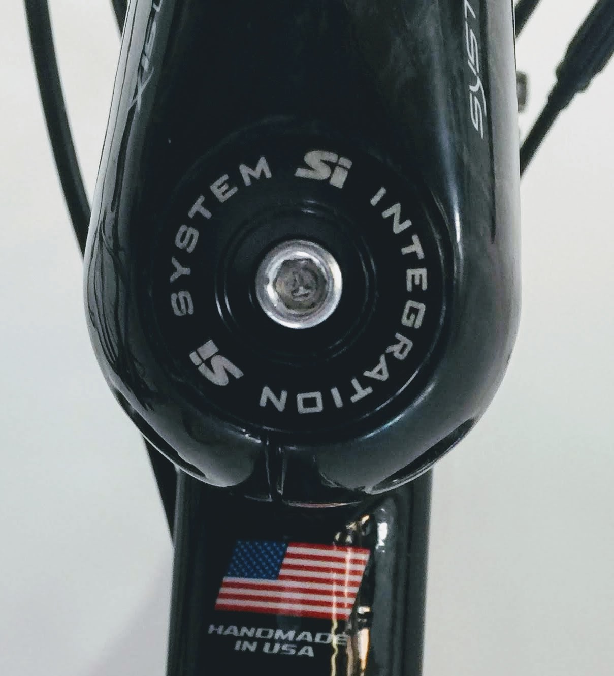

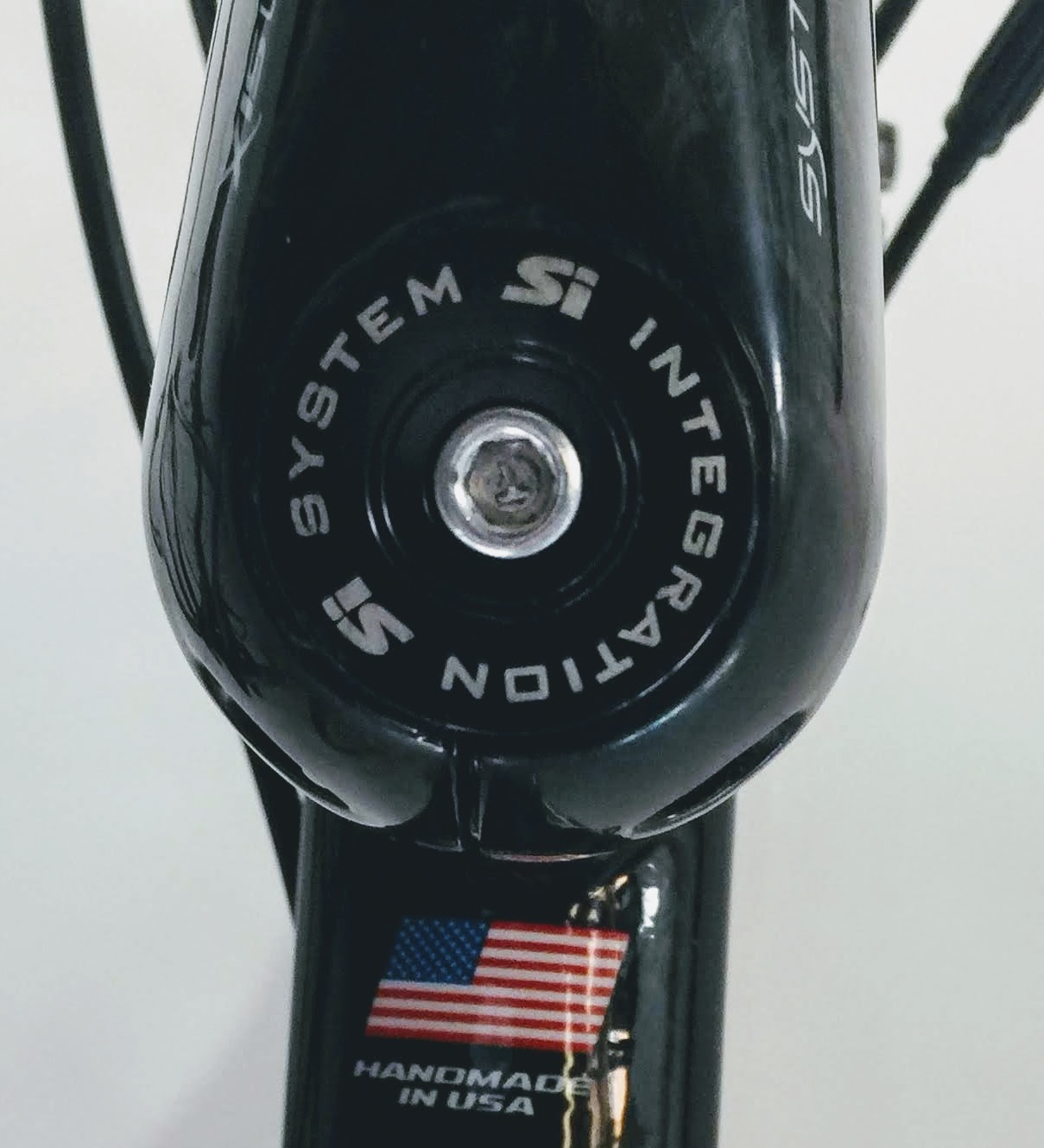

Could you change the headset top cap to one with a radius/taper like the Six13 has, so there's no step in the transition to the spacer(s)? Close up photo of your SystemSix top cap and spacer would help me understand the problem. I've never seen one of these bikes or even a decent photo of one.
Sftwengnr

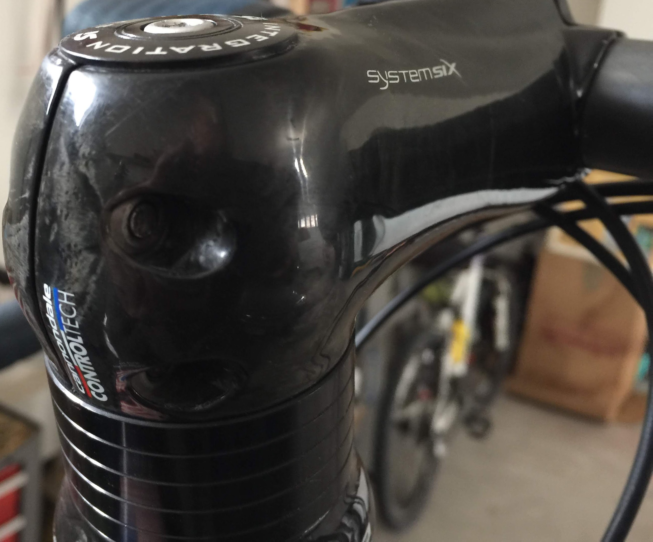

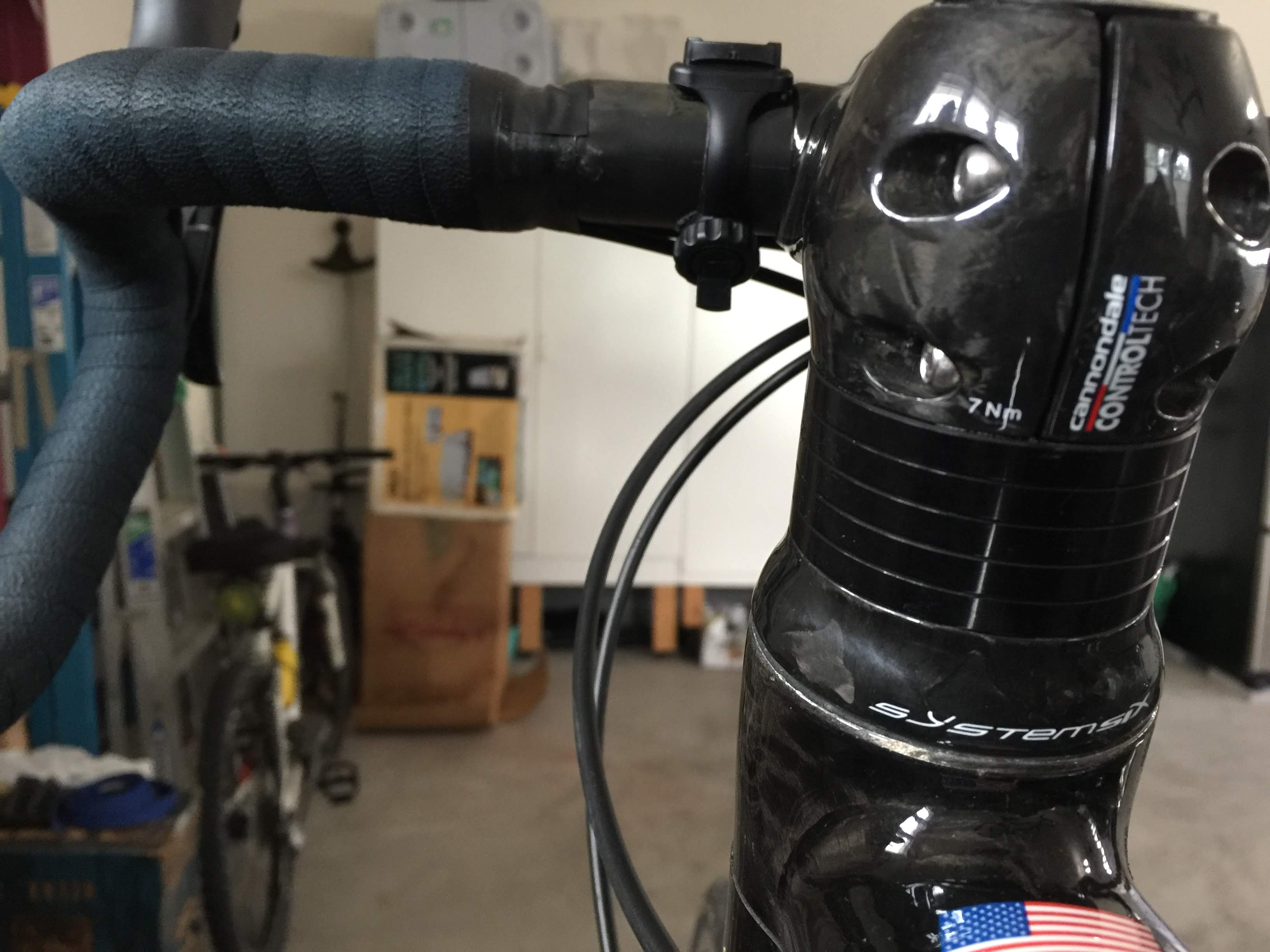

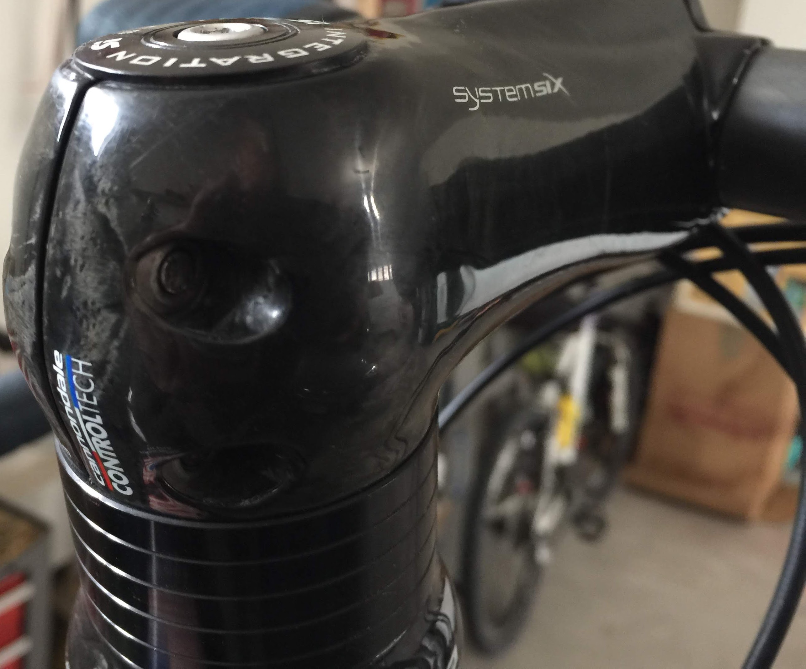

I am attaching some close ups of the stem and top cap along with the stem and top cap of my Evo for comparison.
Hopefully you can see the difference in sizes.
