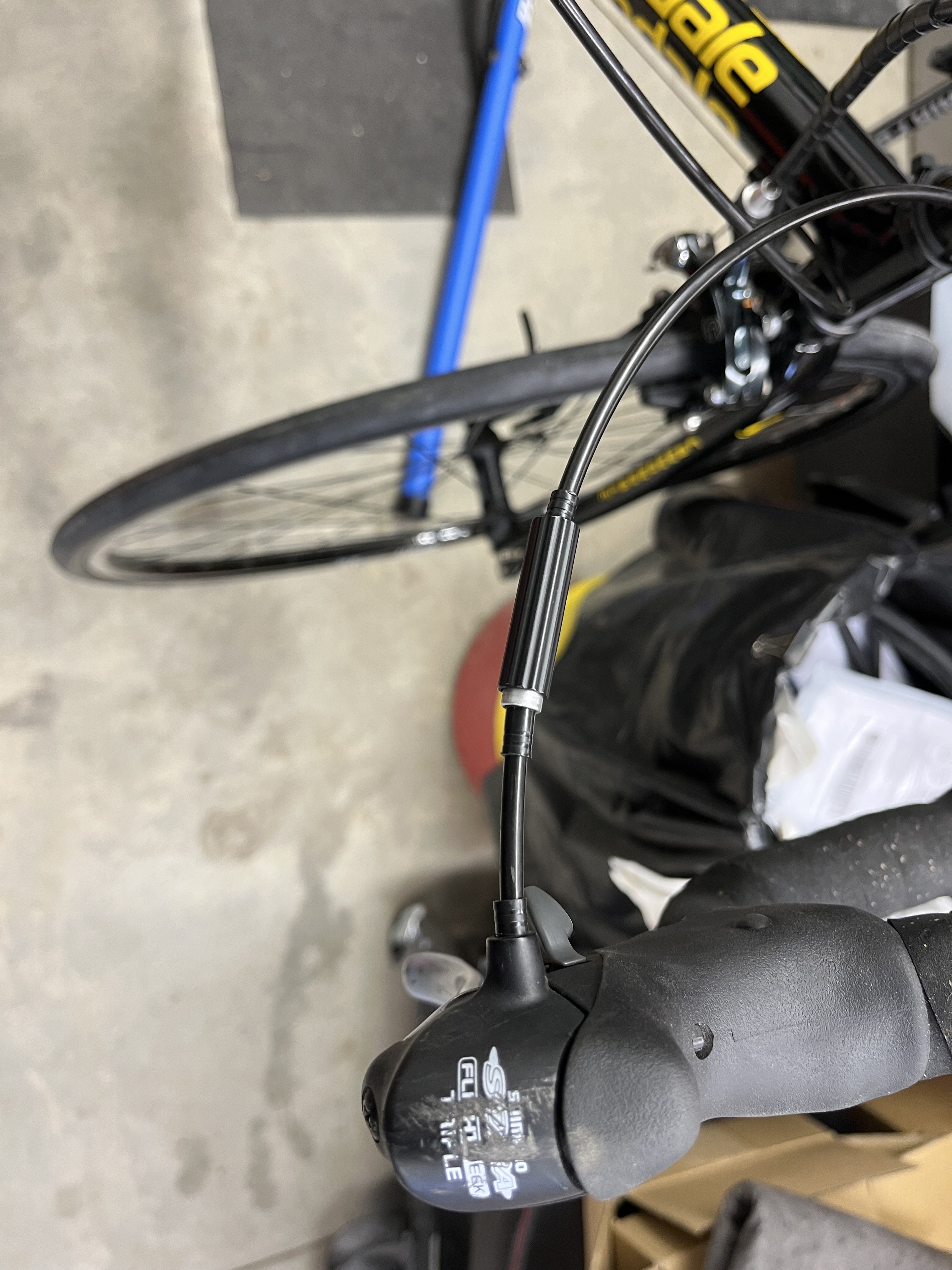

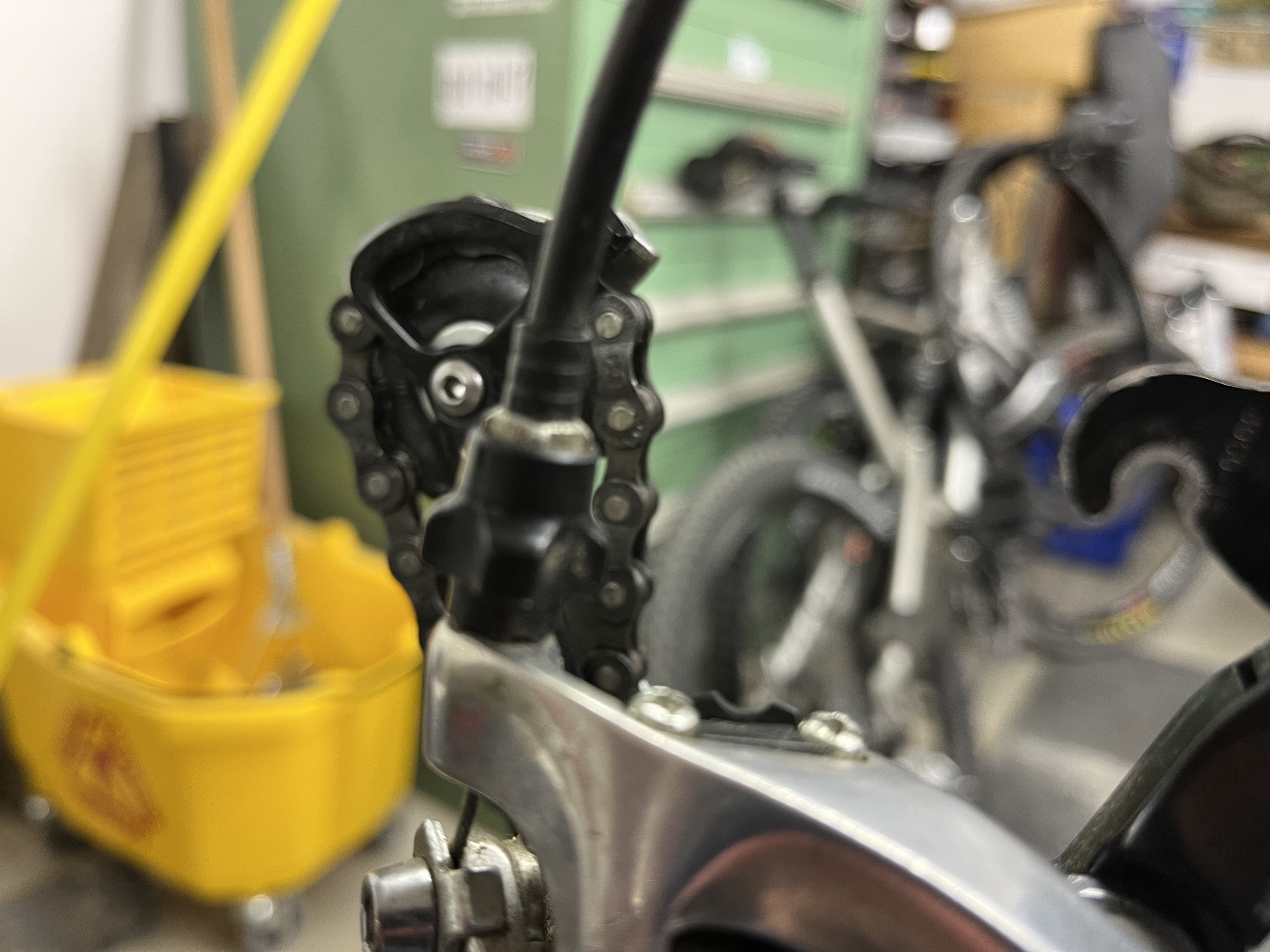

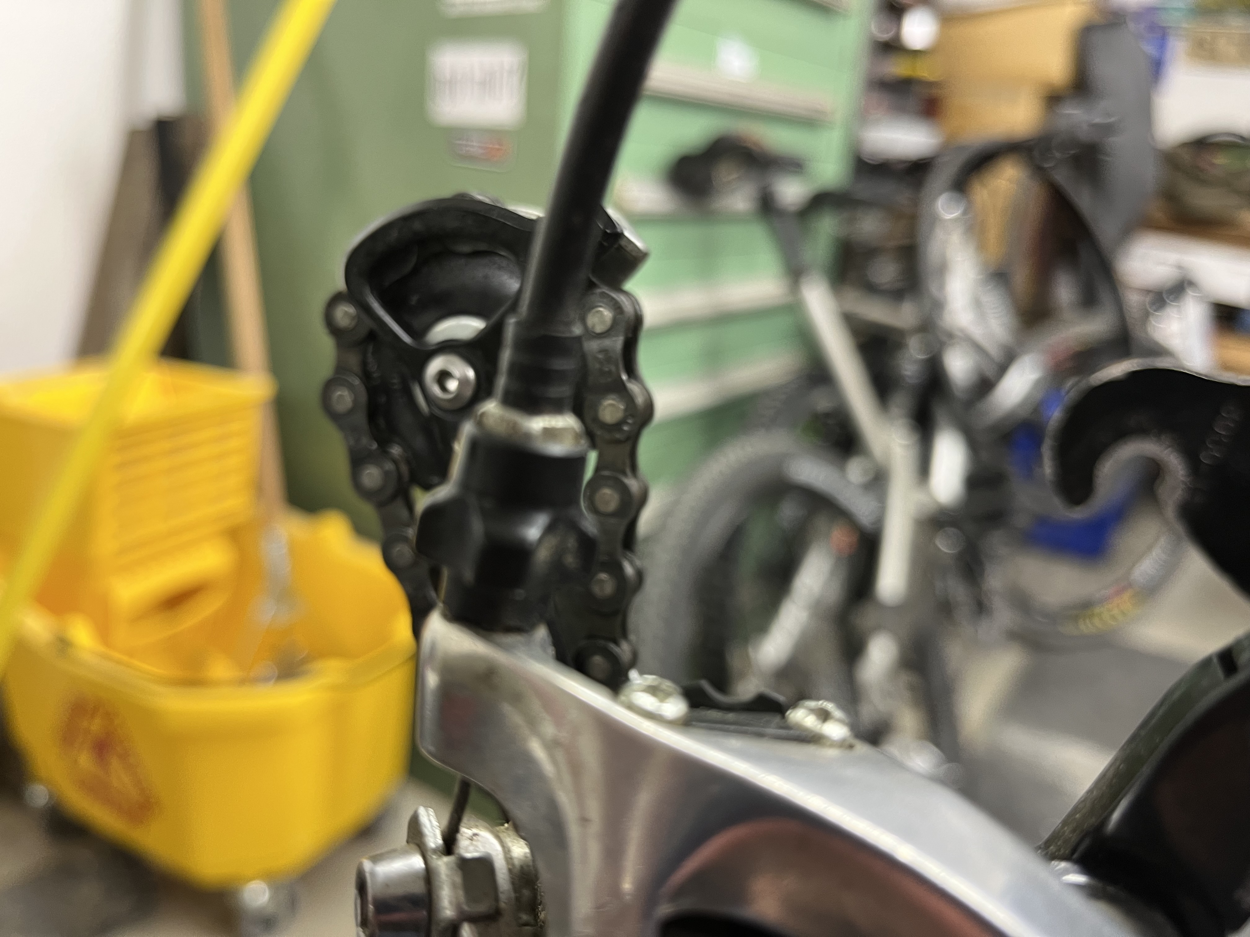

And I don’t have a barrel nut for fine tuning cable tension on the front derailleur cable like I do on the rear cable. As pictured here:
Not sure what that means going forward. I’m learnin’.
The only CAAD3 frame I have is a first year R4000 and it has down tube shifter bosses, so that's where the cable adjusters are located if you have bar mounted shifters. I couldn't tell from the pictures what your frame has but it may only have cable casing stops. In that case what you want is an inline cable adjuster at least for the front. They are typically installed a couple of inches from the shifter so they can be adjusted on the fly. You could put one in the rear shift cable as well if you wanted to be able to adjust it while riding. I generally don't bother with the rear as it's usually simpler to stop and make the adjustment at the derailleur than to fiddle with the inline adjuster.

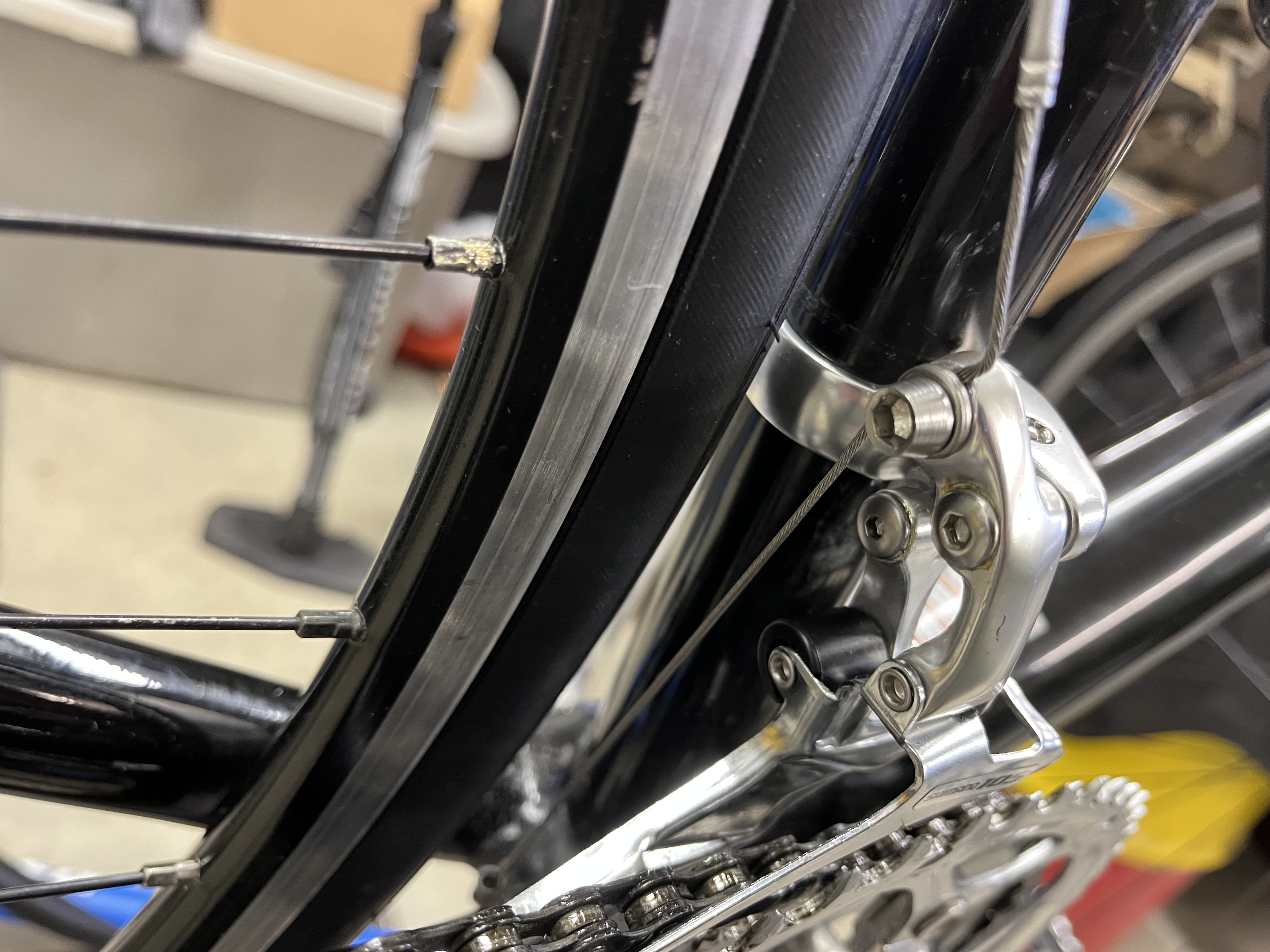

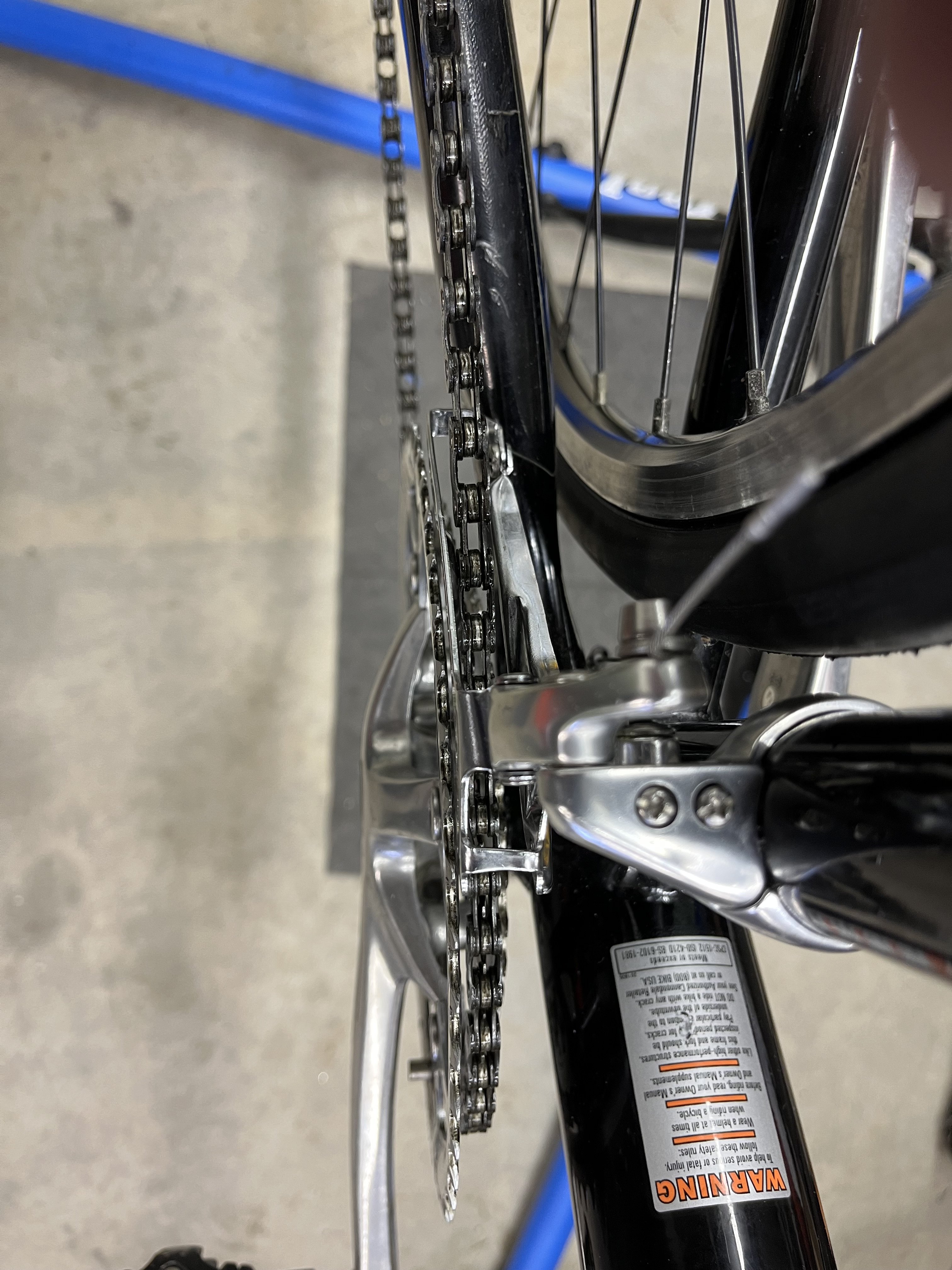

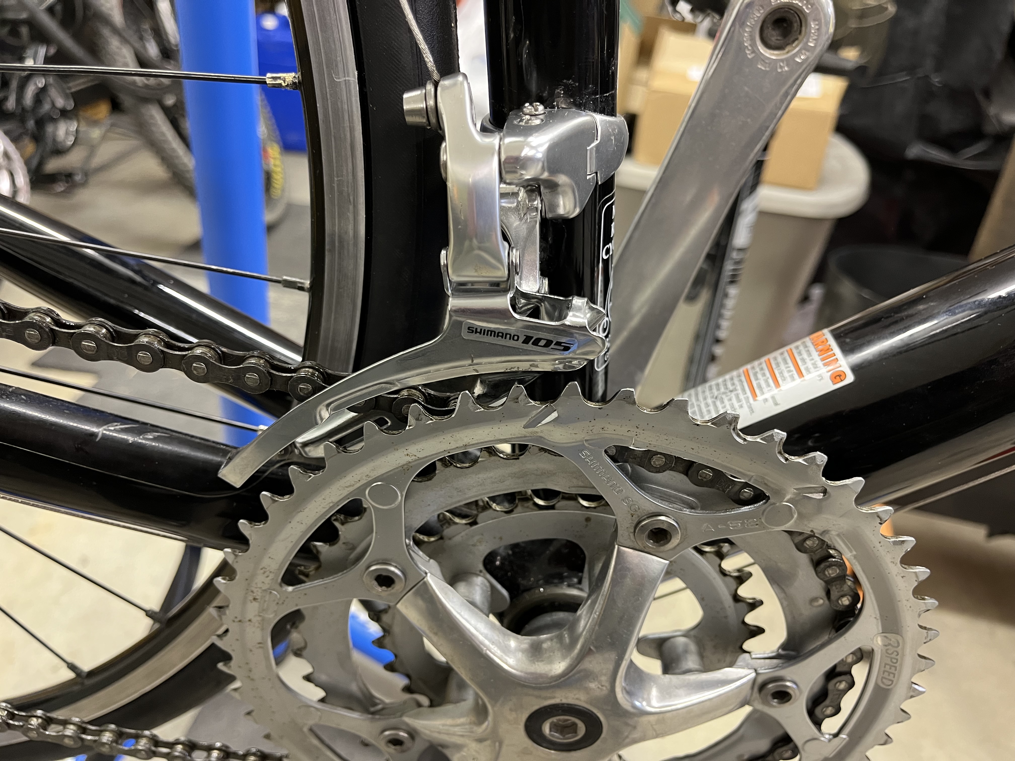

I’m having difficulty with the new FD. First thing I noticed is the return spring in the new 105 FD is quite a bit stronger than the previous Sora FD. Second is the limit screws seem to me as having very little effect in positioning the cage.
I can get the L limit screw set up nicely for the small chain ring. To get to the center chain ring I think I’m having to adjust cable tension just right. Very sensitive. Once I have the chain rings shifting nicely between the center and small ones I then move onto the big chain ring. That is where I’m struggling. The H limit screw does very little and the only way I’ve been successful is by adjusting cable tension. And when I do the previous set up for the small and center chain ring goes away.
Maybe my initial cable tension is too tight (it is loose for L screw setting) or my cage alignment isn’t spot on.
The rear derailleur works ok. I will need to fine tune it. I don’t know if it is affecting my FD tuning.
I get a fair amount of chain rub while on the small front chain ring and if I’m on any one of the smallest 4 rear cogs.

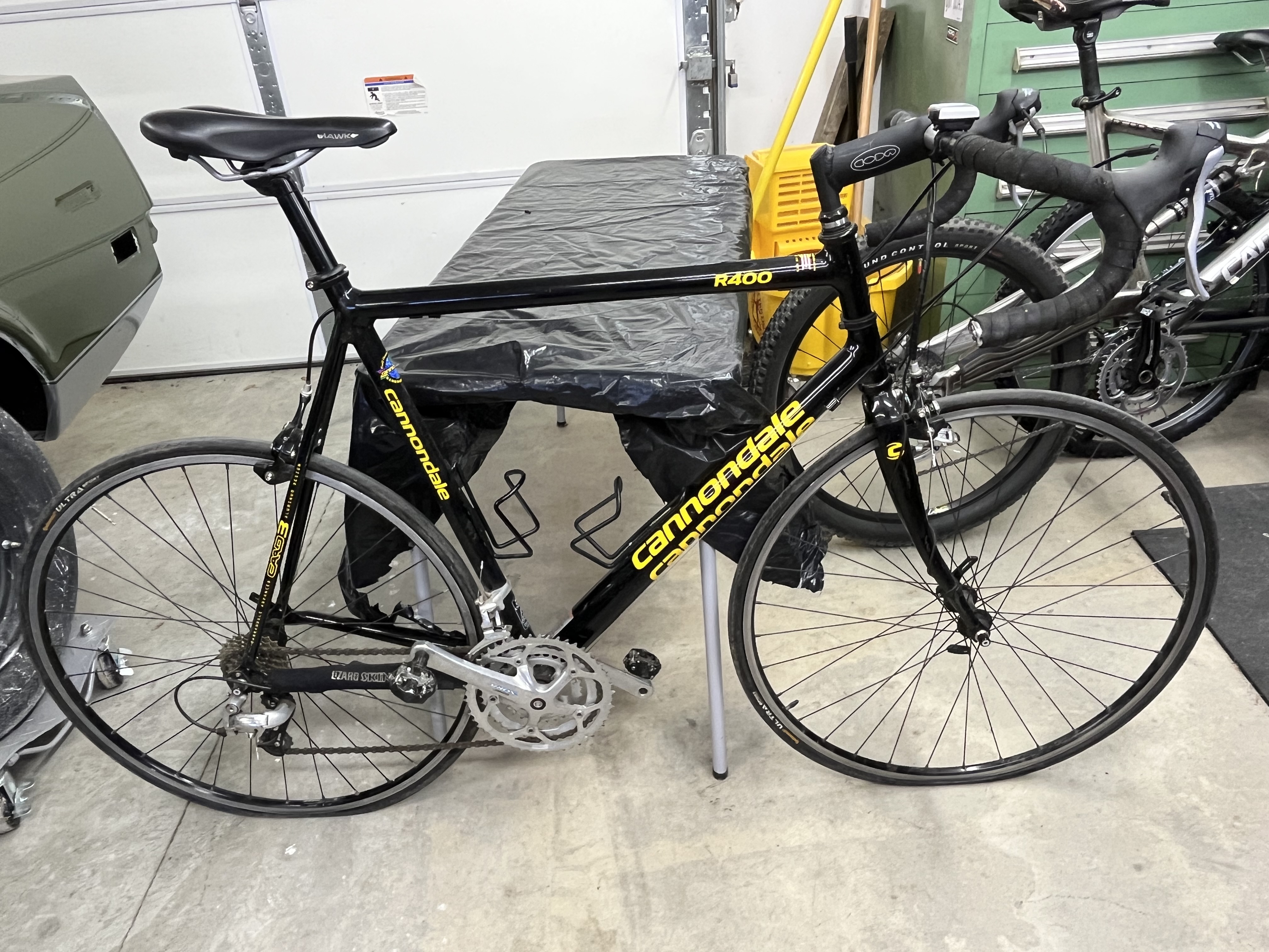

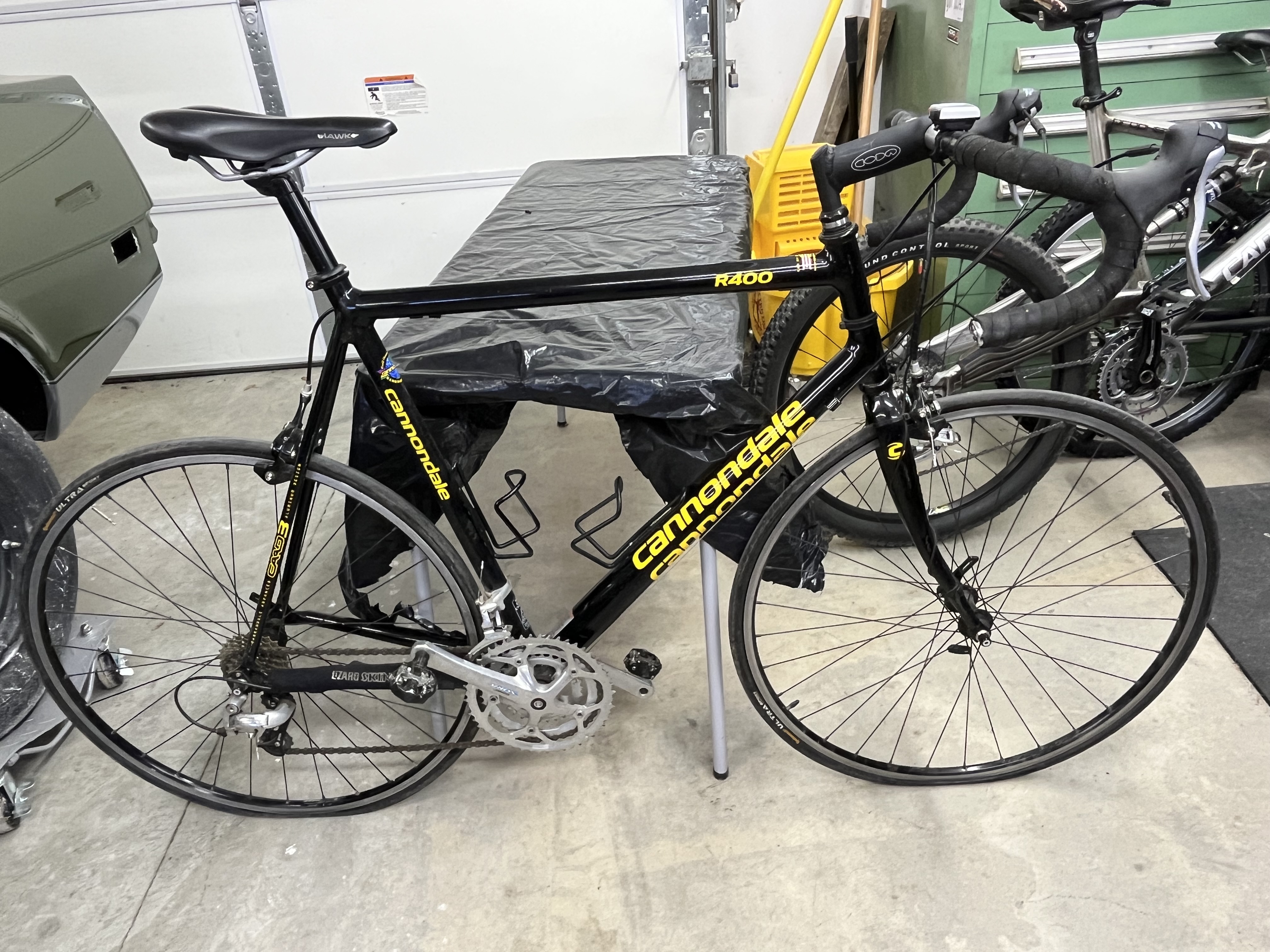

I just have to say something about this bike. It is very quickly turning from a clean but battered and slightly broken/bent "cheap" bike into one very nice looking ride. Keep up the hard work!
Thanks @JohnnyD ! The NOS blemished 105 FD I got from epay cost me half of what I paid for the whole bike.

While my morning coffee was brewing I went out to the “bike shop” and had a look. I must have stared at the FD yesterday for too long. It was not parallel as I looked at it with rested eyes. Even looking at the above posted picture I can see it now. So I adjusted that. A lightbulb went on in my grey matter and I gave the cable more tension at the pinch-bolt. And voila! It works! There is minor chain rub on the cage while on the small chain ring. I’m almost afraid to touch the L limit screw.
Five minute fix after chasing my tail for hours.
I spent too much time yesterday trying to achieve proper cable tension using the “barrel” by the shift lever. It works for that…to a point. Maybe it worked fine when new or it is just a not so good way of getting the job done to begin with. The latter in my opinion.

I like to set FD limit screws with the FD cable disconnected I shift between rings with my left hand while turning the crank with my right. Set the inner limit so that it won't shift to the small cog, then back it out just until it shifts. Then check to see if the chain rubs in the small ring/large cog combination. If it rubs back the screw out until it no longer rubs. On the large ring, turn the limit screw in until the chain rubs while in the large ring/small cog combination, then back it out until rubbing stops. Next check to be sure it will shift from middle to large ring. If not, back the limit screw out until it will shift. Once limit screws are right you can connect the cable. You will want the cable to be pretty tight initially, but not so tight that it moves off the limit screw. I set the cable adjuster fairly short initially but still leaving a turn or two to decrease tension, in case I pulled the cable too tight to start.

I like your idea for FD adjustment. Eliminate cable tension for the initial set up, makes quite a bit of sense actually.

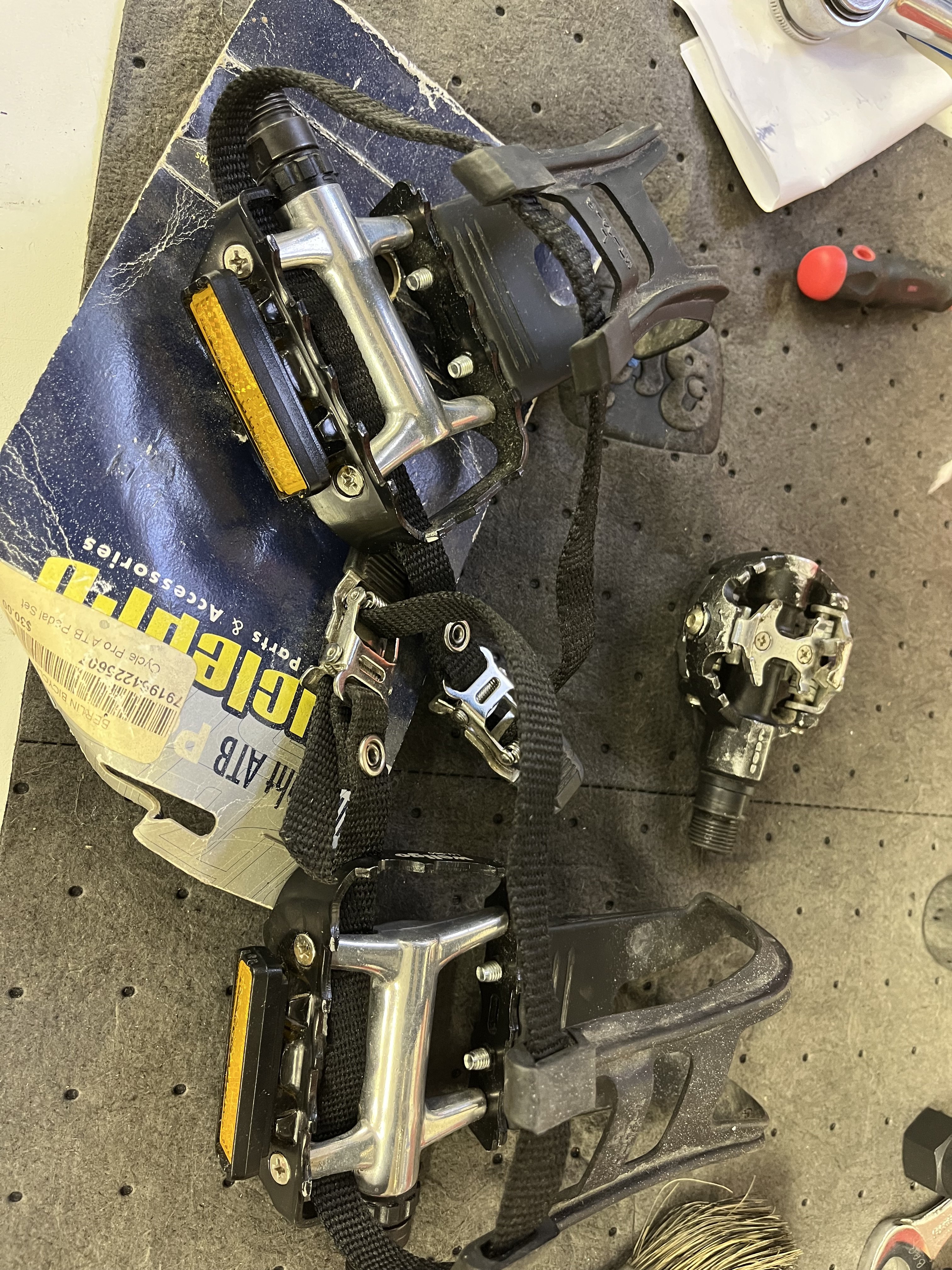

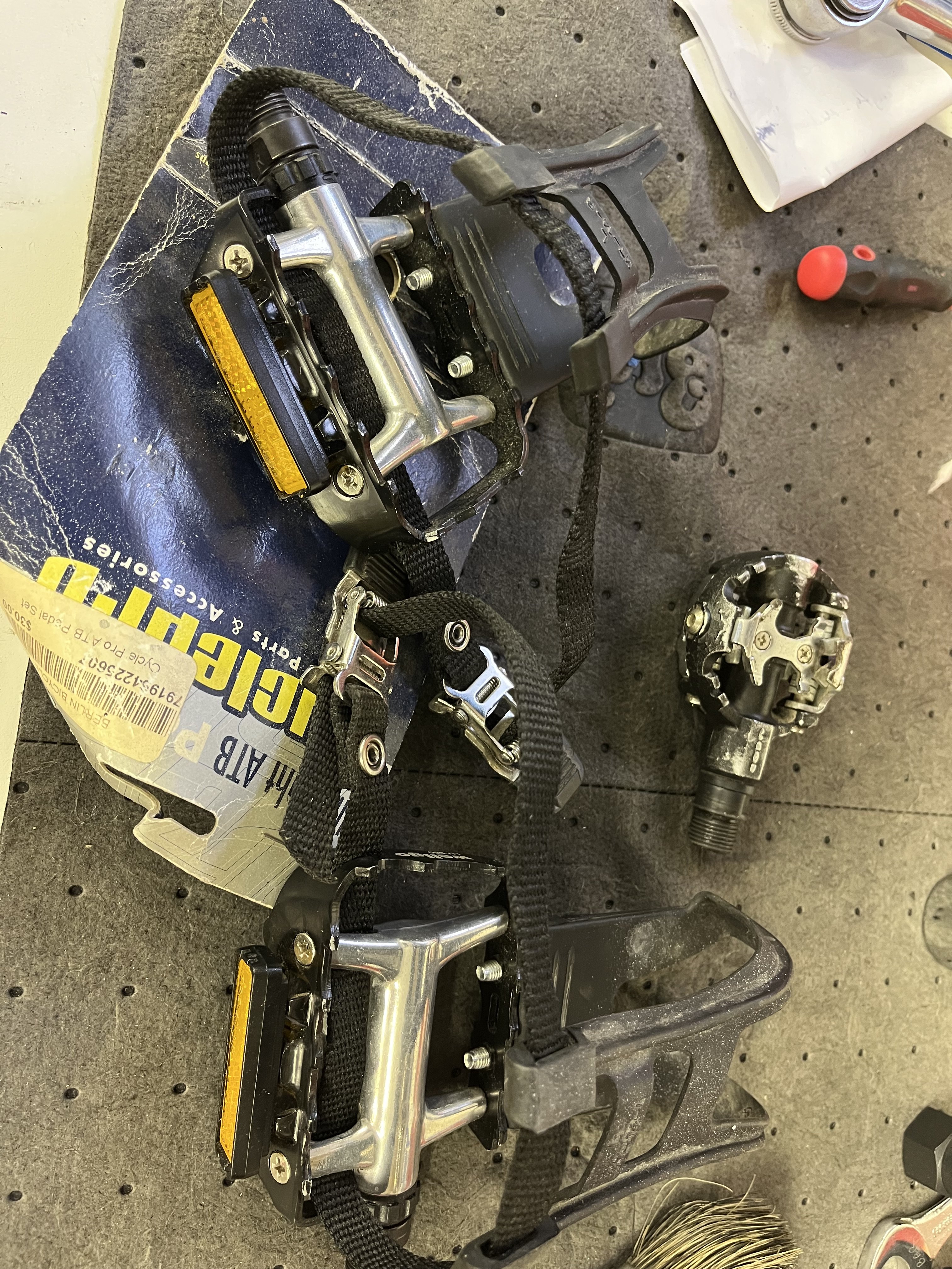

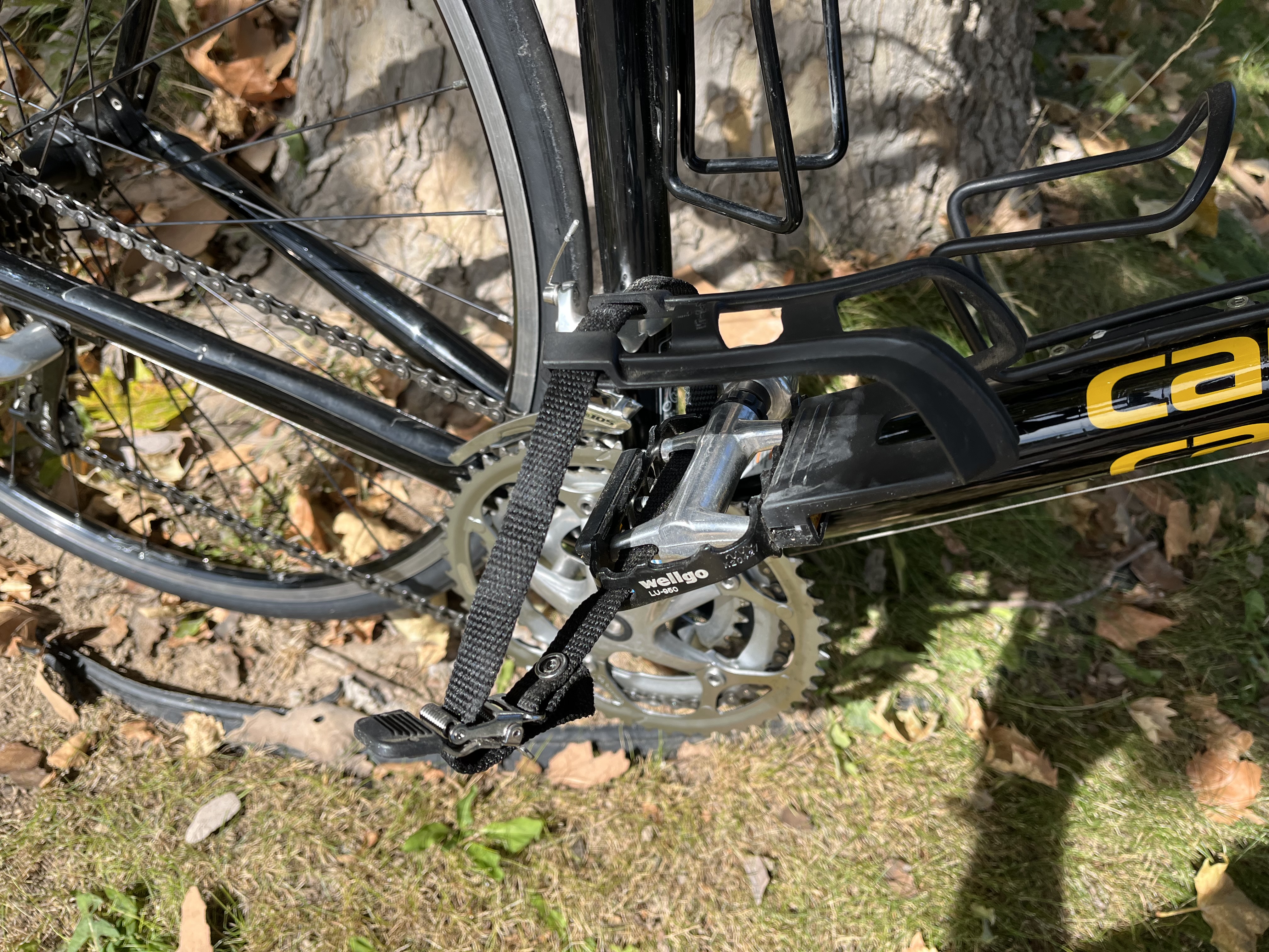

Brand new old pedals arrived in the mailbox today. Swapped out the clipless. Took the R400 for a quick 2 mile ”sprint”. Rear derailleur needs some adjustment. Running the pedals backward, the top jockey wheel is contacting cogs.
