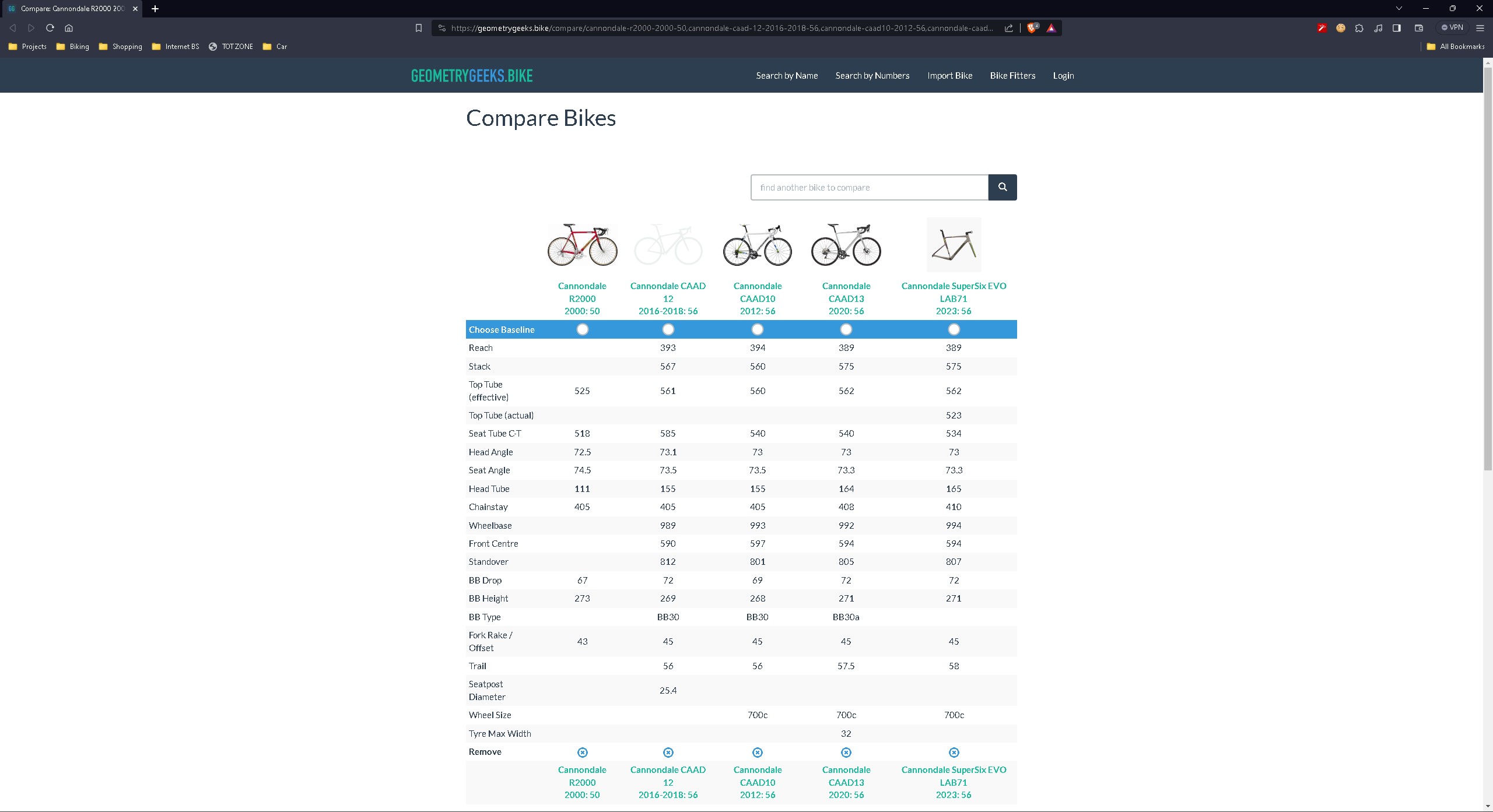

So here's is the geometry specs for a 2000 R2000, CAAD 10, 12, 13 and even the new(ish) superbike the SuperSix Evo Lab71
Or you can see the webpage for yourself here
Interesting to see how little has changed significantly on road/race frames. Materials and aero have really improved(subjectively IMHO) been the biggest game changers.
My feeling with no data to support it is that there is very little performance advantage from a current road frame compared to one from 15-20 years ago. The weight of the frames may be a bit lower now but the difference wouldn't affect the average rider to any degree. Back when I was racing occasionally I did several test rides to compare my 1987 Cannondale to my 1970s Reynolds 531 Bob Jackson. I never once attained the same average speed on the Jackson over the same route as I did on the Cannondale. Whether that was due to my ability/effort on any given day is a possible factor but I came to the conclusion that the stiffness of the Cannondale was the difference. As time passed I think builders who worked with all the various frame materials were able to get pretty much equal performance by manipulating tube diameters and shapes.
I agree with you 100% on there is no noticeable advantages of modern vs. older frames, other than minor weight and aero. I believe it is due to the fact that the basic "template" of an efficient road has been achieved. Unlike MTB's, which have changed dramatically due to the ever increasing technology/designs that are allowing riders to tackle bigger and more difficult terrain and obstacles.

Very interesting observation about the geometry. But I would assume you can correct slight deviations with stem, bar and seat post.
My 2019 Tarmac SW SL6 is way more comfortable over my CAAD9. And it has disc brakes. And I can put on 28 mm tires and these have significant real world advantages. Just three things that come to my mind and I am sure these apply to the Super6 as well.
The frame is also 400 gr lighter but it is not fair to compare aluminum with carbon for that purpose.
Anyways, still very much enjoying riding my CAAD9.
