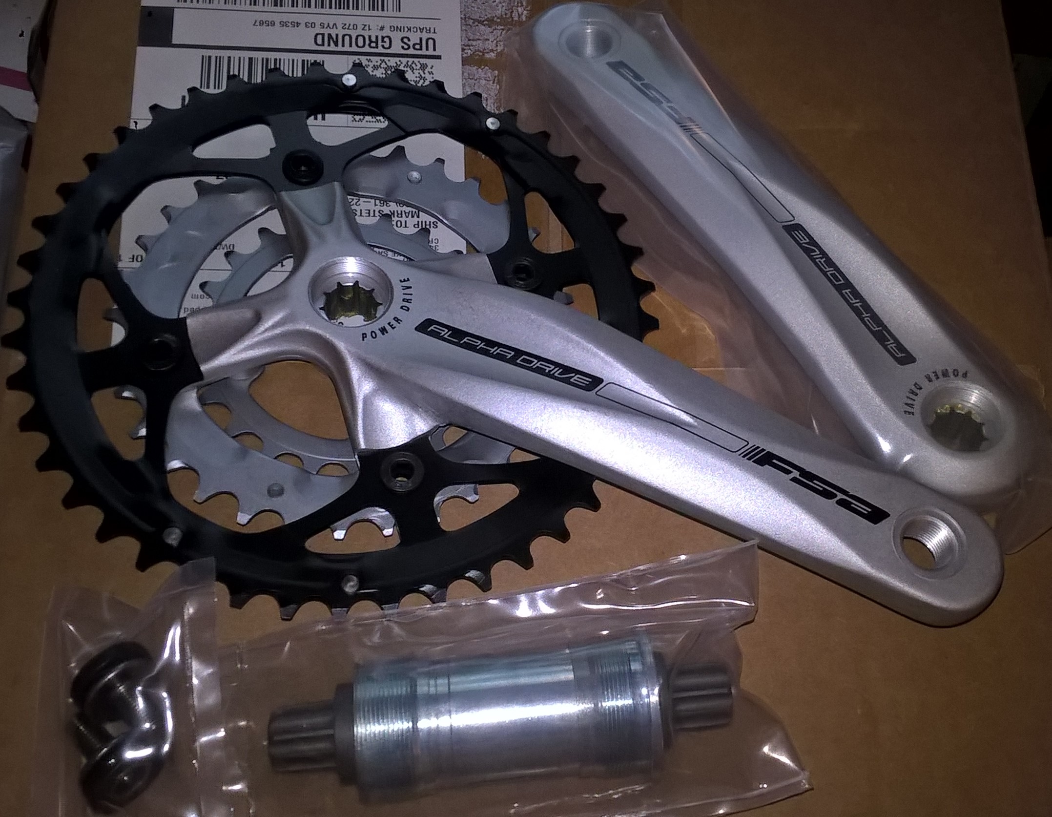

I have several NOS four arm FSA Alpha Drive 22/32/44 cranksets if you don't care about the crank matching the vintage of the bike. I have 170 mm in square taper, ISIS, and FSA Power Drive styles. Some have bottom brackets but I would have to check and make sure they are for 68 mm shells. Nothing fancy but I have them on 3 or 4 bikes and they work fine.
echoplex
Hmm, that might be a relatively quick and cheap (..?) way to go. I don't care too much about vintage-correct on this bike (I guess aesthetically it'd be nice if the crank was silver, but I'm assuming they're black. How much would you want for a set with BB (if you have it)?
Silver but not polished. All three rings are steel so it's not the lightest.
$60 shipped in a flat rate Priority bubble envelope or $65 in a medium flat rate box with the FSA box.
