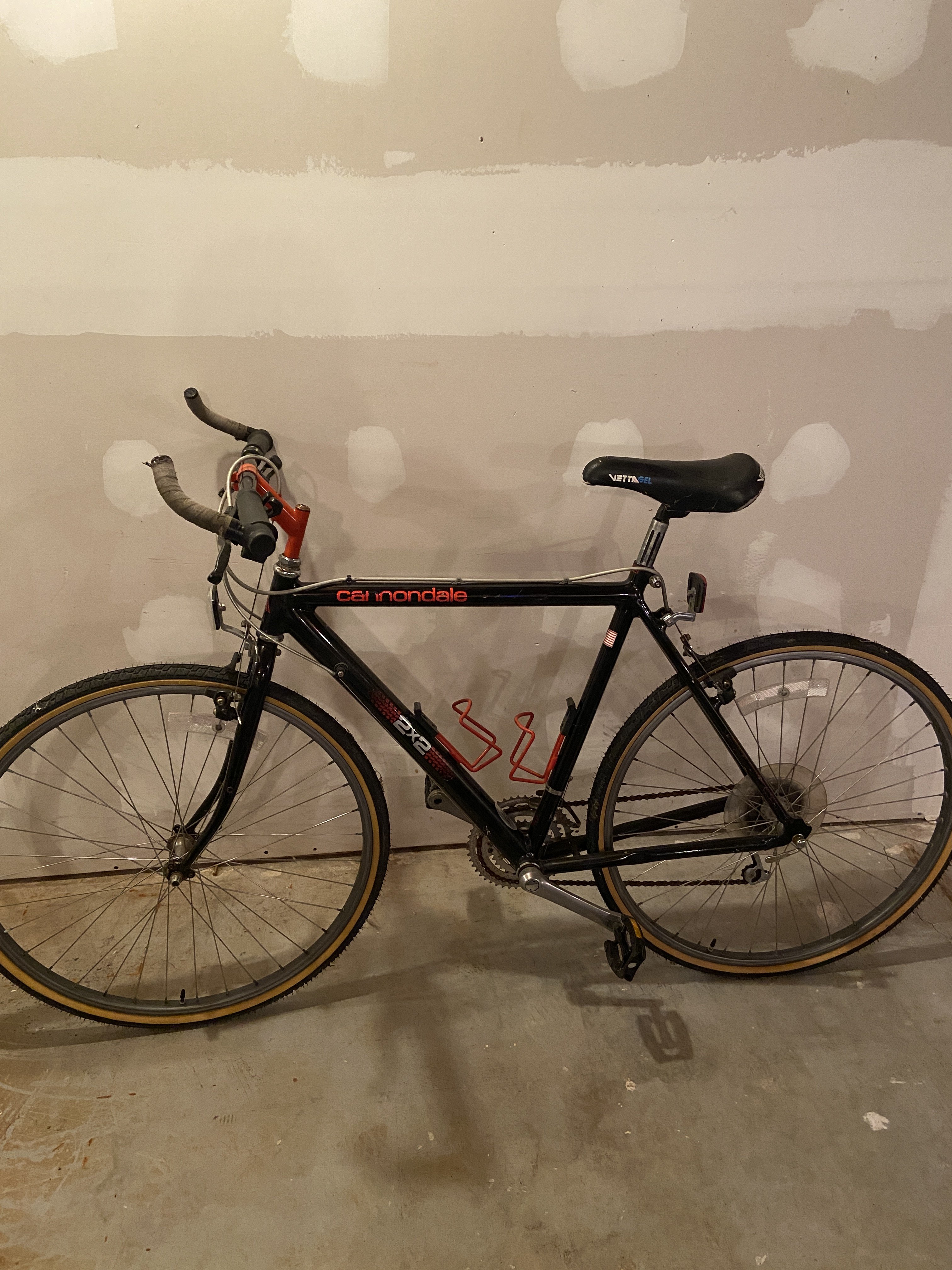

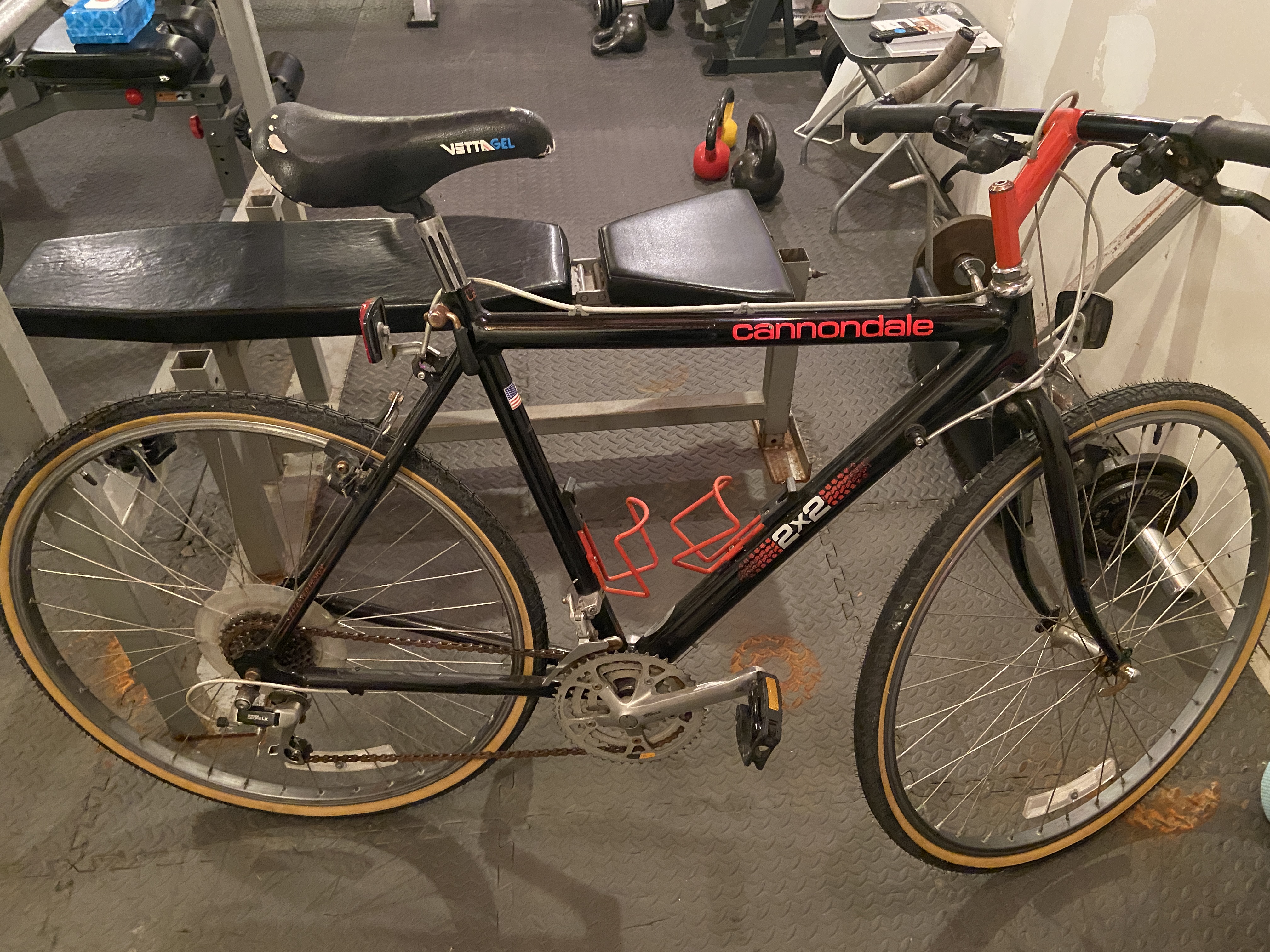

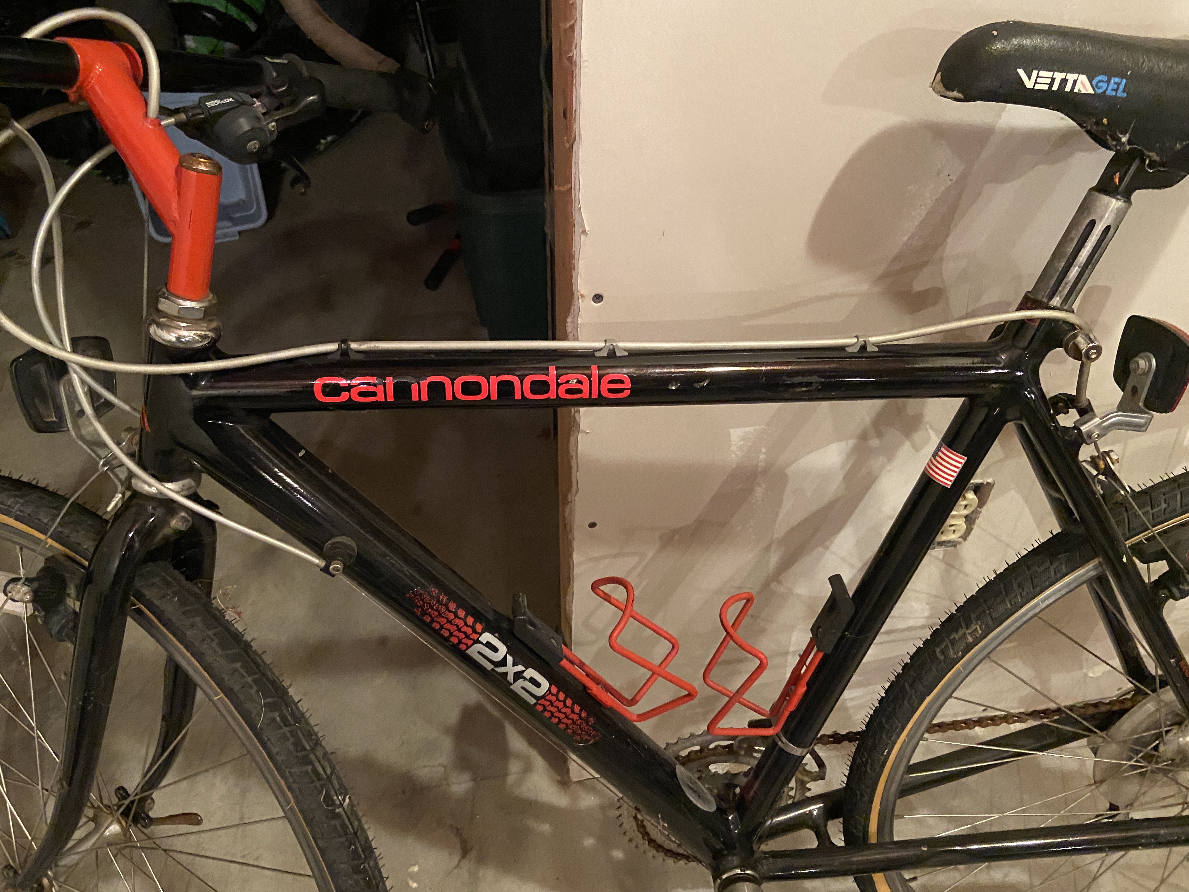

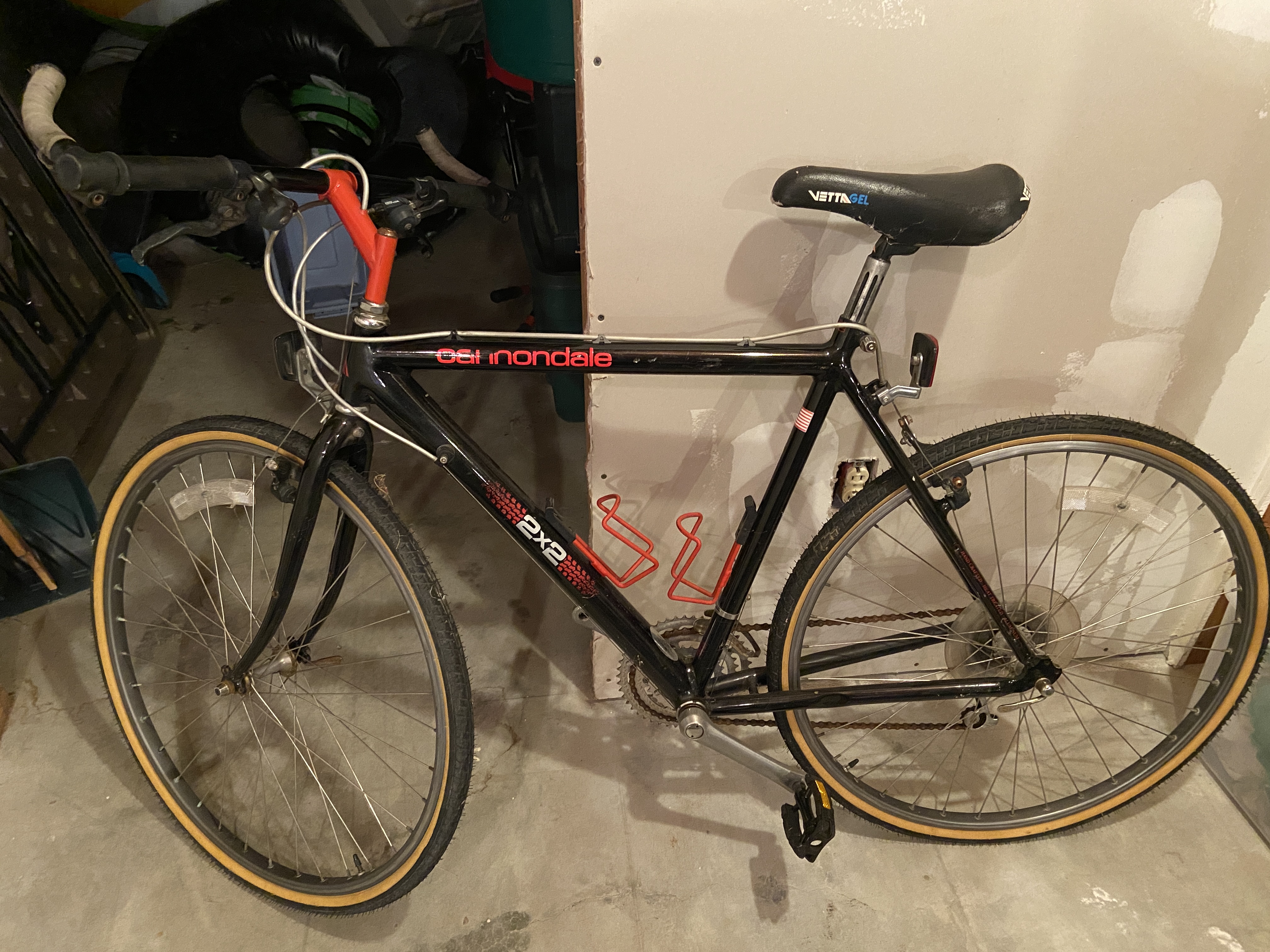

Hi, I have a 1990 SH600 2+2 serial number is 02101907720 looking to sell, was a great bike. Cleaning basement prior to moving. email direct at hattertown@aol.com if interested, would be nice to get it a great home. Joe
I've been looking for an SH for a while. That's a 21" frame, I'd be very interested if it were larger. Good luck finding a new owner for it. For anyone interested: It's made for 700c wheels and came with 35 mm tires originally. Original spec was Shimano LX/DX 7 speed, which generally speaking will run forever.
