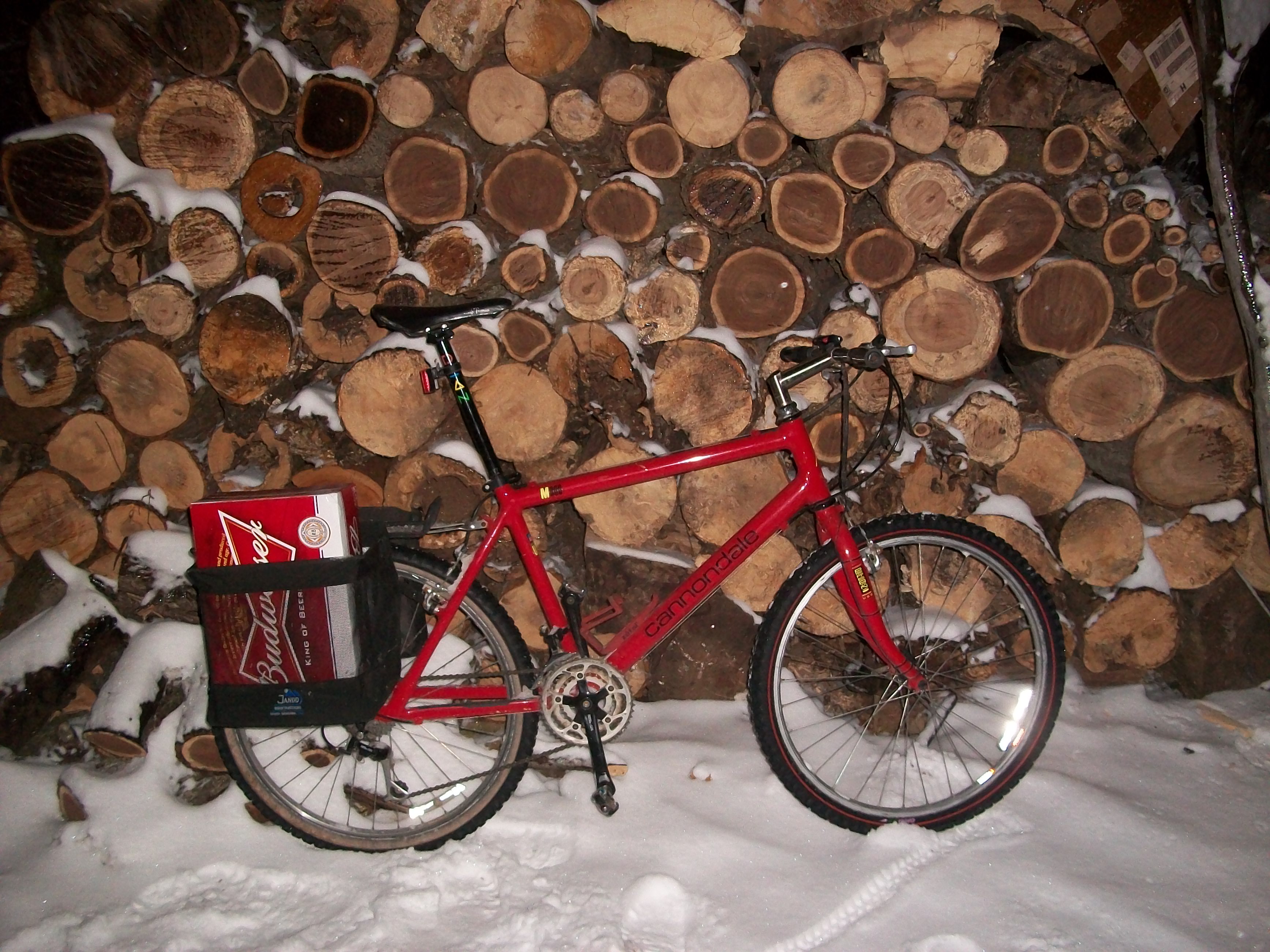

Welcome. Nice Beast. I have a '93 that I purchased in basically new condition in the mid 90s. Have never needed to upgrade any of the original LX parts. It doesn't get ridden as much as it used to but it's still a great bike.

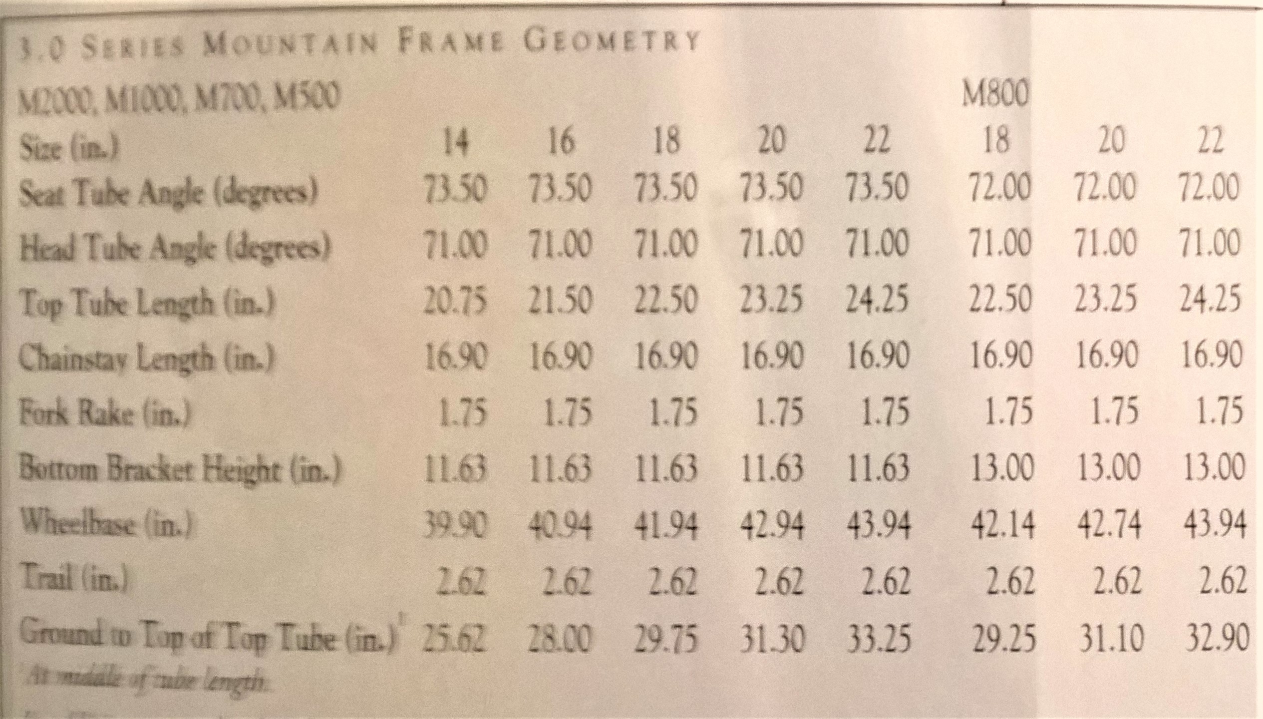

Thanks! Looking good in the snow there, awesome to see cargo on an M800. Only parts I never touched on mine were the stem and headset. Both going strong but I’d like to finally upgrade. Can anyone please share the dimensions of a 94 Beast of the East? I’ve forgotten over the sands of time. What size for a Chris King headset and a new stem? Very appreciated, Cheers.
Believe that picture was taken after I got home with a Campagnolo road wheelset in a box strapped on top, 15 miles with about 3" of snow on the roads. I also pulled a one wheel trailer loaded with 100 lbs. of groceries at times, 12 miles home as low as 20 degrees. Here's the geometry chart from the 1993 catalog. 1994 M800 had the same geometry. Note that the M800 is different from the other 3.0 frames. I would guess that your frame has a 1 1/4" headset, same as 1993. Better check the quill outside diameter though, should be 1.125" if headset is 1.25". If quill diameter is 1" you have a 1 1/8" headset. I might have some stem options, not sure about NOS though. 1 1/4 stems are kind of scarce these days.
