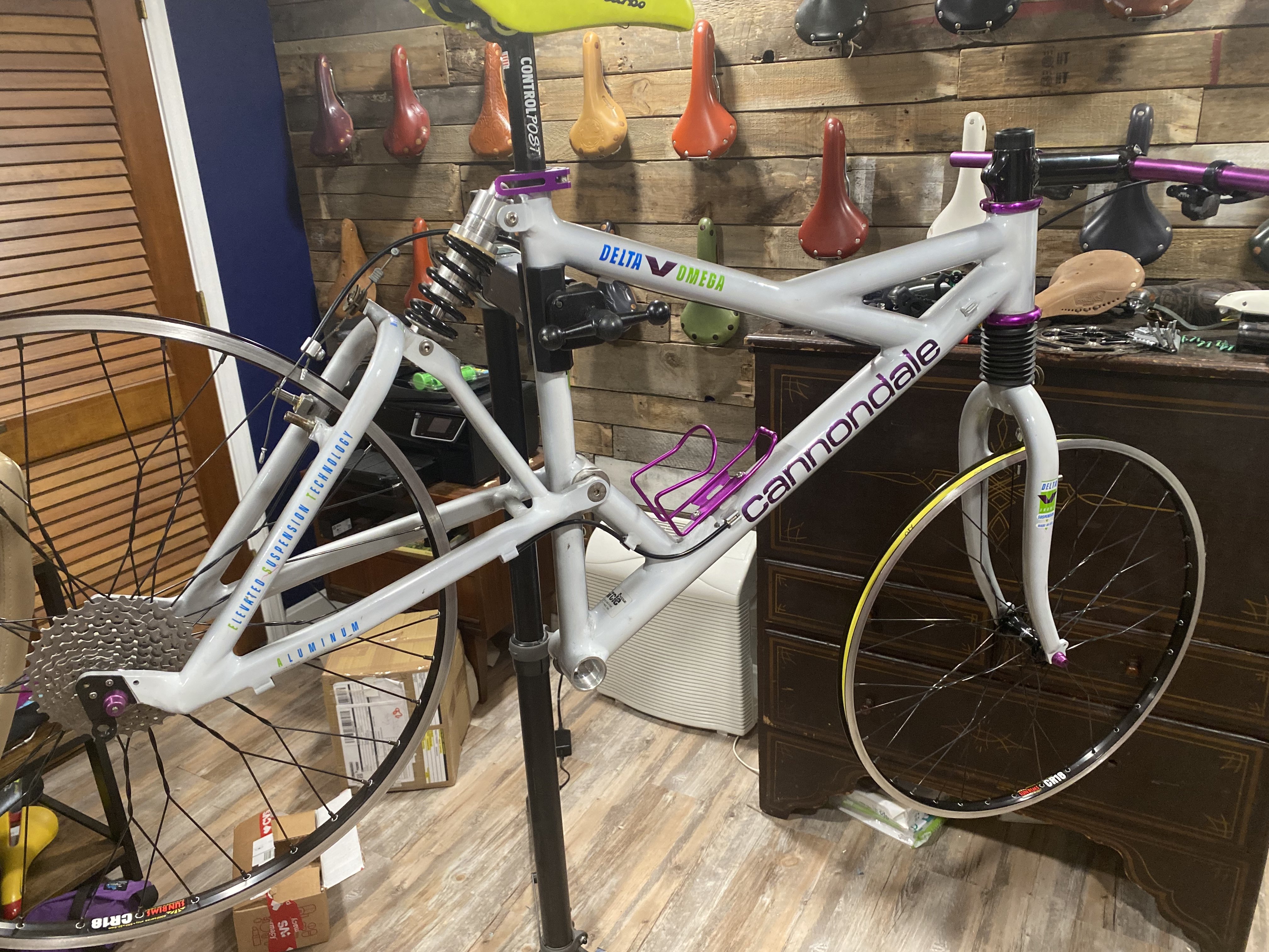

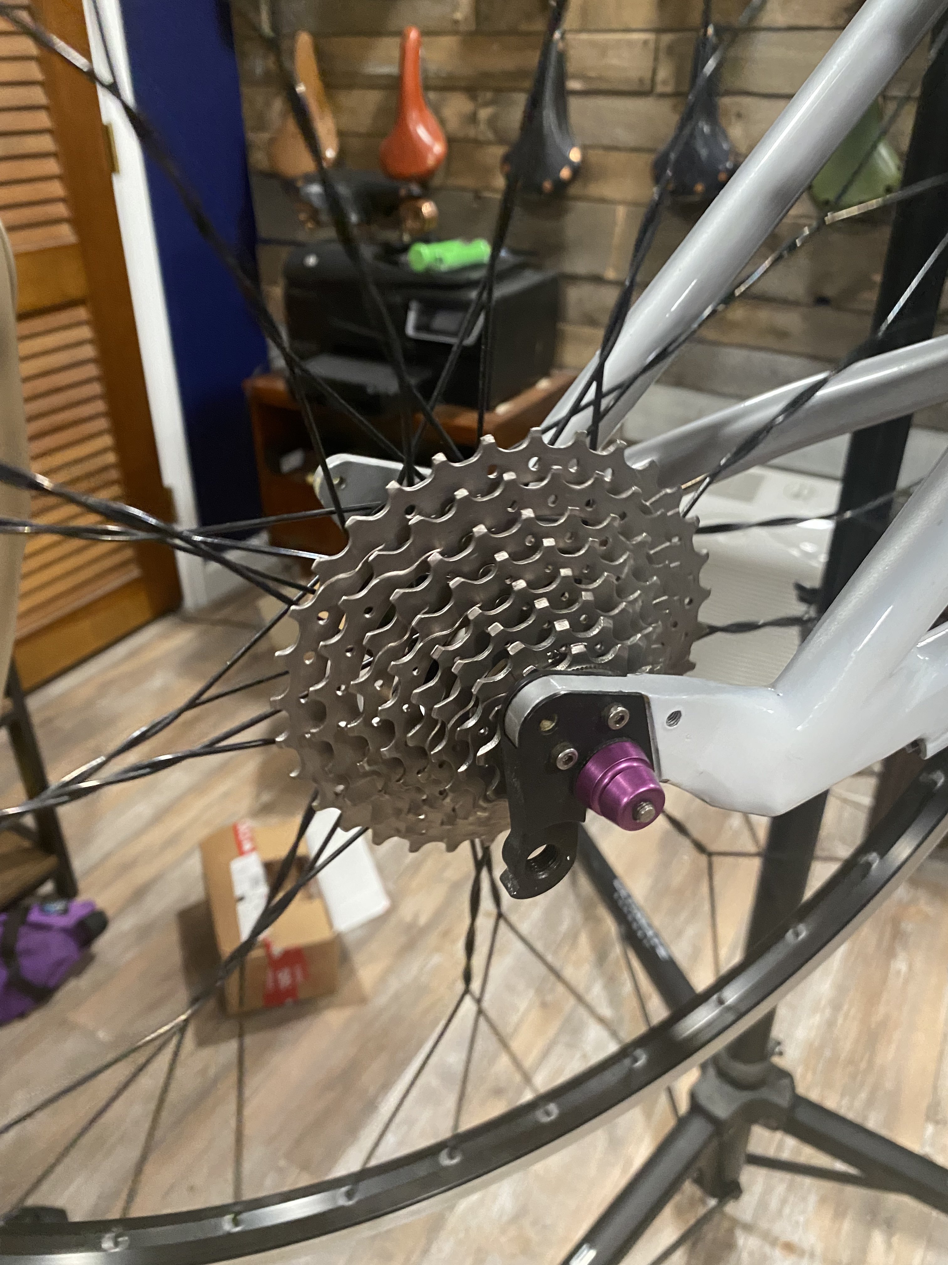

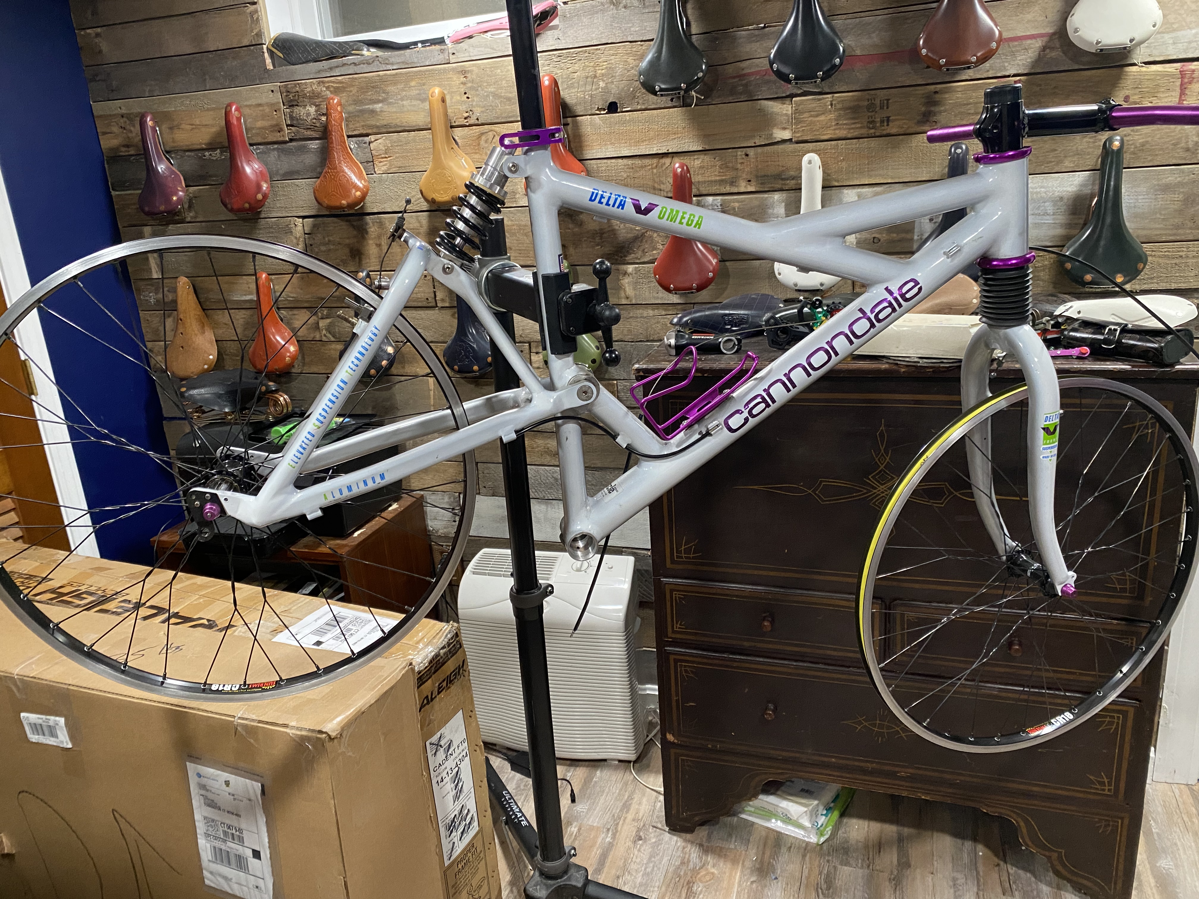

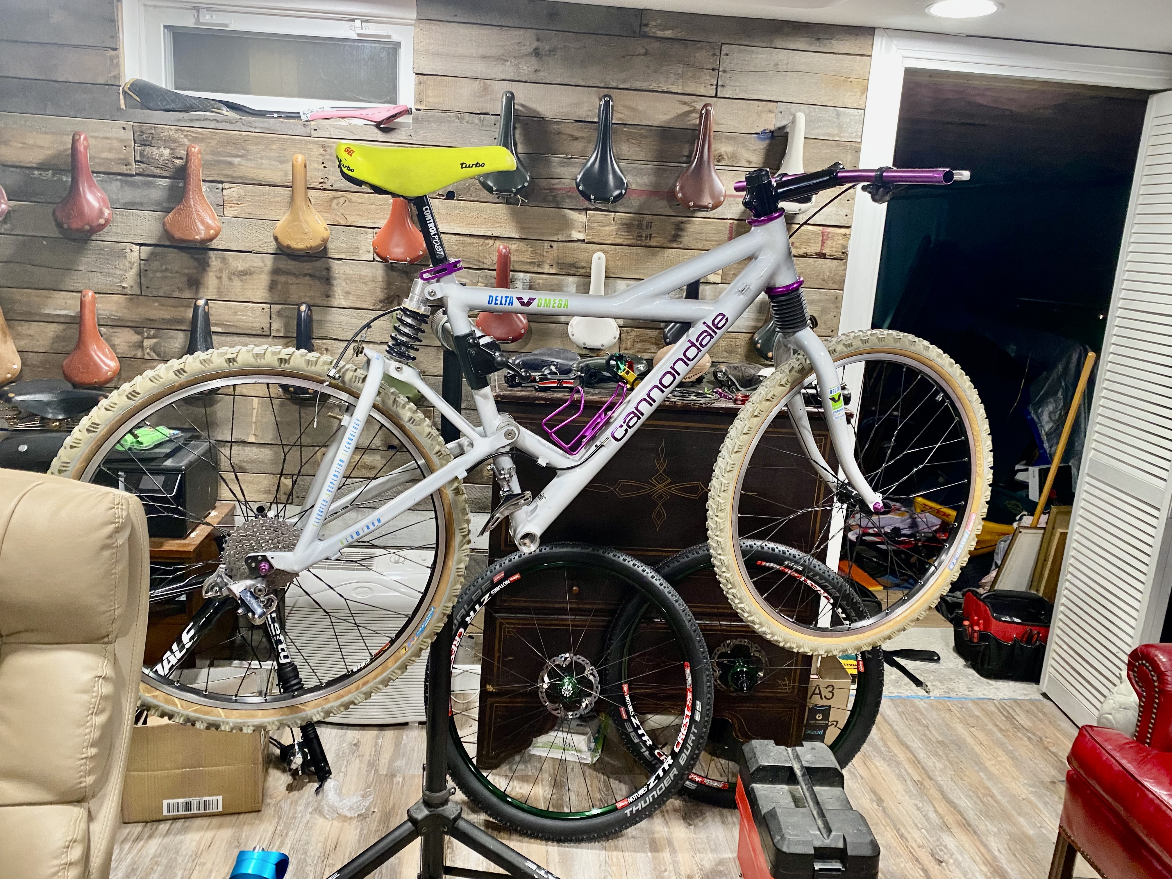

Just waiting on the M900 front and rear derailleurs to work on the build a little more. Purple period correct coda brakes or stay with the xtr 900’s?
If I had the Coda brakes on hand I would probably use them. What better place are you going to find for them?
Is that a 1992 model? I was thinking 1991 for the Omega but I don't think there were Delta V frames that year.
Vintage_bike_basement
I have the coda and xtr brakes on hand, so you say coda? And yes I believe it’s a 1992. Finding info on it is extremely difficult

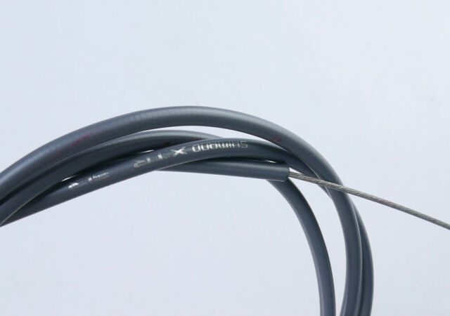

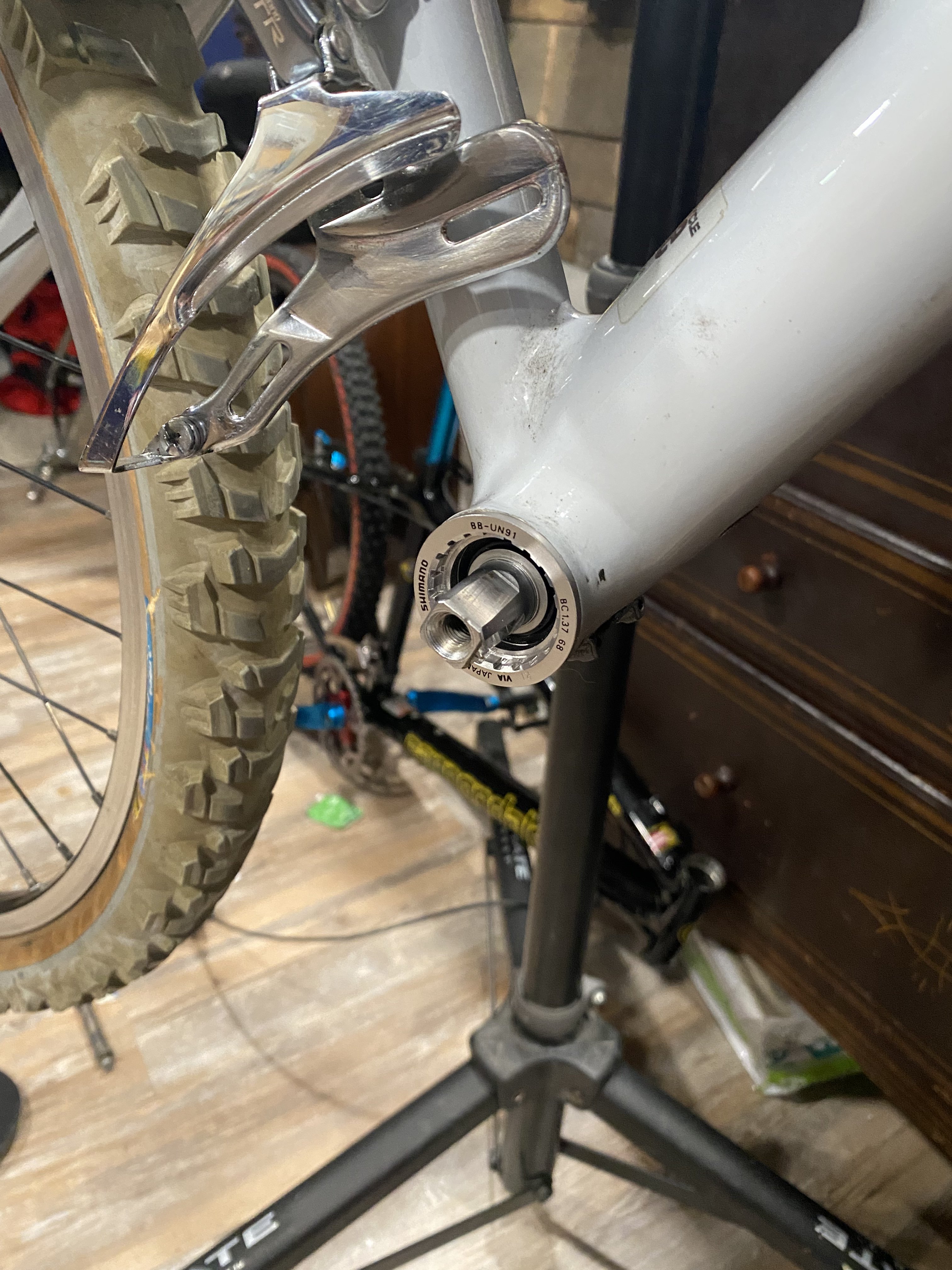

I may be contacting you when I get to the wheels about the 900 hubs and the chinook rim. I have a pair of chinooks in another bike but they are laced to XT and I’m trying to keep this build perfect. I need to get my hands on XTR cables and housing from that era next to get the brakes and derailleurs run. I’m clueless on what crank it came with so I’ll stick with XTR. Every photo I find has a different crank.
I think the XTR crank is the logical choice. On 1992 and 1993 Cannondale MTBs, if the crank didn't match the group it was generally a Ritchey. I haven't owned either but suspect that the XTR is the nicer of the two. A SunTour XC Pro microdrive might offer a bit of weight savings (especially when combined with a smaller cassette) but I wouldn't use one on an XTR bike. Aftermarket cranks were coming (Kooka, Cook Bros., etc.) but I'm not sure what was available in 1992.
I believe they may have actually had a cool bros on it in purple but that’ll take a bit to find. I have both an XTR and ritchey on other bikes and you are dead on that the XTR is the better of the 2. Probably my choice until the cook bros pops up somewhere…..
