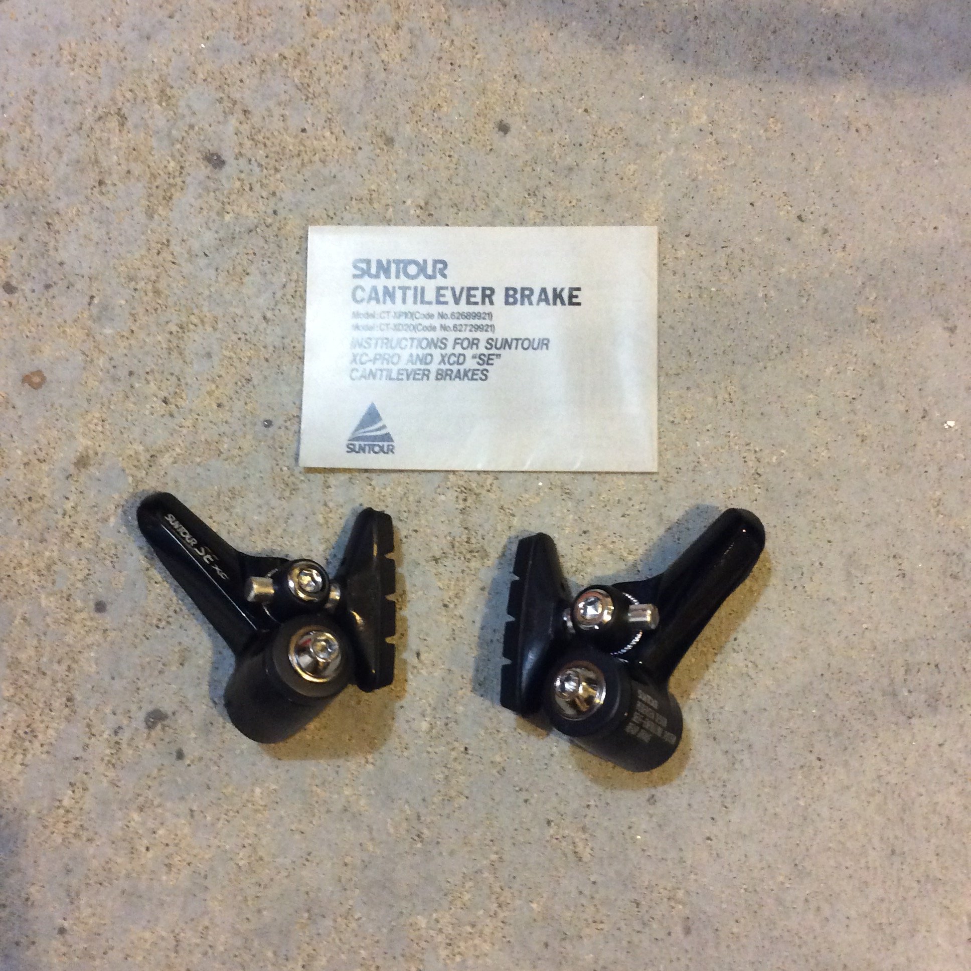

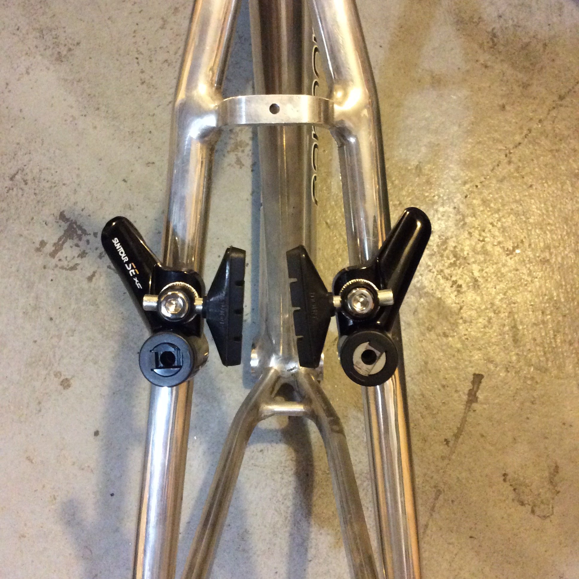

Suntour SE cantilevers:
DDBB7D50-2141-48C2-99F1-3718E21781D4.jpeg 0A82BE24-B45D-47DA-B580-D1C92B6EAB6E.jpeg

I assume only what was pictured was included.
I can't say for sure, because I bought a lot of other parts with that order, so the shipping was based on the total amount (plus, the box was oversized as I bought a set of rims).
Yes, just the cantis in a plastic bag and the instruction sheet. No cross cable or yoke.
