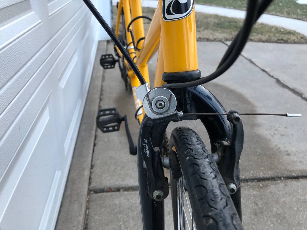

Here is an example of Tektro mini V brakes with a cable pull multiplier (Travel Agent) on a tandem with Ultegra 9 speed sti levers.
You shouldn't really need the Travel Agent with mini Vs. The shorter arms require less cable pull compared to regular MTB V brakes.
