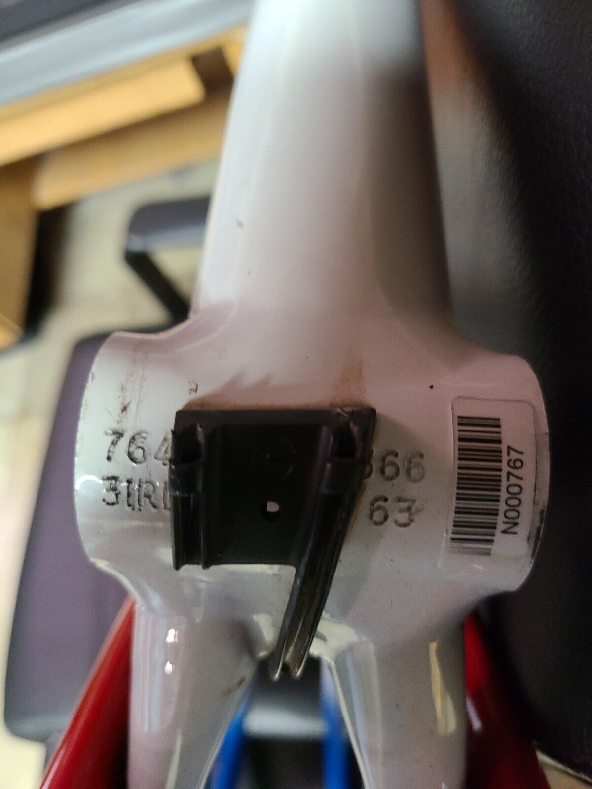

It looks like a 63 cm to me. People make mistakes measuring all the time. Easiest tube to measure accurately is the head tube. Lengths were not published in the CAAD 5 era but I measured a 60 cm CAAD5 at 19 cm, and a 63 cm CAAD7 at 22 cm. He specifies a head tube length of 22.7 cm. I'd expect the 66 cm frame to have a 25 cm head tube, or close. I sent him a message to check for a 63 stamped in the bottom bracket shell.
Pretty sure of the size now, as he sent a photo of the BB shell. The 63 shown is where the size normally appears, I believe the 66 above it is a continuation of a longer number.

Neat additional info! I did not know the BB stampings included the frame size in cm, for that vintage. Good to know.
