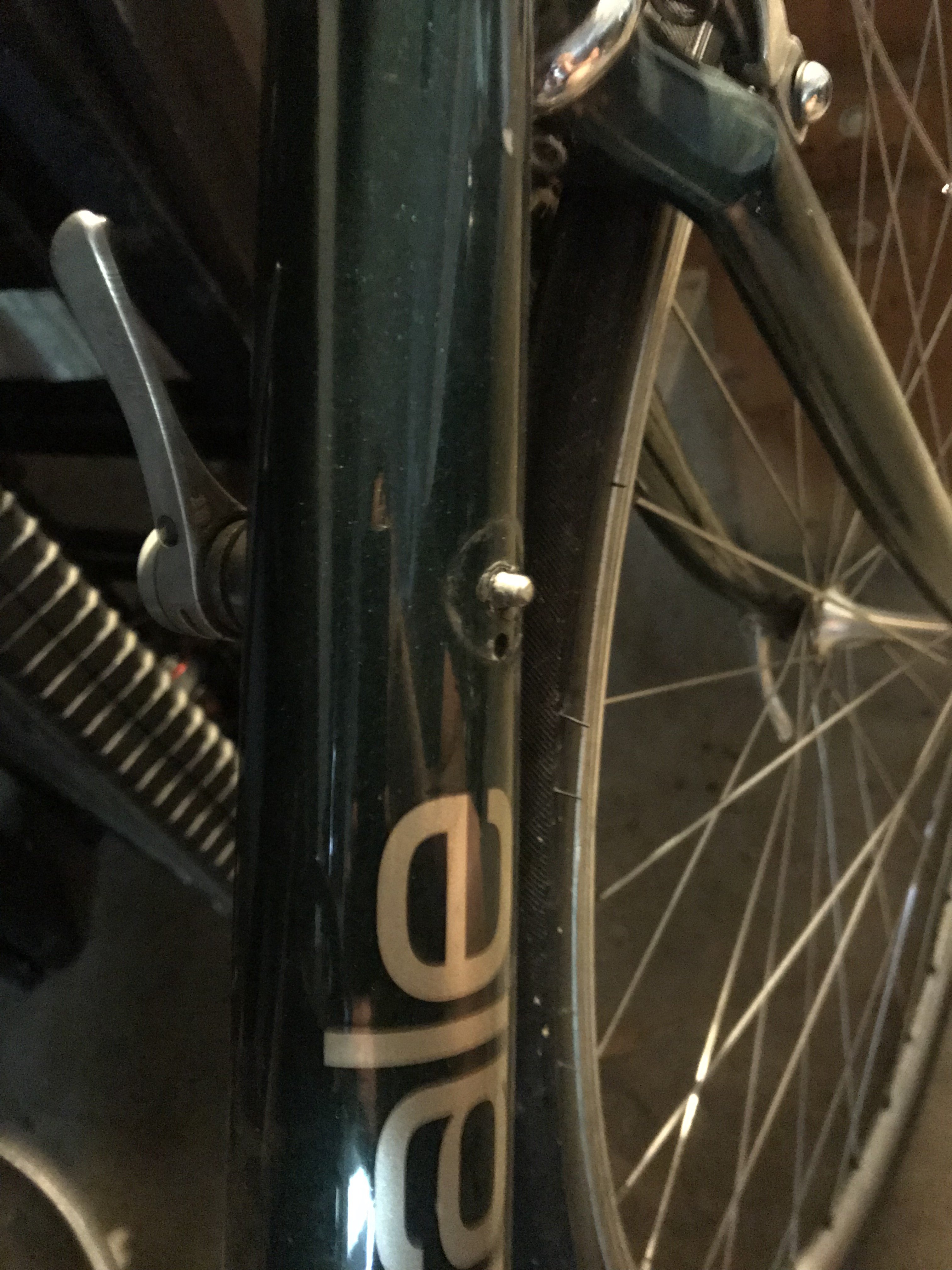

Broken downtube shift lever boss for a '95 R300
N8than
...at least I think it's called a boss. It's the threaded post lever attaches to. Cannondale no longer has them. Any ideas where I can get one?
Thanks,
Nathan

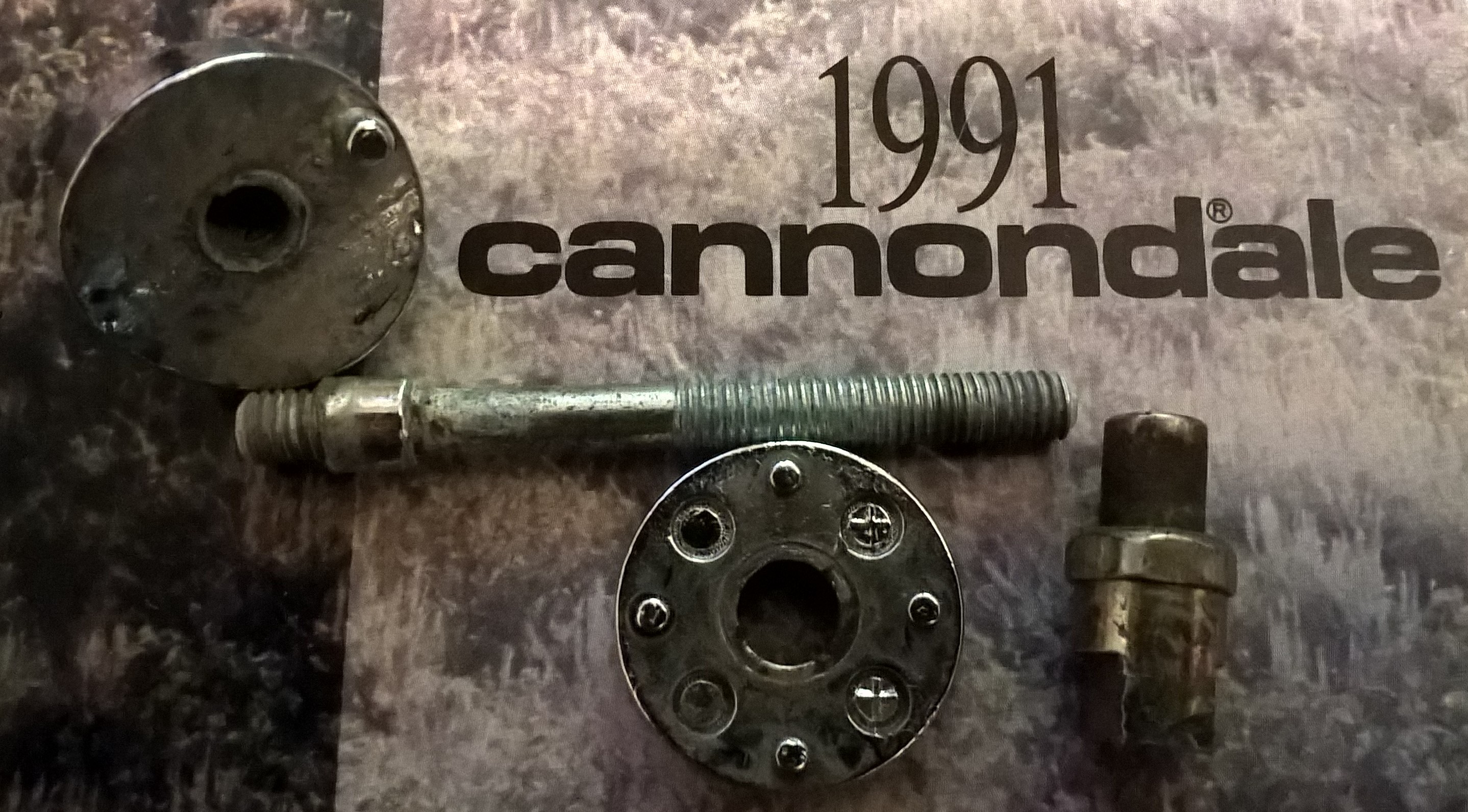

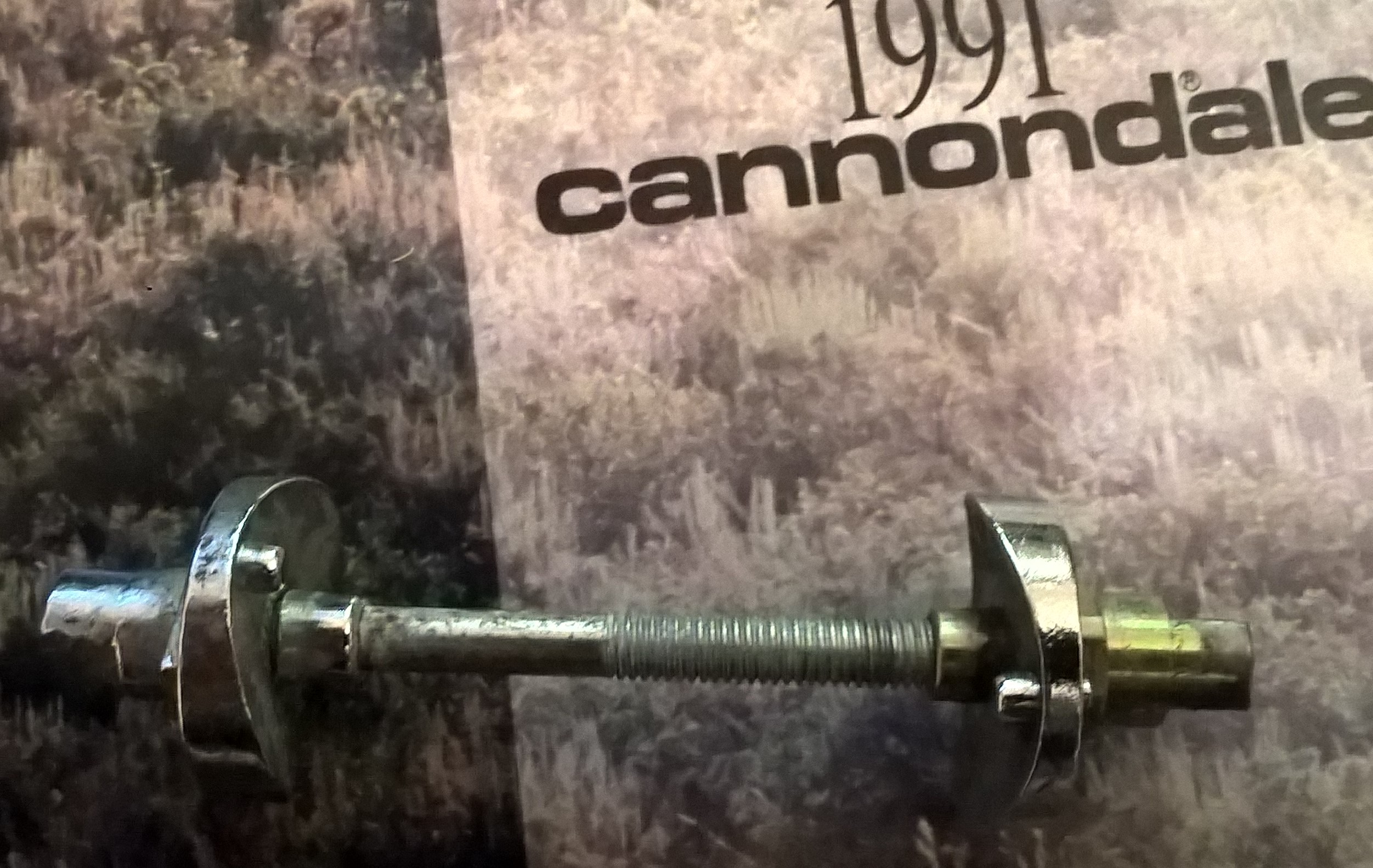

Mine has an issue. The die-cast boss came apart when someone removed it. Click on the thumbnail for disassembled view. There is still enough thread inside to hold, but I would probably remove the broken bit from the threaded stud and epoxy the stud into the die-cast boss. The threads on the other boss are steel, so no problem at that end.

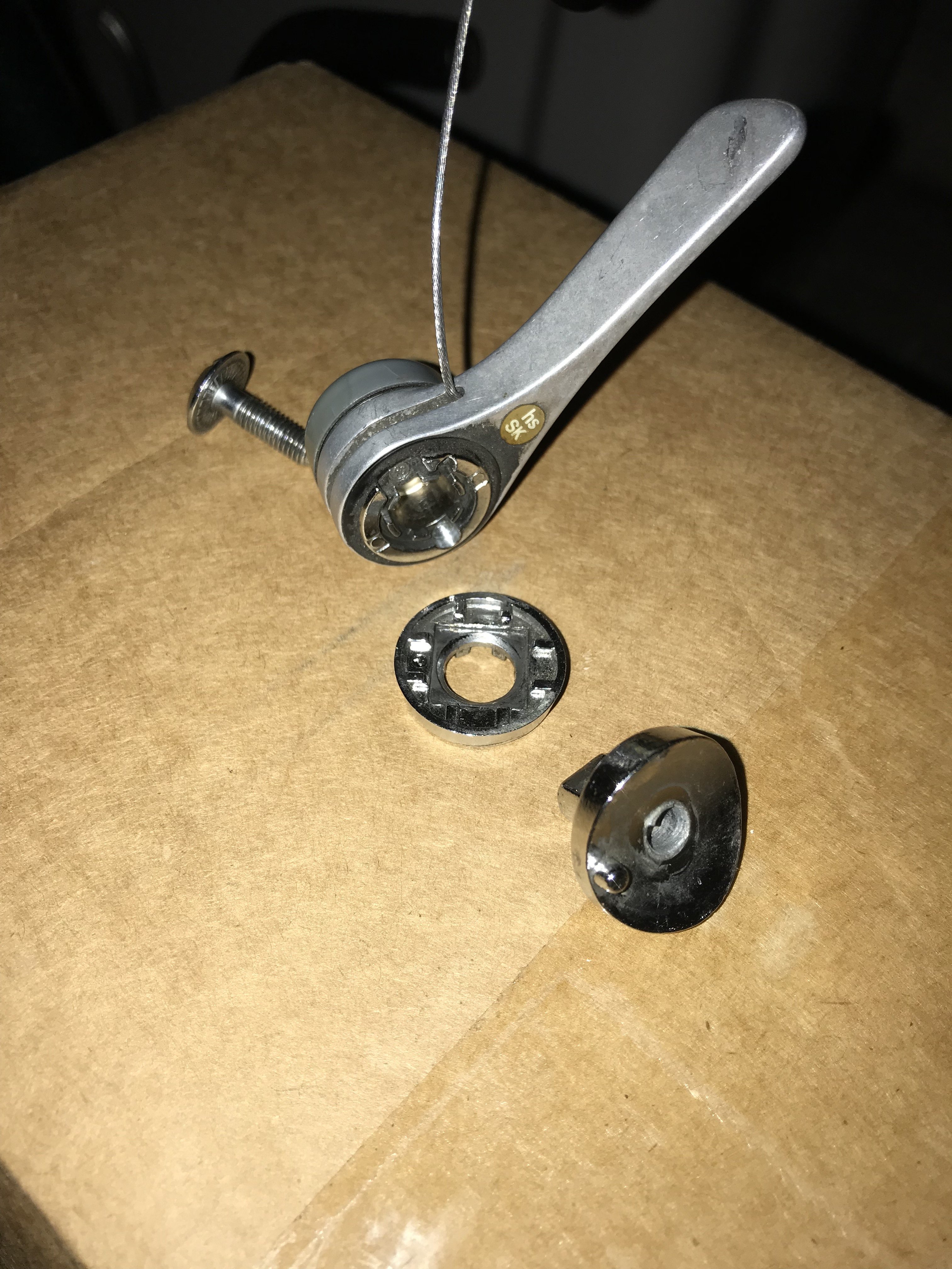

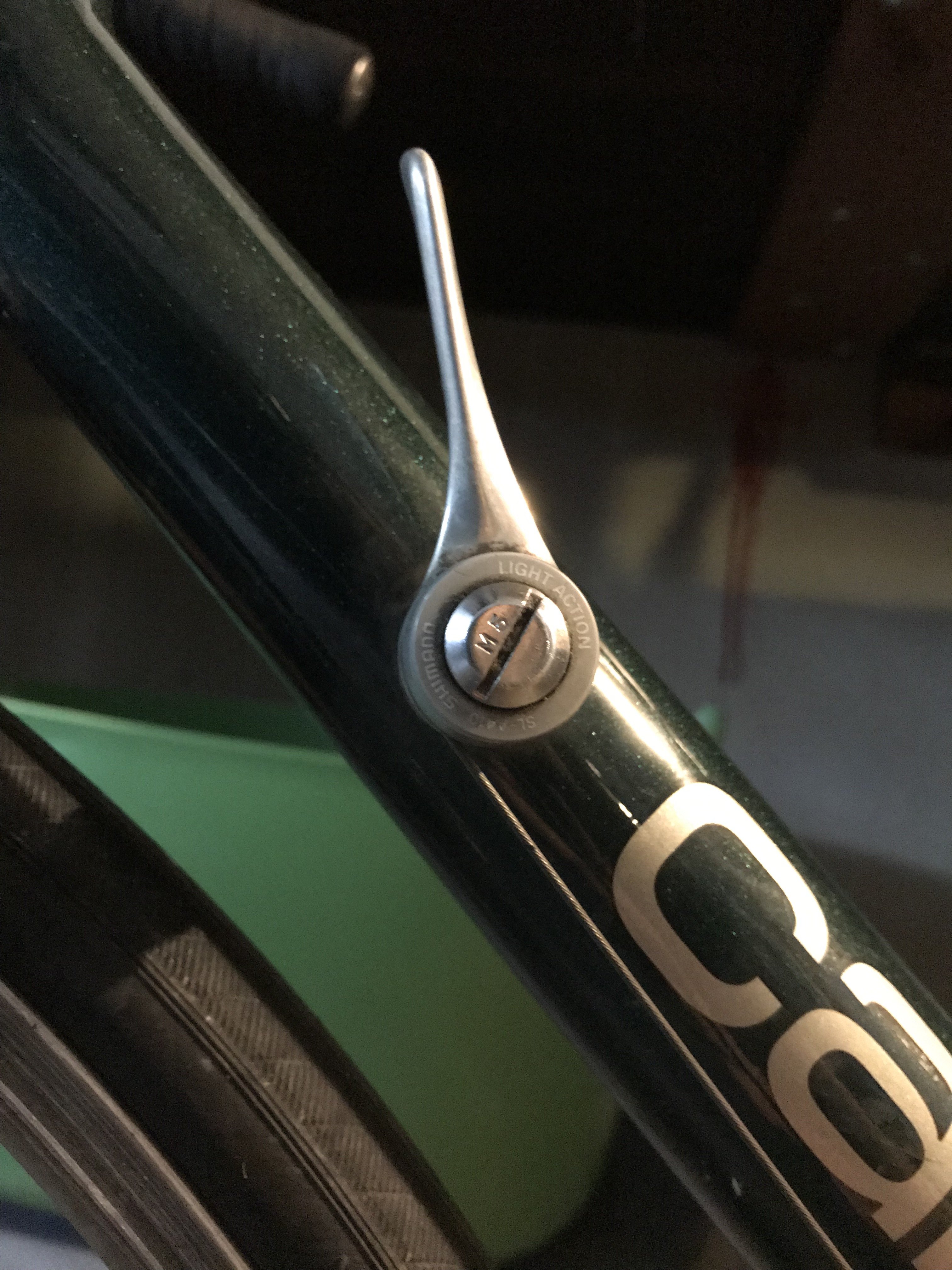

I'll try anything at this point. Just want get back on the road. Attached is a shot of the shift lever that came with the bike.
I'll assume that you want to continue to use down tube shifters.
Have you taken your shifter boss assembly apart? I'd like to see where it failed.
Looks like yours failed in the same place as mine. You can extend the threaded rod farther into the broken boss. If you go too far you may have to shorten the shifter mount screw.
