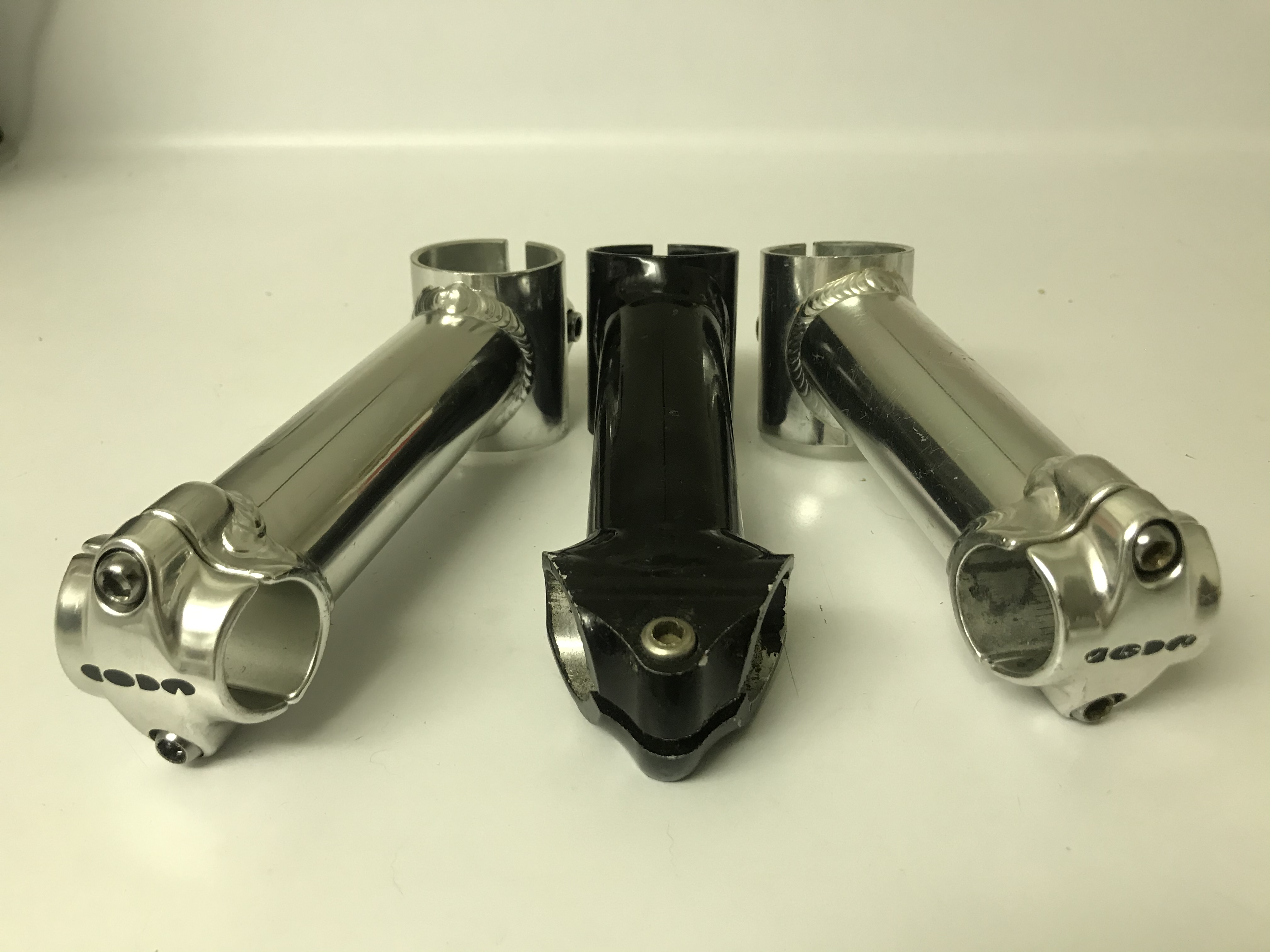

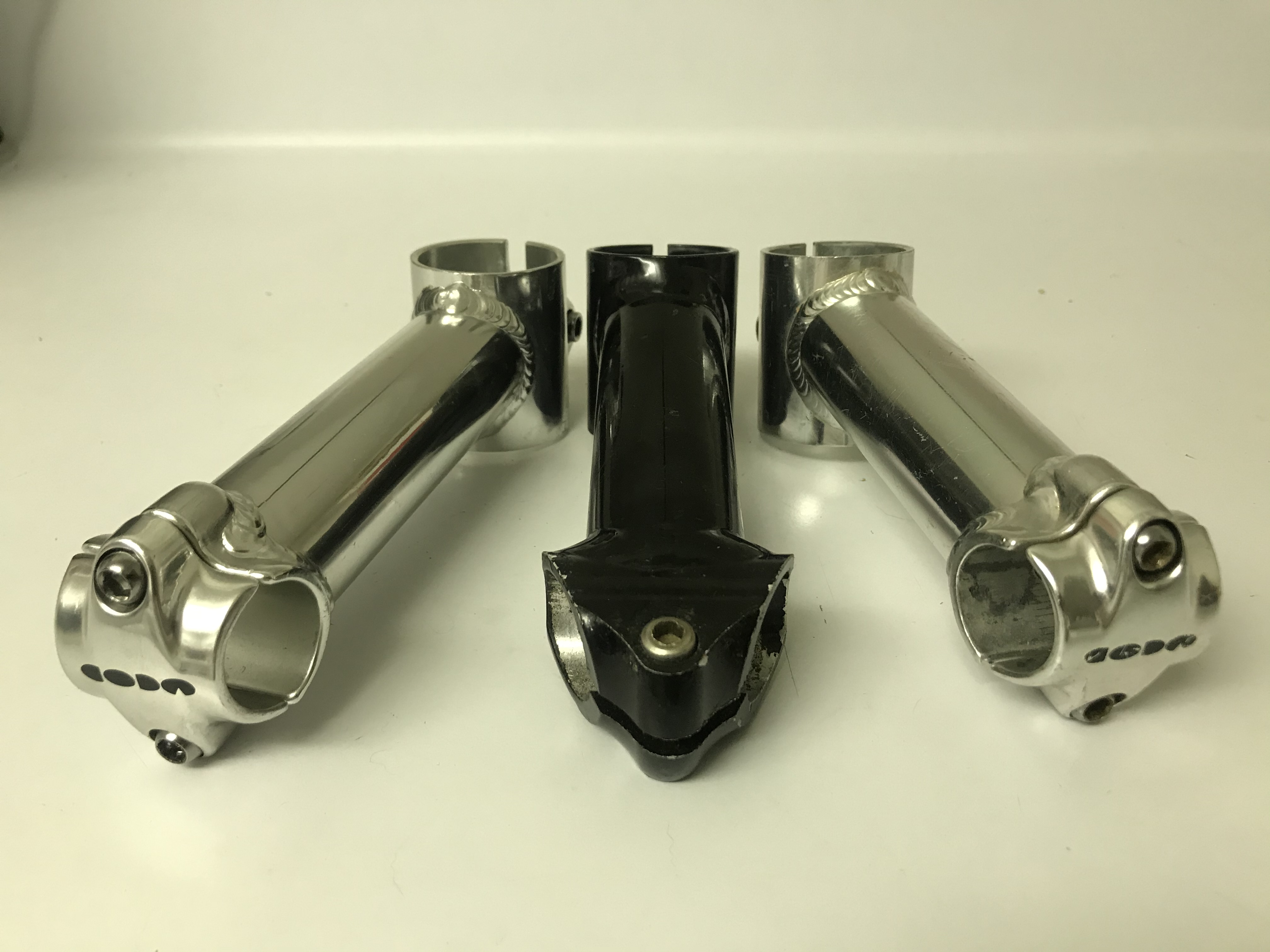

I have these to choose from. The black center one is period correct:

just showing off;):)
it is also the poorest stem ever seen on a cannondale :mad::D
chumaman
If they are for sale, I would love one of the silver Coda ones :)
Coda stems are 1 1/8...not existing for 1994 Killer V900...only cro mo garbage,speaking from experience I spent some time looking for the same.
There are very rarely on offer, I only saw one in Germany, a silver one in pretty bad shape for 30EU :(o_O
chumaman
Shipped to UK is £45 total. Please note the stems are Headshok compatible only.
Your stems are 1 1/2.....and are absolutely not relative to this topic o_O you should know this before you offer here :(

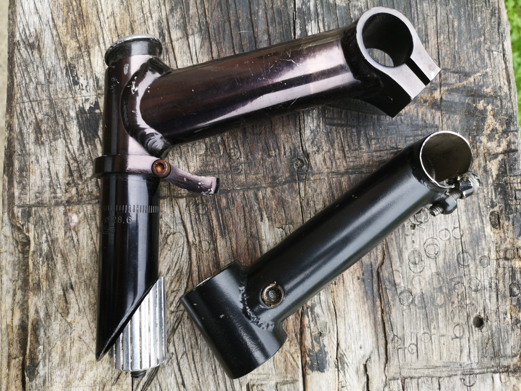

What is required looks like this ;)
And to repeat the aluminum Coda stem does not exist in 1 1/4 :D
