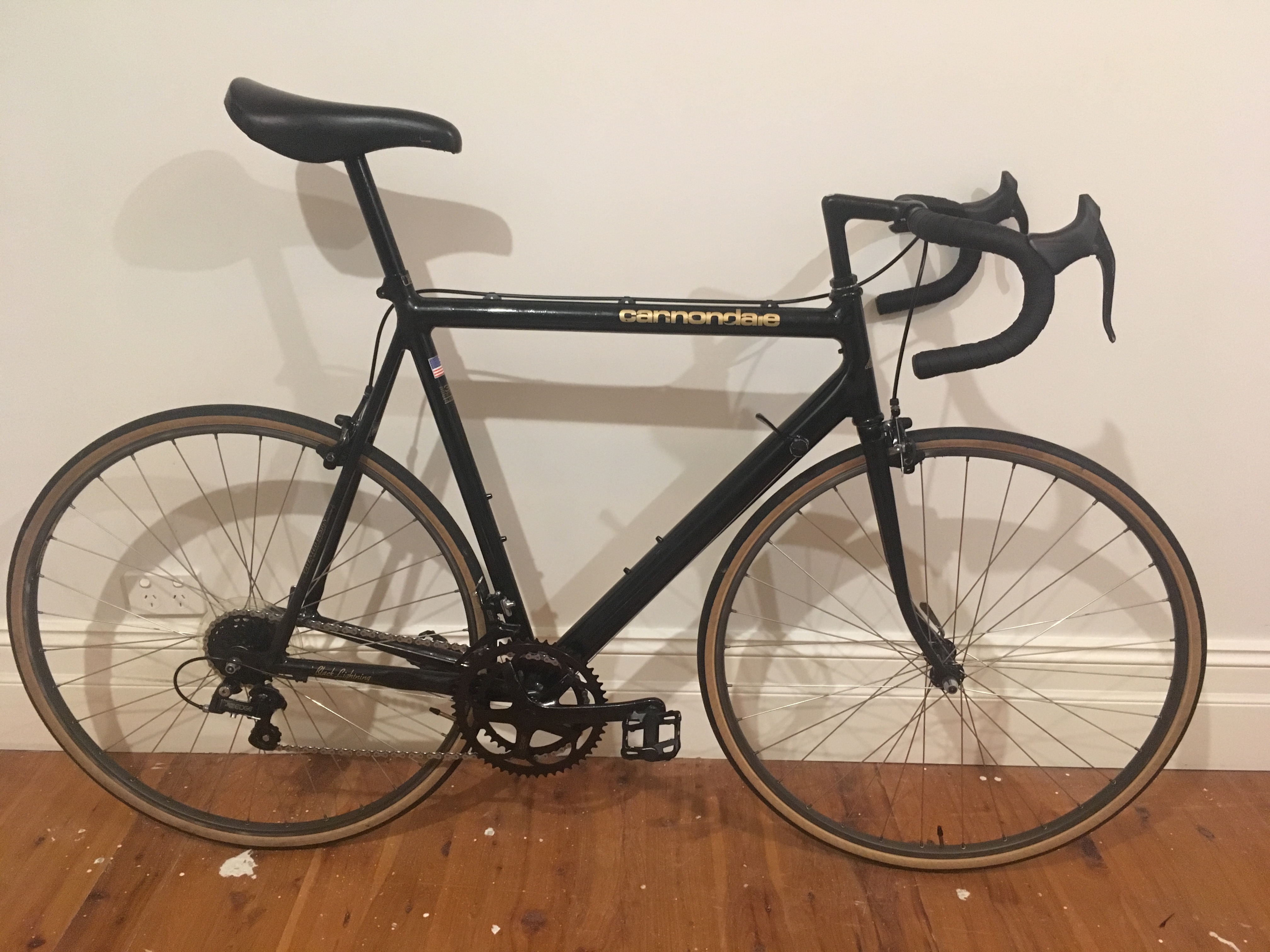

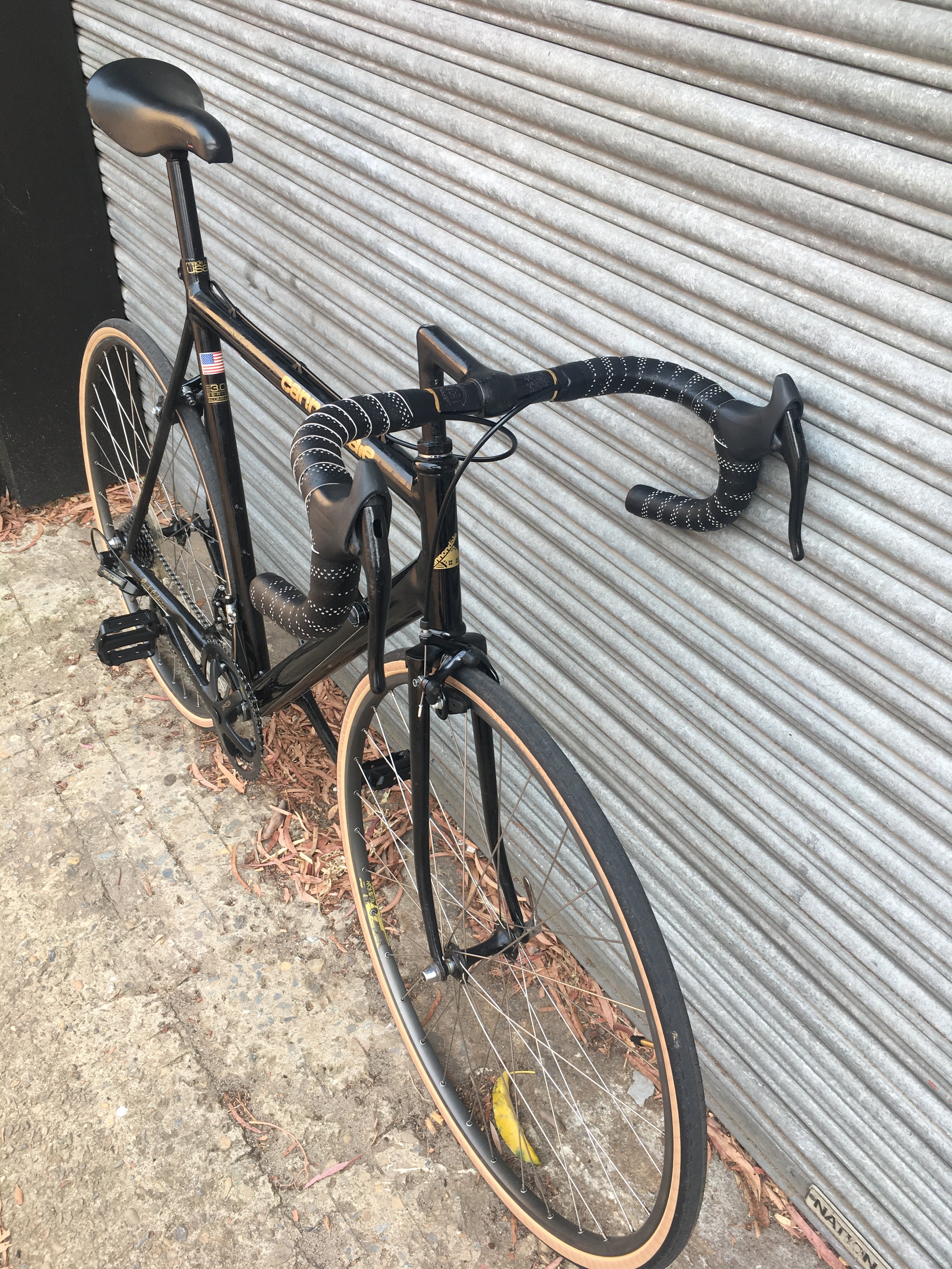

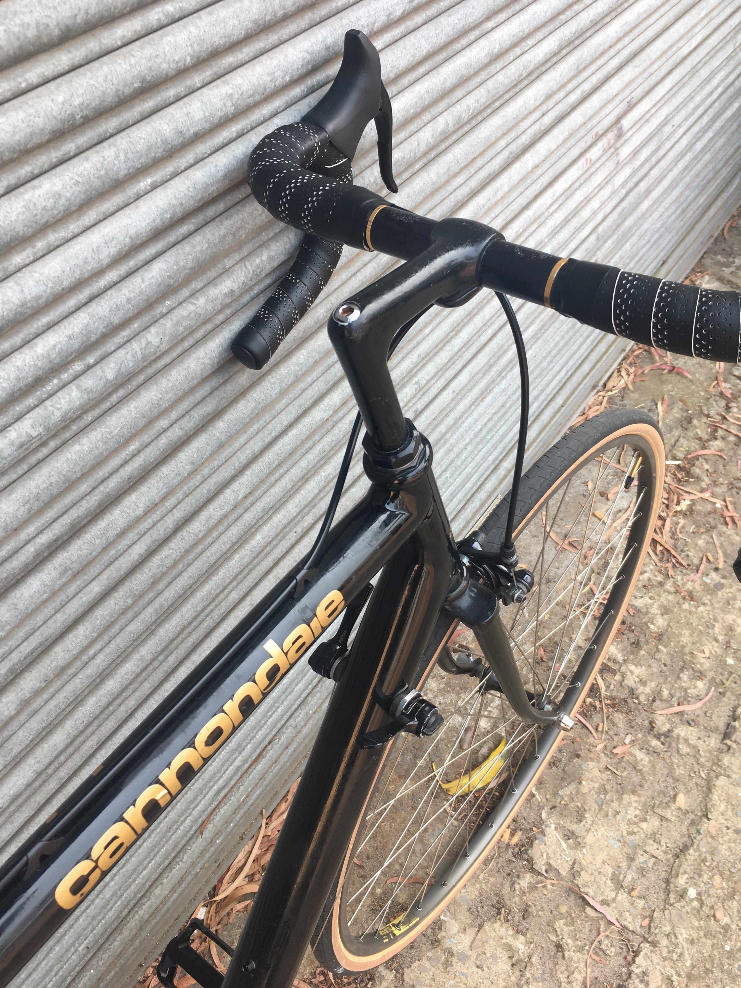

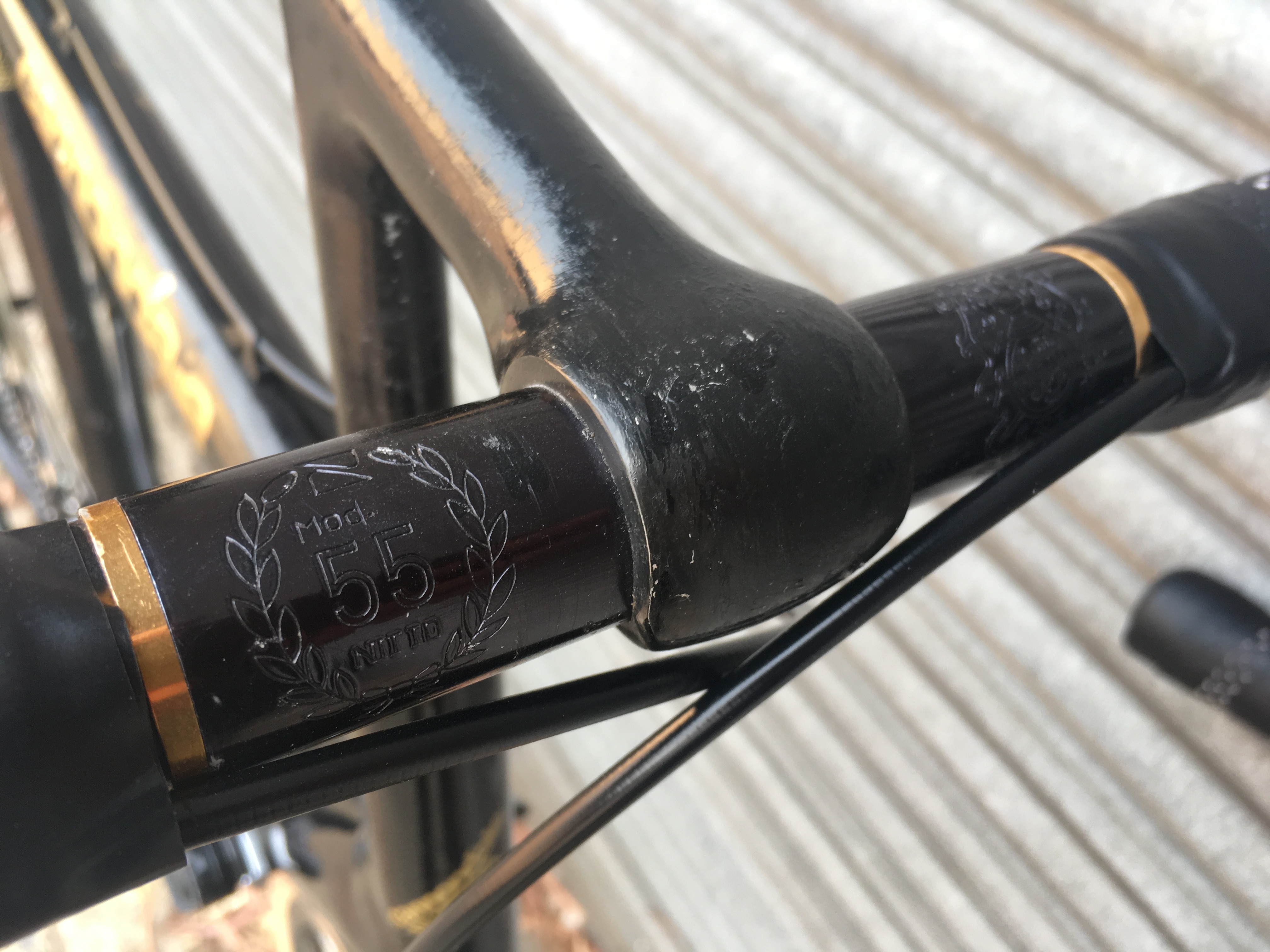

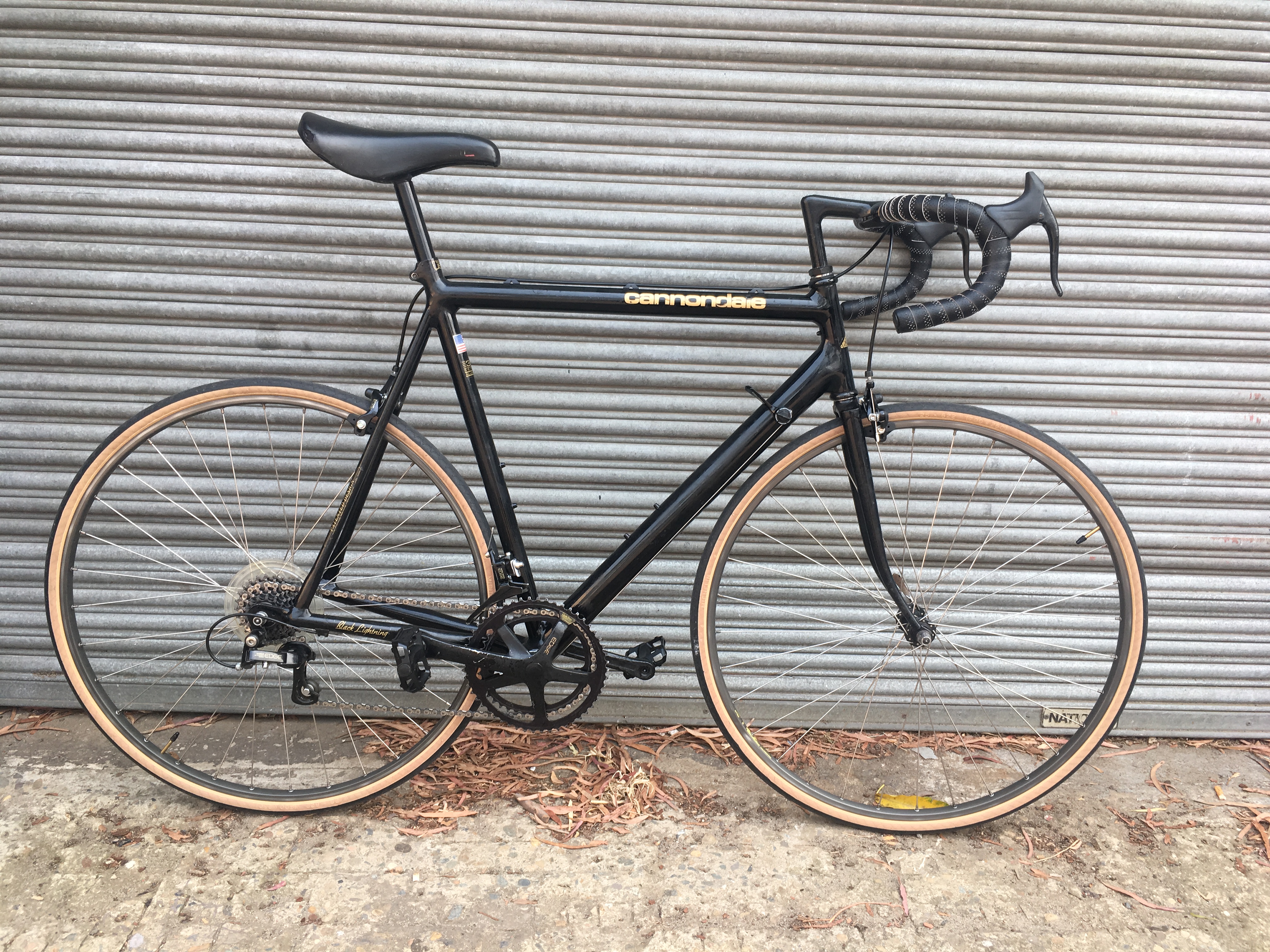

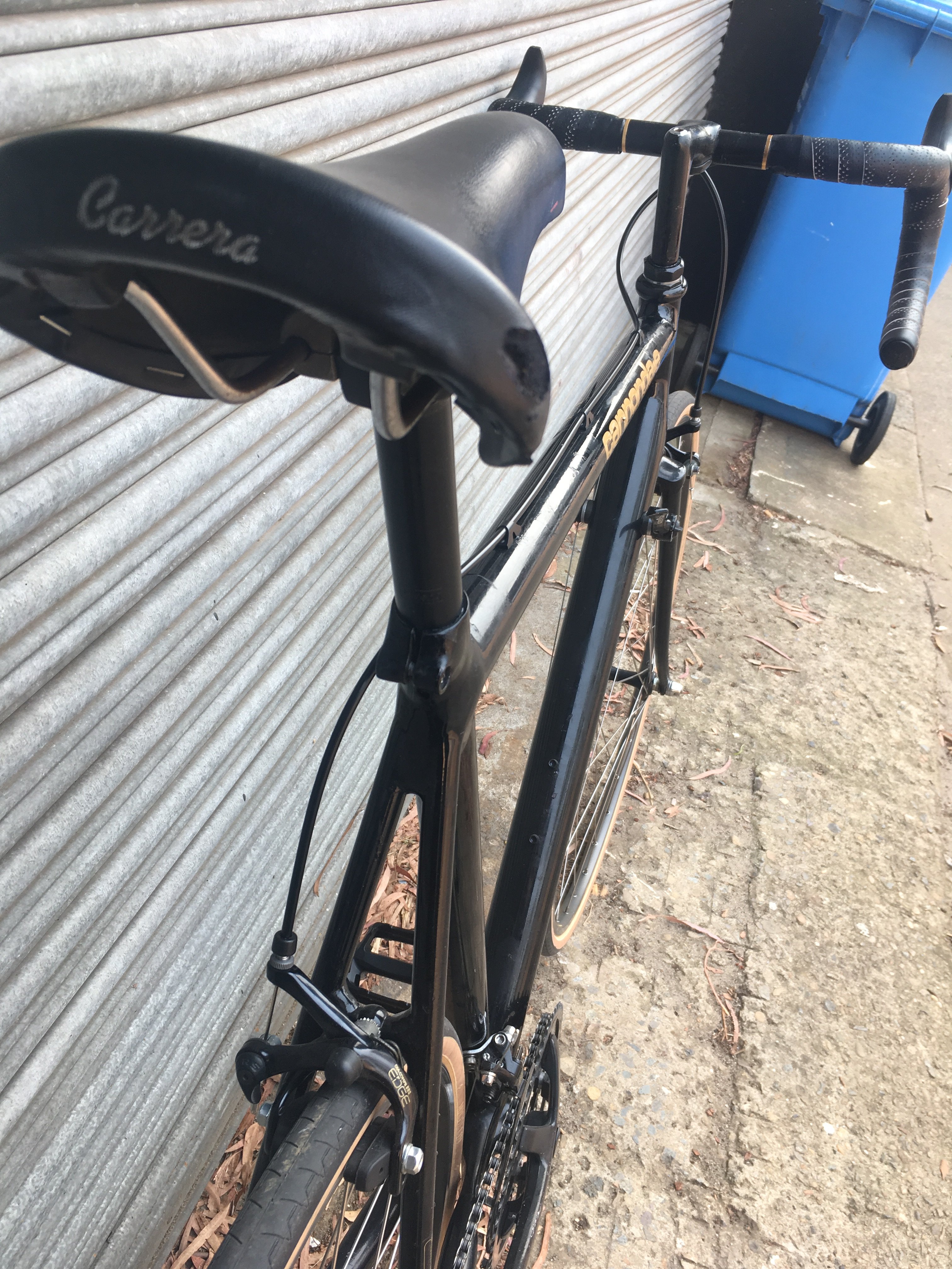

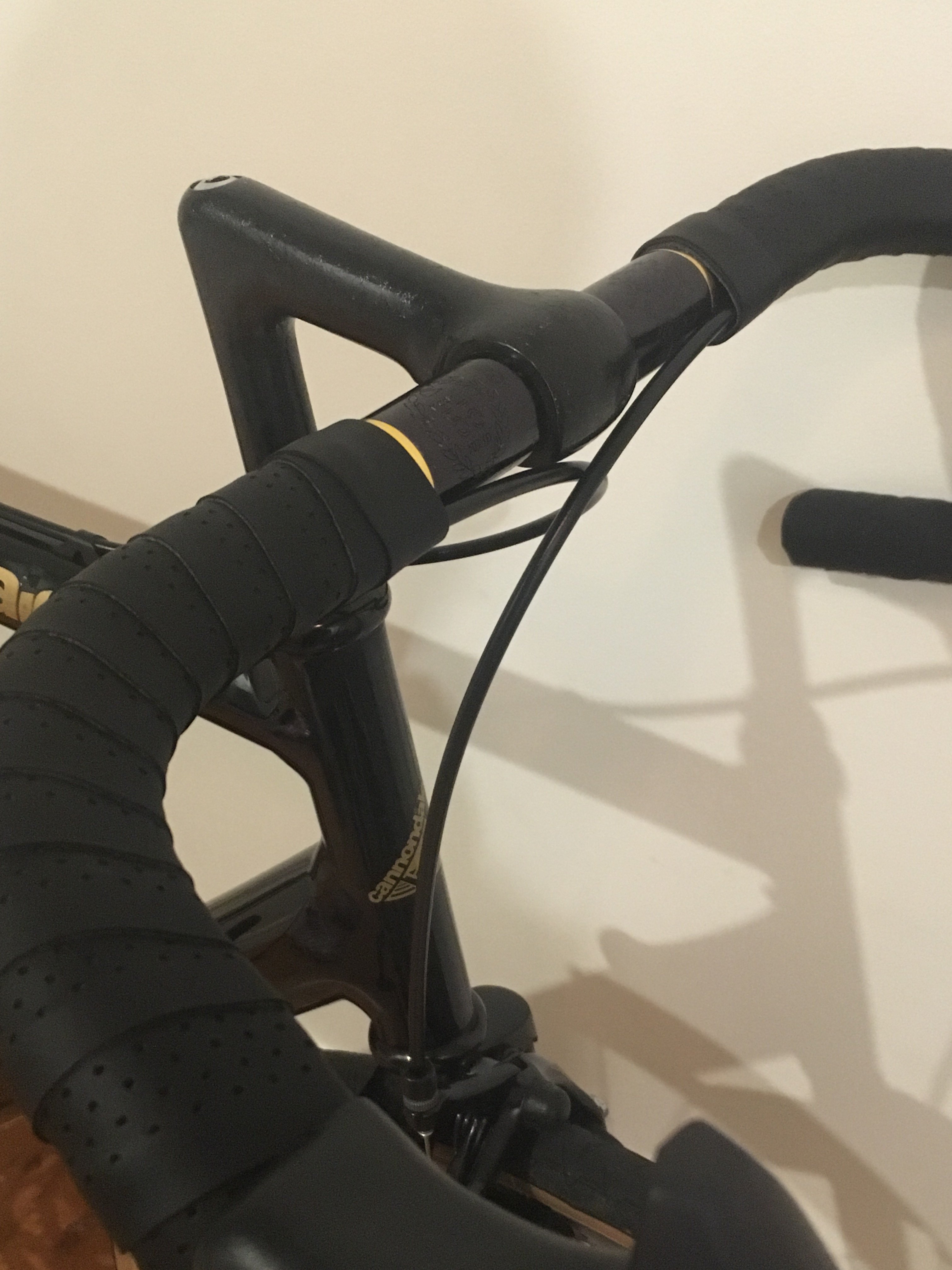

Found this on fb marketplace for a few hundred and the seller even delivered it to me!
It had most of its original components but was in pretty bad shape, pretty sure it still had the original tyres and chain which was stretched nearly an extra inch.
Here's what I did:

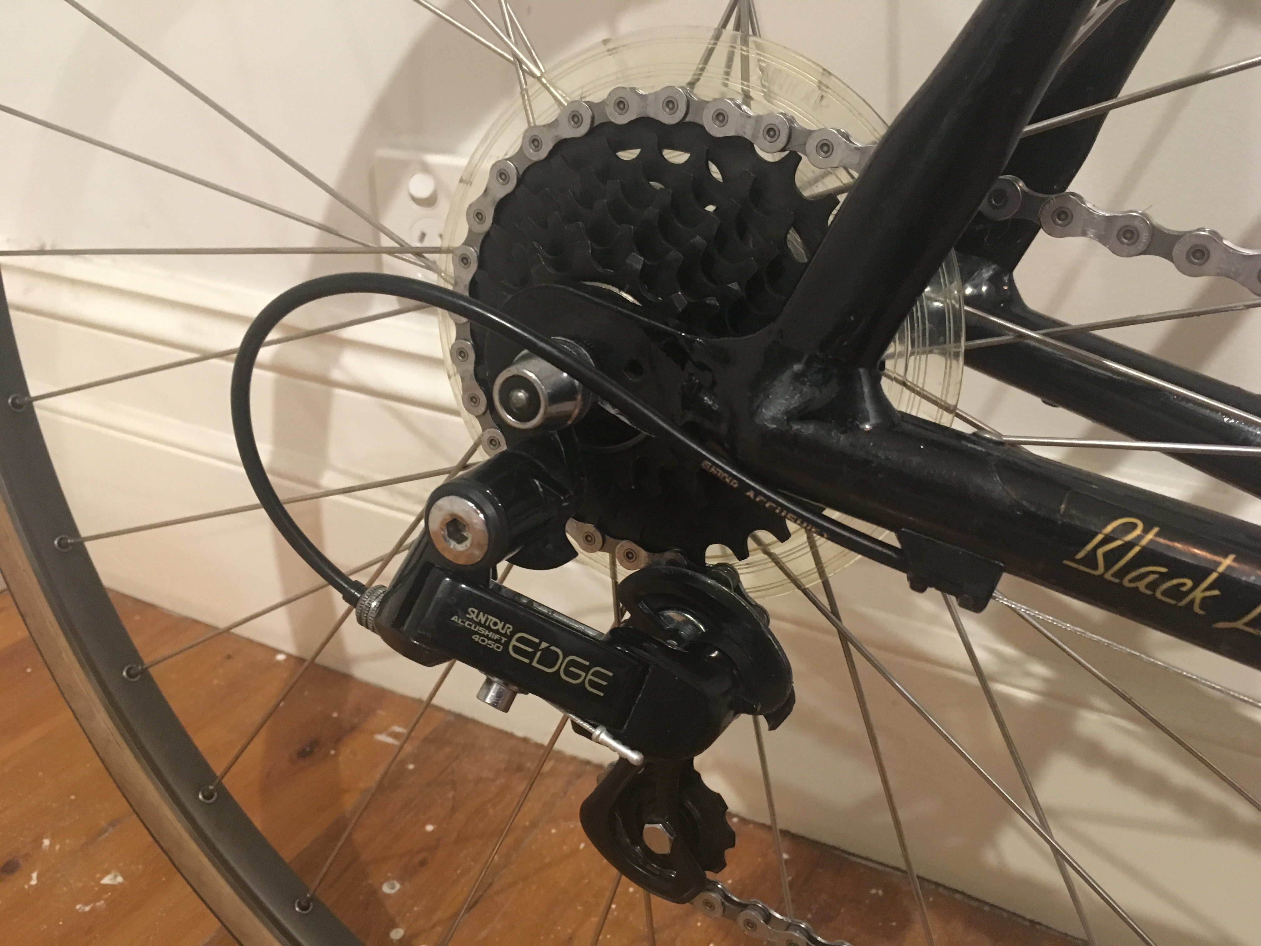

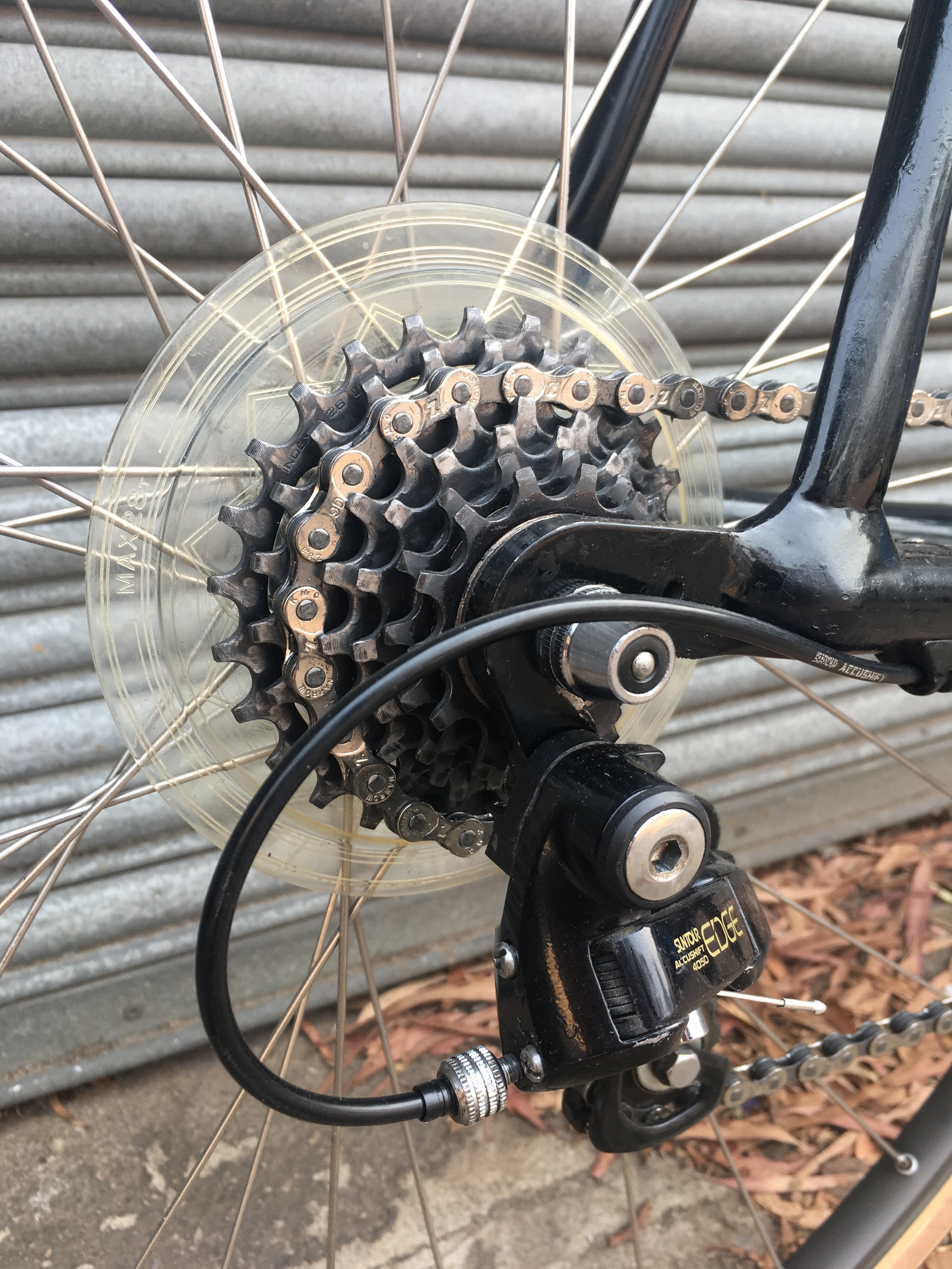

- Somehow bought a Suntour Edge Accushift 4050 RD in black and gold to replace the 105 RD that was on the bike when I bought it.
- Bought and installed NOS Suntour Accushift cable housing for the RD
- Replaced both rims (one had a nipple that pulled through) with a set of good condition second hand Wolber GTX rims (what would have been on it)

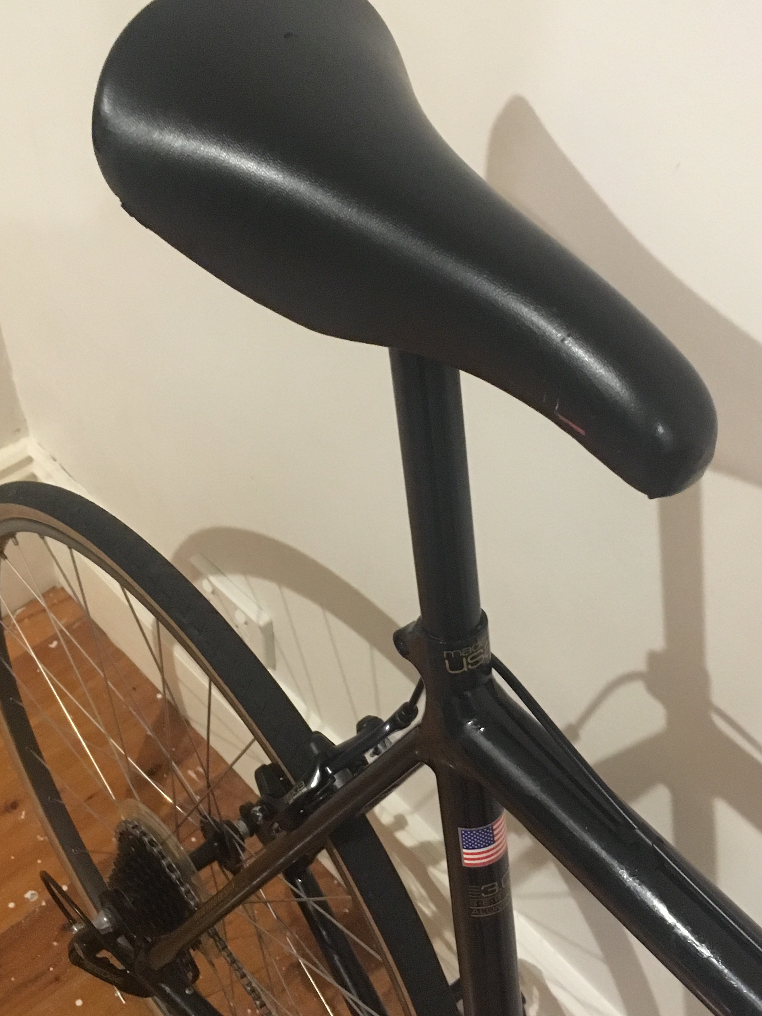

- Repaired the Vetta saddle
- completely dismantled and rebuilt the 7sp freewheel, bottom bracket, hubs and headset
- New generic black pedals. KMC chain. Fizik bar tape
- Replaced top tube cable guides with the repros from VC as there was one missing (sold the other two)

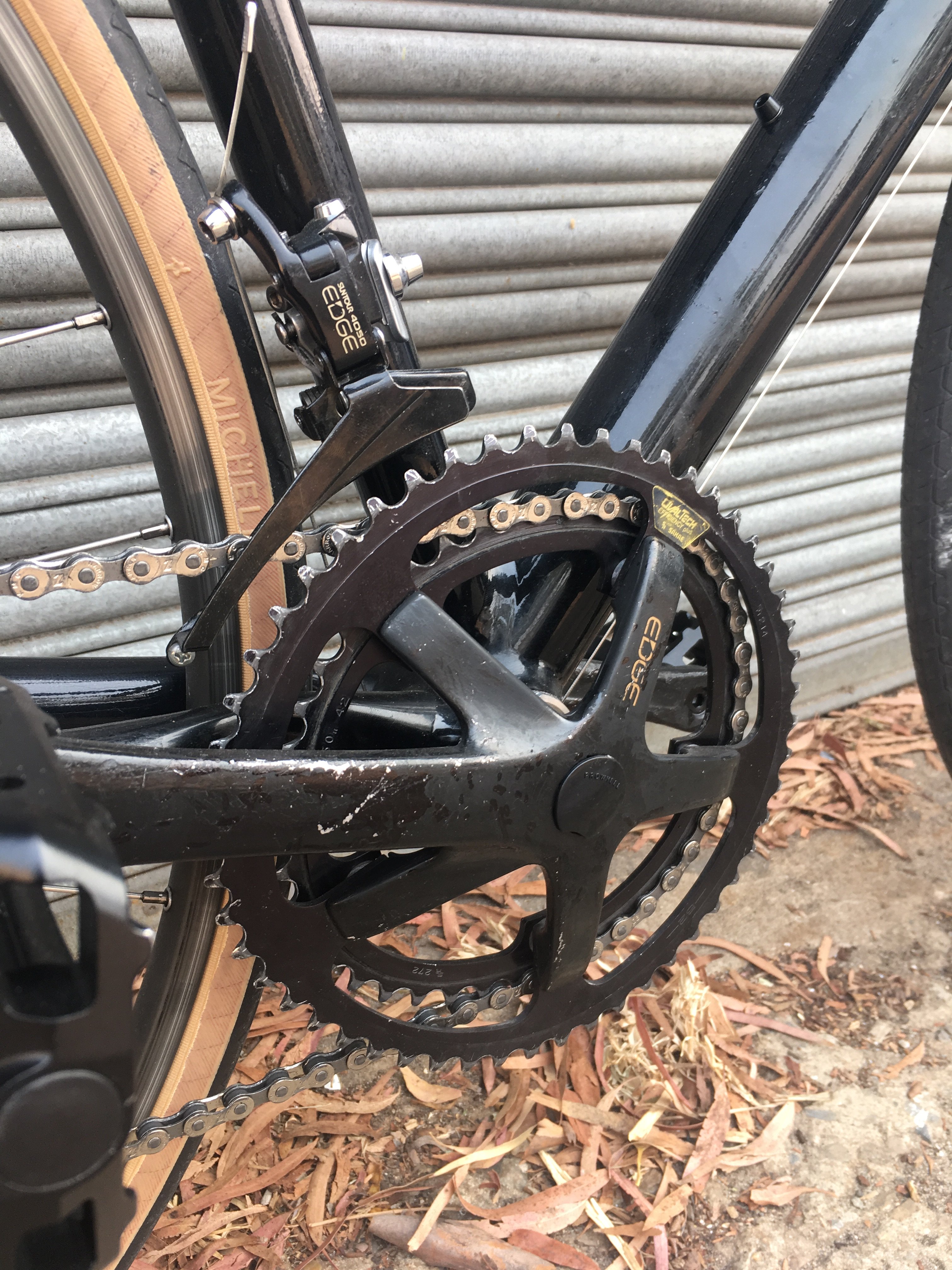

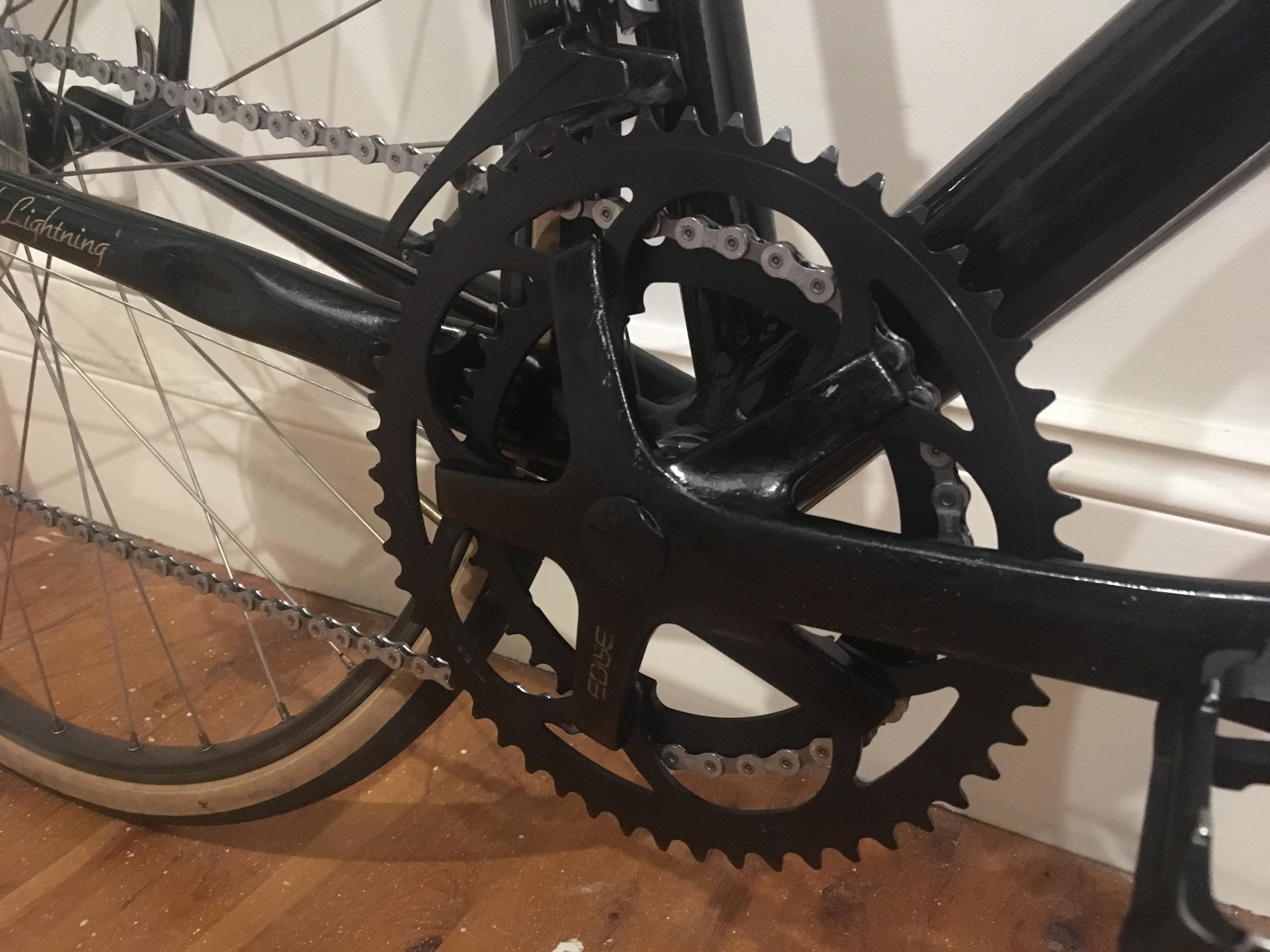

It has SR Ovaltech rings on it at the moment (not sure if they were factory?) but I've just located a pair of 52/42 black NOS Suntour Superbe that I'll put on it. Might get a NOS 7sp Accushift freewheel in the future too for a complete drivetrain overhaul.
The bike feels great and rides like a charm. Always wanted one of the cantilevered BL's with all OG components!
Serial number is Sep 88, 58cm.

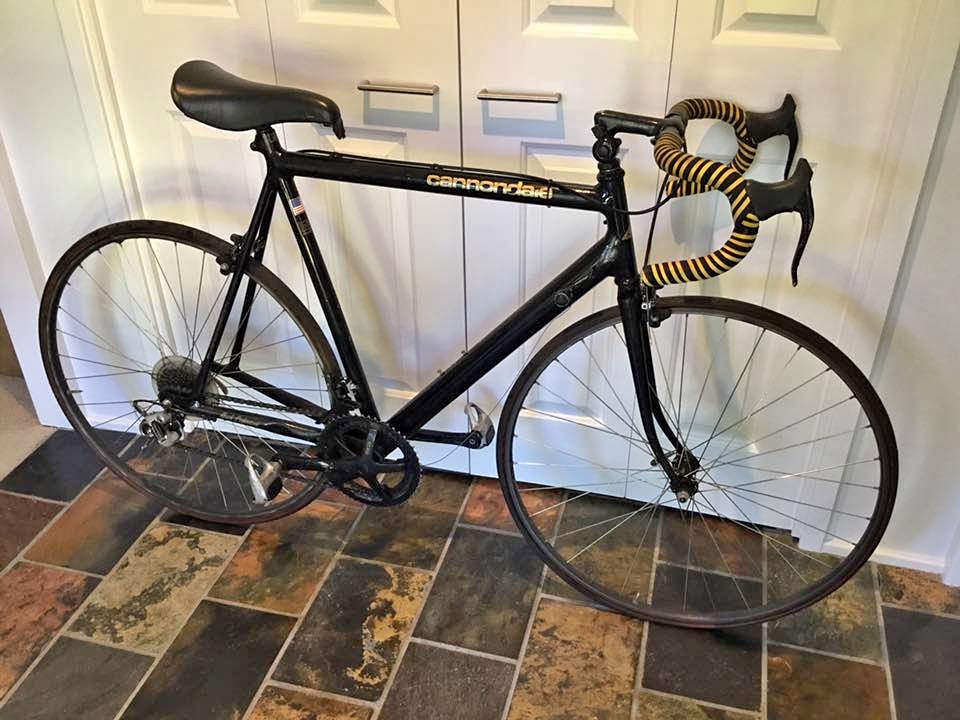

Last photo is a before shot

Nice work, the bike looks great. I'm pretty sure it's a 1989 SR500, which came with Edge. The 1988 BL was the Sprint equipped SR700. The oval chainrings are original.

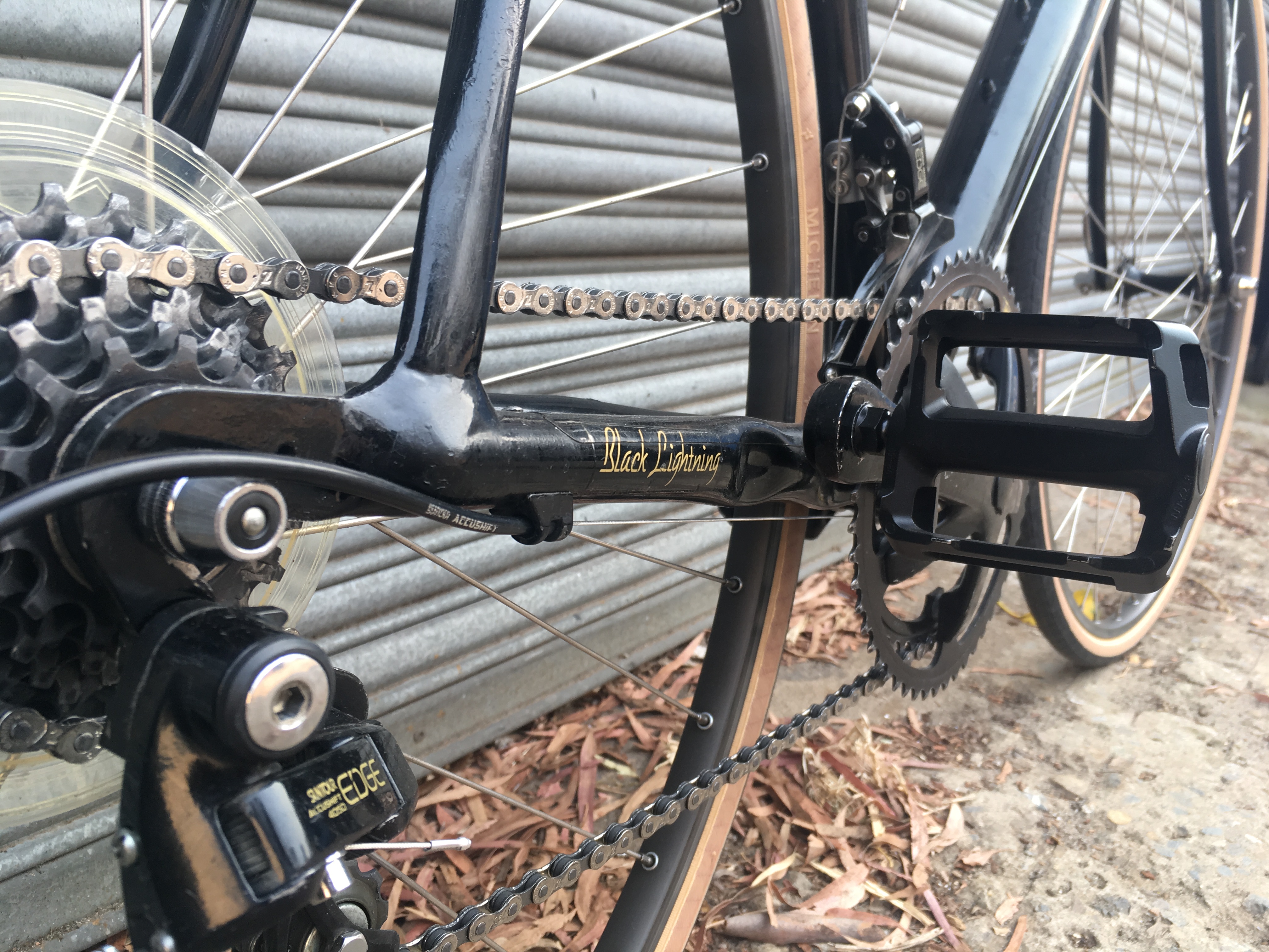

Nice. And I love to see people use the A113 guides. It is an 1989. The rear dropouts...

Thanks guys!
Cool, I couldn't see it in any of the catalogs so good to know the edge and oval tech rings are original!
The code on the frame is 58101188167 so I guess it was made in 88 for the 89 release.
I actually kind of prefer the cantilever dropouts to be honest. Makes the bike look a little 'tighter' or something.
The chain rings are pretty worn, I would love to find a pair of black ovaltechs somewhere, I can see suitable roundtech's on eBay though.
The 1989 catalog that we have only has pictures of a couple of models. You have to look at the specification pages at the end of the catalog to help ID 1989 bikes.
Were the rings that you have made by SR? SunTour made some black rings - I have Superbe Pro on my Black Lightning. Guessing that the Edge rings may have been SR though. TA made black rings with 130 mm bolt circle so that's another option for round rings. Probably several other options.
Peat
The rings on it now are SR. The black Suntour Superbe that I mentioned in my first post turned out to be the wrong BCD so I didn’t end up getting them.
I can see black SR roundtech’s on eBay with the right BCD but it would cost me $150 or to get them to Aus so I am just going to stick with these old worn rings for as long as I can!
The bike actually rides so well the only thing is that it skips when cranking hard on the large chainring and the smallest sprocket.
Also the Edge RD has no b screw so I can’t try and curl it around any more.
Surprisingly the teeth on the freewheel look nearly perfect but the chainrings are worn badly.
What's the bolt circle of the crank? I just assumed that it was 130 mm. Older Superbe would have been 144 I guess.
I've had a new chain skip on Campagnolo 8 speed cogs that looked fine too. If it only skips on the small cog, you should be able to find a replacement. Just be sure to ID the model of the freewheel. Too bad it's not a cassette as I have lots of NOS cassette cogs. I have a few freewheel cogs but I don't recall any first position cogs.

I can see a few NOS oval tech rings but none that are black in the correct BCD and I'm also guessing the black and gold decal on these was a one off for the BL!
I might go the opposite direction and replace the rings now with black FSAs or whatever you can find for a good price. I may have a new outer ring in the spares box, but perhaps not the inner.

UPDATE!
Ok so after much back and forth and buying and selling of bits I decided to keep it as original as possible but try and make it as new as possible.
So I hunted down a NOS Suntour 7sp AP freewheel (which has a 28 which is helping on the hills! (original was 26))
Removed the Ovaltech rings (keeping for posterity) and installed a NOS SR Roundtech 53 ring and an off the shelf Sunrace 39.
I've also put in some NOS Suntour jockey wheels and am trying a 9 speed Shimano HG chain.
So now it has basically a brand new drivetrain and it is working very well. Shifting is fast and reliable, no chain skip and I've been able to get the FD working much better than it was with the oval rings.
Gearing spread and ratios are much nicer imo too coming from an 11-26 and 52/42 to an 11-28 and 53/39.
That along with a slightly longer seat post and some sleeker BBB bar tape and I'm happy!
I still have the command shifters and may give them a go at some point but I think I'm liking the minimal clean look of the DT shifters for now.
