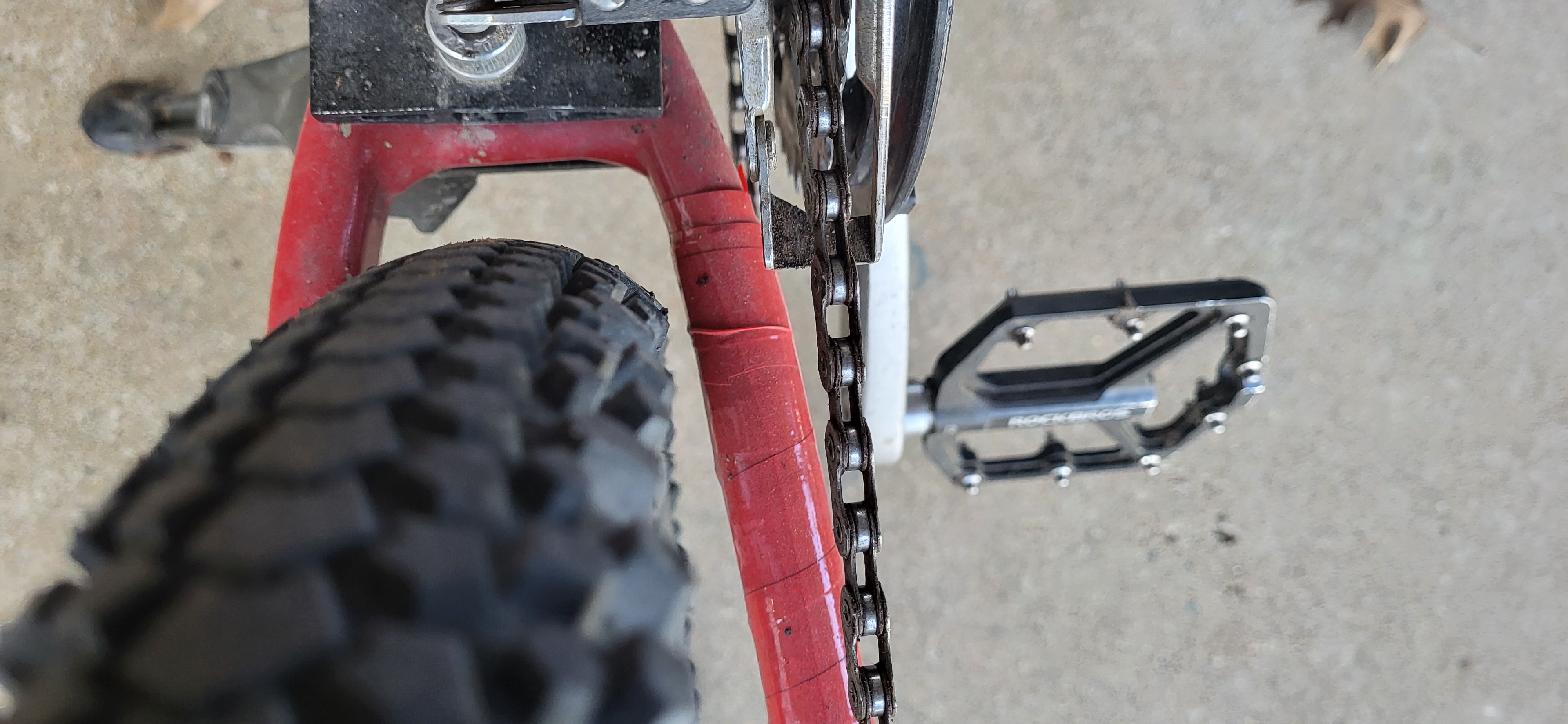

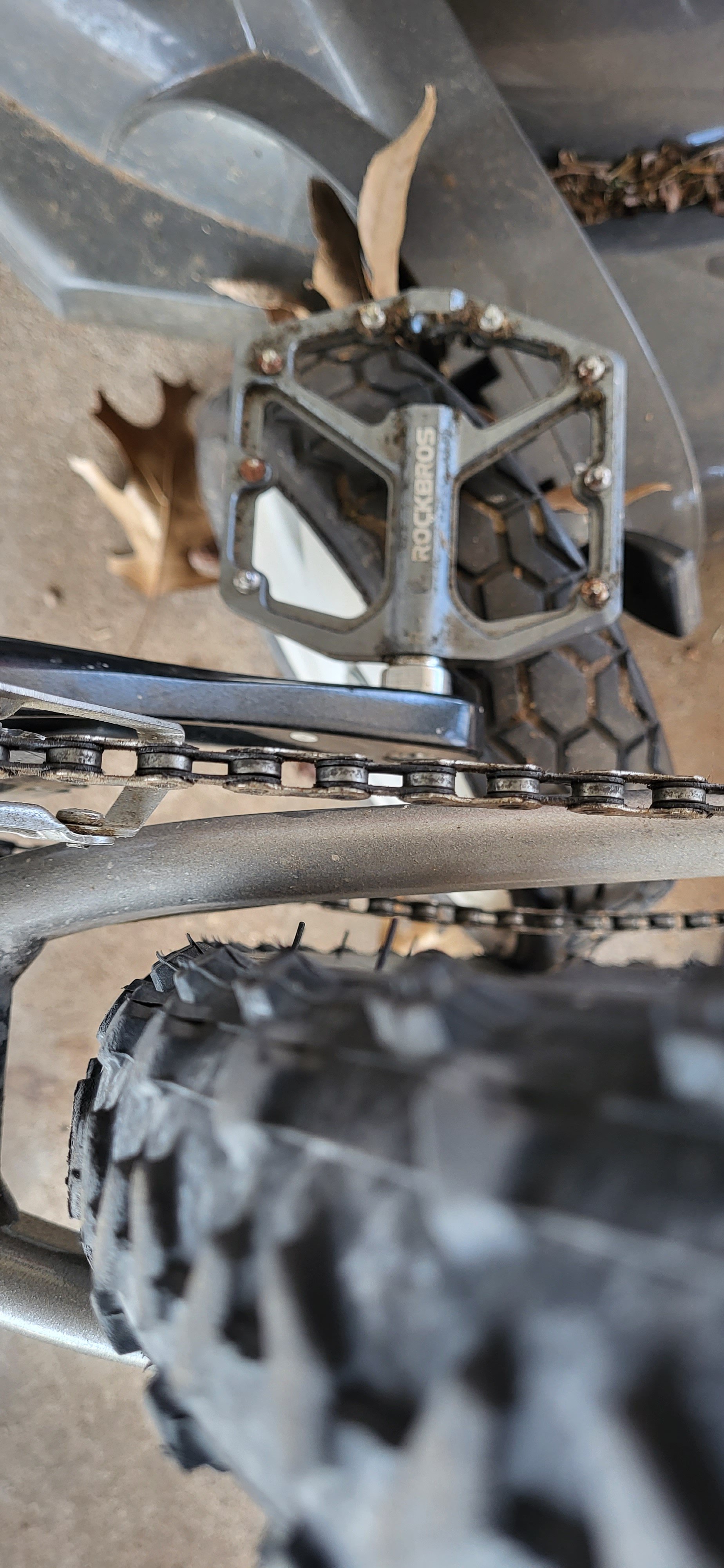

Here are pictures of the chain stay clearance for both of my 3.0 series bikes
94 Delta V 600 with 26x2.25 Michelin Country Trails (measured at 2.25" at the widest part of the tread while inflated @ 35 PSI)
92 M700 with 26x2.1Continental Traffics (measured at 2.2 at the widest part of the tread while inflated @ 35 PSI)
As you can see there isn't alot of chain stay clearance for anything much bigger than 2.25".

That’s very helpful. Yes, 2.25 looks like the limit, but the difference to 2.3 is roughly one mm. I will have to check if the clearance with the older, round chain stays Is less.
I checked my 1993 M800 with 2.25 Bontrager tire and chainstay clearance is similar to what JohnnyD posted. Much better clearance on the fork. I would think that clearance is going to be more dependent on brand/model of tire than 2.25 vx. 2.3.

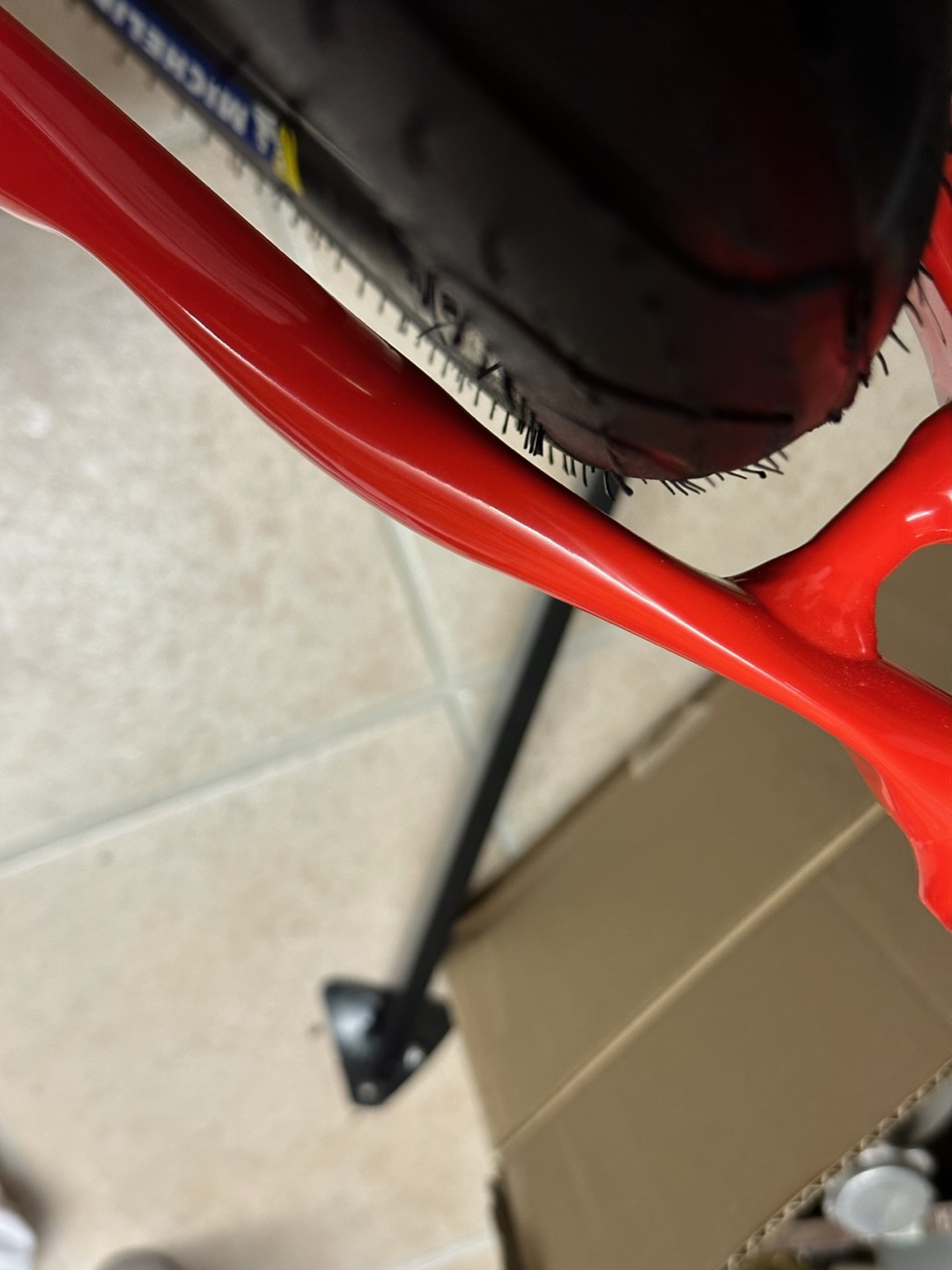

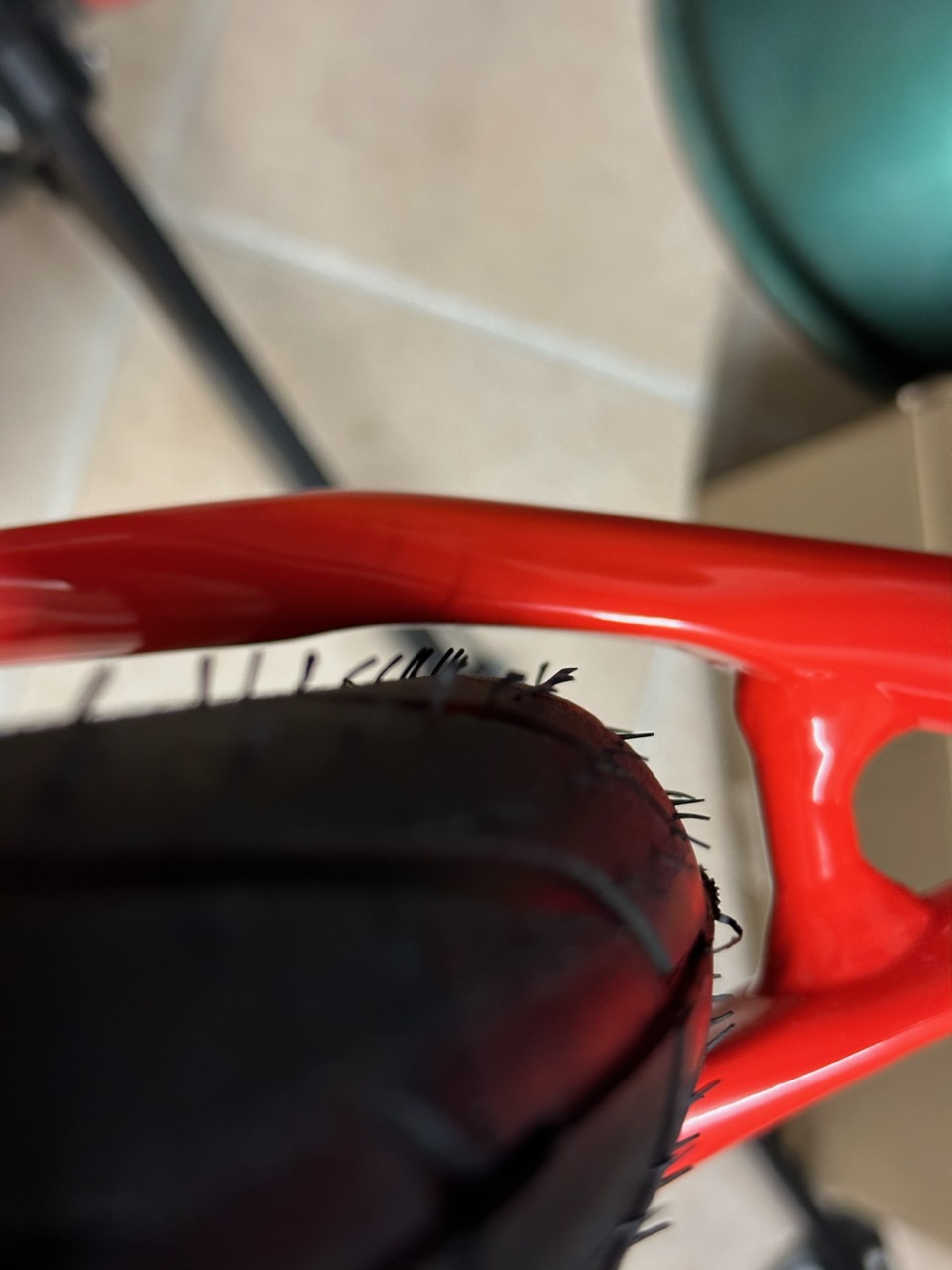

Successfully installed a 2.3 slick tire.
Makes sense that 2.3" slick would fit vs a 2.3" MTB tire.
So I take it you are going to use the bike on pavement more than trail use?
FPrue1304
I like slicks.in dry conditions slicks are great for most: pavement, gravel, stones etc. in wet conditions I am not found on my bike so often and would avoid mud. On my other gravel bike a wide slick is great and confidence building on loose ground. Here, I tried a super wide version to compensate for the smaller 26 diameter. It is a monster tire though. On my other gravel bike I use 47mm on 27.5.
