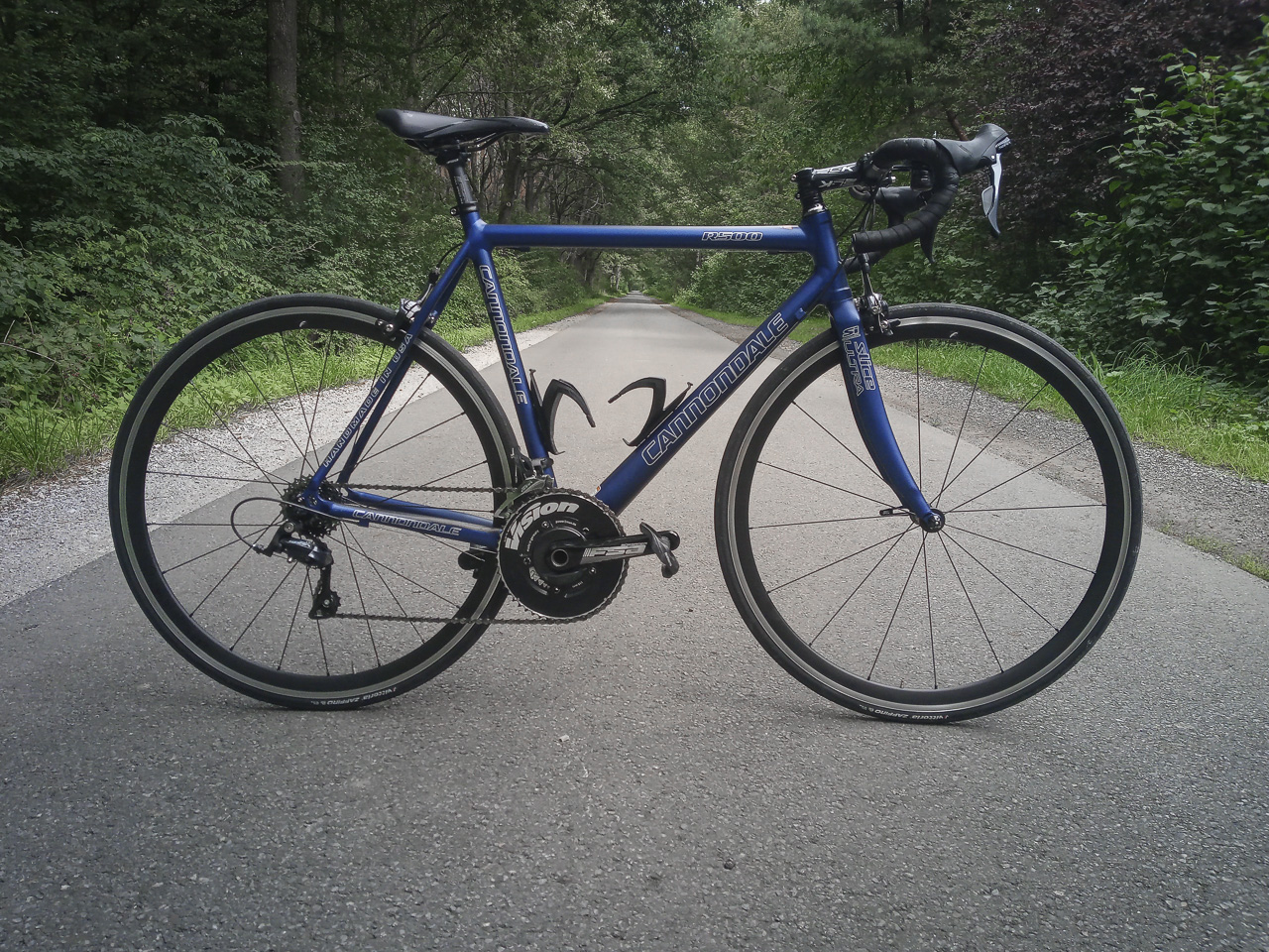

Since i've rebuild the CAAD5 some years ago i was always thinking about to change from SHIMANO's R3000-groupset over to SRAM.
coz SRAM somehow fits in my opinion way better to the Cannondale roadbikes... with all it's other components by VISION & FSA from the US.

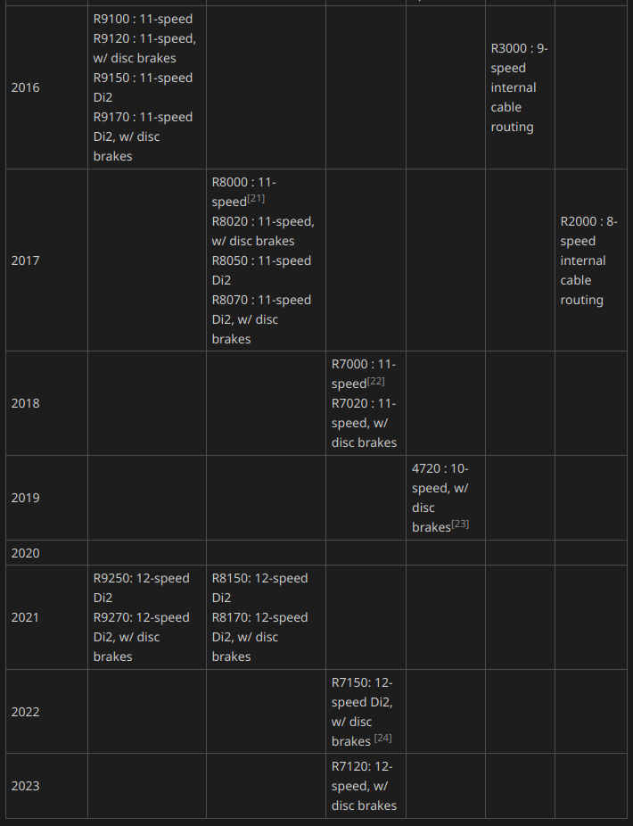

shimano's R3000 groupset is from 2016 and i was thinking to change/upgrade the groupset something similar to ULTEGRA R8000. would be nice. have an eye on some offers at 'kleinanzeigen' about SRAM Force22 with it's 2x11 gearing...

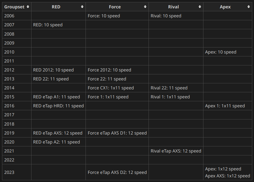

but... i have no clue about the differences. have never used SRAM components. does it feels so different to shimano? SRAM is pretty hyped nowadays and it's components are a little bit more expensive. even used.

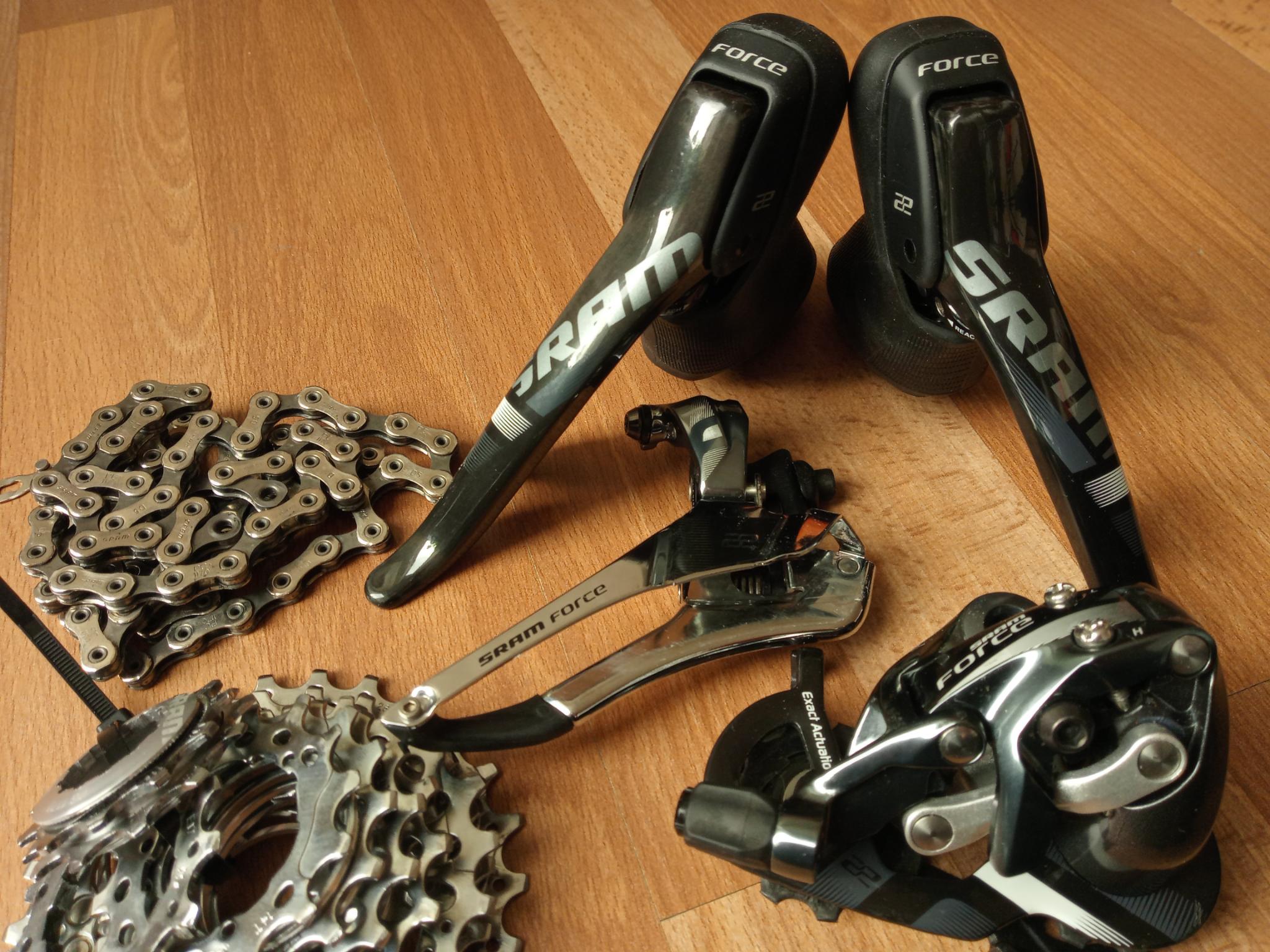

ok... sram got me... xD had the opportunity to get a force22-groupset on low budget in decent, neraly new condition. the parts are feeling good. way lighter than the sora r-3000 parts... i'm already excited to try it out. and how it will work on the CAAD5 :)

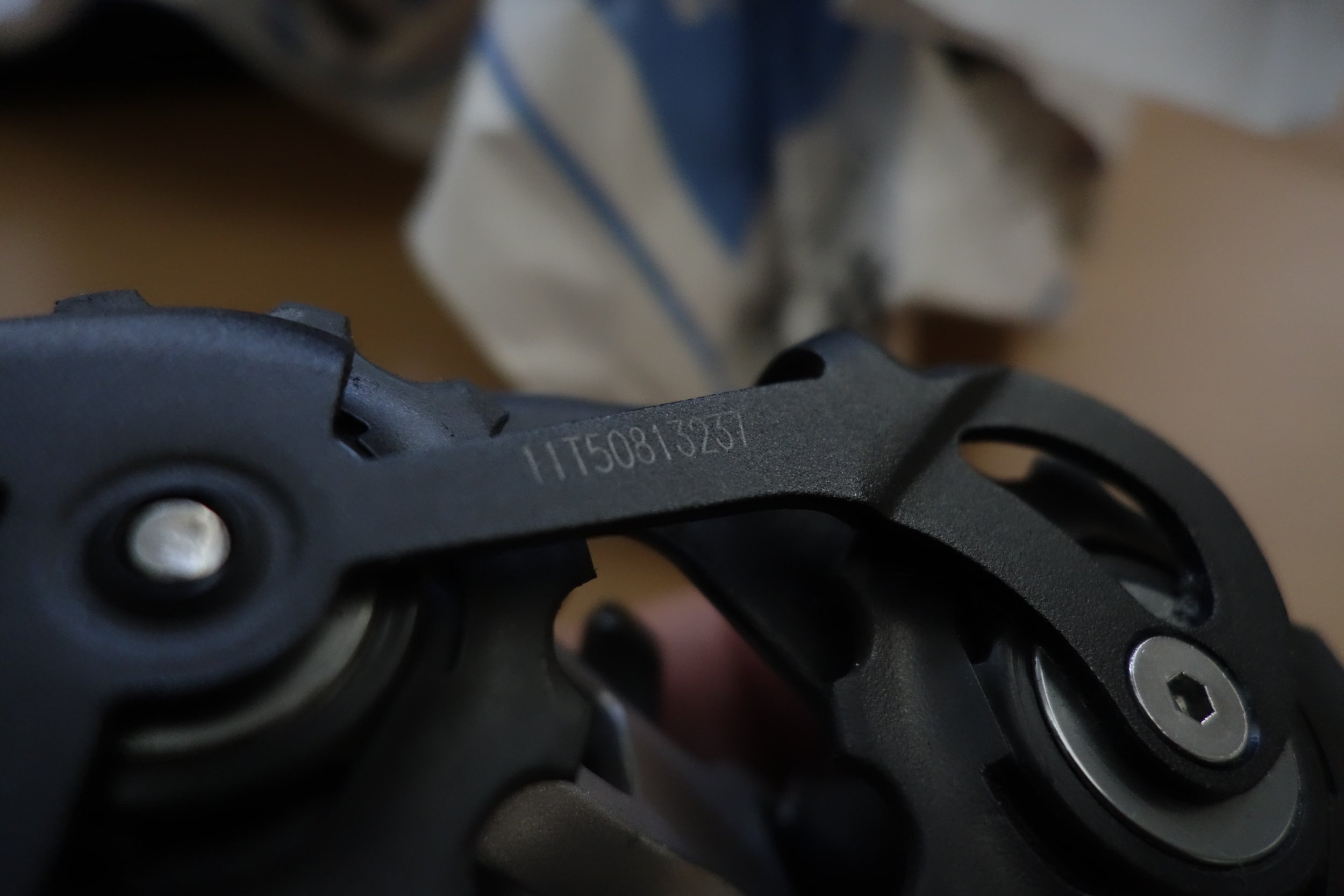

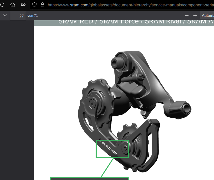

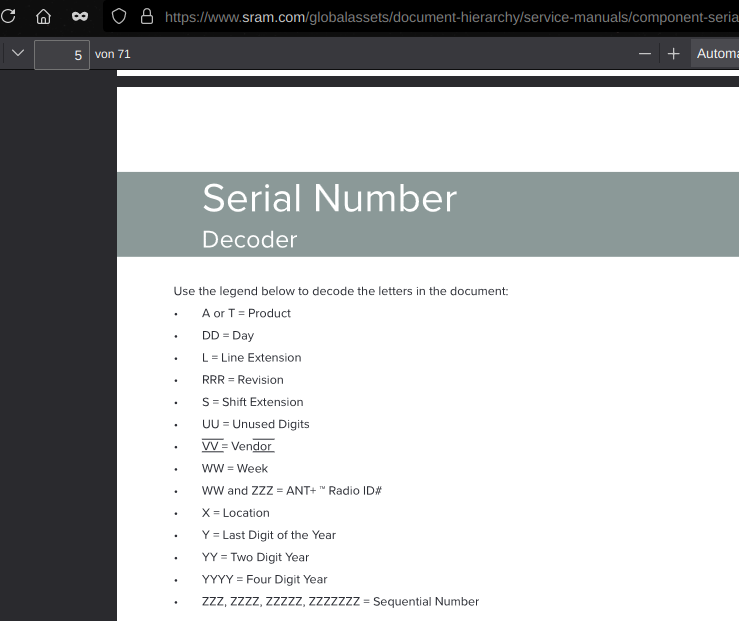

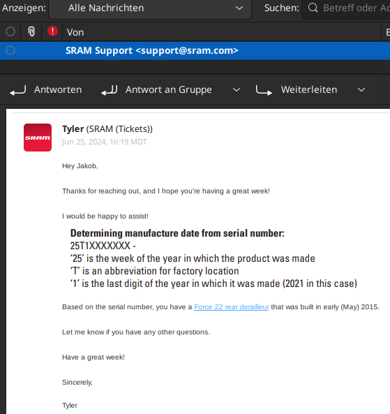

have sent a request to SRAM and got an answer. just in case someone afterwards is also interested to decode the SRAM-serial-number.
so in my case (11T50813237) the rear deraileur was made in 11th week of 2015.
