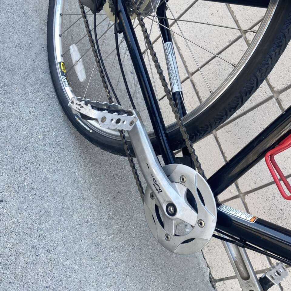

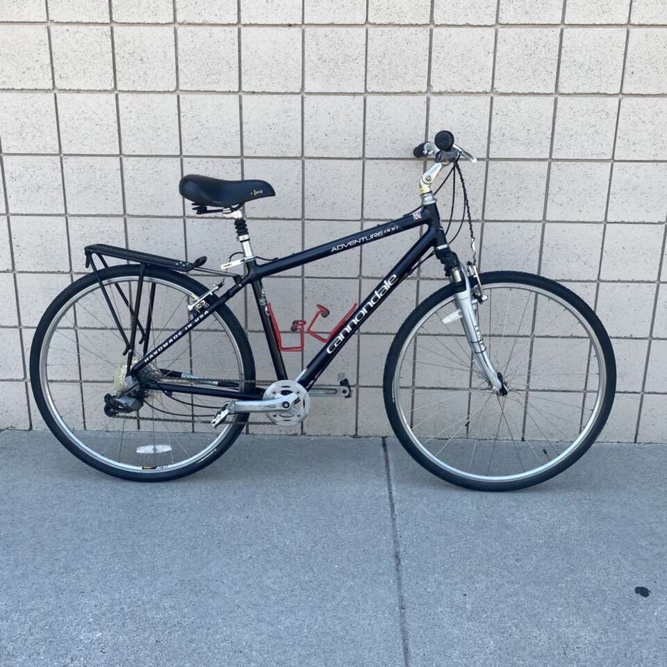

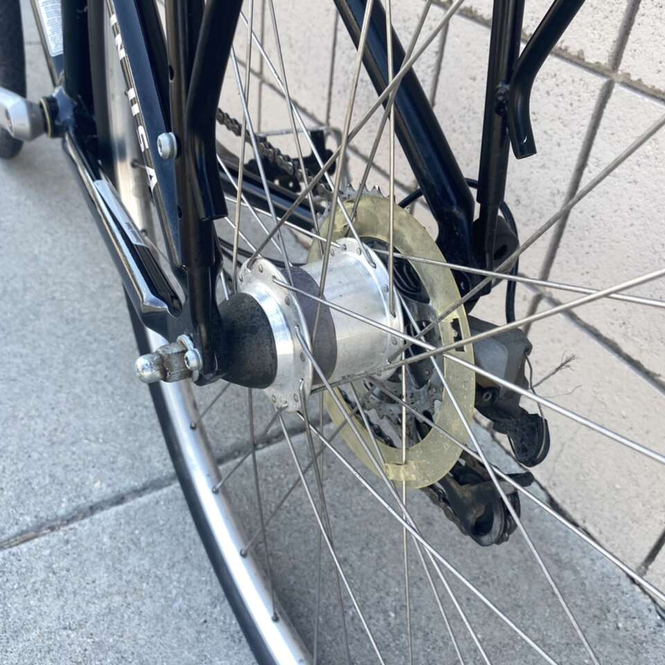

What would a thread be without pictures of the bike in discussion…..
Regardless of the complexity of the drive train, what an interesting find. Good looking bike on top of that.
