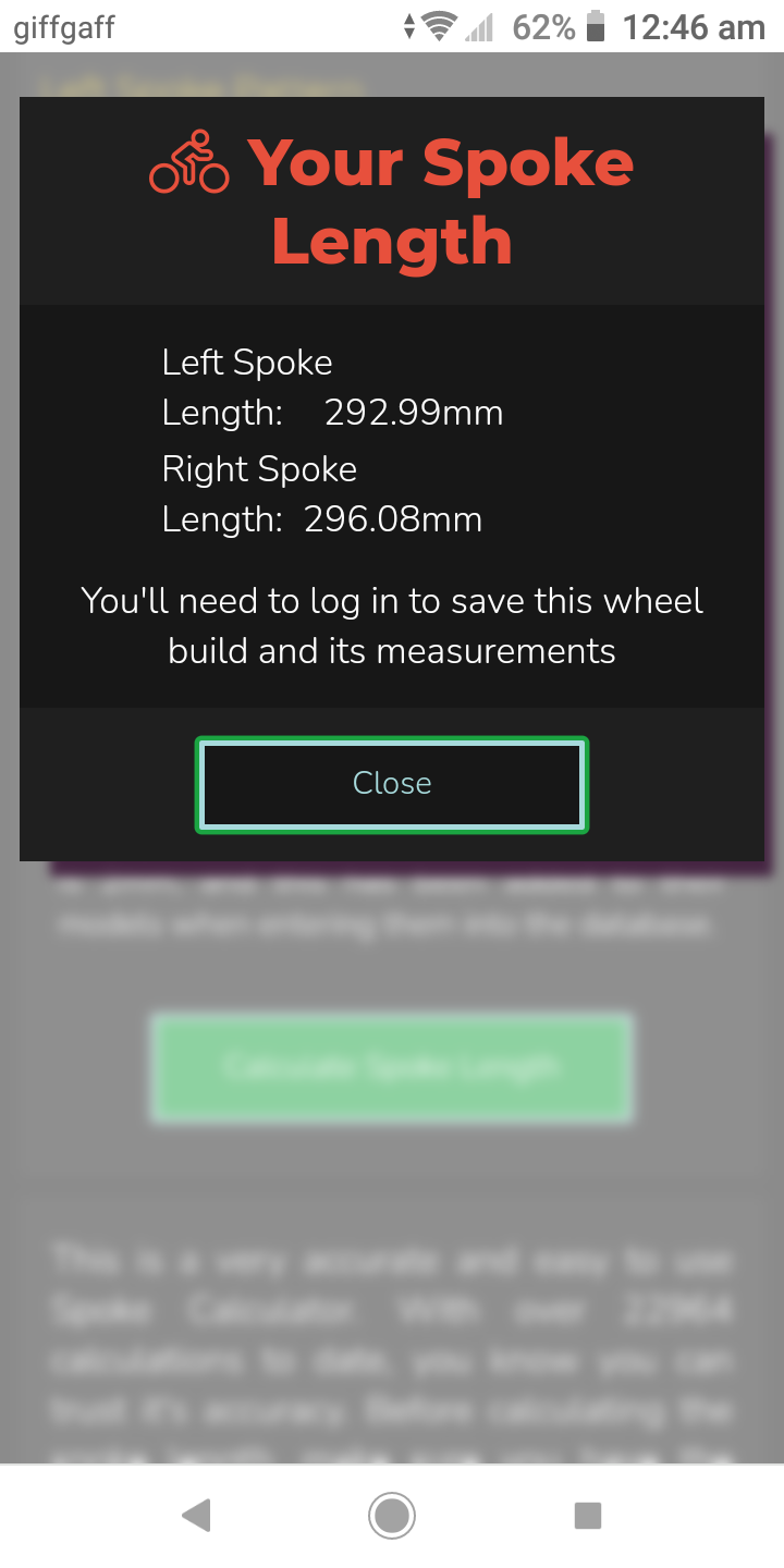

I'm hoping someone can help me please with spoke length as I'm getting nearly same size spokes for each side of my Hope hub and I don't think it's right.
32 hole Mavic Reflex SUP road rim double eye clincher 700c

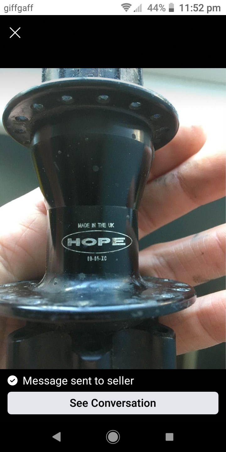

32 hole Hope XC hub rear 8/9/10 speed 135mm/QR disc brake version but not using the disc as will be building for V-brake.
Will be using 3X when building.

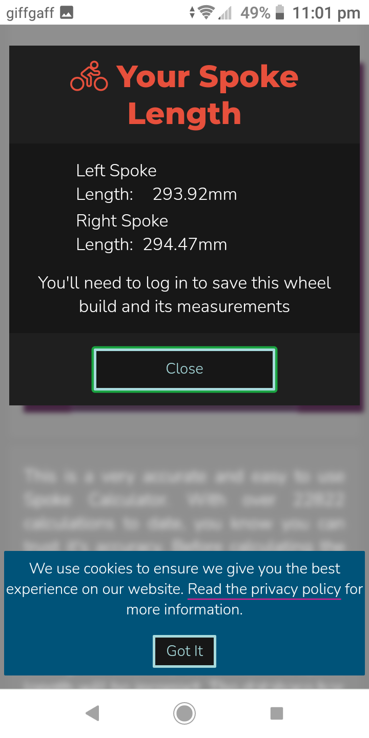

Yes tried spokecalculater.com but I'm not sure if it's correct as have my doubts as think spokes they are saying are too long.
Also had this size aswel from same site for same hub and rim.
Did you measure your hub and rim diameter or are you using dimensions from online sources?
I recall building a rear wheel with an Open Pro and Zipp hub with the same length spokes on each side, but I might have cheated on each side a bit. Wheel build was fine, but the Zipp hub was the weak link and I didn't get many miles out of it.
