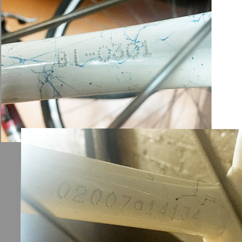

Mourned the theft of my '96 Killer-V for a whole weekend, only to find a sweet SH400 hybrid on CL! Feeling much better already.
It's in the 1991 catalog (white frame, blue detail) but was trying to decipher the serial. Can't see the year on it.
Looks like
BI-0301 on one seat stay and 02007 o 14134 on the other. Any idea what that means?
Thanks!
Lucy

rickpaulos
sn faq here:
https://vintagecannondale.com/info/serial_numbers/
1986-1992 serial numbers on stays.
02007o14134 That o is a 9 shifted down a bit.
02007914134
20" frame?
July 1991? 4,134th bike built that month?
also, the link above shows the decal/logo changes over the years. Scroll to the bottom of the page to see those.
catalog
https://vintagecannondale.com/year/1991/1991.pdf
page 27 for the SH400 in white with the blue splatter.
that BI-0301? I've seen the same or similar on countless treks. perhaps that's a part number for the frame.
rick
Agree with Rick, that's a 20" frame with 130 mm rear spacing (the first 0), July 1991 production. Looks like the 9 stamp slipped out of the holder prior to stamping. Nice find, I've been looking for a 22" SH for years.

Great sleuthing! Thanks gentlemen, that makes sense! I'll get some pics up when I've given it a clean. I think it's gorgeous.
