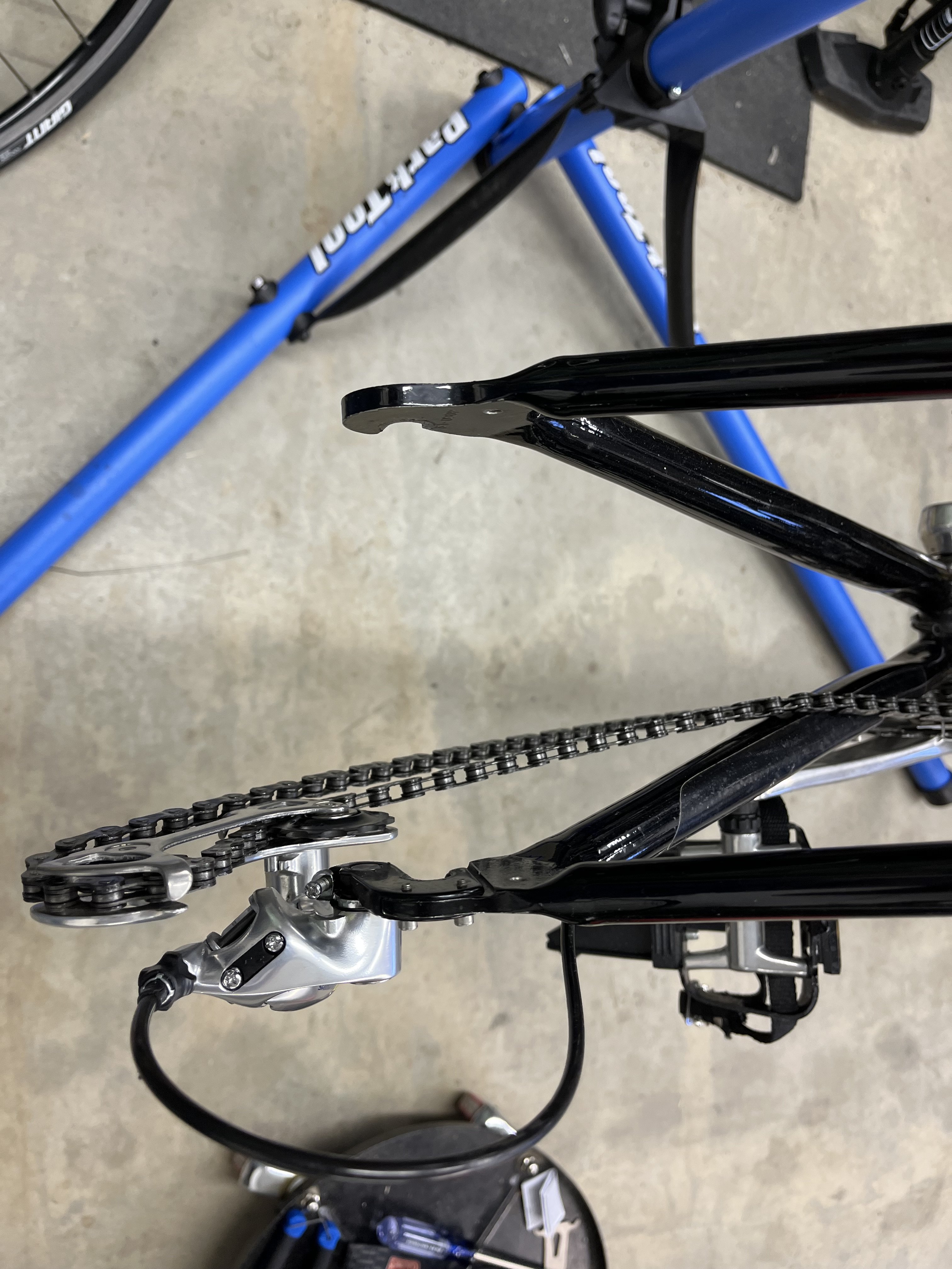

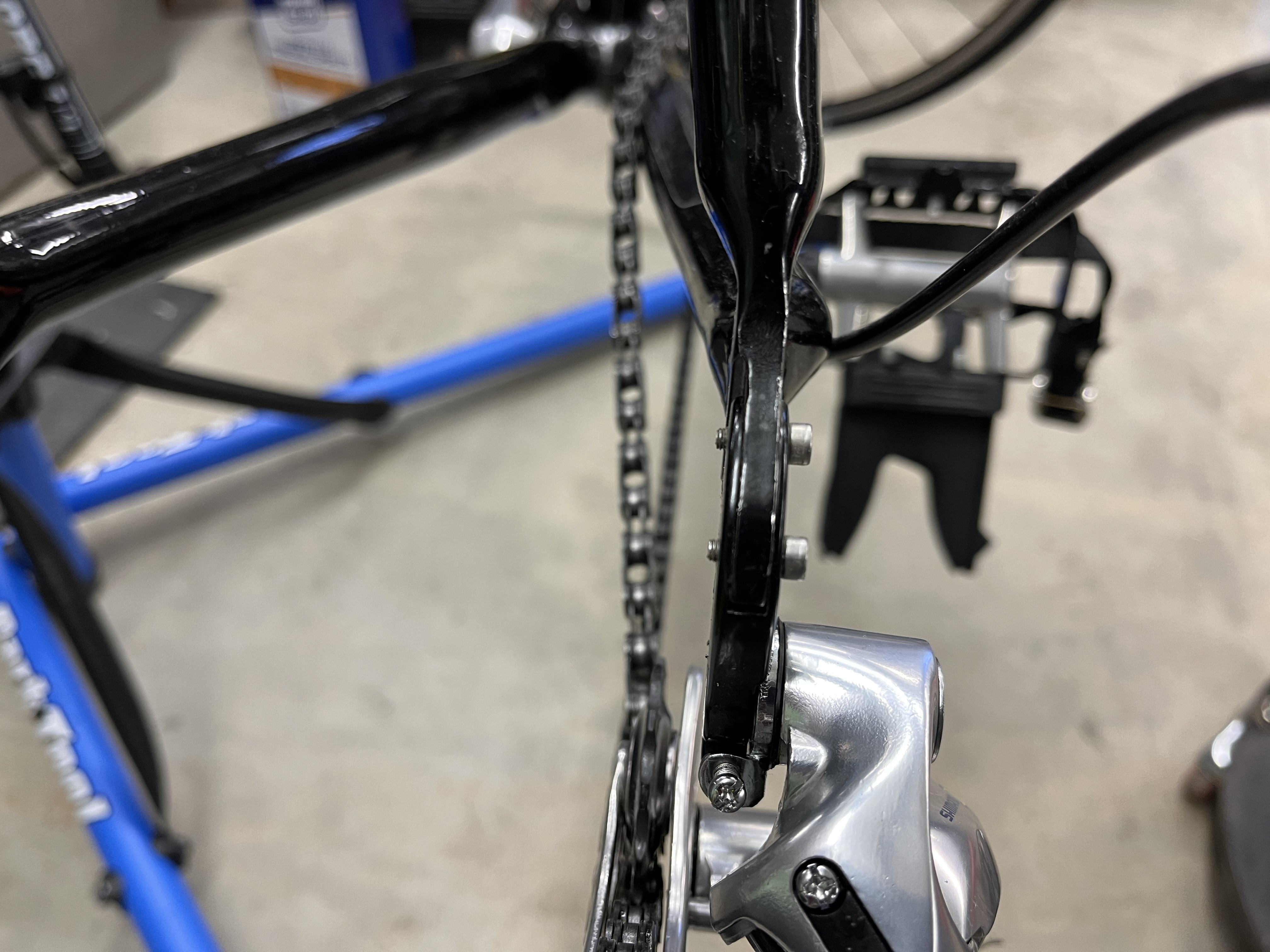

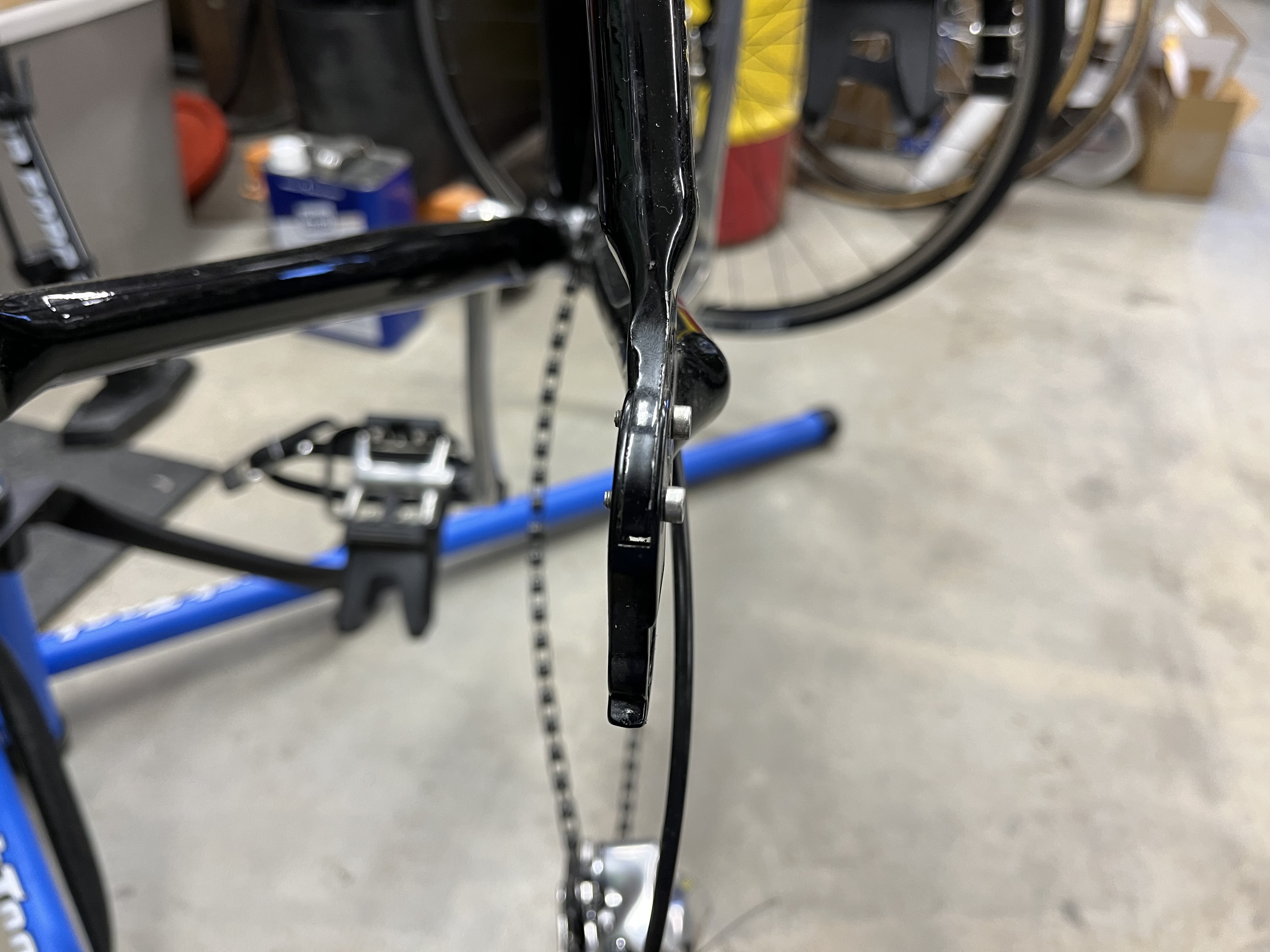

I do believe I’ve discovered the issue. The first step in the video is to make sure the derailleur hangar is straight. It looked straight enough to me in the beginning. After struggling for a few days I had another look and eyeball compared it with my other bikes. It is not straight. Looking at a picture with wheel removed it is obvious now. And the frame almost looks bent.

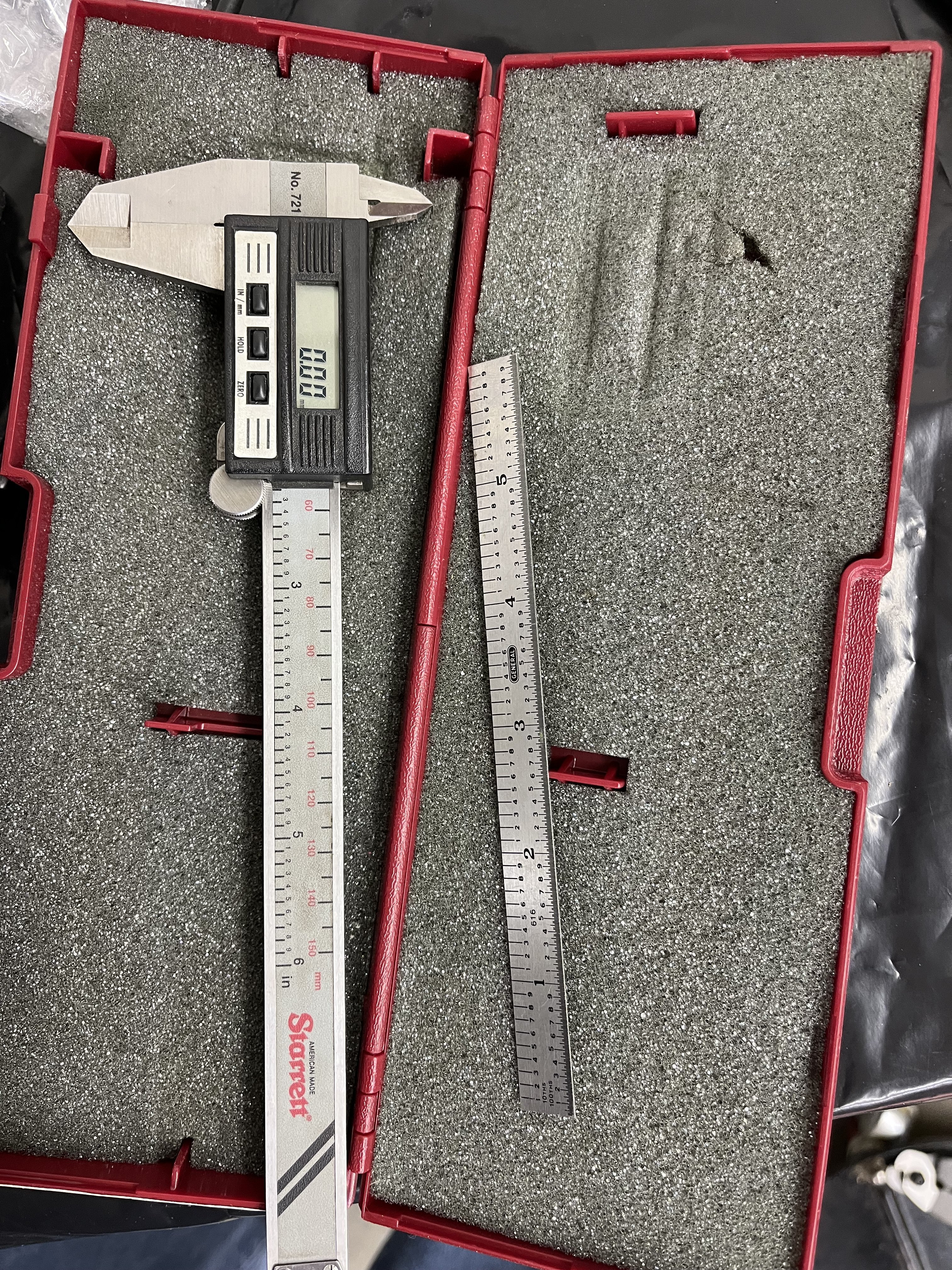

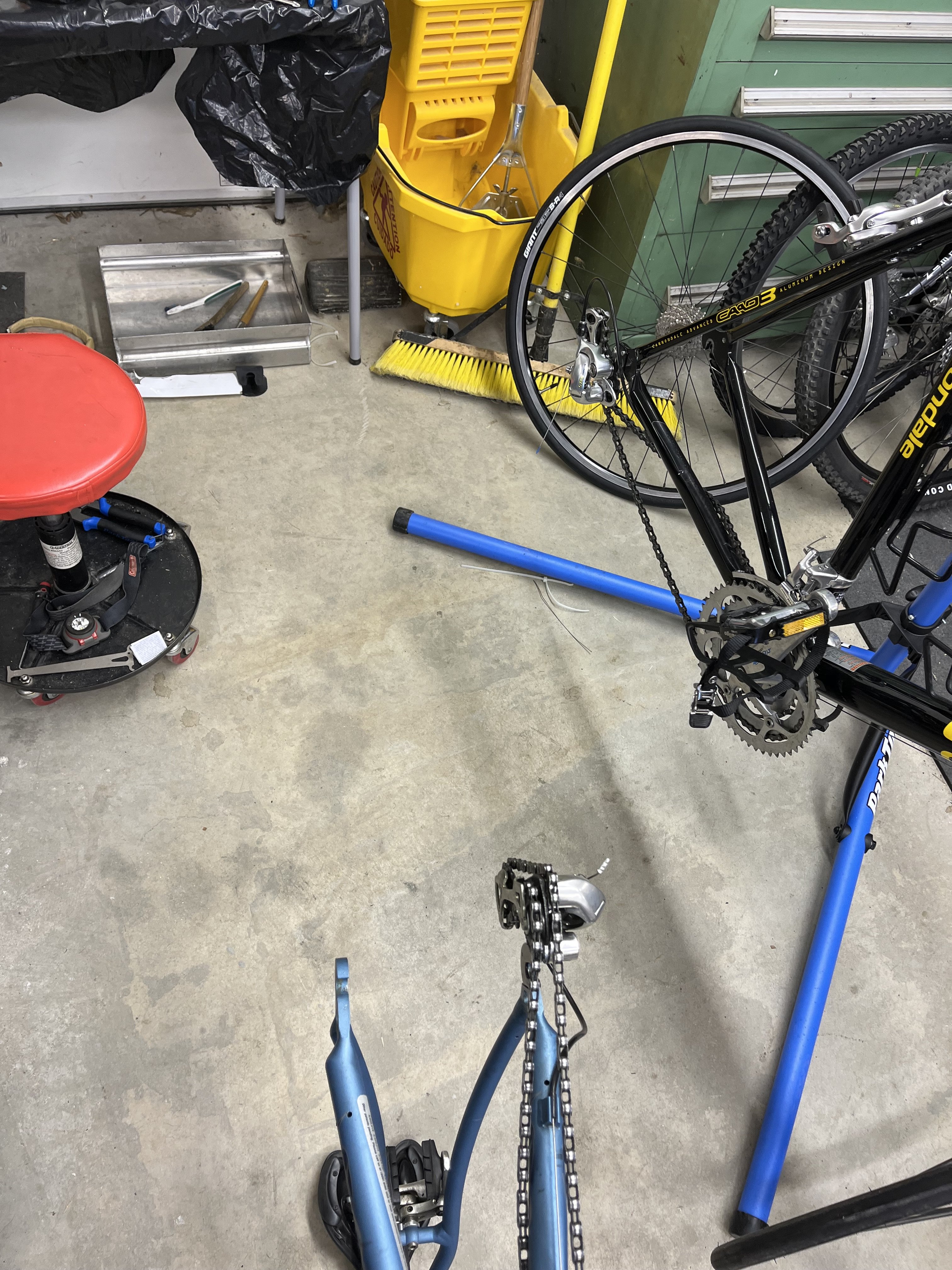

Nope. Optical illusion with all the curves. Nothing is bent. I carefully measured and compared to my CAAD4 frame. If there are differences it’s less than half a mm. It’s a bicycle not an airplane.
