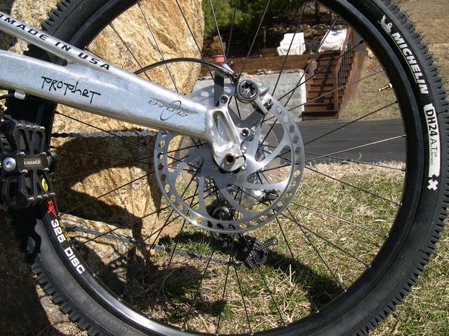

2.) The only way you can tell is the drop outs. Photo is attached from the web, (Thru 12)

Thanks Brian. Is that a 24" rim on that pic?

The rim in that photo looks like a 26". stock Mavic rim.

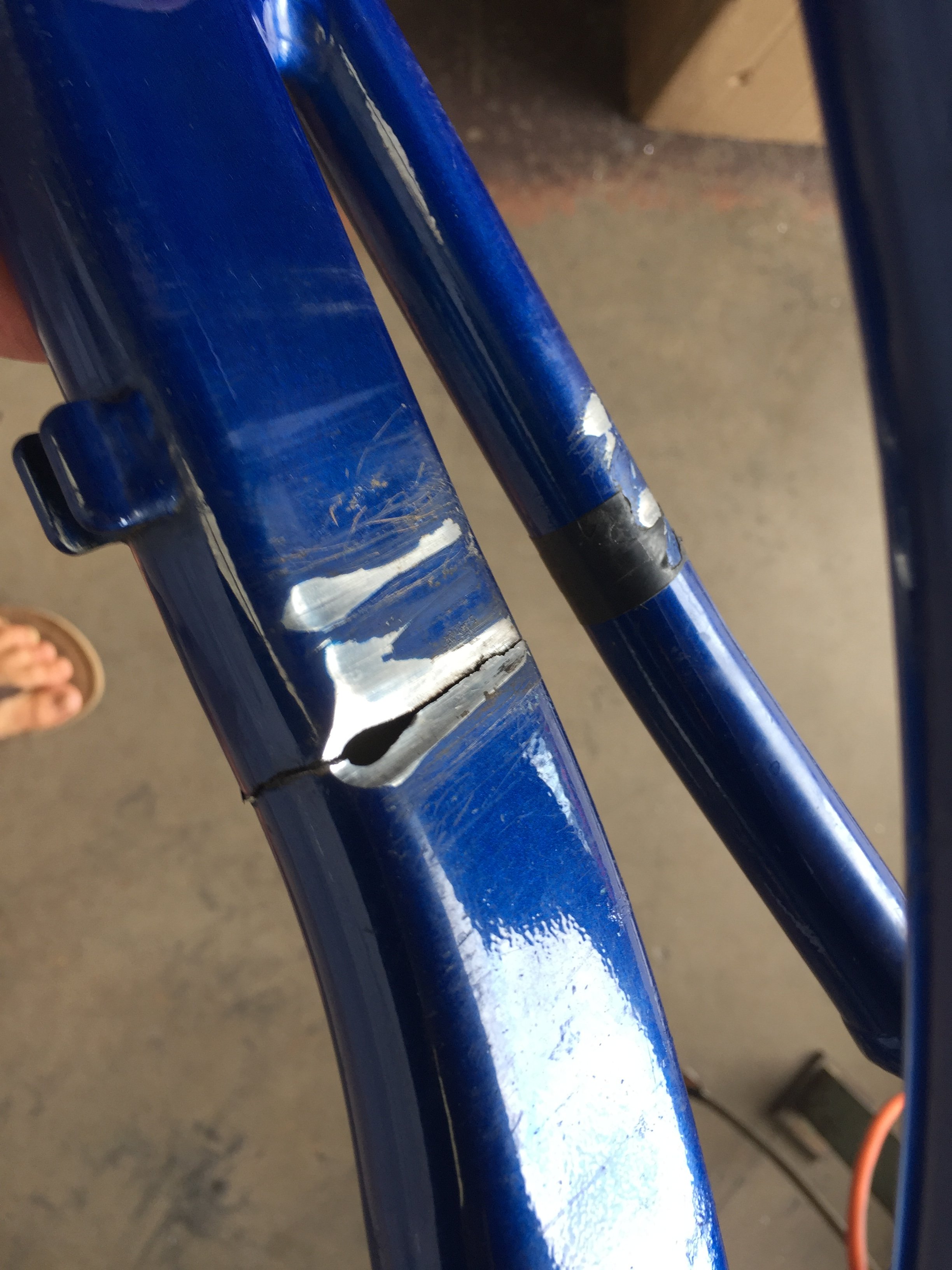

I do have a question for you. Can you post a picture of the damage to your rear swing? I have not heard much about these rear swings breaking. The Super V bonded ones are famous for breaking. I have 2 broken ones...

Thanks Brian, just about to sit down watch another marvel movie with the kids (so many of them!!) no time to hunt up the pics of the break... but no matter because... Broke some spokes on a muddy as hell ride, the DH tire rubbed on the swingarm and wore right through it ie a clean rub hole spanned entire inside of main beam. Of course the rest of the beam fractured the next big hit.
Hi Brian and crew, heres the tire rubthrough that resulted in the breakage of my dear old prophets swingarm..

I cant believe your prophet rear swing. Did you notice the rub? Do used Prophets pop up for sale in Australia much?

My poor prophet, it was so muddy and fullon gravity goat trak, buckled broken wheel, recipe for disaster. Now I know better... Ive seen a few complete bikes online the last few months, no 12mm thru from what I could see... I may have to bite the bullet and go with standard.
