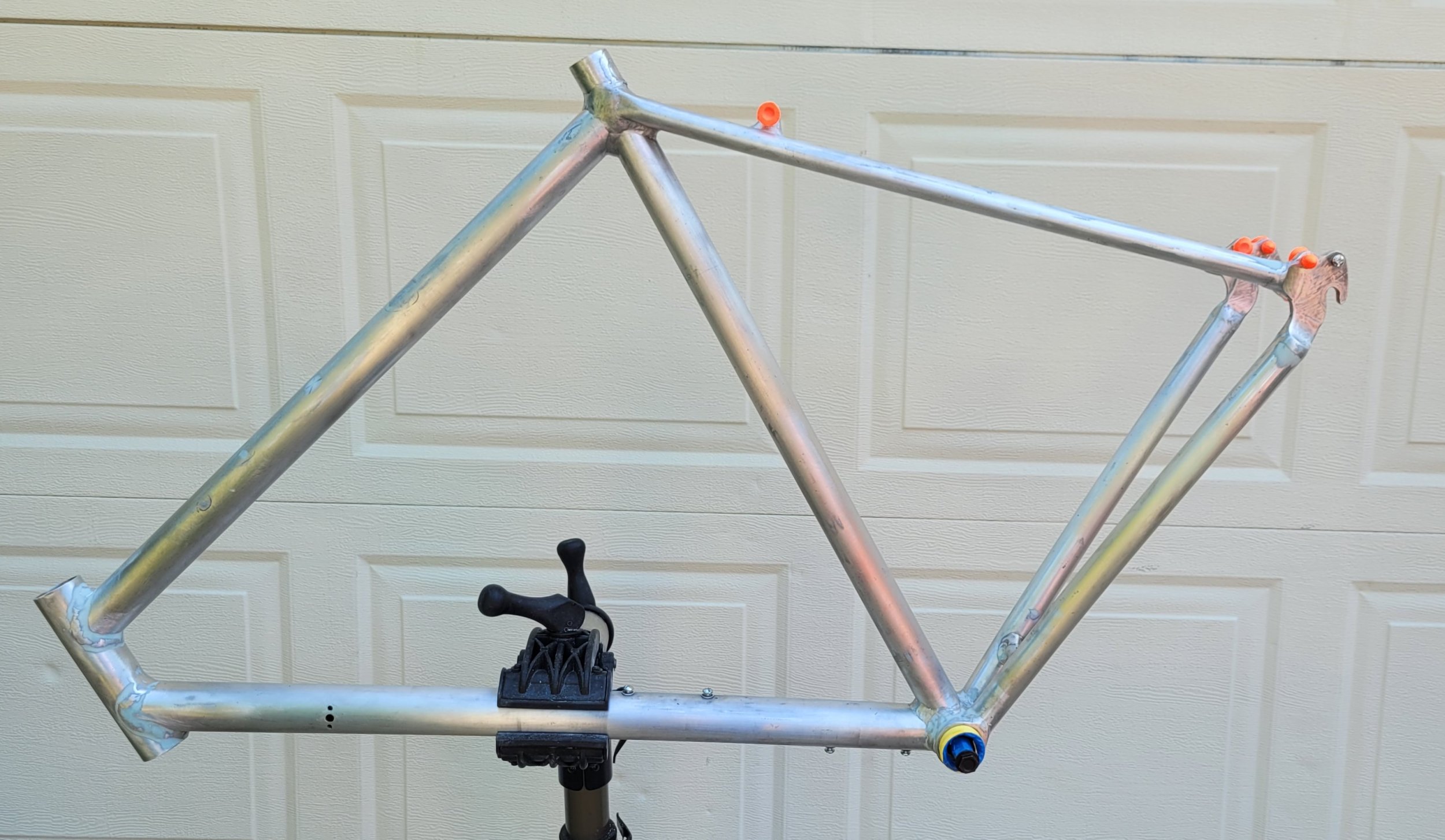

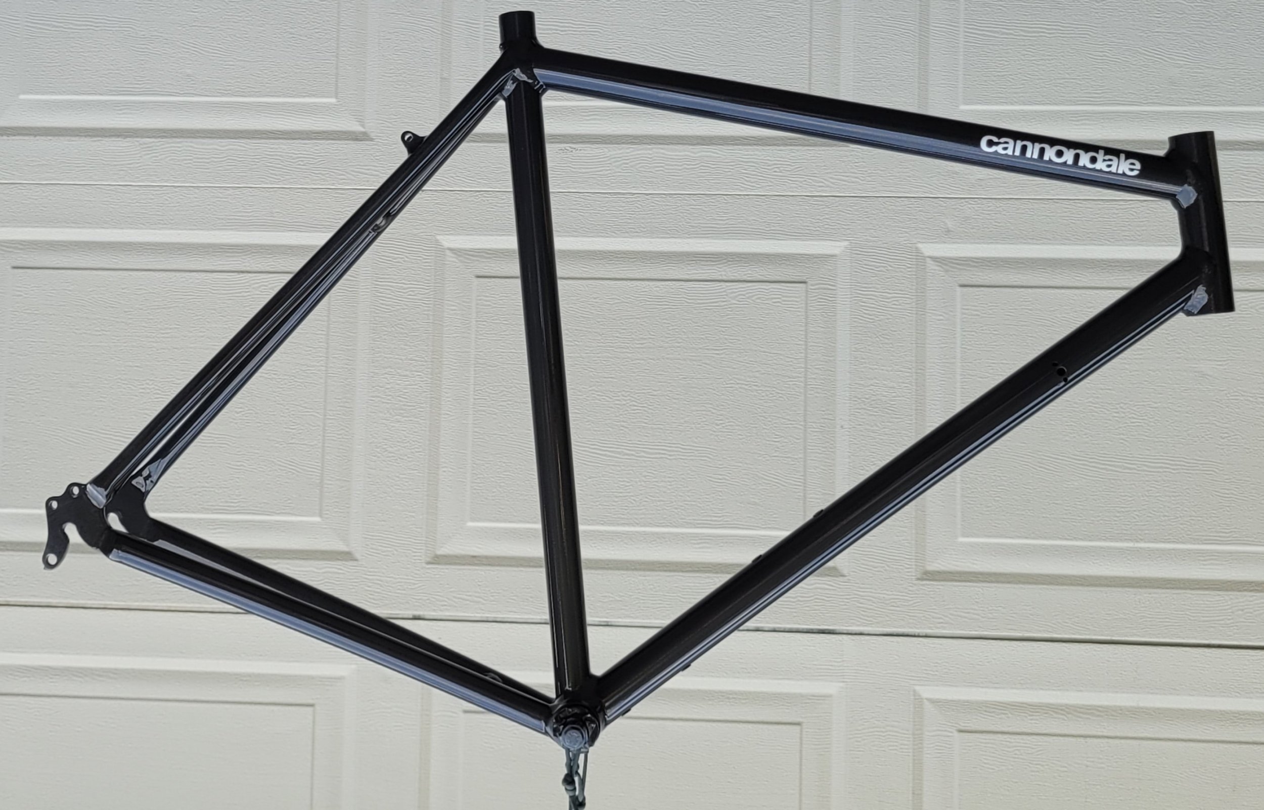

The frame’s stripped and ready for primer, I have some good aluminum-compatible epoxy stuff. I can’t find anyone to shoot the paint (WTF is with body shops nowadays?), but a local supplier turned to me on to an isocyanate catalyzed auto paint system in a spray can so I’m giving it a go.
I’d like to find a set of stickers for the logo on the top tube. Scaling from the photo in the old sales brochure pdf I have, it looks like the original Cannondale logo was about 128 mm long. I'm planning to use them as stencils over a white basecoat, shoot the rest of the frame with a cool looking Graphite tone (the original color was Charcoal), then remove them before clearcoating.

Finally shot the color. I grabbed a jpg snip of the logo from the '83 pamphlet, and used my wife's Cricut machine to cut out masking tape stencils from it. Should have let the white flash off longer before I applied them, some adhesive got left behind when I pulled them off. The Graphite basecoat's a bit thin in spots, should have gotten more but I can live with it. I think it turned out fairly well, not good enough to deliver to a customer by any means but I'm okay with it.

In the meantime I cleaned things off and got the fork straightened. The clearcoat took FOREVER to fully harden, I had the frame hanging for at least two weeks (including a couple of days baking in the sun) but it was still soft enough to take an impression from the chamois I wrapped it in when I put it on the stand. I didn't clamp it very hard, either.

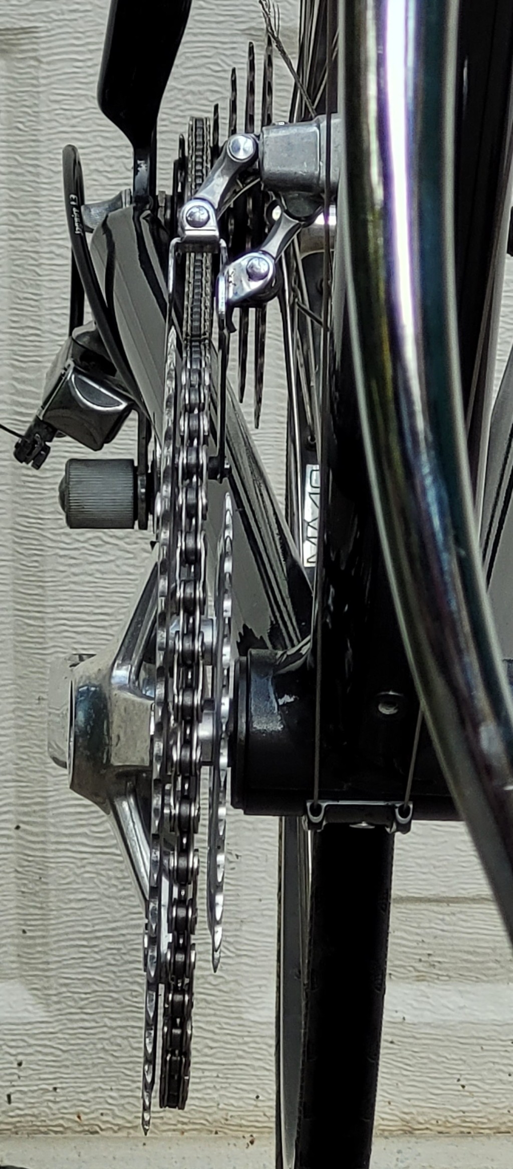

My knee issues have had me toying with the idea of putting a midrive e-motor on it (CYC Photon), but hadn't realized how whacky the chainline is. The main rings are lined up with the smallest freewheel sprockets, but the granny is so close to the frame there's no way to move the crankset inboard. And the 44 tooth ring is only ~7mm from the frame, so even with a single ring on the motor I'd be pretty much stuck. Some of my rides involve 5%+ uphill grades for miles (which I always did on the 30-tooth chainring), and I don't think I want to risk destroying my new chain and freewheel trying it on a 44. Maybe I can find a torque sensing hub motor.

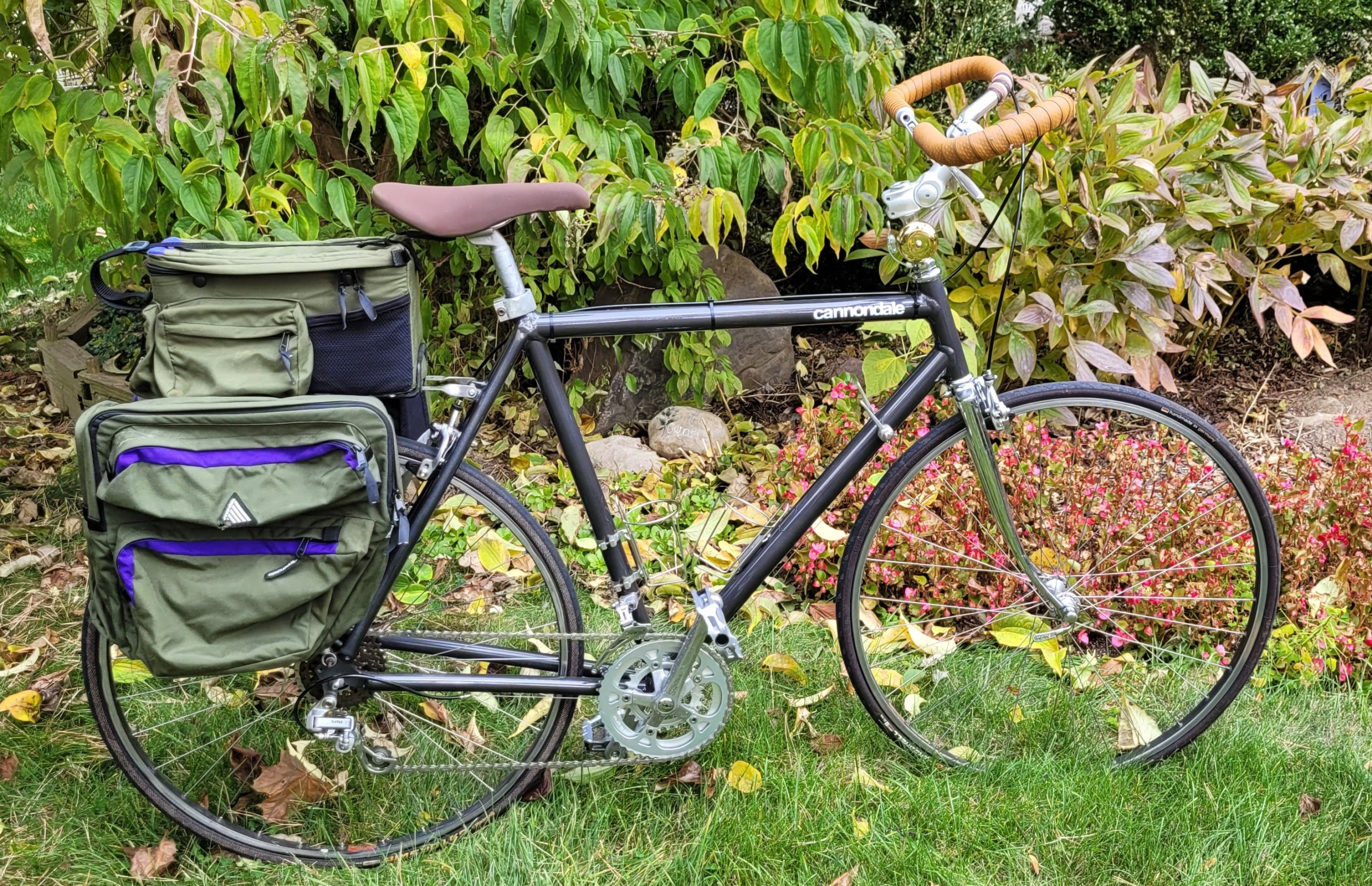

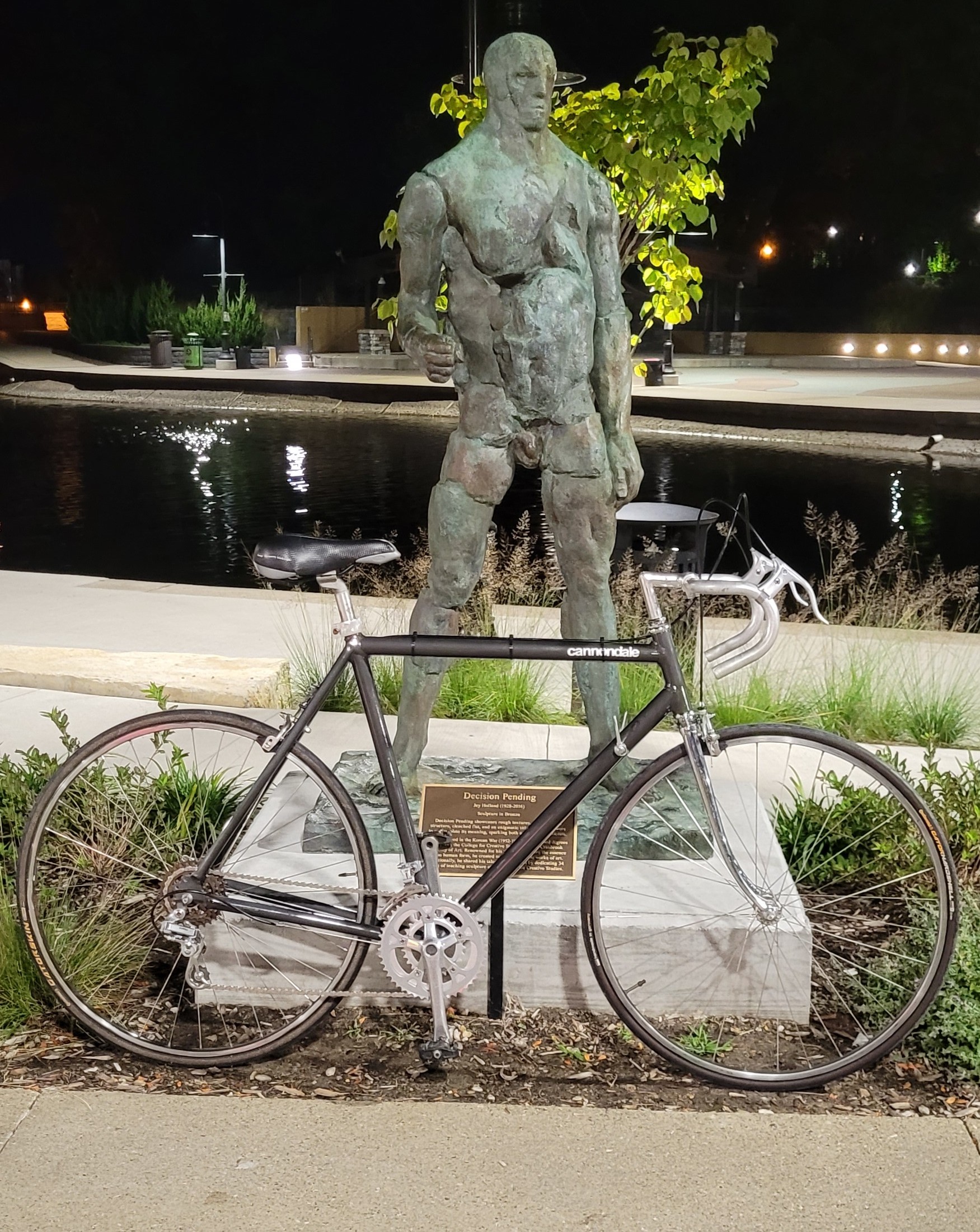

Got it together enough for a short ride last night, it was good to be in the saddle again and it rode very nicely. Lots more to do yet, but it'll happen more slowly now. Saddle, obviously. I want to go to 32mm tires, so new wheels. Fenders. Good racks and bags. Pretty sure I want to increase the handlebar height, so at least a new stem but I'll wait until I get to a good fitter to see exactly what I need there (she's booked out until December). I'd really like to find good replacements for the rear brake cable guides on the top tube.
The statue is locally known as "The Ugly Naked Guy", but IMO it's the best piece among all of the public artwork in my town.

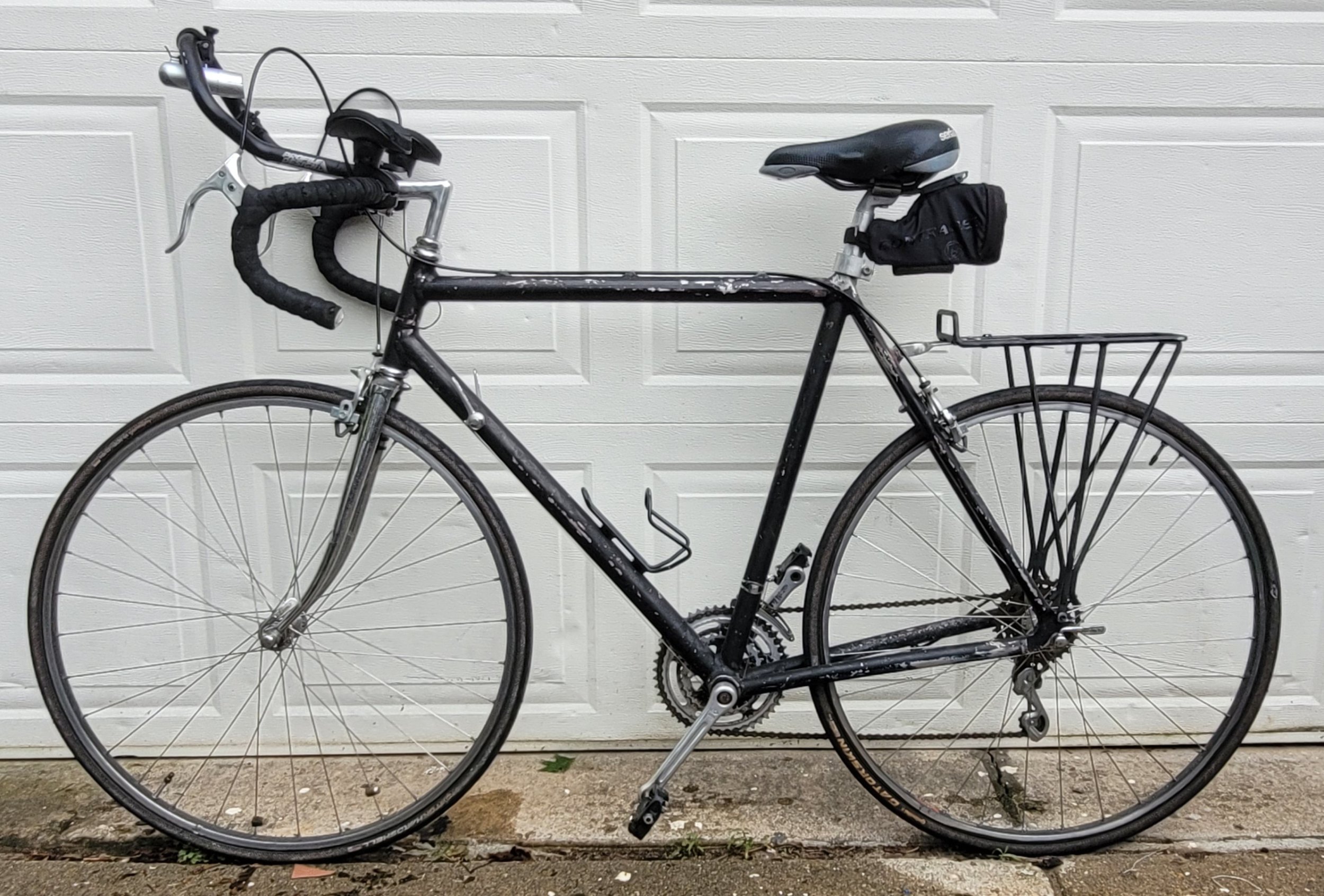

Getting closer. I put flat pedals on and found that the natural position of my feet is about an inch and a half farther out than how my clipless were set; I rode that way for thirty years so I guess it's no surprise that it aggravated my got-kicked-by-a-horse-once knee.
Got a threadless stem adapter and butterfly bars from VO, and the adjustable stem off Amazon; I really like the more upright riding position and the variety of hand placement options. The Dia-Compe DC189 brake levers I got from Blue Lug, I thought they were supposed to have a short throw but I guess not. If anyone knows of something similar that'll work with my side-pulls I l'd appreciate hearing about it.

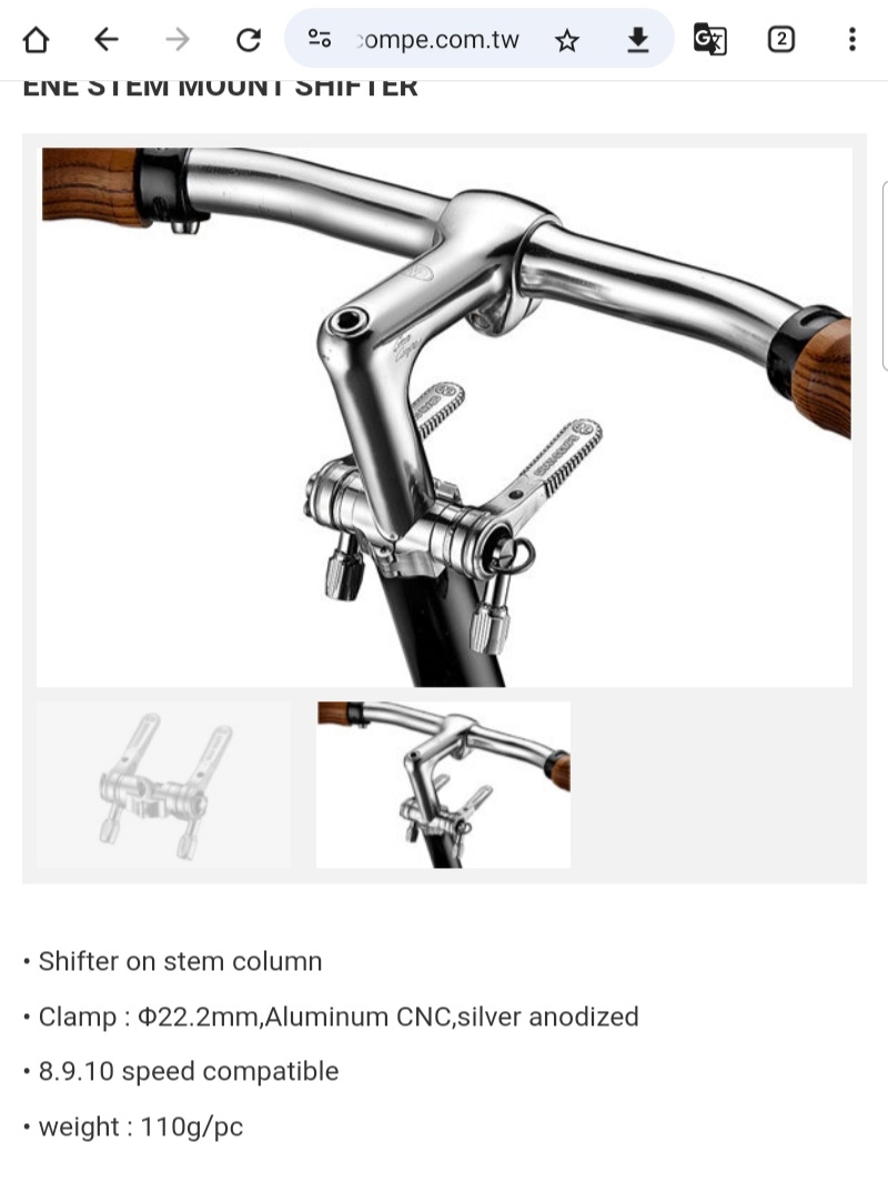

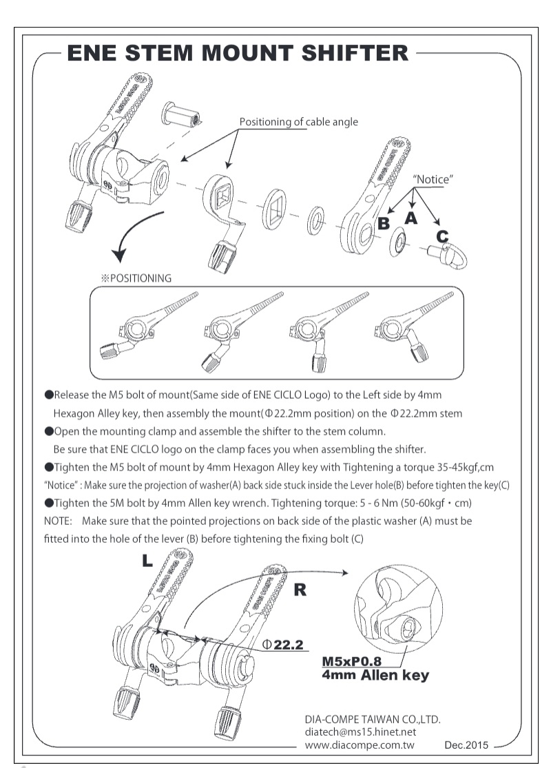

But now it's harder to get to the shifters, so I want to move them up onto the stem. I don't see many good options for that, I might have to fabricate my own mounts.
I'm not crazy about the VO saddle, but it was only fifteen bucks. I figure I'll end up with a Brooks Carved or a Selle Anatomica something-or-other. I'd also like to get some road isolation on the seatpost, something without too much bounce.
I stumbled on the B1200LI rear panniers on FB marketplace, they're not quite the right period and are smaller than I was really looking for but I think they're probably big enough for the rides I'll actually be doing most times and they're in really good shape. My wife thinks they look great. The seller also had a pair of B119EBO front bags in black, so I got those too. I'm scoping out front racks, and am thinking that something from Old Man Mountain would be a good choice.

Maybe?
chilehed
Thanks for breaking the logjam free, it helped me find these, these, and these as well. I'll look closely at all four, some are not cheap but I've had more expensive hobbies in the past.

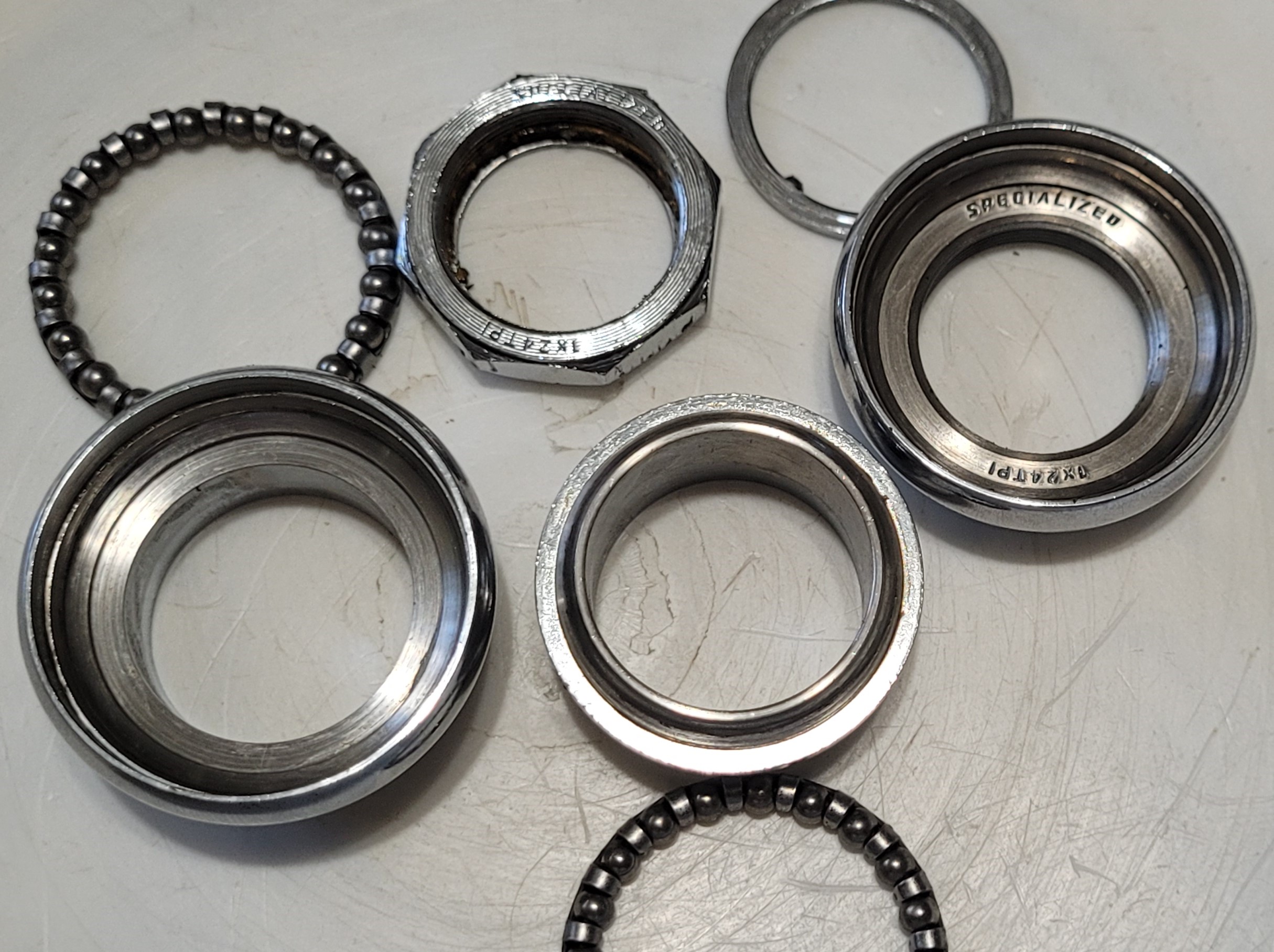

Do you have any history on the chrome fork?
I'm not the first owner but far as I know it's the original part. I can't find my note of what markings were on it, but I'm also searching for a sealed bearing headset replacement so I can have another look when I yank it out. The VO part looks good but they're OOS.
