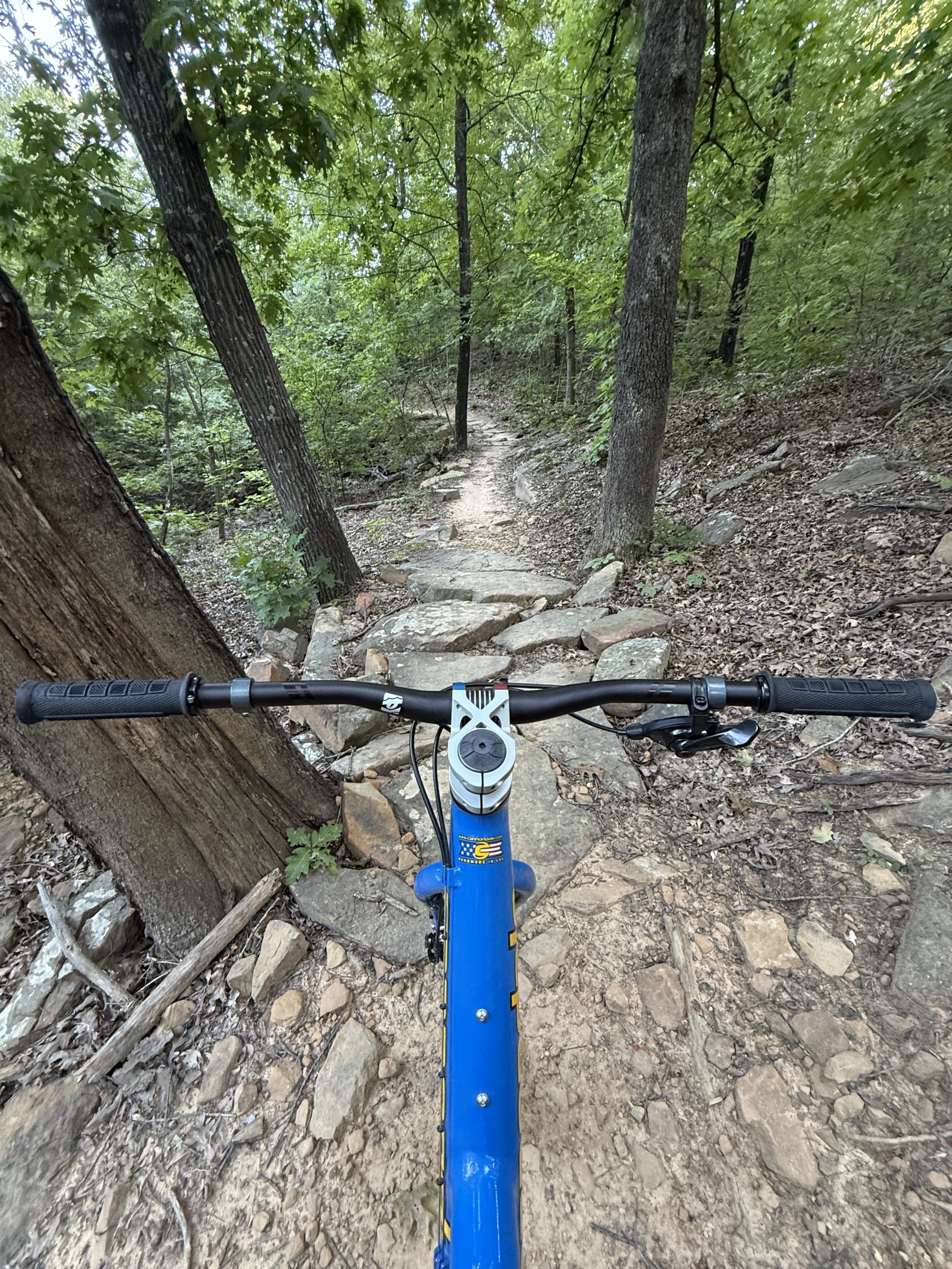

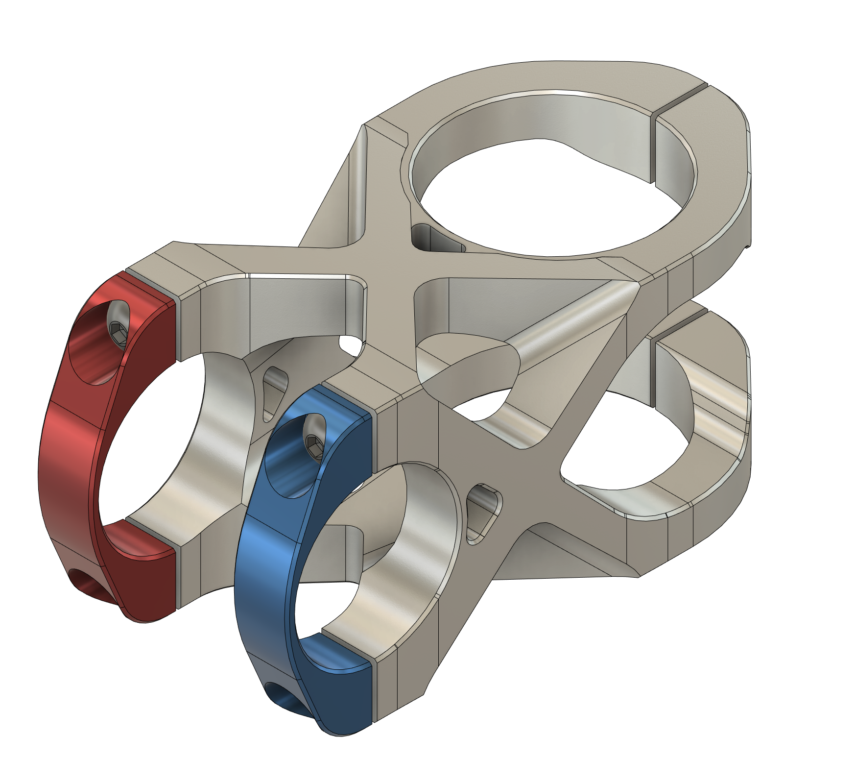

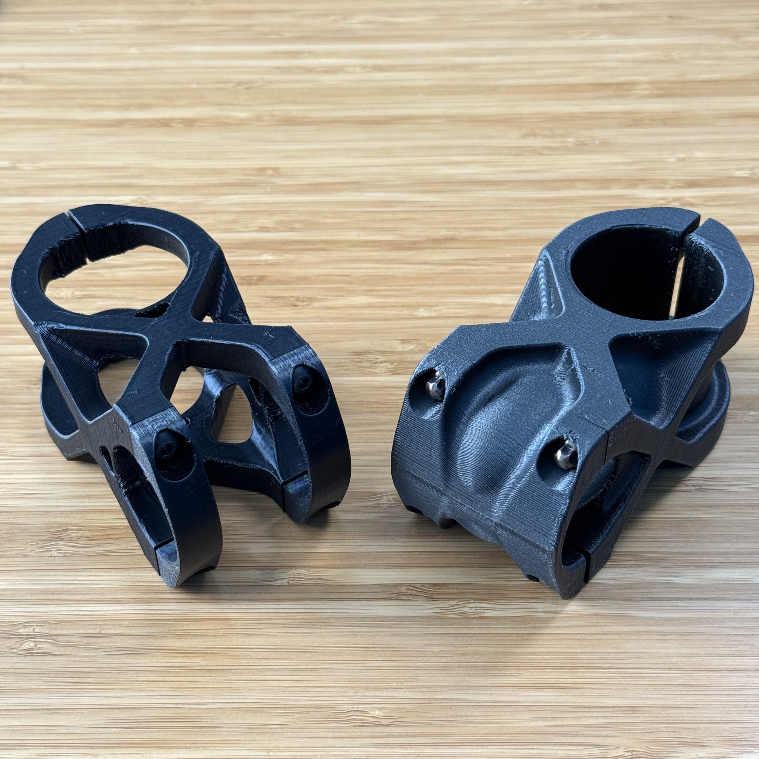

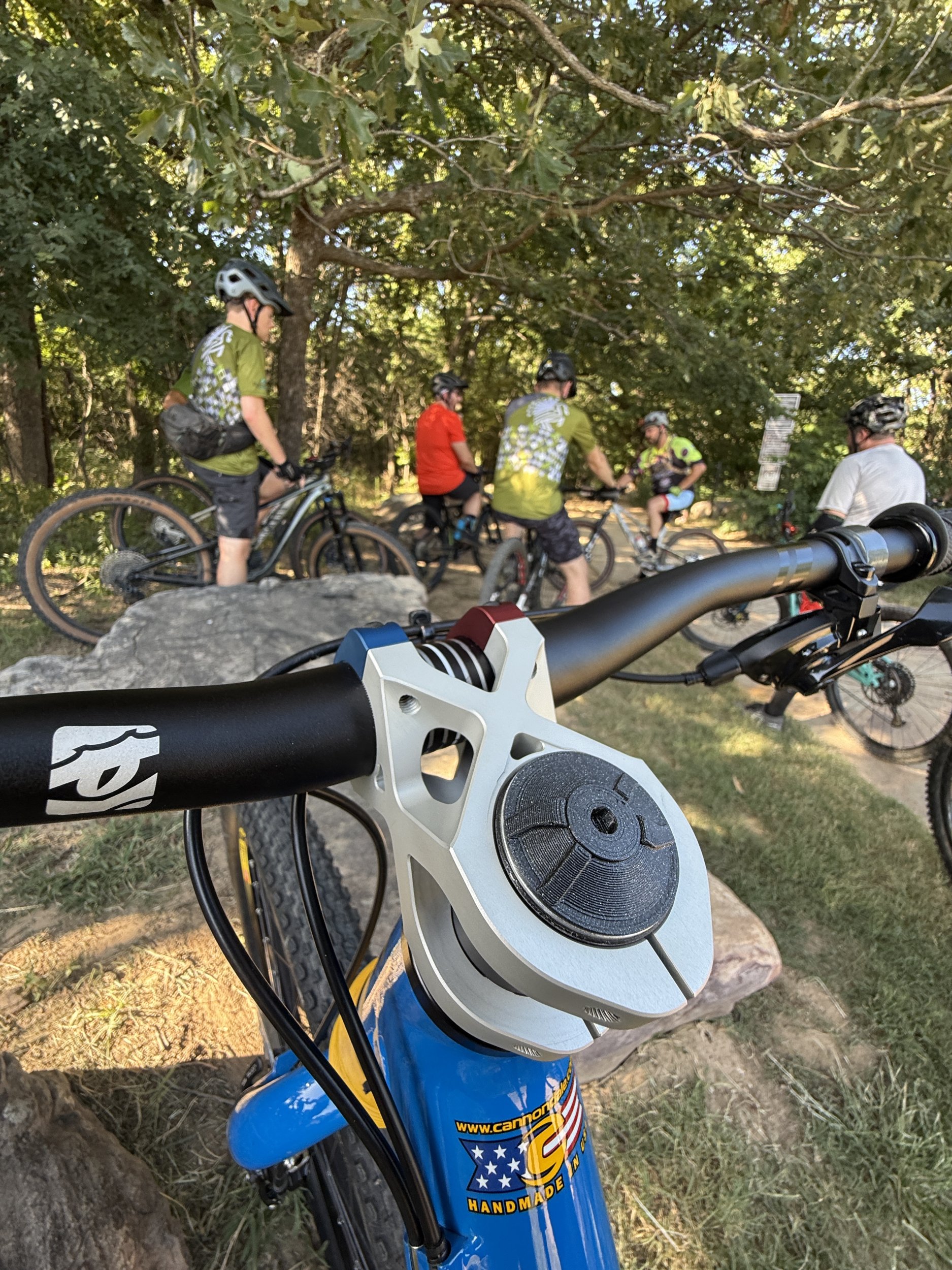

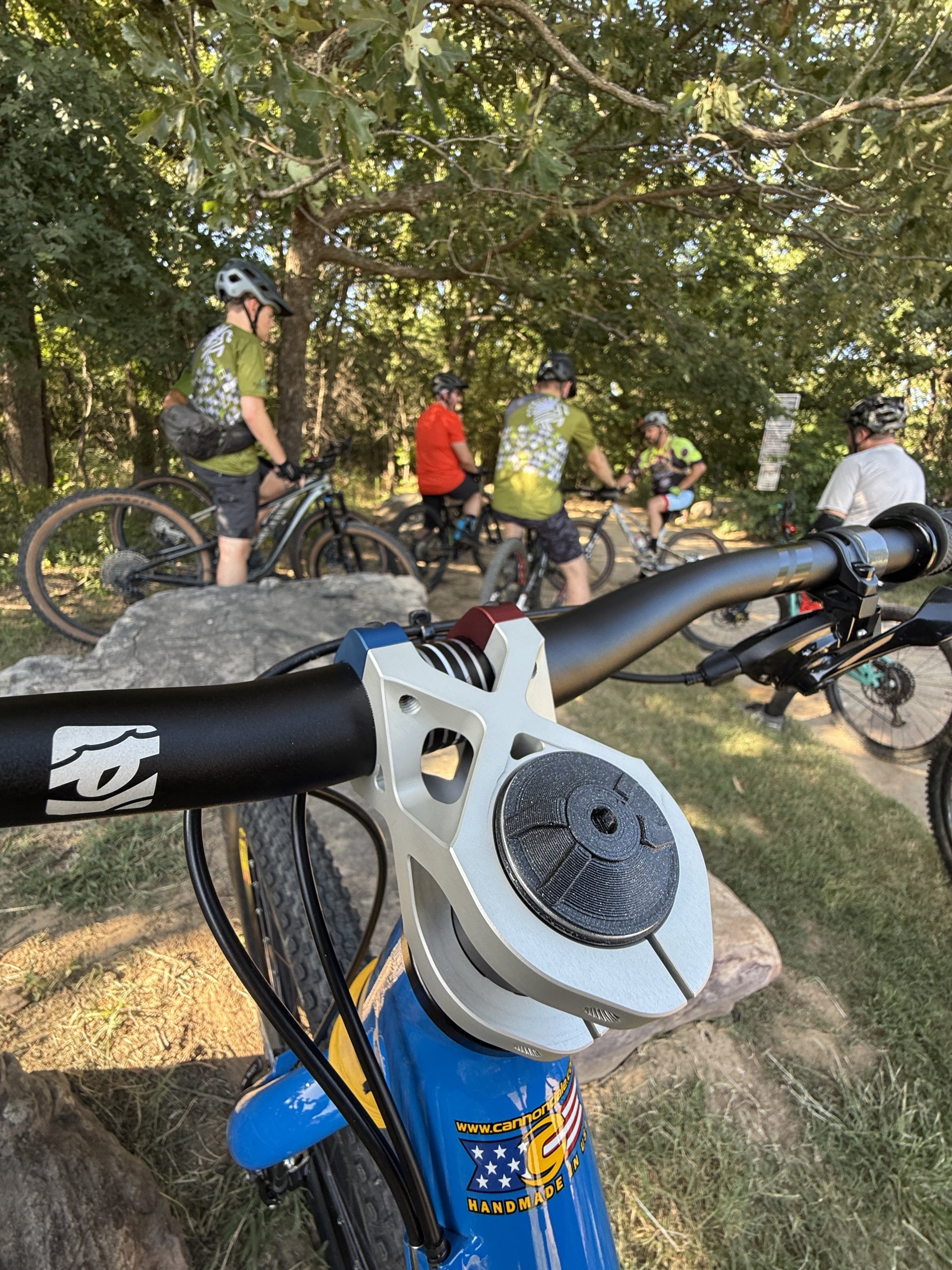

Current configurations under test:
  • HeadShok — 1.56” steerer | 31.8mm bar | 60mm length | 0° rise
  • Standard — 1.125” steerer | 31.8mm bar | 40mm length | 0° rise

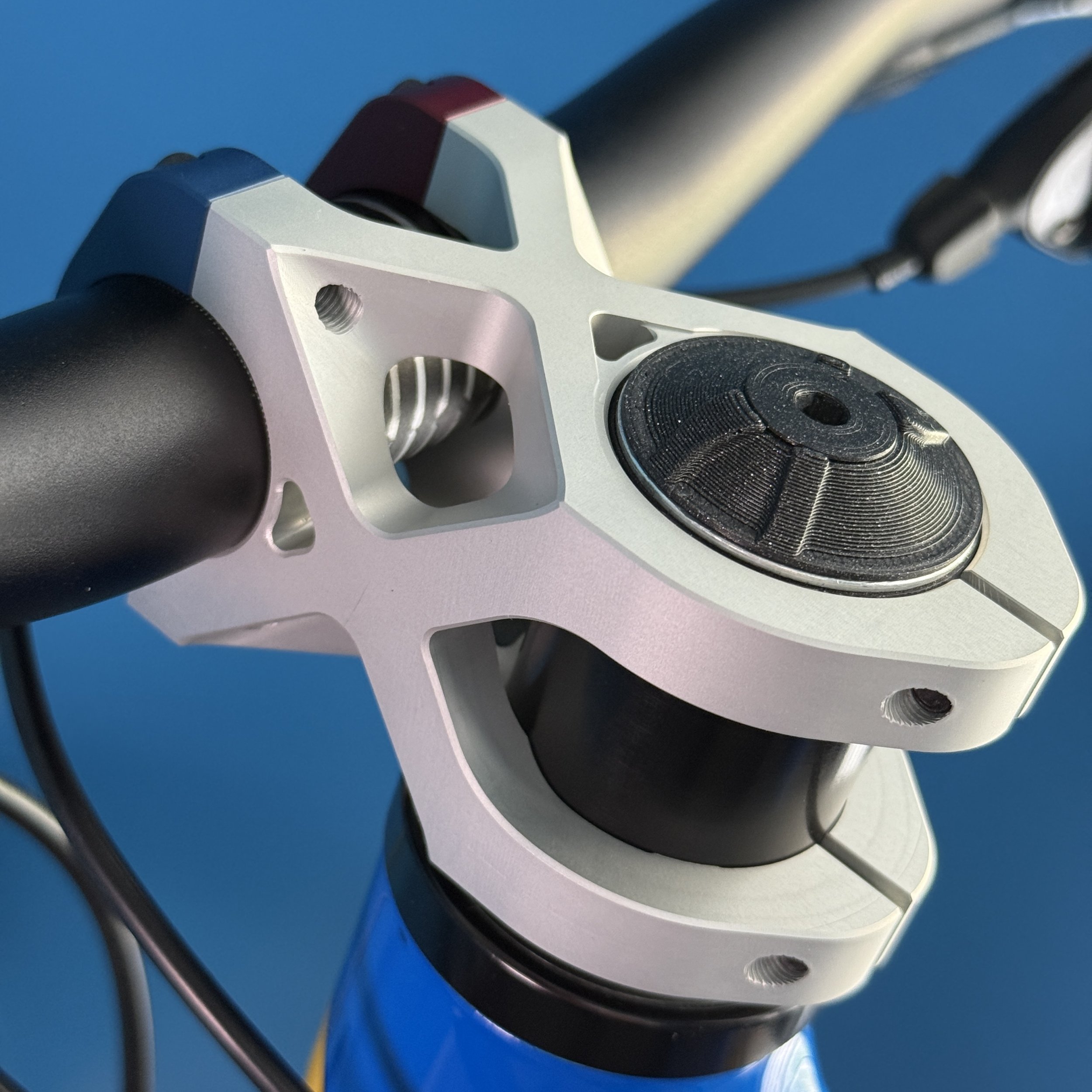

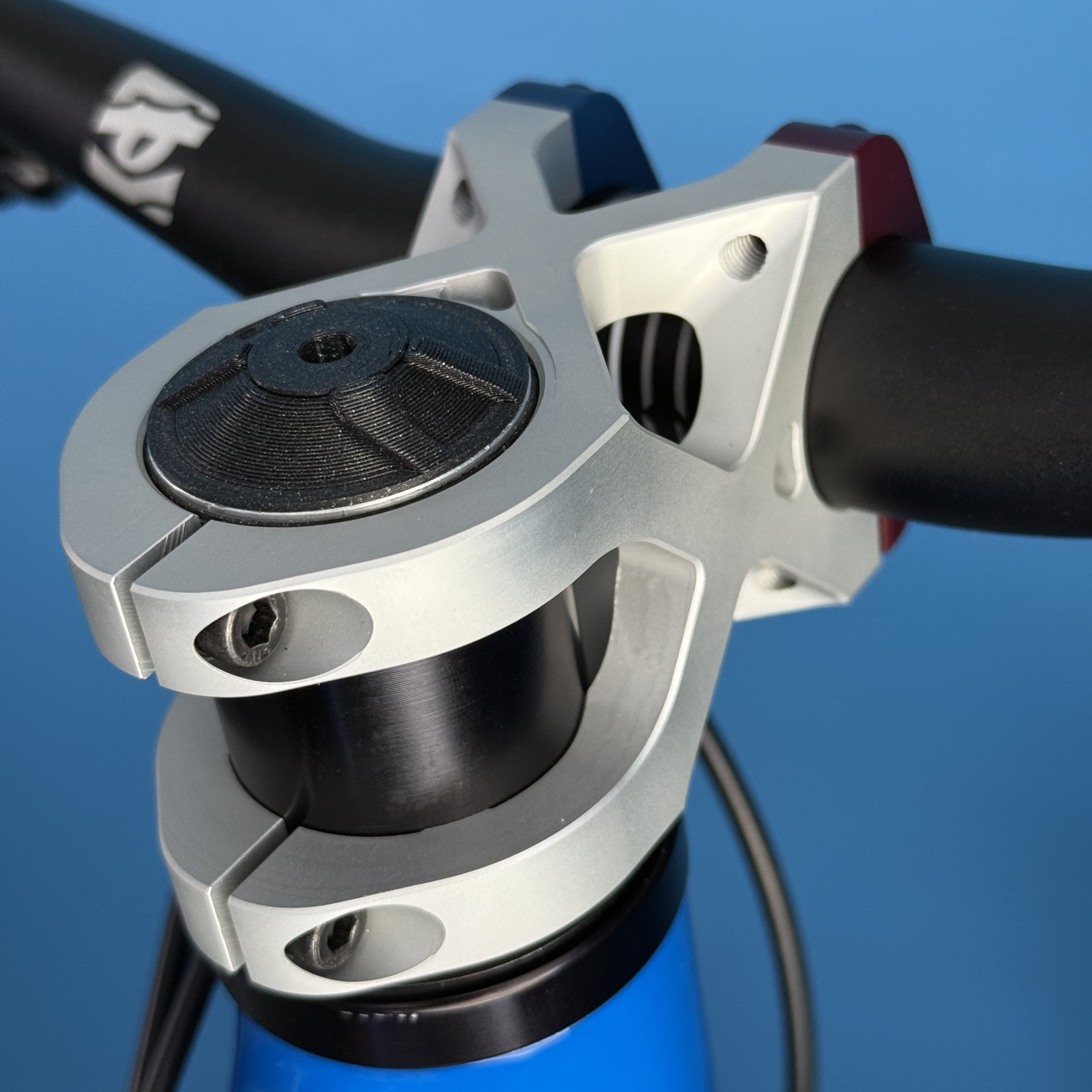

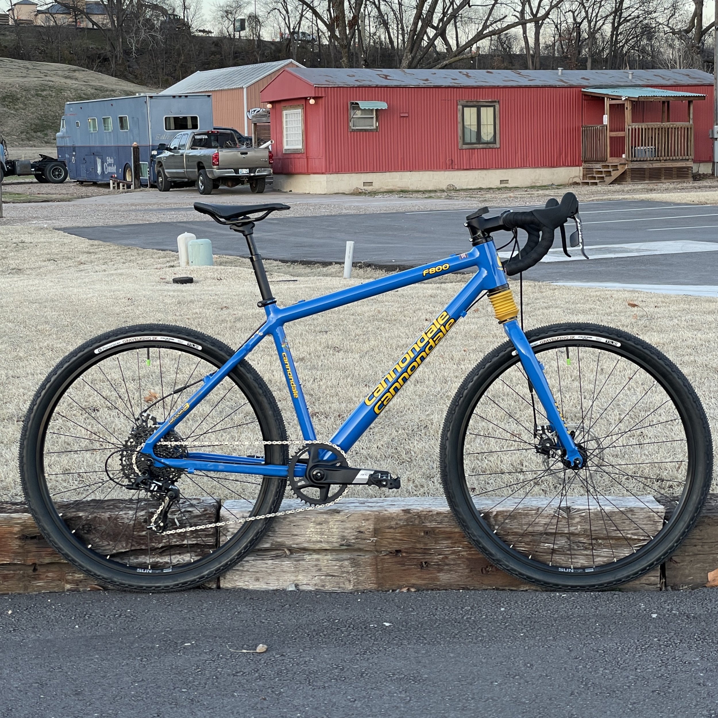

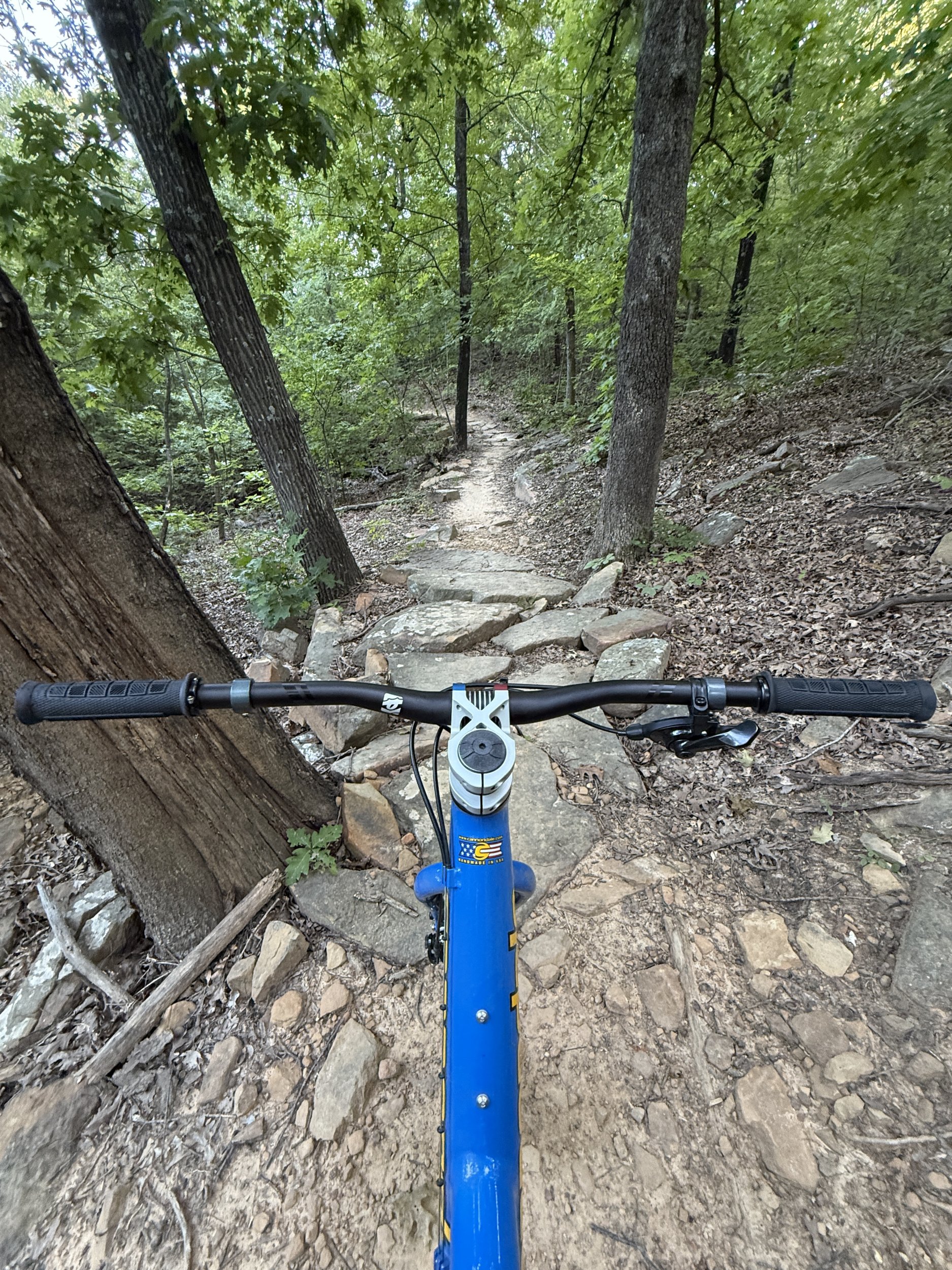

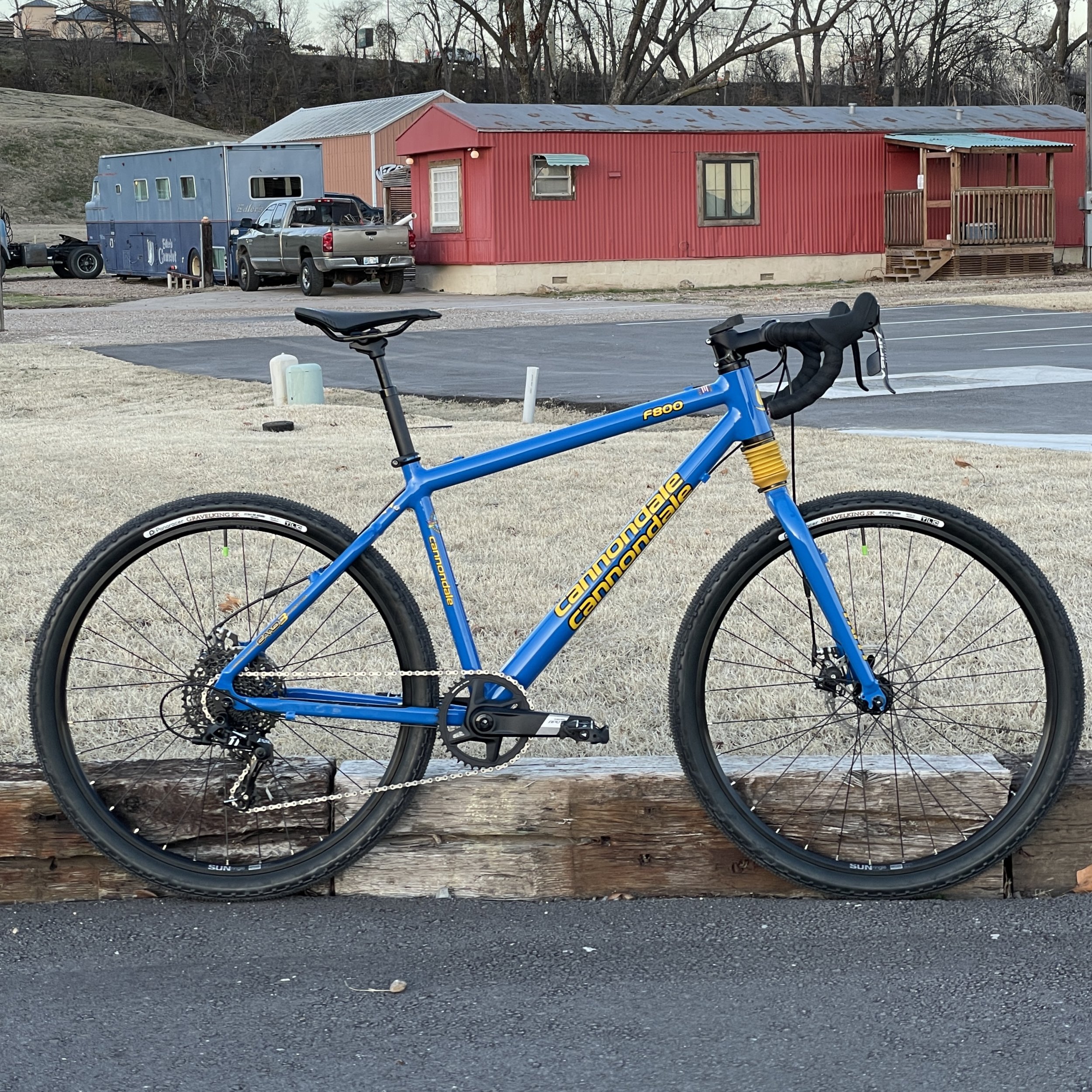

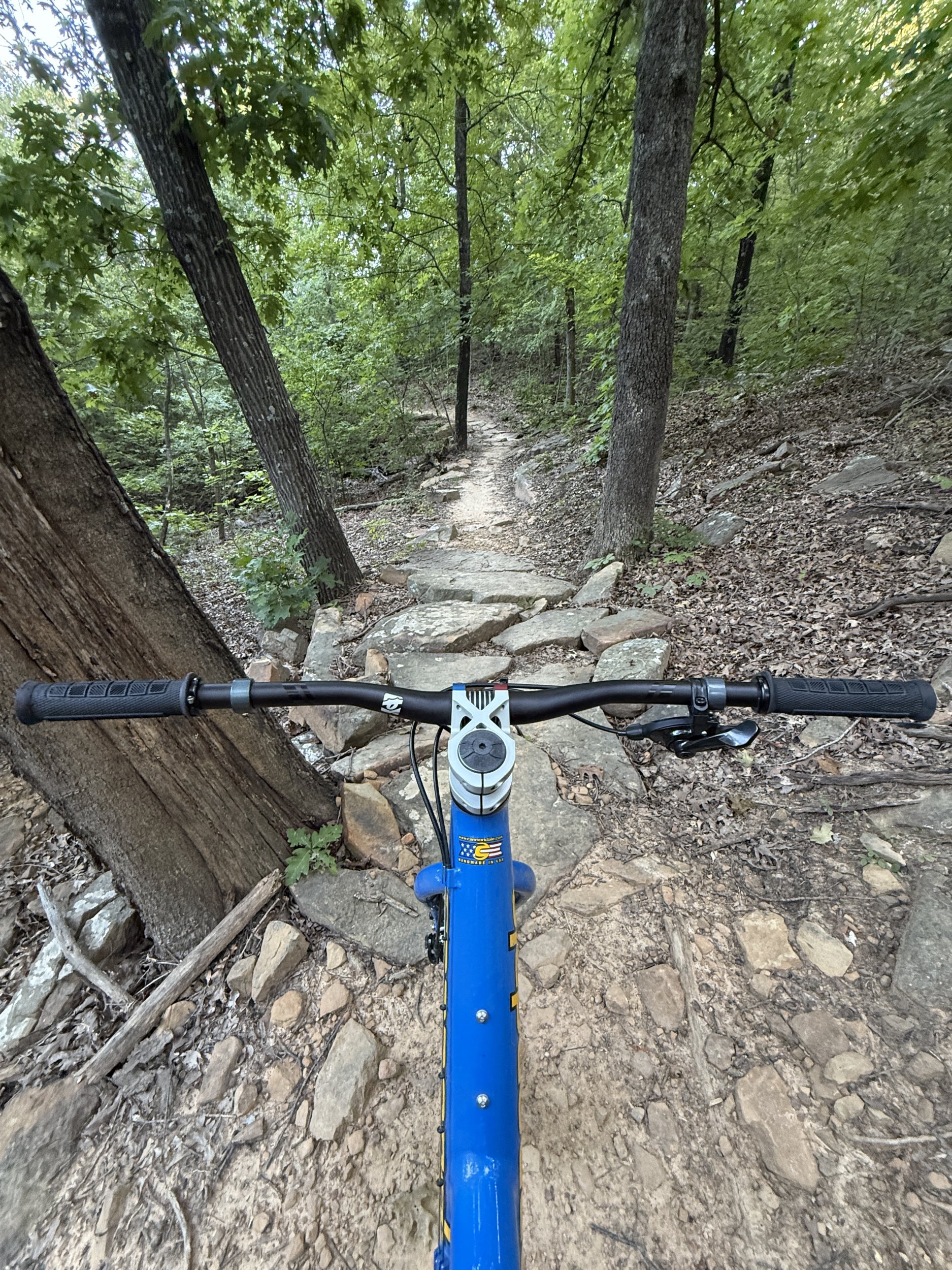

Testing to date includes real-world riding on my own bikes:
  • Super V (MTB use)
  • F700 (road / gravel crossover use)
These rides include rocky singletrack, sustained vibration, and typical trail impacts. So far:
  • No stem slippage observed
  • No visible signs of fatigue or deformation

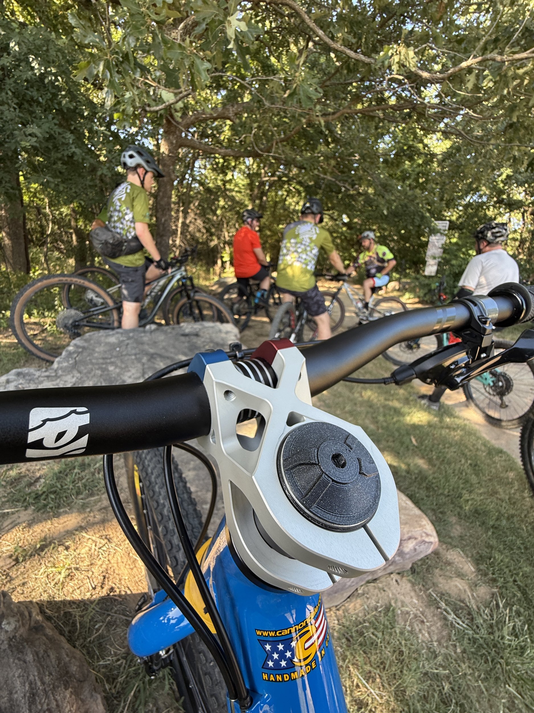

To expand coverage beyond my own setups, a small group of local riders has begun testing the standard steerer version. This helps validate broader usage scenarios while supporting continued development of the Cannondale-specific variants.

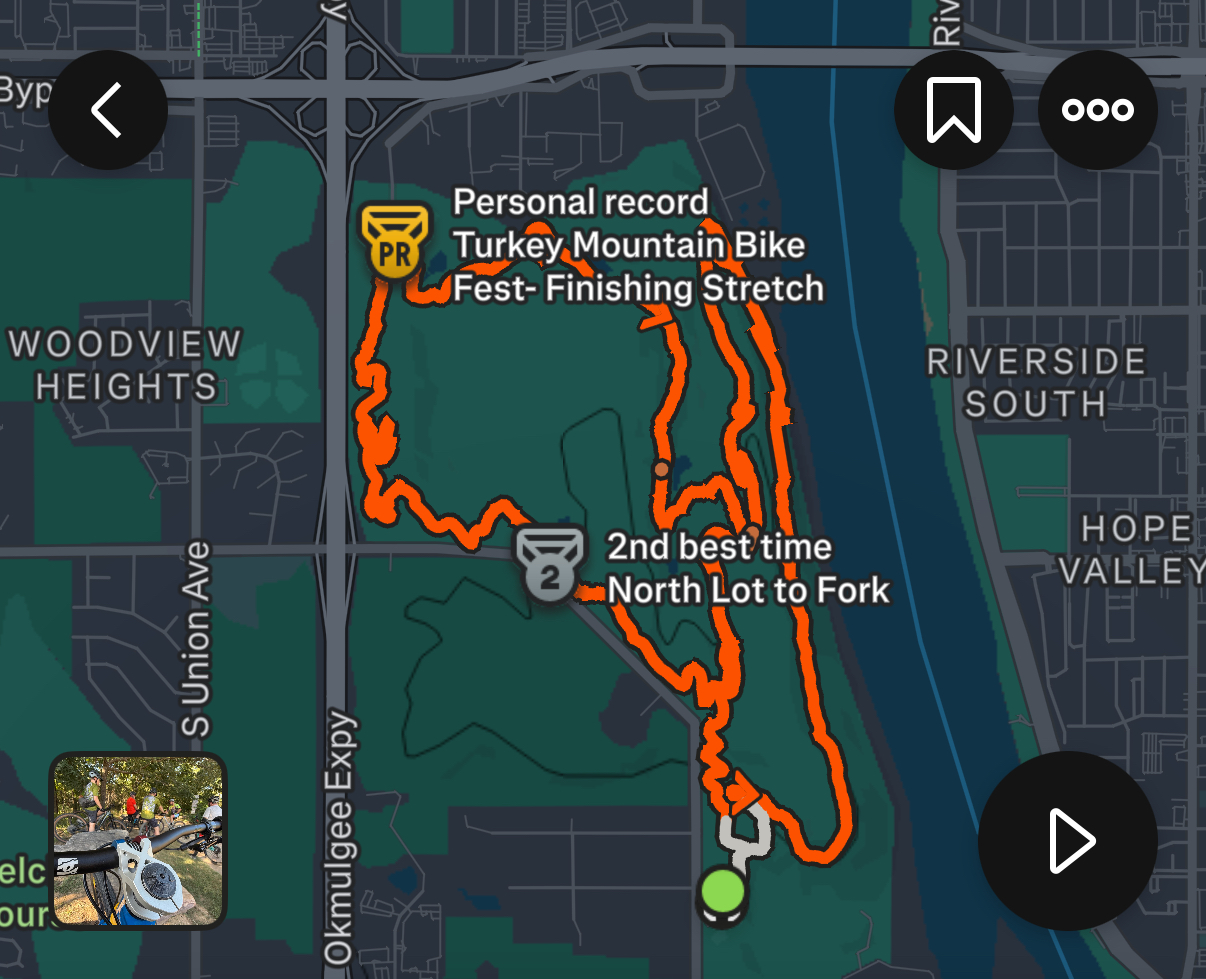

dhzmwCBxFhj427pocVEKyt
Local MTB trails used for testing

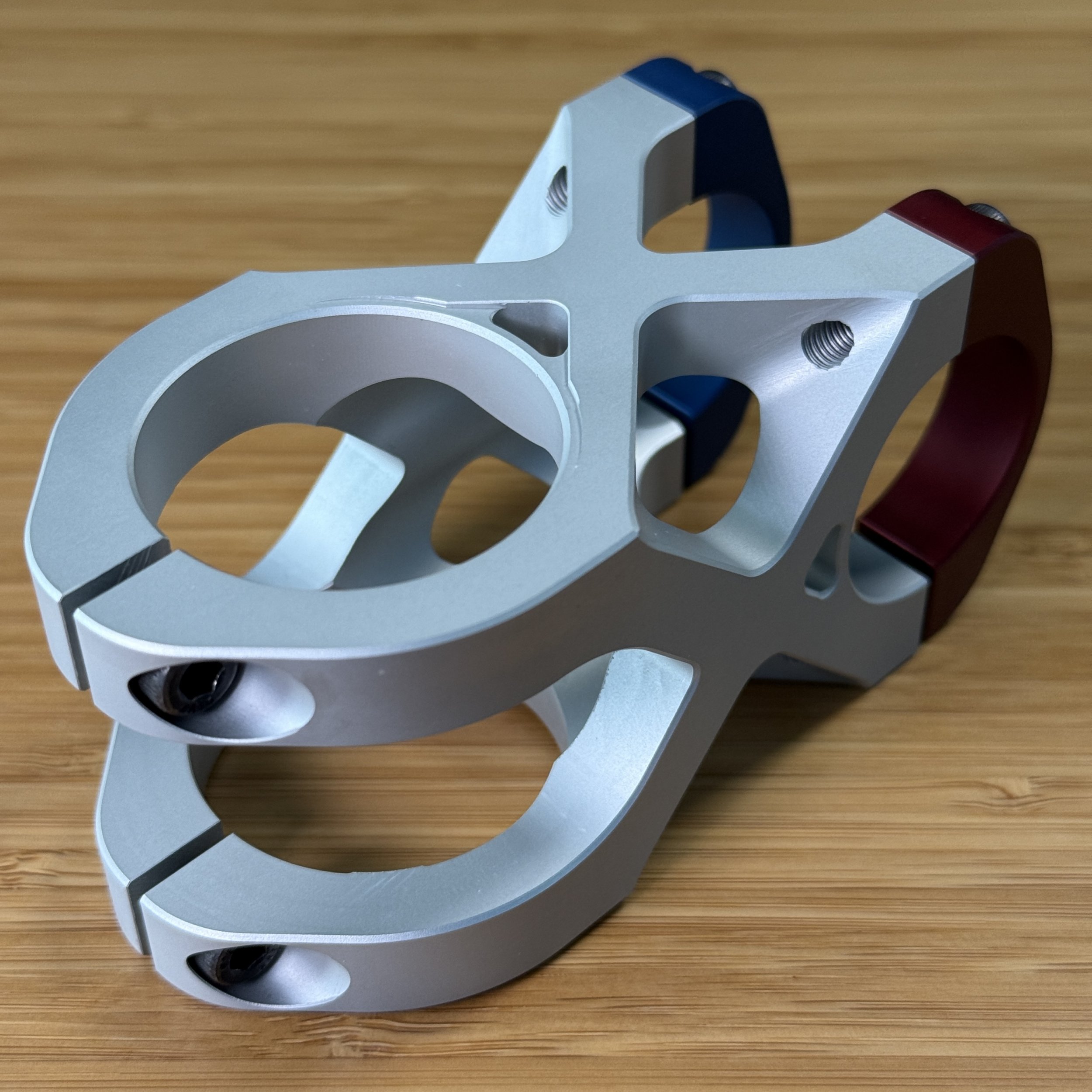

A dummy steerer test fixture has been sourced and is currently in transit. Once received, final samples will be prepared and sent to a certified lab for ISO 4210-5 testing.
This will provide standardized data on strength, fatigue, and safety, and represents the final major validation step before any production decisions are made.

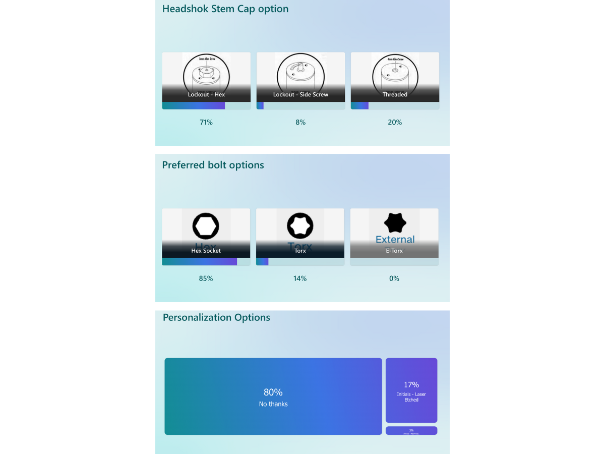

Been deep in XStem development lately, but another small part keeps coming up:
HeadShok lockout knobs / stem caps.
A lot of originals are cracked or missing. Before producing anything, I put together a short 3-minute survey to gauge real demand and preferences (period-correct vs modernized, additive vs CNC, pricing, etc.).
Not a preorder. Just collecting input before moving forward.
If you’ve got a HeadShok fork, I’d appreciate the feedback:
Take Survey Here
I’ll share what comes back once responses are in.
