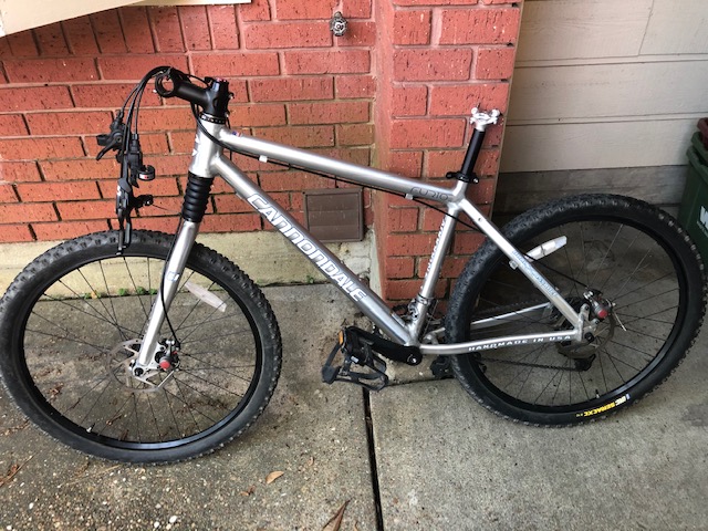

Hello everyone I am a first time poster and have a question that may have been addressed (a lot). I have a Cannondale Furio F600, probably circa 2000. The Headshok continues to loose pressure. Replaced seals numerous time, just hard to maintain. Have decided I would like to replace the front fork with a fixed fork, but local repair shop, and local Cannondale dealer, have told me that you can no longer find the 2" to 1-1/8" reducer adapter that is required. Any suggestions, I really would like to keep riding this bike!
Thanks in advance for any guidance.
Steve

So someone swapped seals a lot, and it never got better?
Curious if your air valve is blue, or silver?
Asking, cause there was a problem with that generation of Headshock, and many had constant leak issues. If the blue one is in place, you have the "fix" already.
Silver? Yeah, you never got the proper resolution to the issue.
Adapters? Go fish, I'm not aware of any simple, plug and play solutions.
Just know that new stem, headset, adapters, and fork that is close to commensurate with the performance and characteristics of the fork you already own, will not be cheap. Figure $500 easily.
That's a whole lot of bread for something a $60 upgrade can resolve.
I think that's a 2006 F600. I don't have any experience with frames that new but this headset sounds like it will work for what you want to do. I wouldn't think that the increased stack of headset would hurt the geometry much, though it might slacken the effective head tube angle a bit. Not sure that's a bad thing, depending on what you find for a fork.
https://www.ebay.com/itm/Cannondale...379202?hash=item54812bb942:g:wbsAAOSwXMZebNQX
The same seller also has a headset to fit a 1.5" tapered fork:
https://www.ebay.com/itm/Cannondale...687568&hash=item4da8df1222:g:uJ0AAOSwLrNebNQa
Thanks Black Lightning and Craig. I've been reluctant to give up on this bike, but I think its time to cave...who doesn't love a new bike anyway?

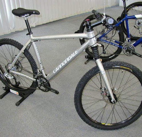

Well now I am a Furio F600 parts dealer apparently. Anybody interested in this ole girl? Or can anyone suggest where I might find some interest? Thanks everyone :).
Easiest is probably to measure the wheelbase: centerline of front hub to centerline of rear hub with someone holding front wheel straight ahead. That said, the size may be stamped in the BB shell.
