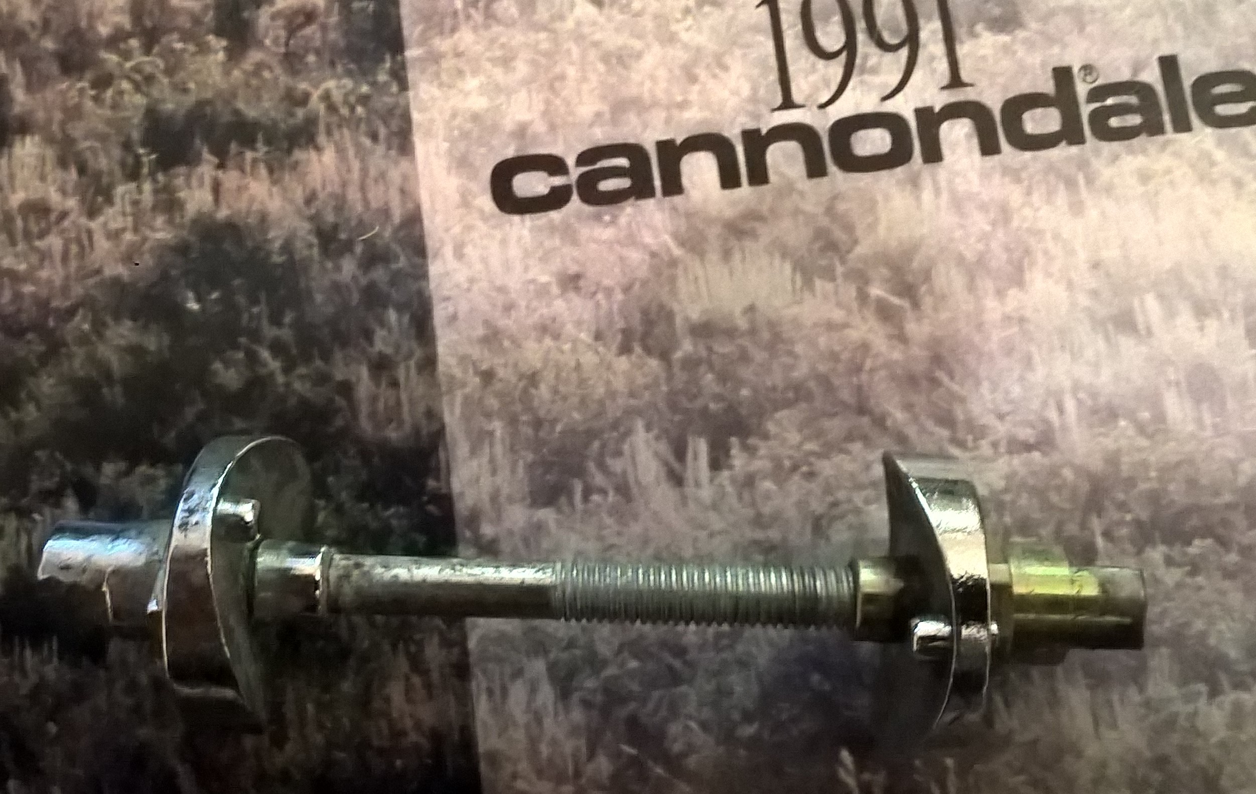

Brian, what about 3D printing? Might be a lot cheaper than the original die cast. I would make both sides the same as the right hand, with both sides having the steel part passing through the spacer that has the radius to fit the down tube. This would eliminate the threaded boss breaking off the pot metal on the left side, and eliminate making the left side altogether. I would put a 12 mm square boss (which the left side has) on the spacer instead of the 4 round bosses that index the shifter plate on the Cannondale part. You can't put a Campagnolo downtube rear shifter on these frames without modification as the 4 round bosses on the right side form a square too large for the Campagnolo lever stop plate. They put the four round bosses on to provide room for using a socket to tighten the steel part. The hexagon area on the steel part isn't even needed as you can tighten it with an adjustable wrench on the two flats. You should also consider making the flat back plates for Shimano shifters, as they are getting hard to find.
I can loan you my broken one if you want to pursue this.

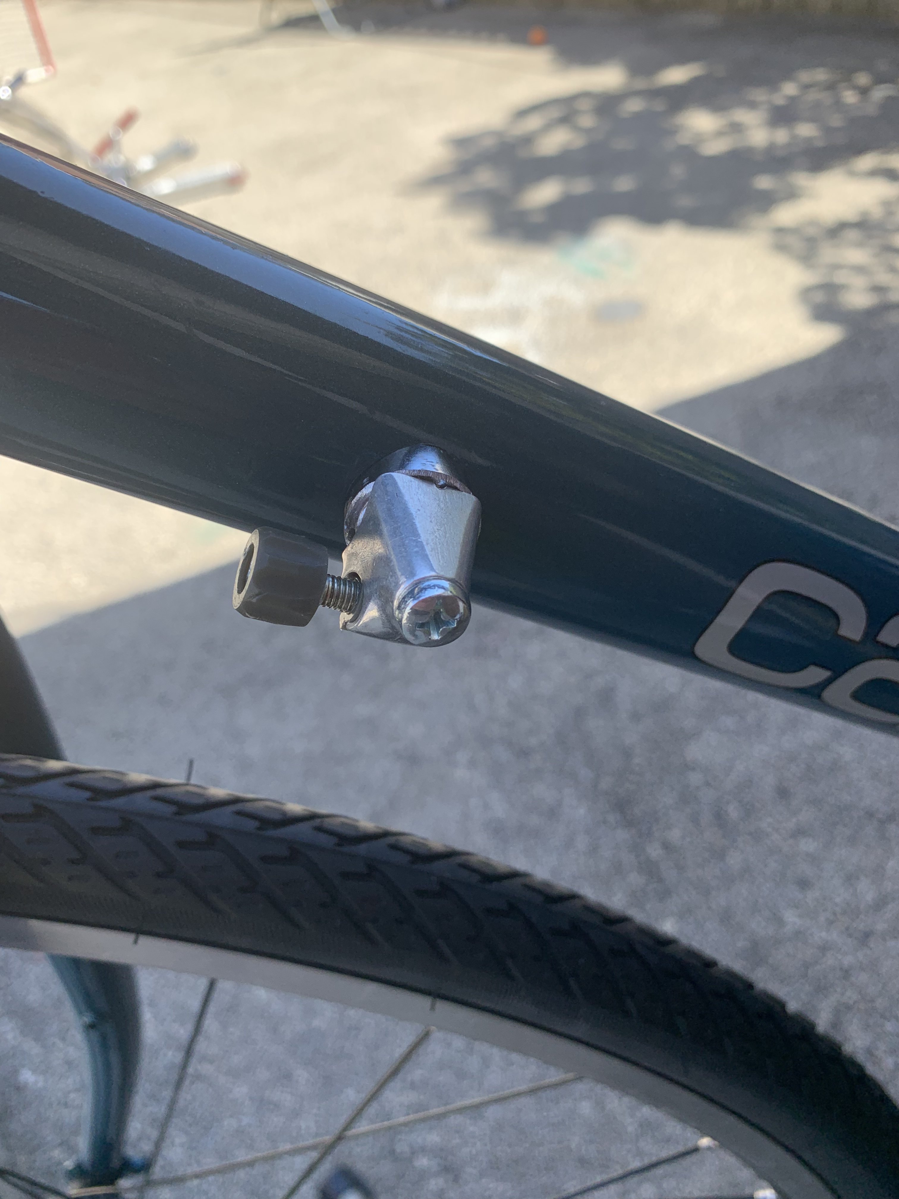

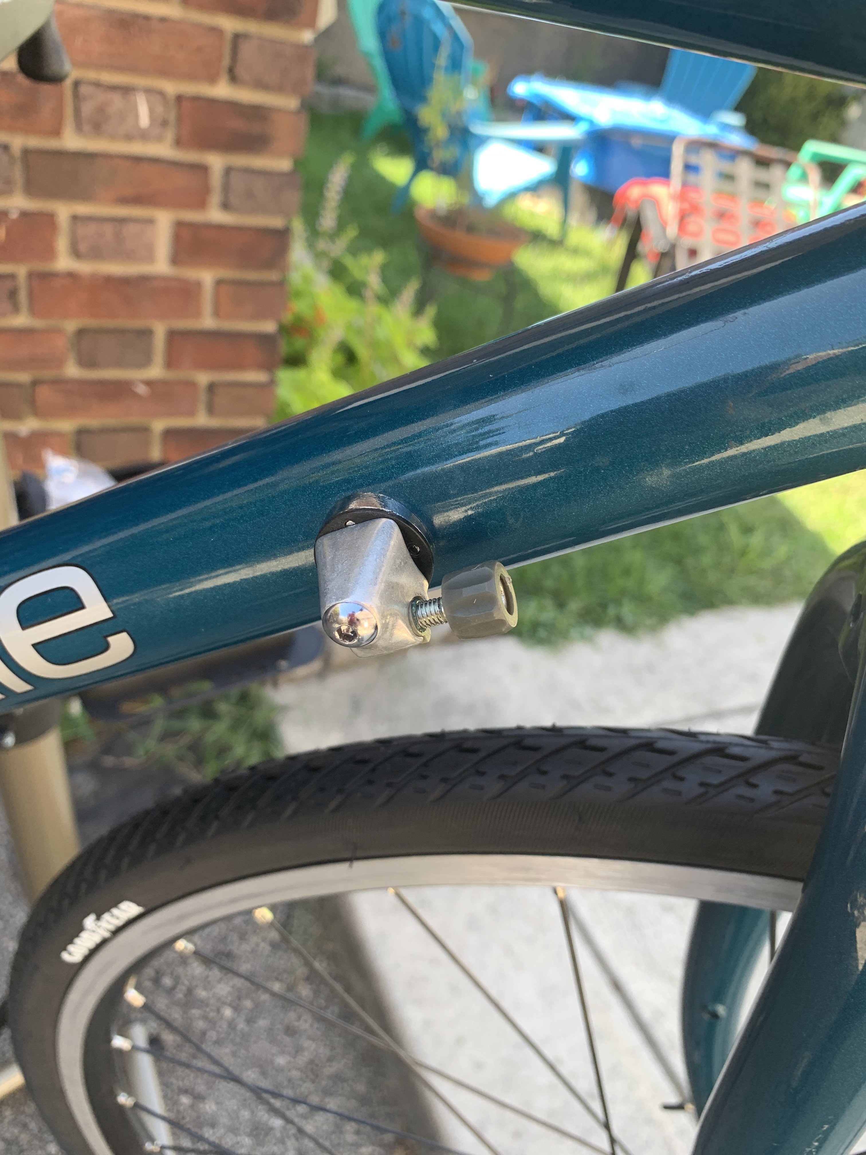

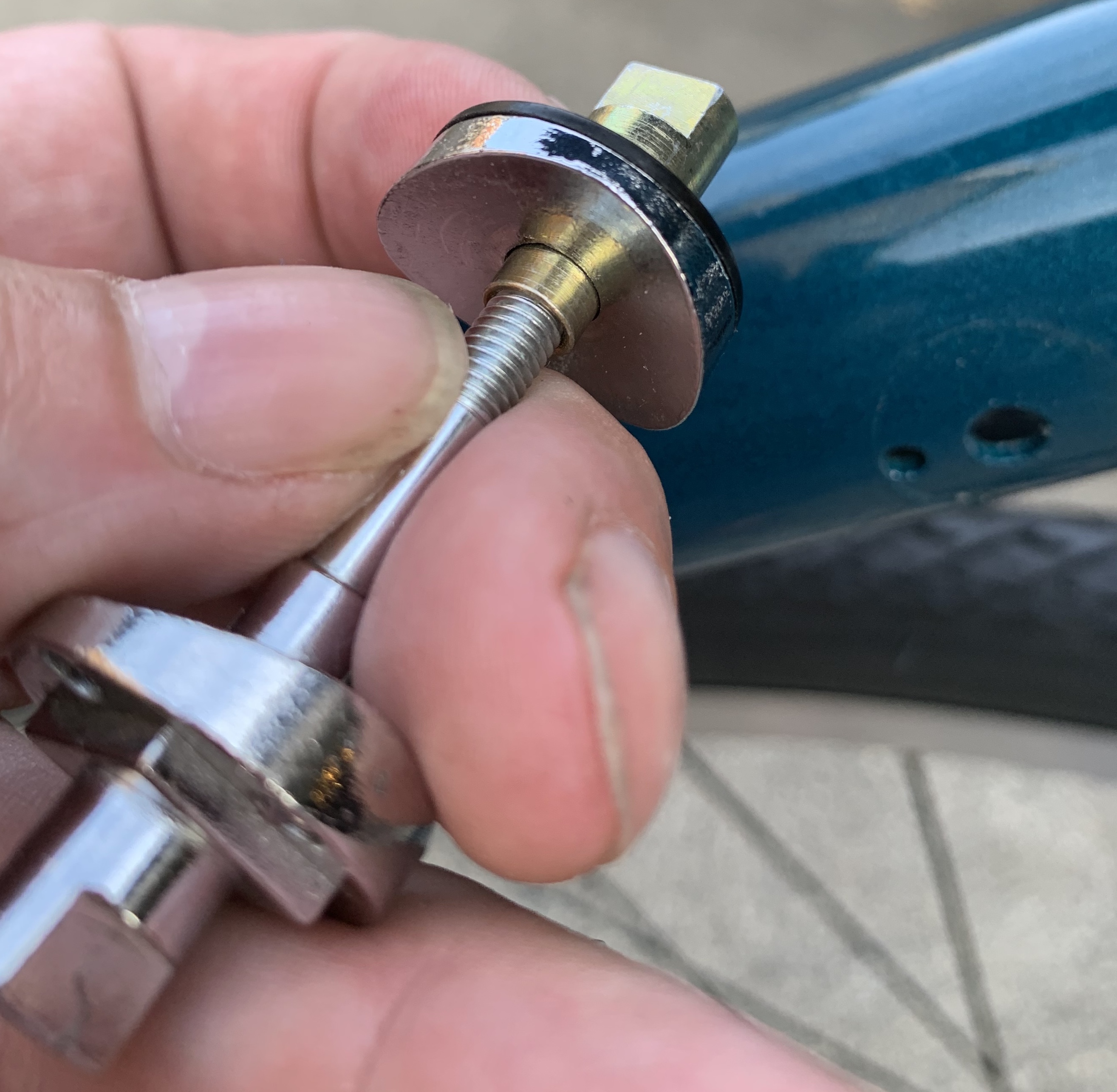

So I have created a work around which, while it may not pass as a “restoration”, both works and doesn’t stand out as a patch job without a second look. The key is that the brass end of the original DT shift boss is still usable.
Parts - all bolts match thread pattern of the
  • Original brass fixture
  • Cable stops
  • Generic curved DT shift boss (bought a pair at Framebuildersupply.com)
  • Shimano SL-7800 shift lever boss cover
  • 2” bolt (length may vary depending on frame diameter)
  • .6” bolt
  • .5” bolt (original)
  • Old tube
  • JD Weld steel formula
  • Thread-lock
Instructions
I neatly cut the head off the bolt leaving a 1.5” threaded post. (Same length as my original post.) I attached the post to the generic shift boss with the JD Weld making sure not to thread it too deeply. Because the curve of the frame and shift boss don’t match exactly, I cut a gasket from the old tube to protect the frame. Thread the post through the frame and attach the brass fixture using JB Weld. Make sure not to over tighten.
Place the shimano cover over the generic boss stop and attach the cable stop using the.6” bolt. Install the cable stop on the brass fitting side with the original .5” bolt. Use thread lock on each.
The shimano cover is slightly thicker than the original covers. I ground the lip off the edge of this with my Dremel although it wasn’t entirely necessary. Removing the lip does help to keep the cable stop from rotating due to the square structure. I will clean this up better before final assembly. Regardless, the longer bolt was necessary due to the increased width.
Finished, this is attached solidly, isn’t rotating, and if the need arises it will be easy enough to drill out the generic shift boss end.

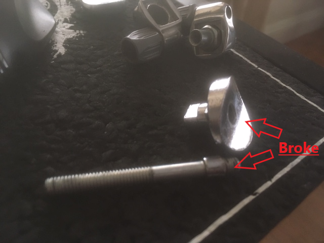

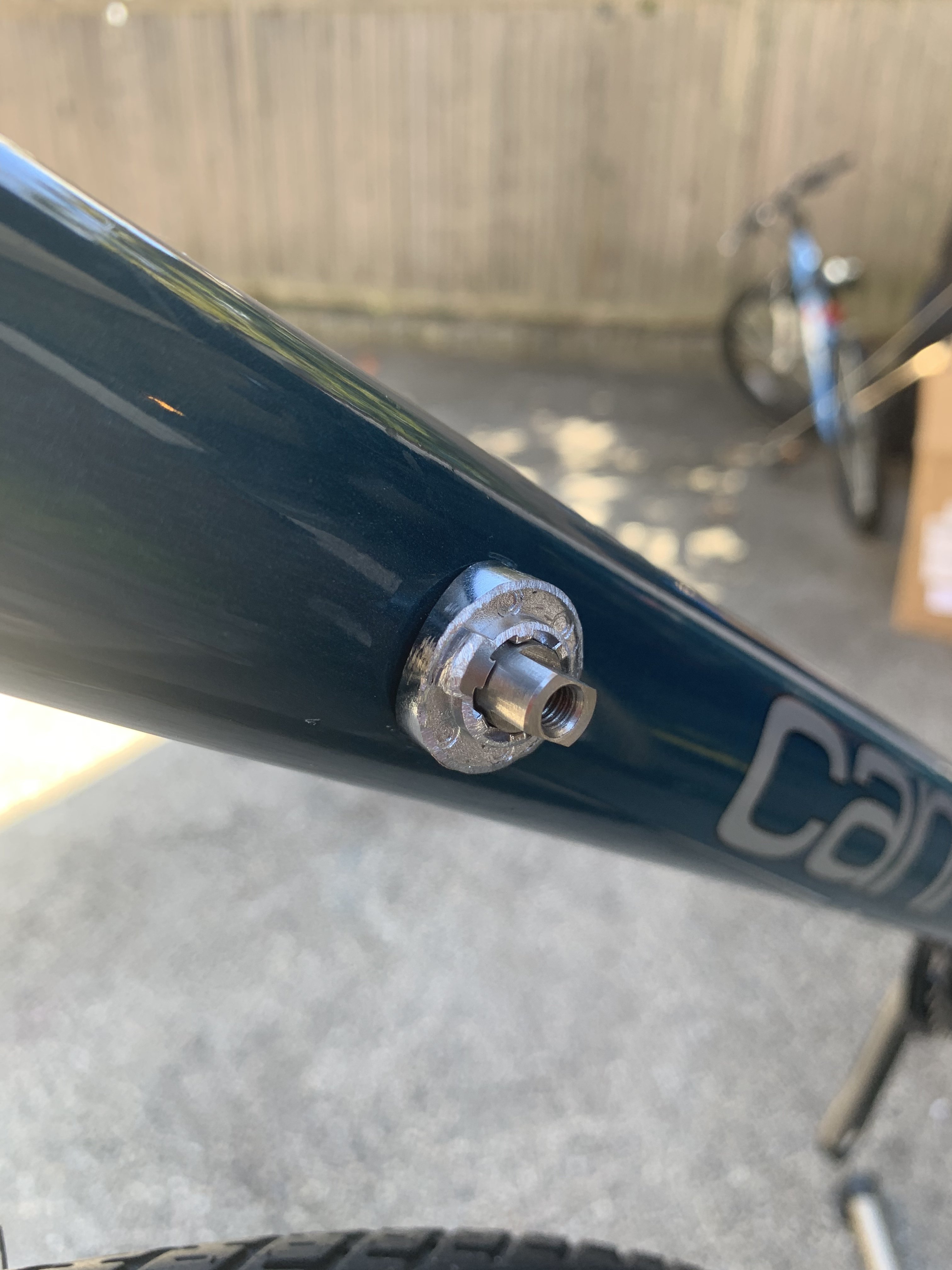

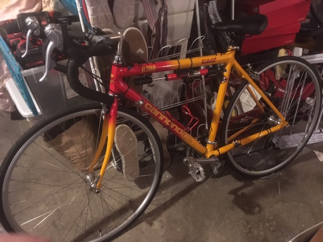

I'm having a very similar issue with my CAD2 R300 after having an accident in August. Mine broke shortly after the accident.
Down tube shift post_cable stop(3).png Down tube shift post_cable stop (assembled).png
Any luck finding a downtube shift post/cable stop? I've been looking everywhere! Anyone have one that they are willing to part with?
ANY help (even pointing me in the right direction would be appreciated!
I would think you could JB Weld the stud back in the boss. I'd saw the broken part off the stud so that it can thread into the boss a bit more. With the epoxy it should hold as long as you are careful not to tighten it to much. If that doesn't work you can order one of these:
https://www.cycle-frames.com/LEVER-BOSS/
People who have used them say that you have to file them a bit to fit the larger than usual down tube of a Cannondale but that they work fine otherwise.
