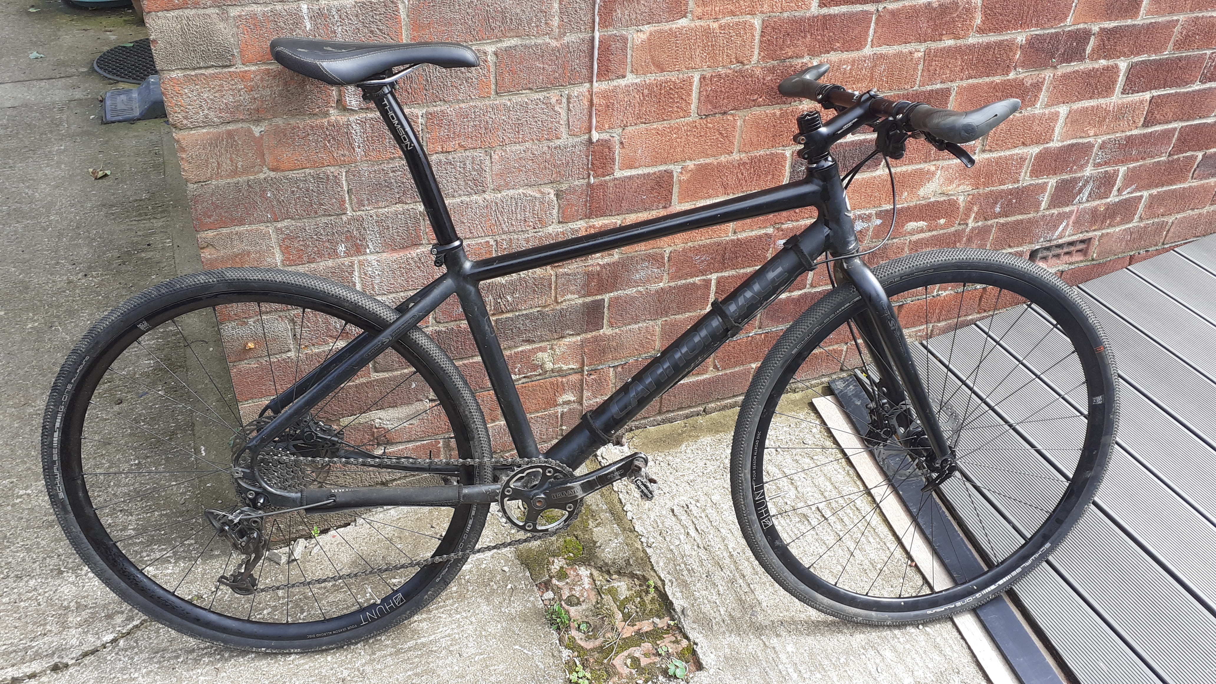

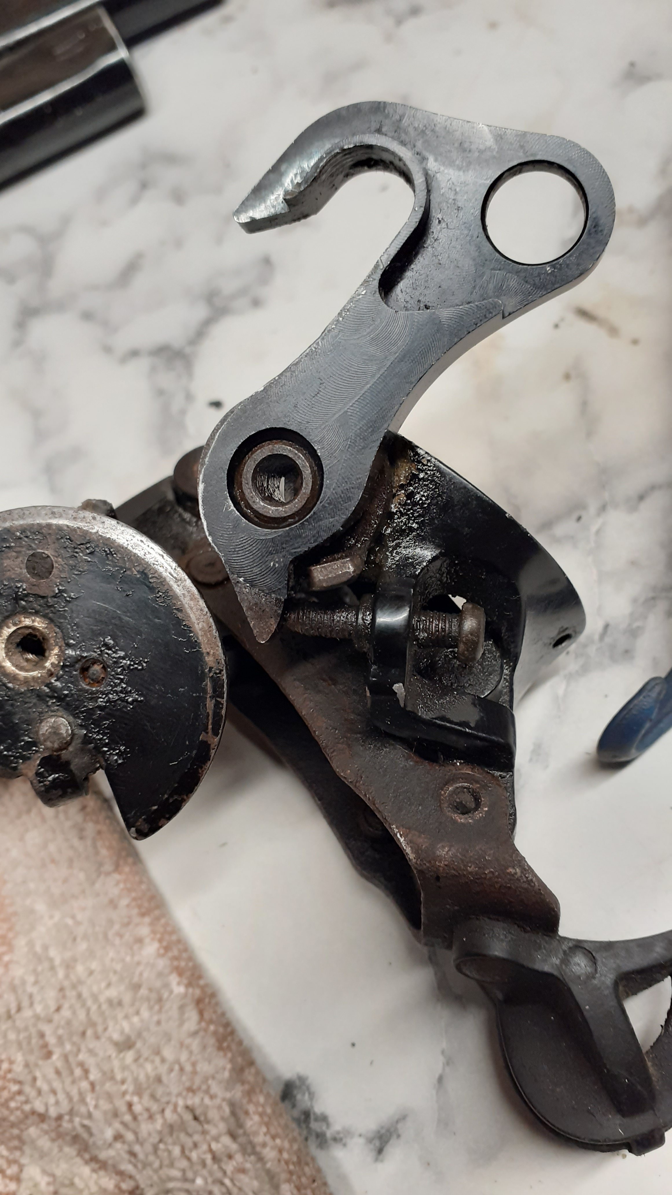

Hi. New to this so forgive me if this is a repeat. Am in UK upgrading my old Bad Boy to a gravel machine. I think it is Circa 2015 and on trying to replace the original SRAM X-9 rear changer the hanger is well and truly stuck to it. So I need a replacement, but I can't see the same shape hanger online anywhere.
Will post pics of bike, hanger etc and if anyone can point me in the right direction of a model ID and something to look for online that would be great.

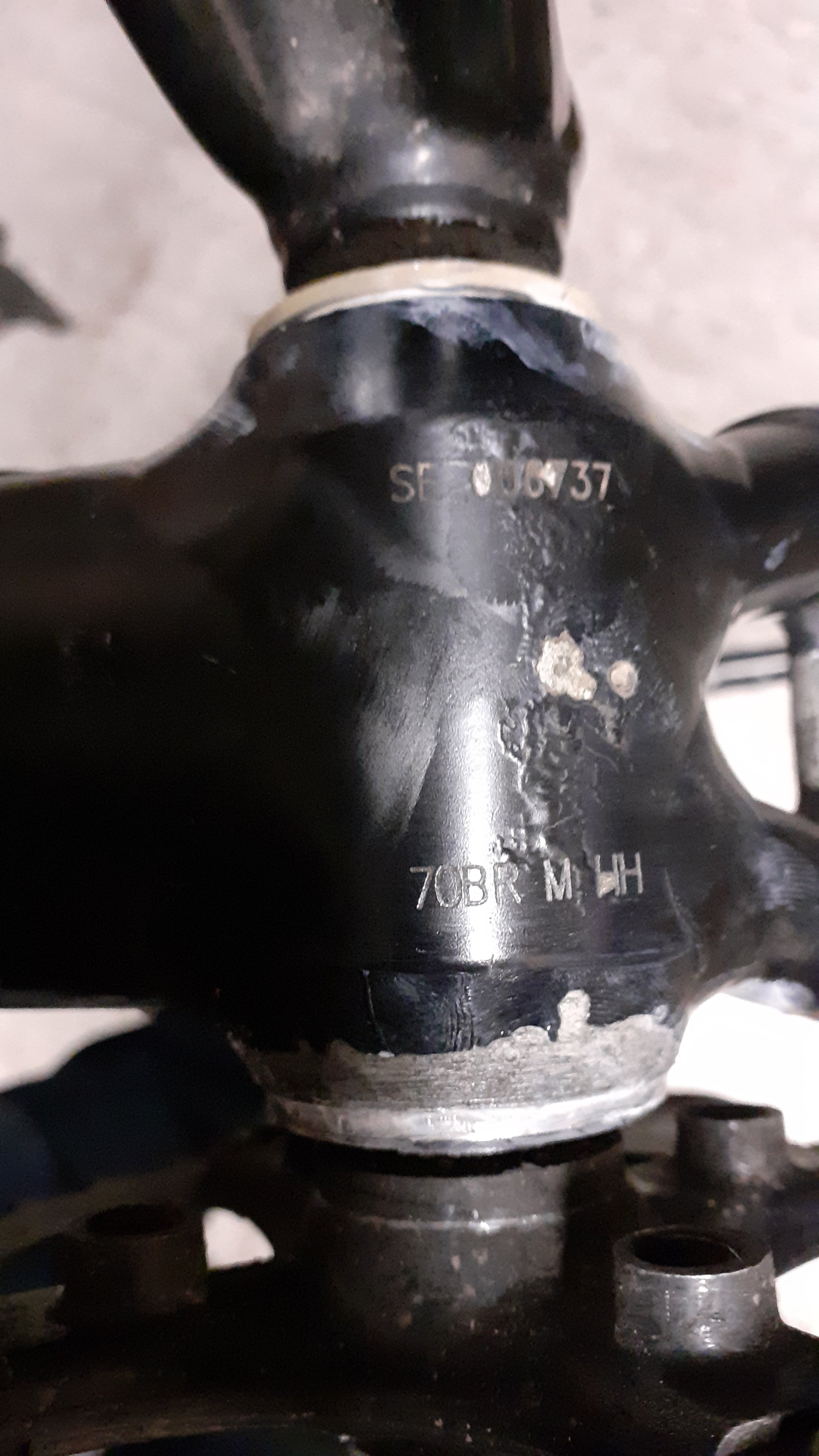

Two numbers under B/B are what looks like SE 006737 and (definitely) 70BR M HH.

Have you looked at Wheels Manufacturing's website? They have pretty much most Cannondale derailluer hangers available. Also look on Cannondale's website for the bike's owners manual. That's where I found the Cannondale part # for my 2004's derailleur hanger which allowed me to cross reference it and discover that it's the exact same part # and hanger that is on my 92 M700.. talk about blind luck.
FYI , from a quick glance I am thinking it is a model 6 from Wheel's manufacturing, but again that is a quick guess based on your pictures alone.
I haven't been able to find any SRAM equipped Bad Boys in the catalogs so far. Just trying to place the year by the components. Have you checked with a dealer? I would think they could ID a bike that's that recent.
I would put a little heat to that hanger with a propane torch. Can't imagine that it's so tight that it couldn't be loosened up.
Managed to retrieve the hanger with the aid of a vice and a hacksaw. The derailleur was knackered anyway. Thanks for the links though. All good for future reference.
