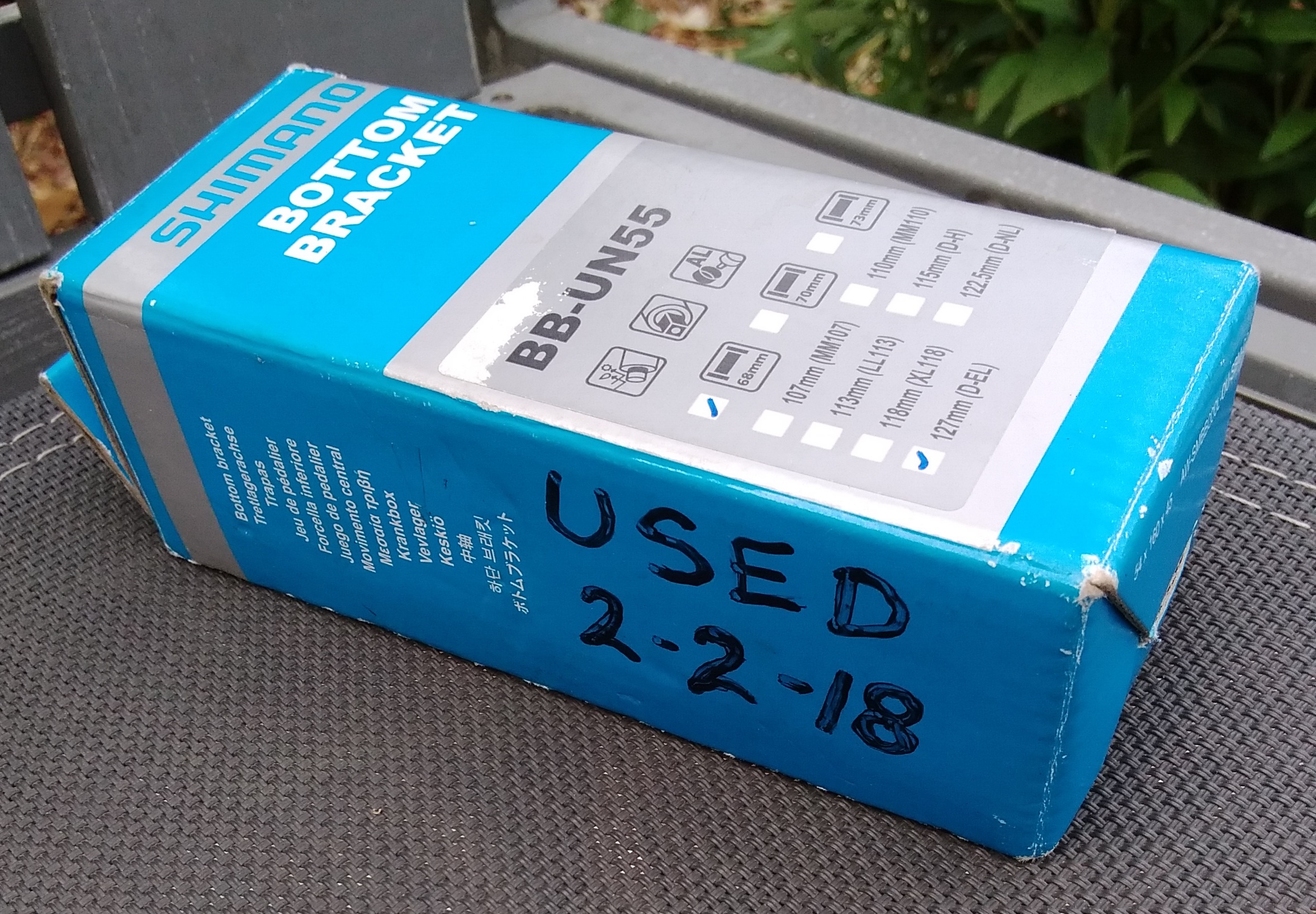

I've worn out plenty of bottom brackets over the years, mostly due to riding in wet and salty conditions, so a few years back when I felt and heard a drivetrain creak I had the BB pegged for sure, and of course it was the first part I replaced. A few months of sleuthing the still present condition found the cassette body to be the real culprit.
I'm still holding onto the original BB, just in case.;)
