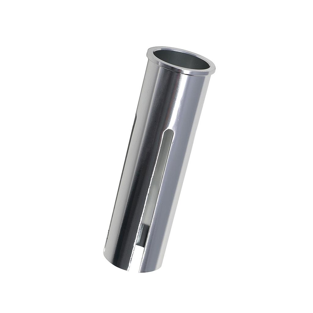

Thanks. I presume these stems were specially made by Control Tech, for Cannondale. Talking about a shim, I was thinking the other way around. There are shims to fit a 1” strem in a 1 1/8” steerer tube, like this one from Soma.
As the Sub-1 fork is so skinny, I feel that an A-headset, stem will look a bit to big.

My 1992 R1000 is 1". I was thinking your stem might work for SirRidealot with a quill adapter.
The Control Tech stem you listed is for a 1 1/8" fork, the quill OD is 1". I've never heard of anyone using a shim with a quill stem but it might be possible.
doxilia
Right you are BL87!
I can understand stating OD’s for quill to ahead adapters but stating a quill stem is 1-1/8” seems like a bad way to spec diameter when in fact it’s 1”. After all it’s not the outer thread diameter of the steerer that’s of interest as with ahead but the insertion diameter.
It would make more sense for these quill stems to be spec’d with 22.2 (7/8”), 25.4 (1”) & 28.6 (1-1/8”) insertion diameters.
If the OP is interested in keeping the front end as original as possible, these quill stems may still be the best option using the shim he posted earlier in the thread. And a good amount of torque on the quill bolt I’d imagine. Maybe even carbon assembly paste between shim and steerer. Any slippage would of course be rather undesirable but the design of the shim seems to take this into account.
Actually, on opening the link to the shim, that particular one appears to be the wrong size. It would have to be 28.6->25.4 for these CT quill stems to work.

The Nitto adapter plus a standard 1-1/8” stem would probably be easier to manage spec wise and allow any drop bar you like to be used.
But…, it does brake with the traditional classic look.
