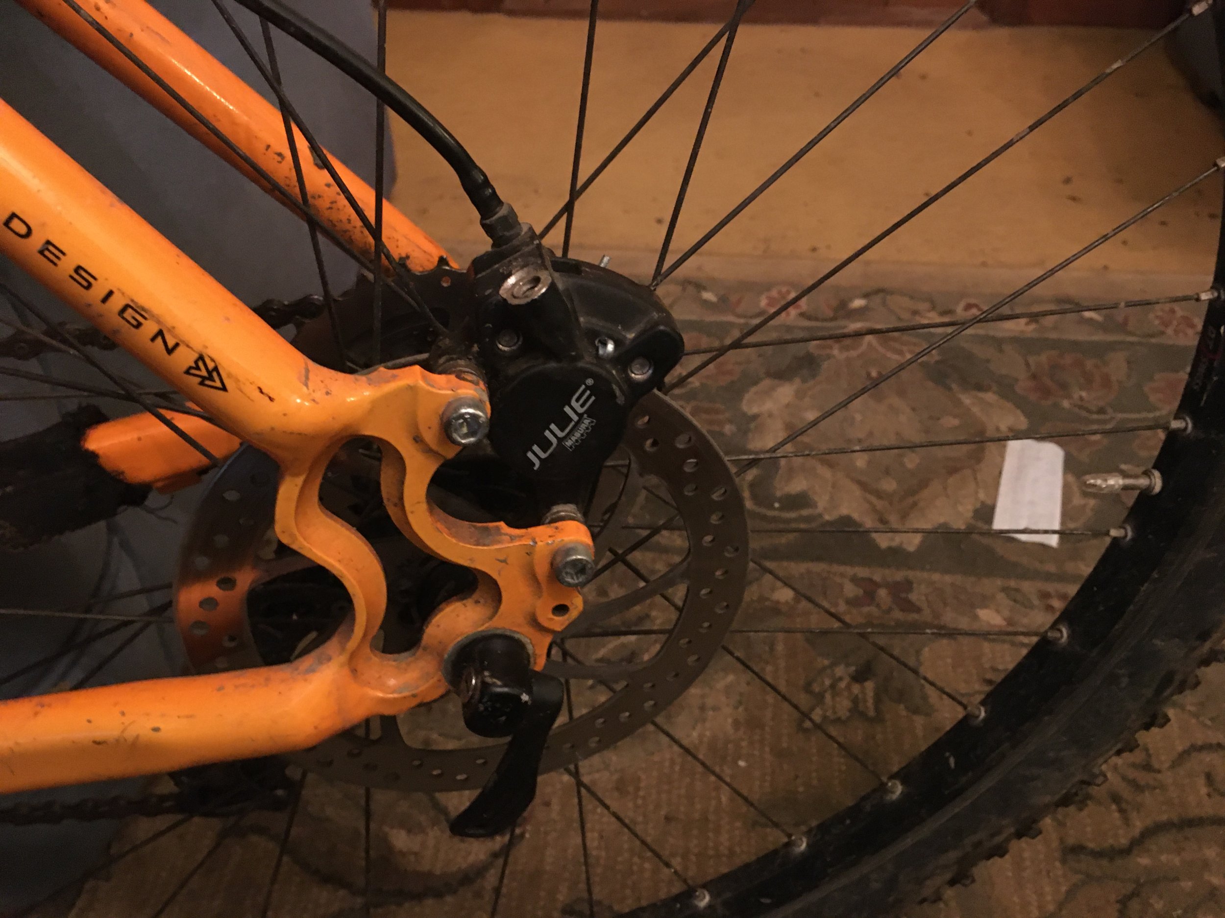

Hi , I’m new on here and needed a bit of help I wanted to fit 180mm disc on back to match front
It looks like you have a 2002 model. If your bicycle was equipped with a smaller rotor on the rear wheel I would leave it that size. It is common for the front rotor to be larger due to the fact that it does more work because of weight transfer during braking. Thus more heat is generated, and a bigger rotor has more mass to absorb, and dissipate, that heat. It just isn't necessary, or helpful, to have a larger rotor on the rear. The brake pads have the same surface area front and rear. You won't be getting any better performance.

I just put new pads ( resin ) the rear and I’m getting a high pitch squealing sound untill I touch the brake . I’m waiting on new shimano 180 front deore sm rt56 untill I fit the pads . I might just do the rear disc 160mm , the old disc had lots of brake dust in the disc holes
