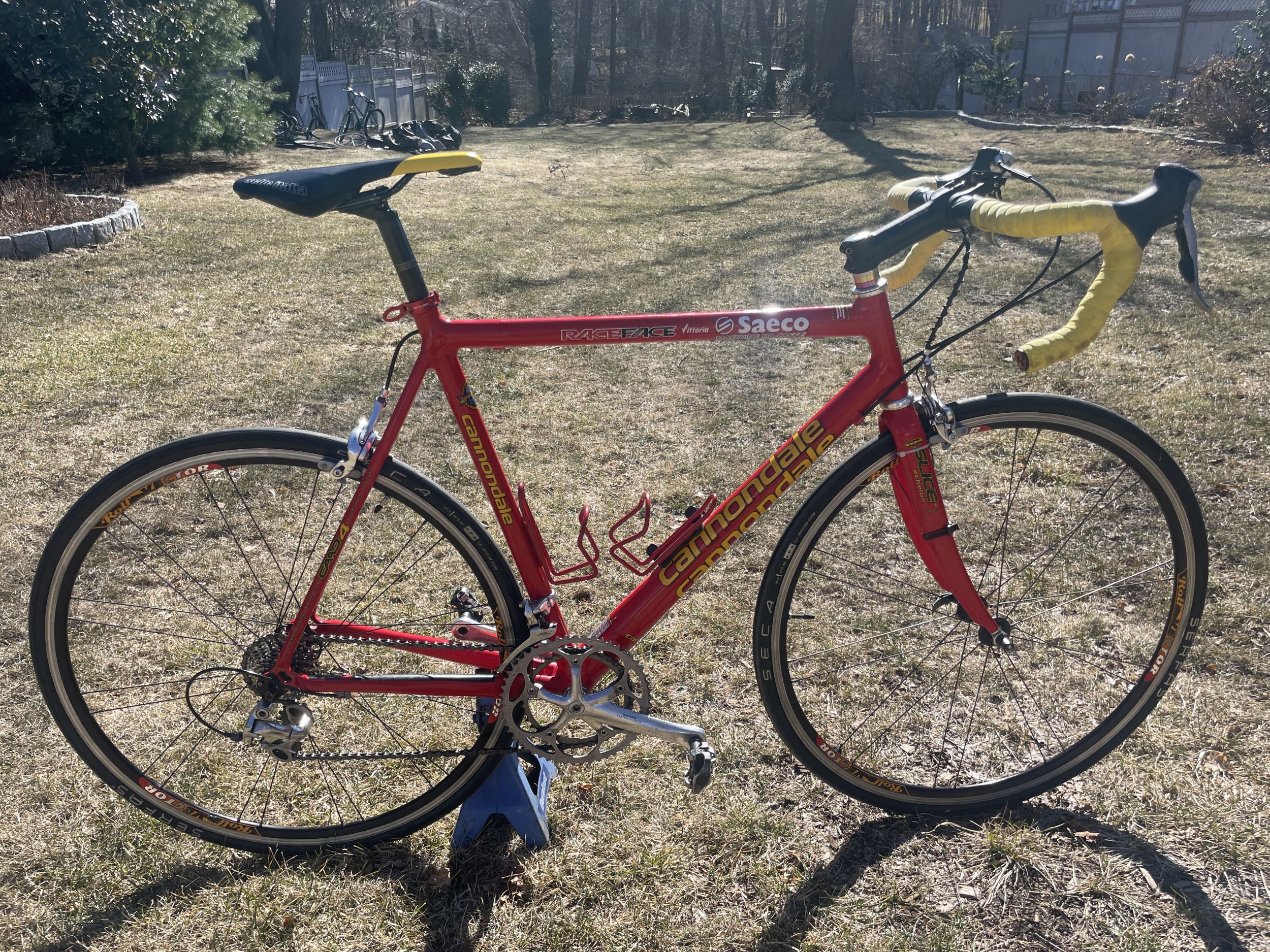

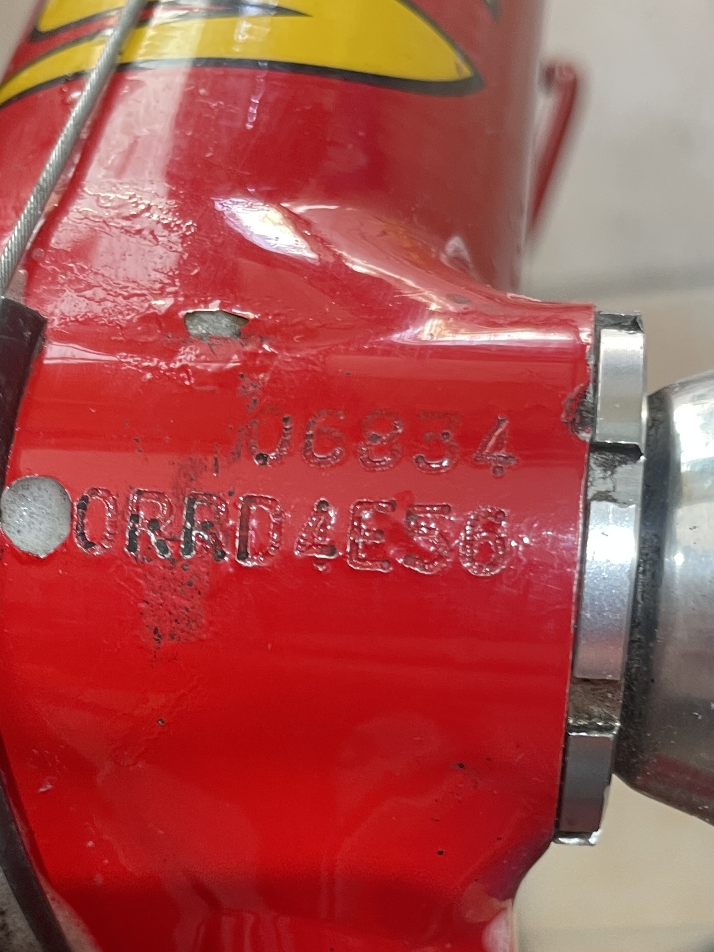

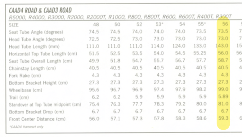

I am selling this bike. I had it listed as a 58cm frame, though that was nowhere listed on the bike (or so I thought). Had a very particular customer come look at it. He had a feeling its geometry was not consistent with other 58cm frames. So I went into the 2000 year catalog here, per the suggestion of a rep at the Cannondale 800 number. I found which bike had the same chainstay, top tube and other dimensions, and it matched a 56cm (with an effective seat tube length of 58.7cm). The serial number isn't really that consistent with the guide elsewhere on the site. But I do notice that the last two digits of the number are 56, which should be the frame size. Wondering if anyone knows how to interpret the serial number and/or can confirm I have now correctly identified this as a 56cm.

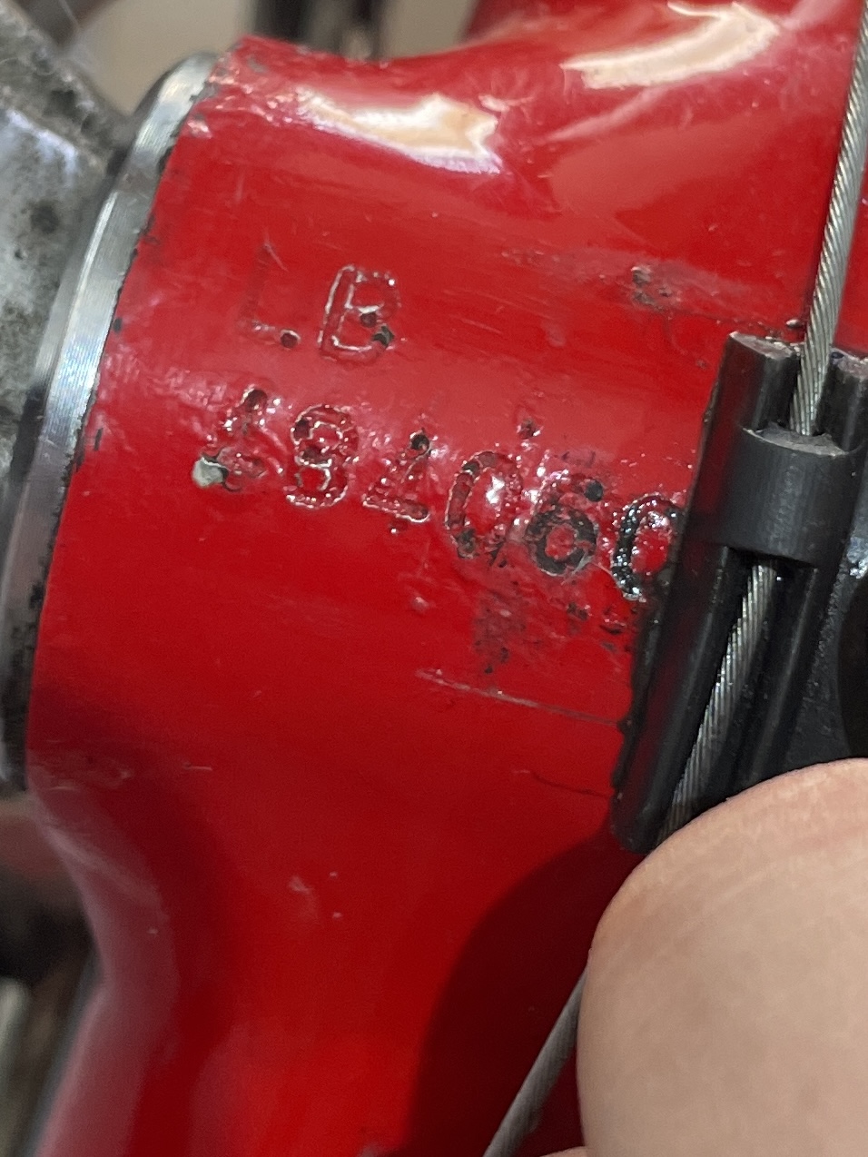

The “LB“ on your BB is in a different spot than indicated for year on the serial number page. But it matches: L=2000, B=February.
I’m not an expert decoder but I’m 99% sure you’re correct on the 56 on the BB being 56cm.

I will add that Cannondale measures their frames slightly different than some other companies. At 6 feet tall I ride and fit a 56 cm. Cannondale frame better than a 58, although both sizes will work for me. But a Trek or Specialized bike has to be a 58 which fits very similar to Cannondale's 56. They say 56 is for rider 5:10-6:01. For reference 2005 C-Dale R 5000 in 56 and a 2022 Trek Emonda in a 58.
