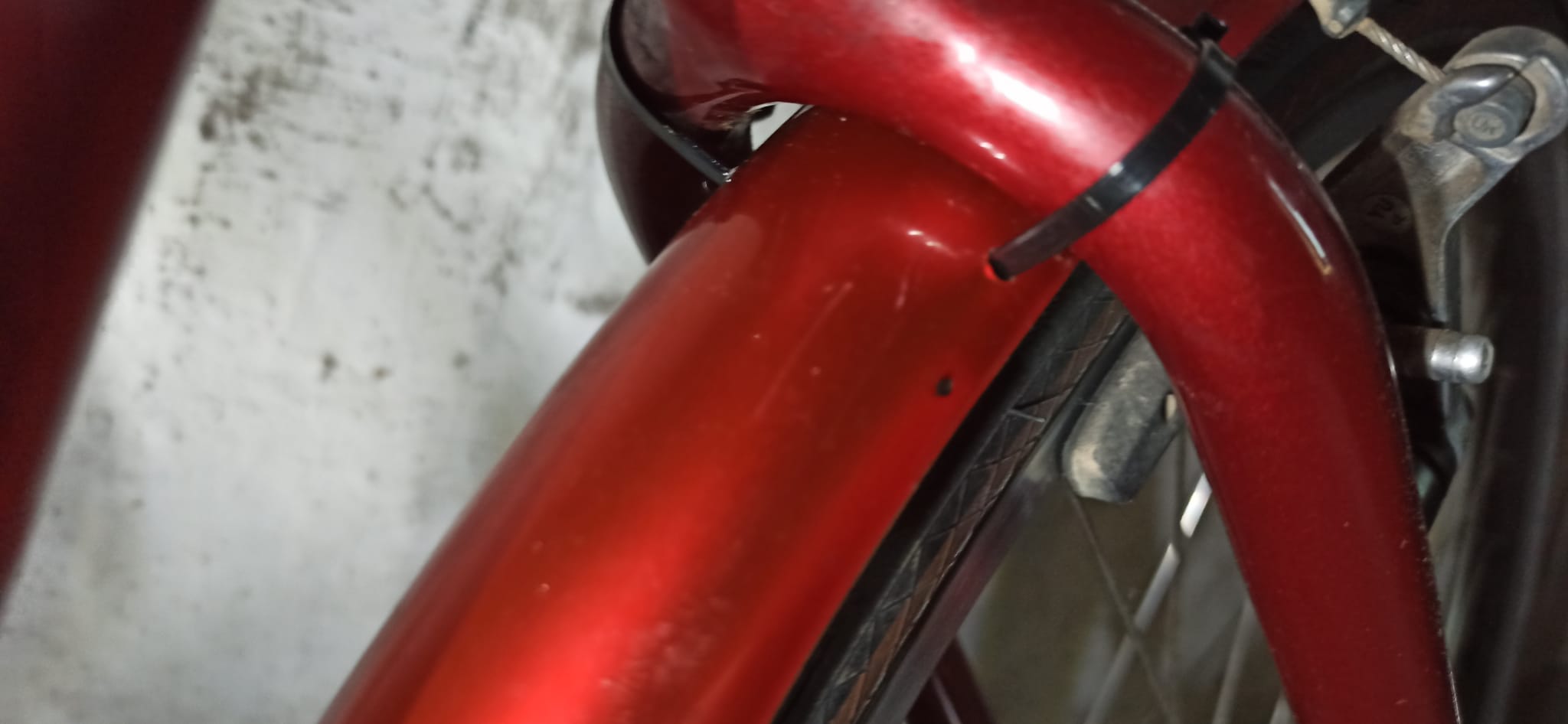

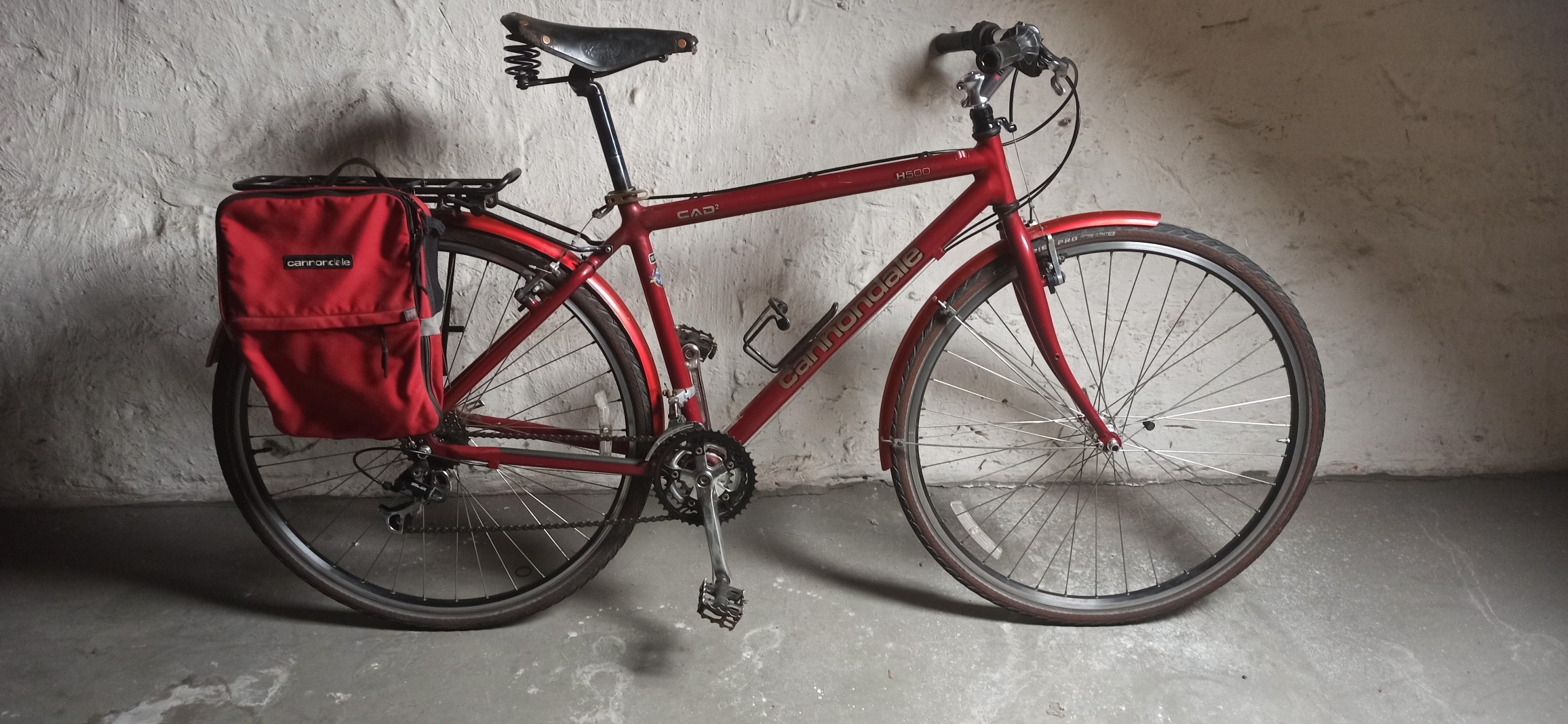

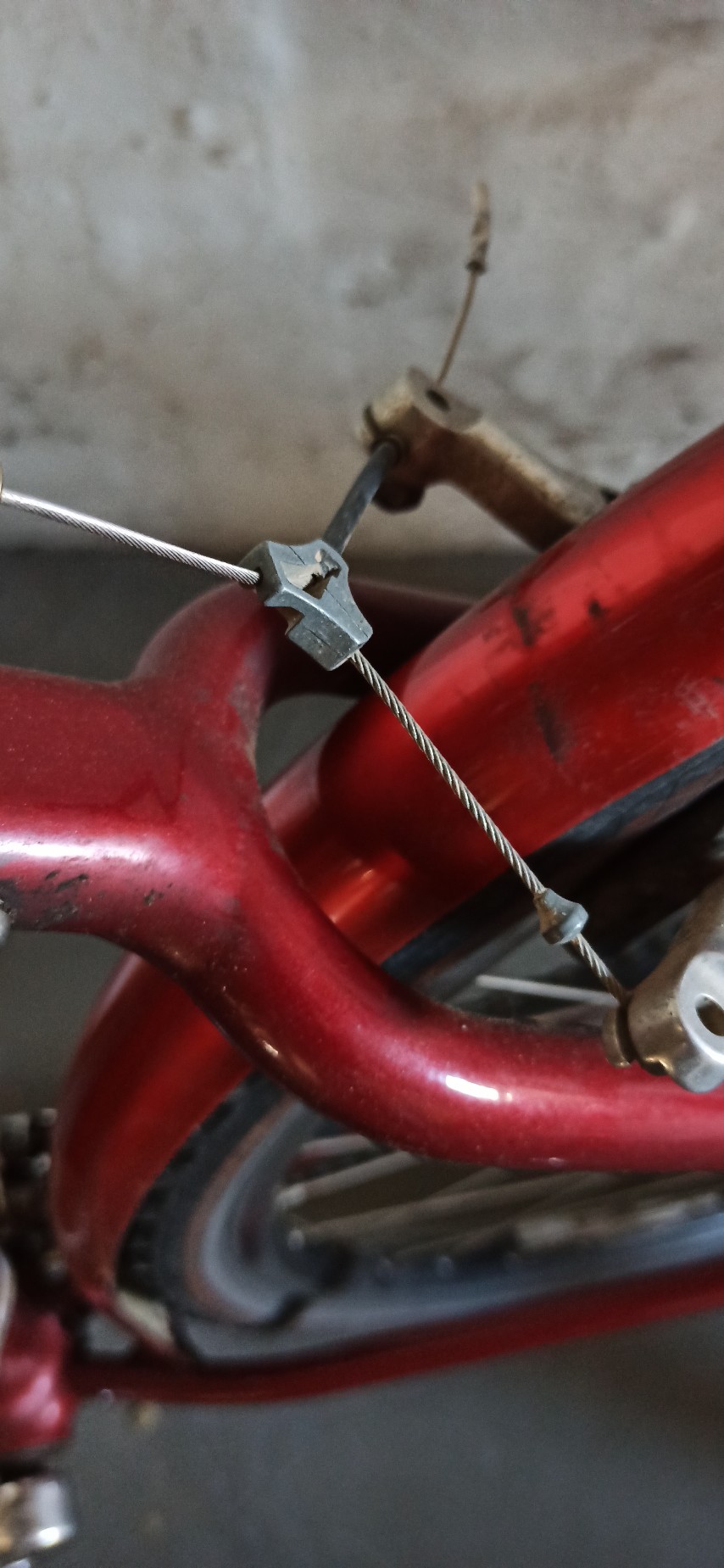

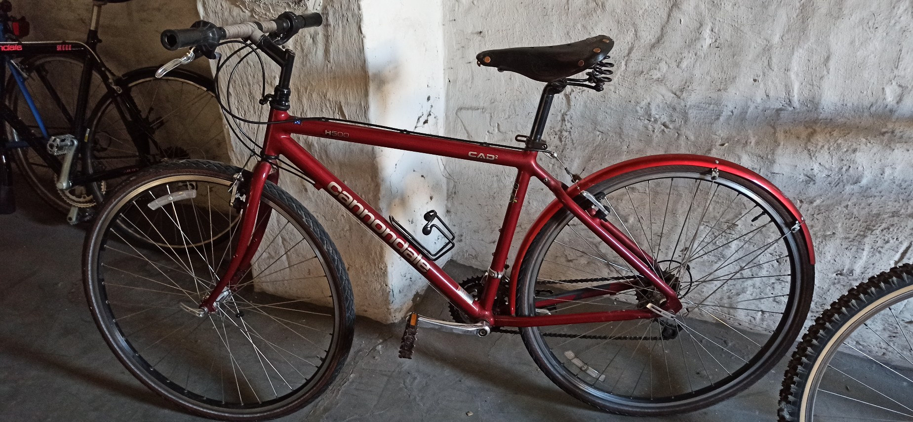

Yesterday I got this nice little H500. I'd like to put bluemels on, but could anyone tell me how to fix it on this kind of frame? The best idea I had so far is to make little holes in the fenders and take zip ties to fix them, but I don't want to ruin the bluemels by doing that.

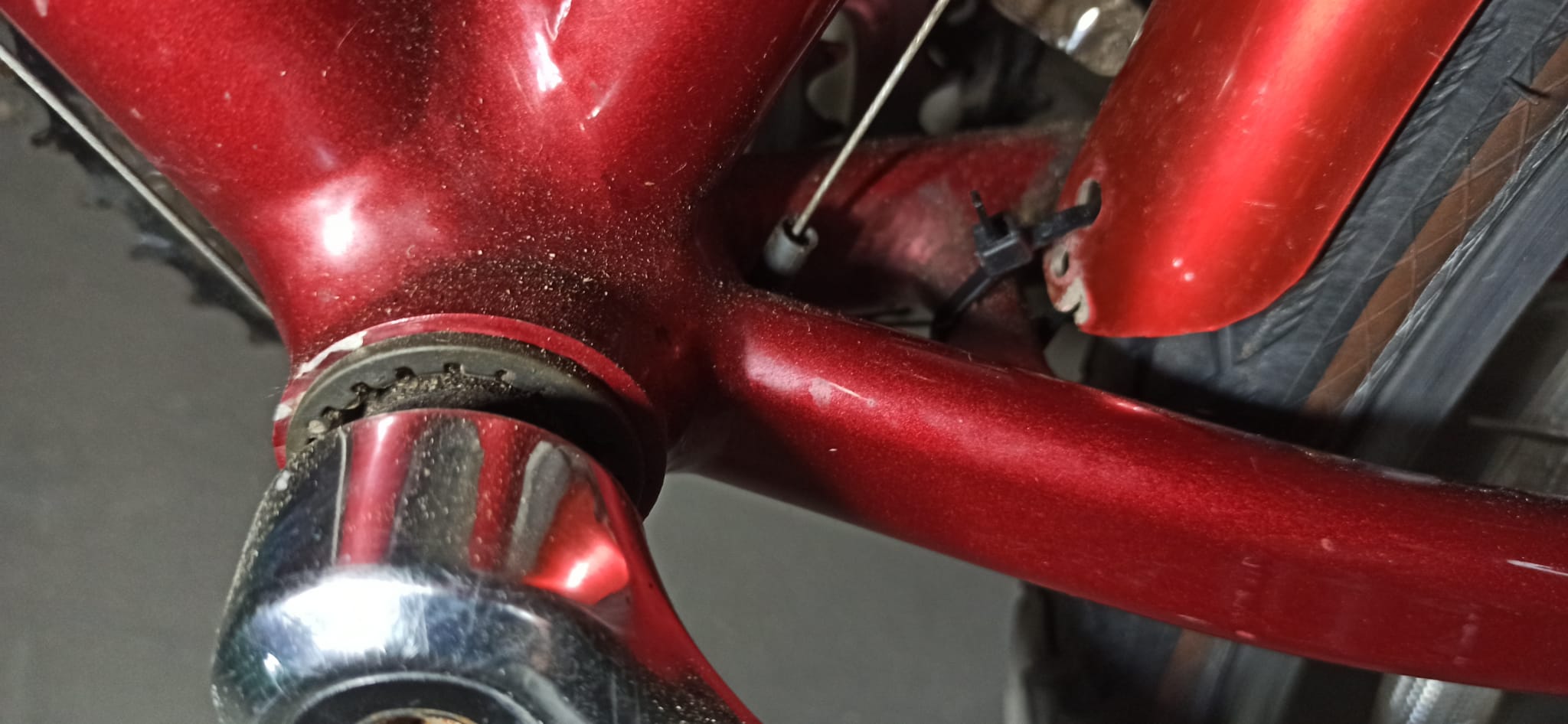

For the rear you might fabricate a sheet metal bracket from the original mount (or mounting hole) to the rack mount boss on the frame. Was there originally a similar bracket on the front fender?
ChrisW
Problem solved!
Might not be the most elegant way to fix it, but it works and it's hardly visible with rack mounted.
Looks good enough for me
